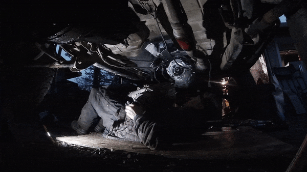

Post a video on YouTube and provide some pictures. This is a GIF I made so no audio... can't post videos directly...
