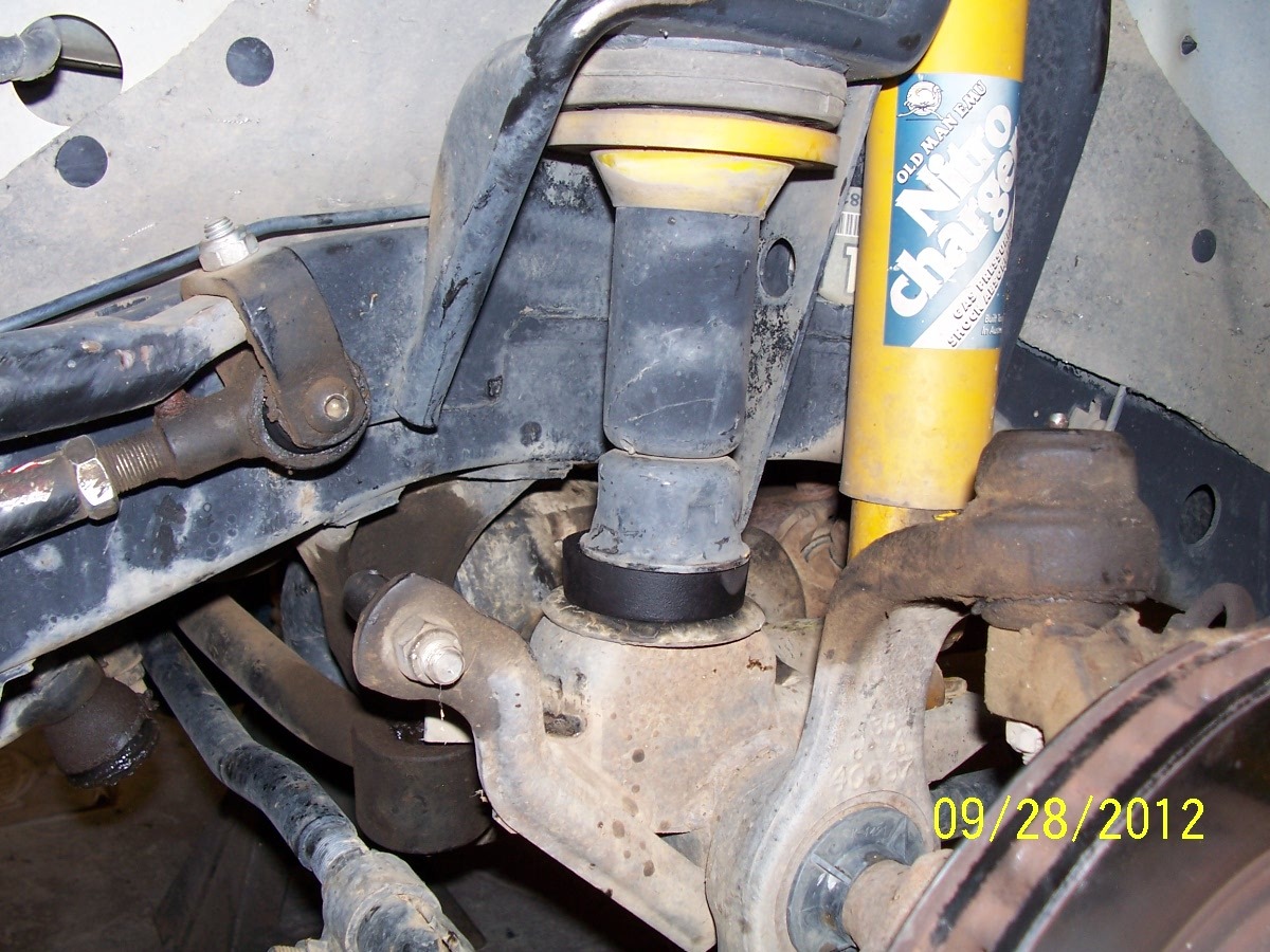

The OEM isolator is on top only and is a softer rubber than poly spacers. I kept the OEM isolator up top and added the OME 10mm spacer below it. Ran that way for years. I now run 3/4" poly spacers front/rear in that same configuration. As usual, I have pics, lol!

If you keep that isolator on there, then add the 10mm OME spacer, then the spring, I'm going to have to assume you'll gain much more than 2", probably closer to 3", right?
