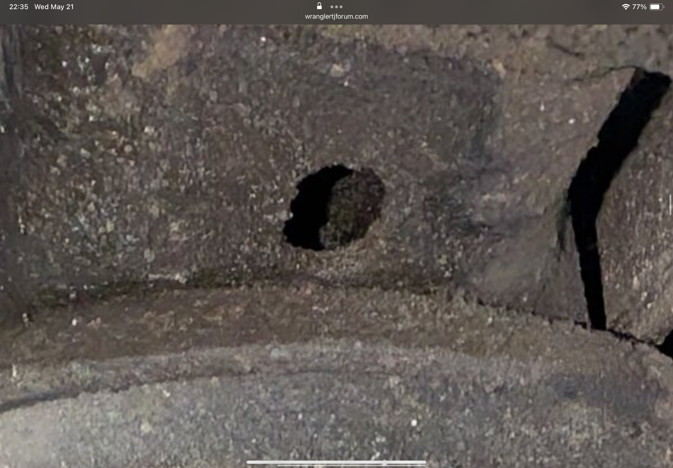

That frame looks rough...is that oil or scale? Have you borescoped the inside?

The frame is actually completely coated, I believe it is Krown. The first thing I did when I inspected the frame was dig into the "crud" and the steel underneath smooth is not rusted. But let me confirm further with my borescope to be safe.
