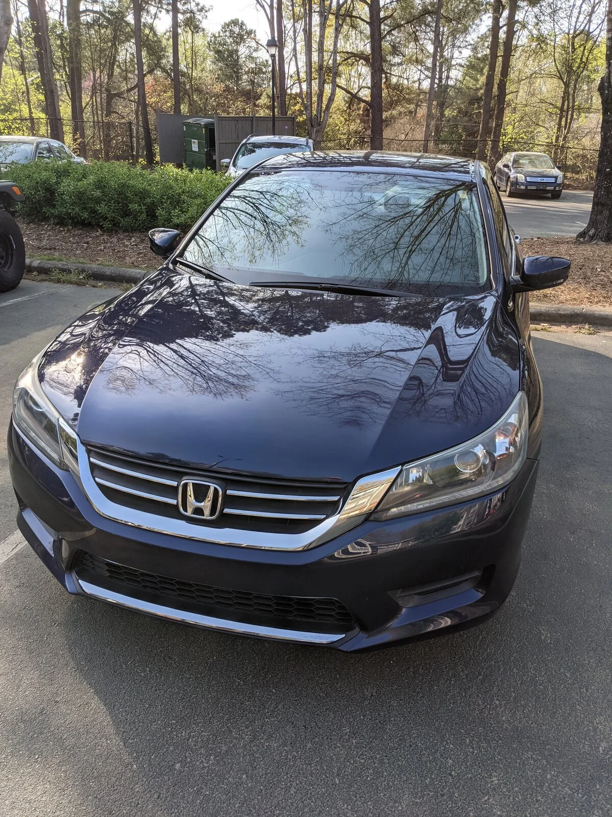

Biggest change I've made recently is paying off the Jeep and buying a Honda Accord, first highway trip I averaged 39.2 mpg driving with a very light foot 😁 Driving the Jeep is fun again now.
