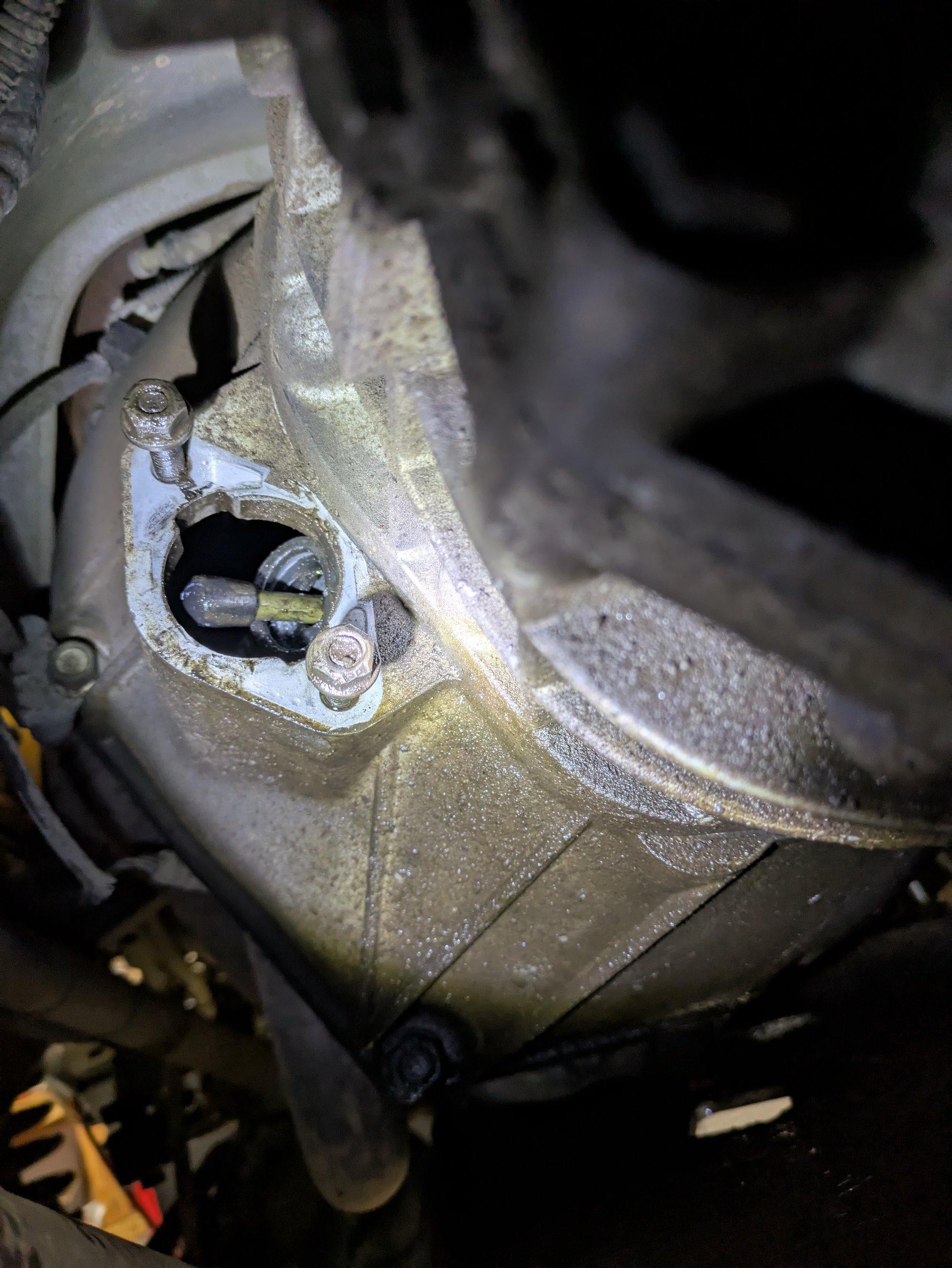

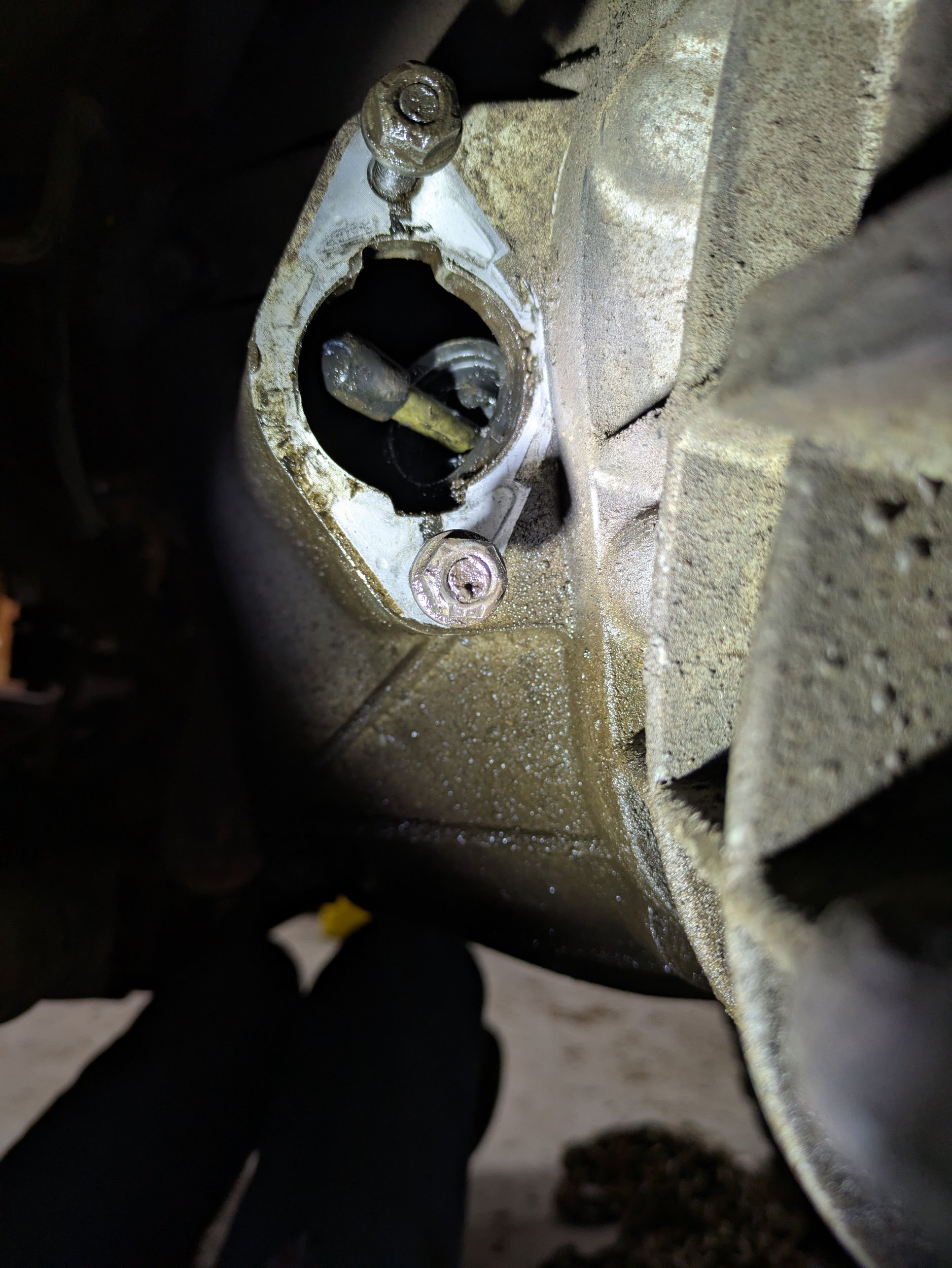

I was able to remove the system but found this inside the slave cylinder opening.
It appears that adding the extra fluid forced the clutch fork sideways?
Other than simple routine maintenance, I have touched nothing on this 5 speed.
So, when I removed the slave cylinder and then I see the clutch fork sitting like this, I'm fairly sure it's sideways now, and I'm totally uncertain how to correct, other than pulling the tranny.
If I can avoid pulling the tranny, that would save quite a bit of work.
Has anyone encountered this, and is there a simple cure?
Lots and lots of posts on this. I'd drop a pre-bled Luk master/slave in and be done with it.
Ah...shift fork is screwed up...yeah...time to drop the transmission and honestly if I had mine out I'd replace the clutch, TO and pilot bearing. Luk also make a kit.
-Mac
-Mac

I'm hoping to not have to pull the tranny. Trying to determine if this is salvageable. I've never had the tranny apart, so unfamiliar w the way it all lines up inside.
I'm going to slide in a camera and determine if this can be slipped back into place before I commit to a new clutch and sundries.
Thank you for your reply.
