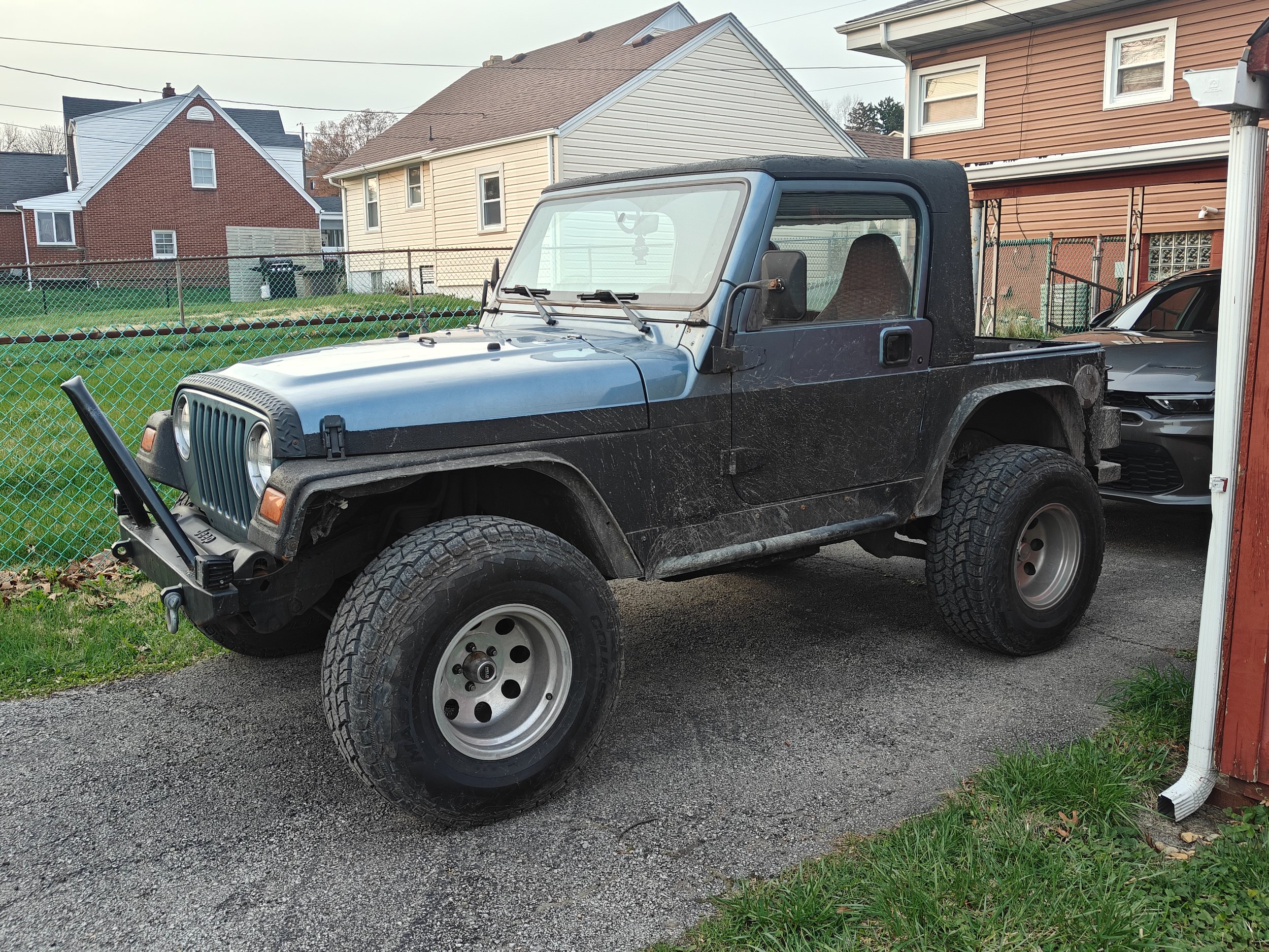

Picked up my new to me TJ 2 weeks ago. And I noticed all the shocks are leaking. I've looked at everything from ranchos to Bilstein to fox adventure series and can't come to a decision. It's a lot of on road driving with the occasional trip to the trails. Jeep has jku springs for the lift and on 33s. 4.0 5 speed. Also replacing the front bumper (currently a home made stinger from original owner) with a stinger bumper and winch. View attachment 609332

Your TJ looks light in the back so a softer shock like the Black max should do well. I have Bilstein 5100s in the front and Black max in the rear. I picked them more for the sizes they come in than ride concerns but when I switched to the Black max out back the ride became more supple.
