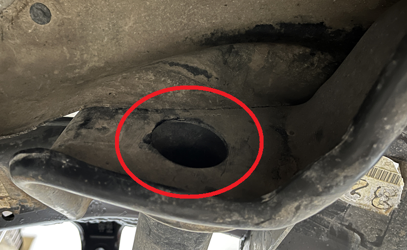

Does anyone have a print file for a plug or a cap to seal the opening atop the front coil buckets?

If you have a picture of this opening (my Dana 44 is out and apart right now, and I couldn't see what you mean), and assuming it's just a round hole that needs a plug, I can probably design something pretty quickly to try, and then if you provide feedback, I could tweak it until it worked for you.
Edited to add: I think I figured out what you're looking for. Is it a plug for this hole:

I can't find the picture right now, but I used a large rubber foot that would go on the end of a pipe - think "cane foot", but larger. Got it at Ace. Wasn't my idea, someone else here on the forum did it first. They've been in place for years, no problems and lift right out when needbe.

that's it!
Here's a zip file that contains a .3mf and a .stl file. If you'd like to see a write-up on the design of this piece, see my build thread.

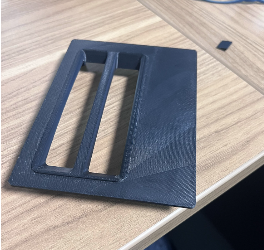

wanted to add this. Its a replacement auto shifter bezel. Just the black trim part, the rest of the parts are not designed, and it would be tough to print the curved lens...but if you have a shifter cover that has broken tabs, this will work to replace it.
I'd recommend ABS or ASA material, PLA could melt in the interior of a car and there isn't any reason to go with any of the filled engineering fillaments. PETG may work also, but I've not done much with PETG. The tricky part (going on a few years since I actually made this) is removal of the parts you're keeping from the junk. IIRC, they are heat staked together. I included posts on the new design to use sheet metal screws to hold the assembly together.

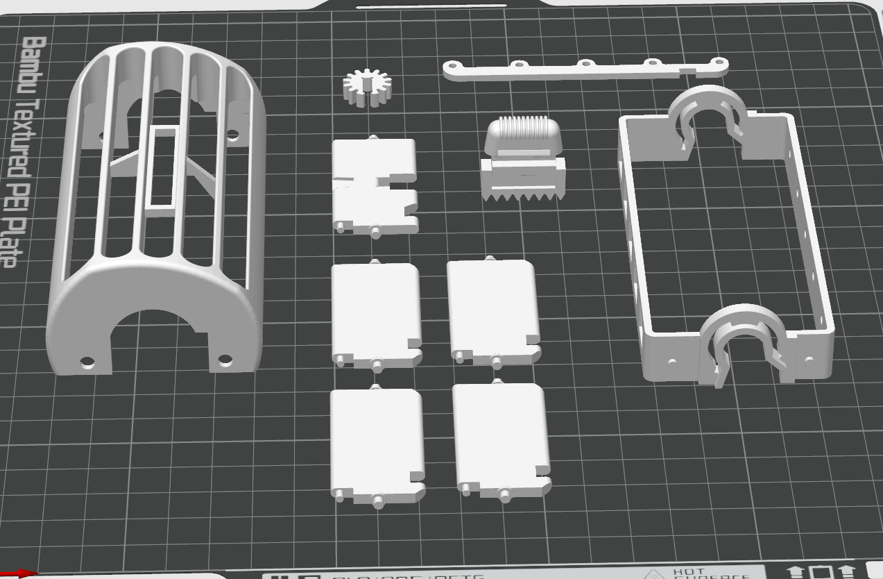

Here are some .STL files for center vents. These are meant to match up as close as possible to the OEM ones. I have yet to finish optimizing these as an assembly, but they are close. I have test printed these with PLA, the pivot point on the frame piece may need some tweaking to have proper tension. Here is a pic of them in Bambu Studio. Just clone the outer baffles, need 4 of them and 1 center baffle. Gear snaps onto center baffle, knob snaps into outer shell. Baffle tie bar is a tad too thick to be honest, needs to be adjusted so it doesn't pop off the baffles.
Anyways not too bad for a first couple rounds of editing. Enjoy.

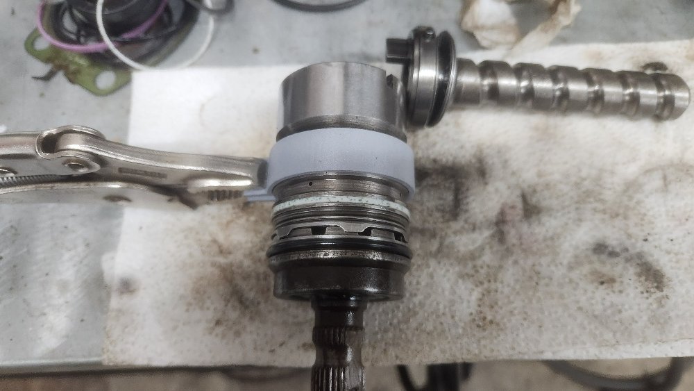

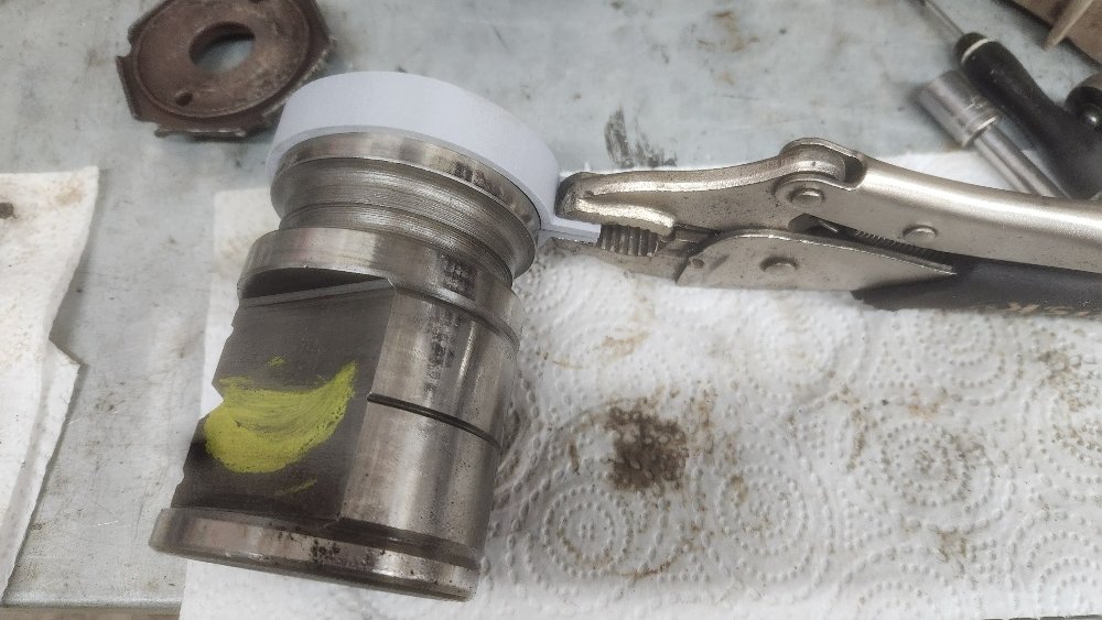

If anyone is rebuilding a Saginaw steering box, I found some 100mm ring clamps and scaled them to 2.75" & 2.00", the sizes needed to compress the teflon rings on the piston and spool valve, respectively. @hosejockey61 's method in his video works but with a 3-D printer at my disposal, why not make some effective tools with it. I printed with PETG @ 100% infill.

Nice!
