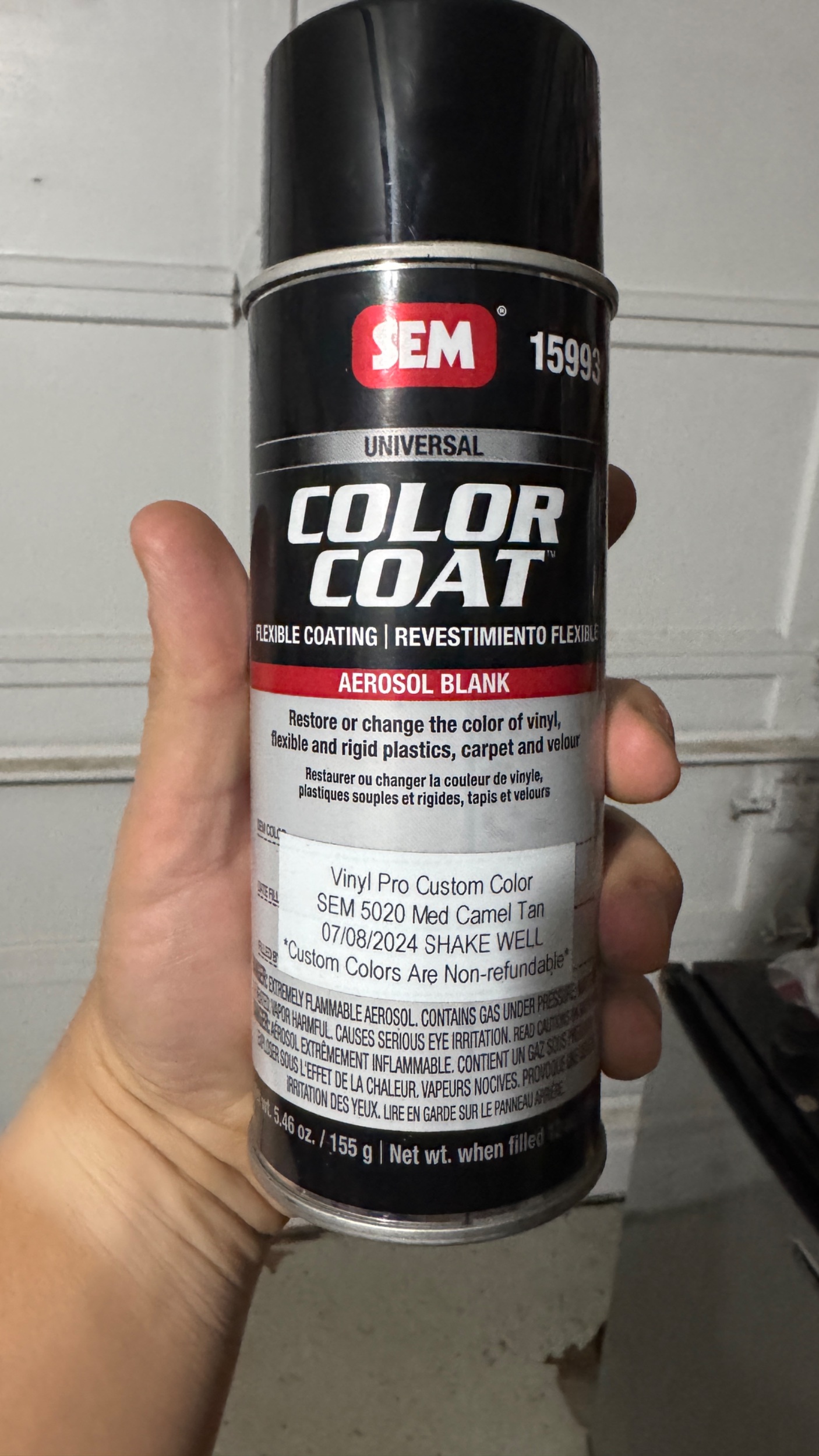

I recently refinished the interior panels of my 2001 Sahara same as factory. It is SEM 5020 Med Camel Tan . I went to my local paint Specilist and they got the paint mix exactly the same
