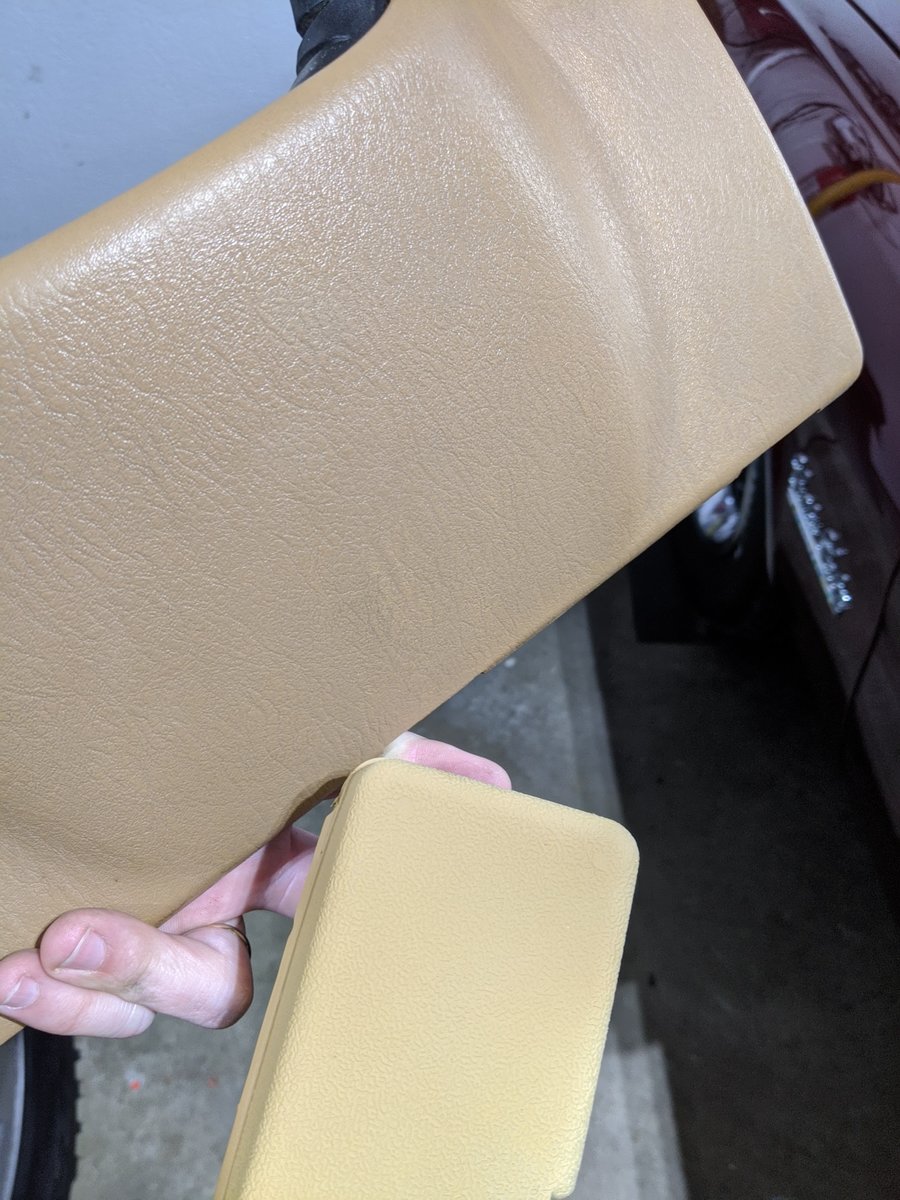

The paint guy mixed both 5020 medium camel and 4976 saddle up for me and neither are it for my '98. 5020 medium camel is too light and 4976 saddle is a very dark brown, almost black. I have pics I'll try to figure out how to upload later. I have previously tried 15173 saddle tan and it's close but too orange. I'm trying to repaint just my airbag cover, not the whole interior, so a perfect match is crucial. The hunt continues.

I have 15173 on my half doors. It is close but not enough for a panel on a door next to the dash, but not a long panel in the middle of the dash (like my airbag cover). I get what your saying about the effort to find the right color, but if I was doing that why bother trying to find a close color at all? I'm comparing all these colors against the unfaded underside of a dash panel btw. They clearly aren't just faded differently. They are off.
Interestingly the guy made me a can of 4976 color coat after the 4976 and 5020 sure coat. It was much closer than the 4976 sure coat. Still no cigar though.

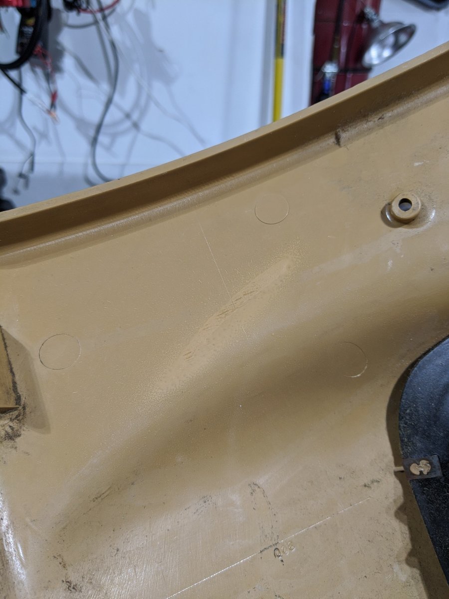

Sorry for the delay! I just sprayed a few light coats and tried to get the cracks as best I could. My goal was just getting the interior to a reasonable state. Here's some pics of how it's aged. I scraped some paint off moving lumber, and touched it up with some left-over can. Overall, I'm happy with it still.
That’s a bummer! I was stoked to get the 4976 paint code, but that’s basically yellow from the pic. I don’t mind the darker tan too much though. That was 15173 right?
