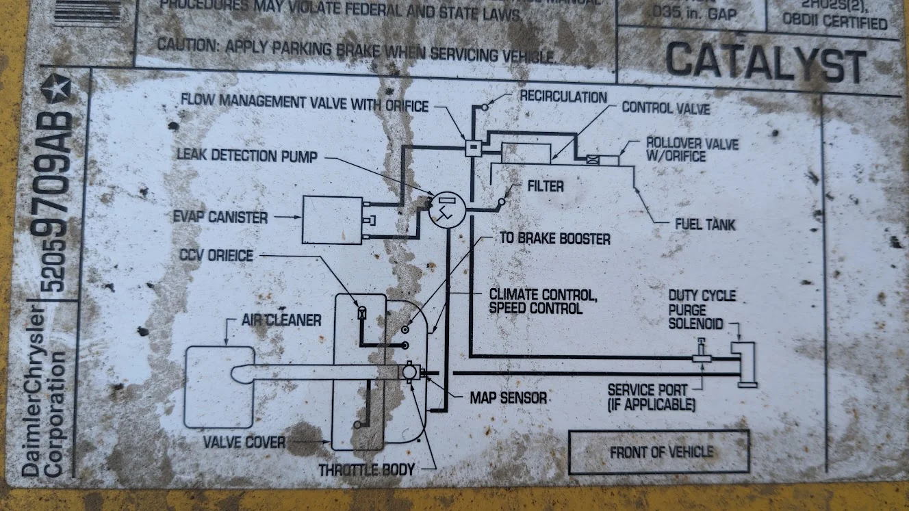

I'm wondering if there's anything in the system that would cause too much fuel vapour to be pulled through? The evap system diagram shows the canister vented to air, would this being clogged mean too much vapour flow? Or if the canister was saturated with fuel? Or do I just need to replace the purge valve even though it seems to test good?

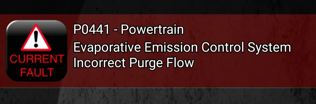

I get an occasional 0441 on my 97. I need to start troubleshooting too.

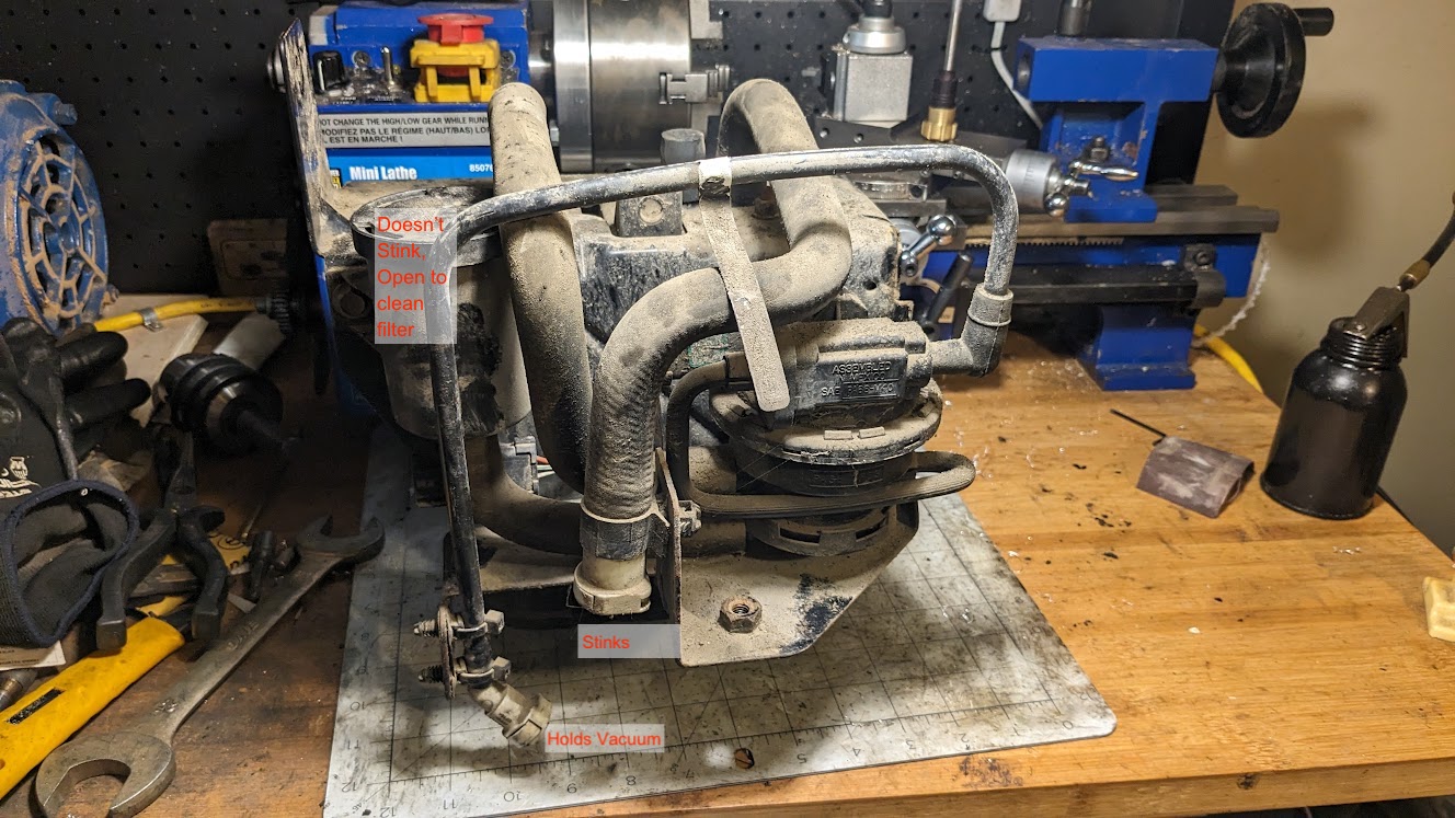

Well, the canister sounds like dry sand not sloshing fuel, and it only stinks like vapour when you blow air through the one direction. Also I didn't see any charcoal chunks in any of the lines. So I think the canister is still good.
According to the FSM the flow management valve seems to just be a correctly sized hole to control flow (similar to the CCV) so I can't imagine that could fail to allow extra vapour through.
I did clean the canister filter, it was dusty, but not so caked as to completely block flow. Also after looking at the diagram closely, the only way I think that filter would create a situation where way to much vapour was going into the intake was if it was completely blocked and the tank was pressurizing. But in that case, the purge valve would suck it back to neutral fairly quickly I imagine and then the flow of vapour would be restricted not amplified. Plus I'd have filling issues.
The leak detection pump could fail allowing unmetered vapour into the intake, but it has a separate line and so unplugging the purge solenoid wouldn't have fixed the issue, plus I'm sure I'd be getting codes if it was the pump. Also that line does hold vacuum with the vehicle off.
