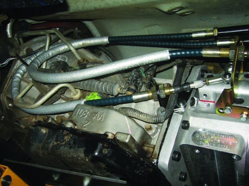

Also, here is a good pic of how the cables need to be routed.
Reactions: Apparition
