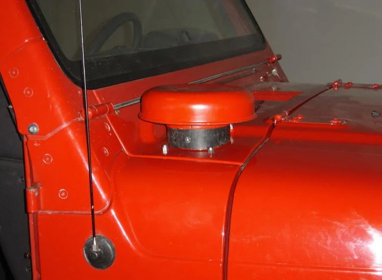

Sorry - I should have been a bit clearer. Only the elbow would be going into the cab, it will exit out the top of the cowl and have an extension I can either put a short tube on (maybe 2-3") with a mushroom cap or a taller one (12" or more) if I want as a snorkel. I don't want to crimp or cram an accordion hose into the cowl if I don't have to, so the flow is a smooth 4" all the way down to the box. So the actual intake inlet will be higher than the stock location, and won't be the 1.5" hole facing into the engine bay sucking up all the heat that little 4 banger can put out. I just figure I'm going to be working on the engine and probably upgrading the exhaust manifolds while I'm at it, might as well turn some attention to the intake and get it up into the cooler outside air, and future proof it in case I do want a full snorkel.
Run it into the cowl like the windstar setups then a 90 out the cowl and put a heavy equipment intake cap on it.done. no need to run it into the cab 🤔

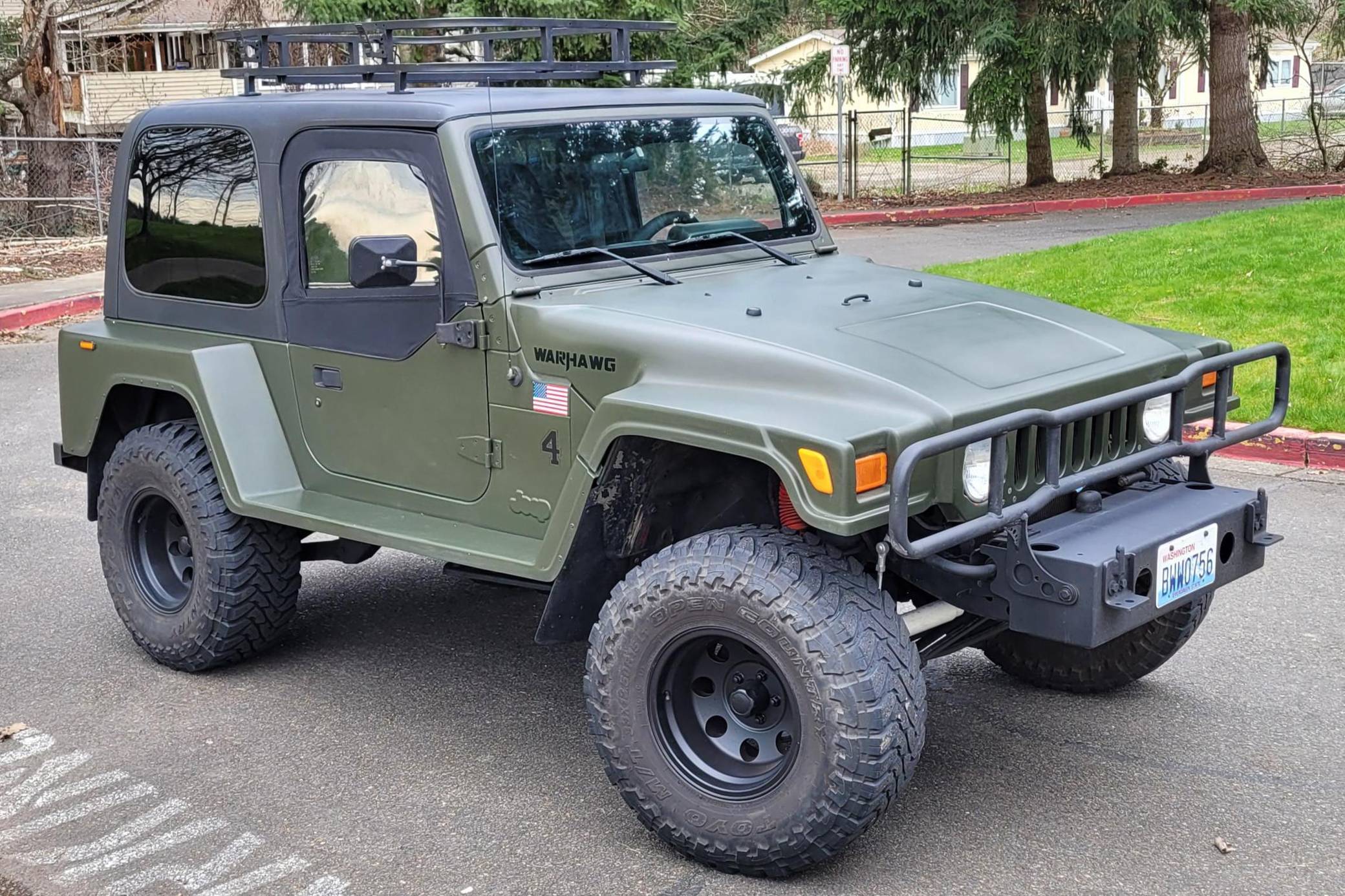

If I'm being 1000% completely honest with myself here, some part of me just wants another cool and unique part on the Jeep... Ever since I got the chance to work with a USMC HMMWV for awhile I have been in love with the style, raw utilitarianism and everything about them period. No way I'm ever going to be able to afford one of those though, so my "little hummer" will have to suffice lol. Plus I'm looking at a way to just simplify and unclutter the engine bay/vehicle, as well as making changes that I can live/grow with as needs change.
