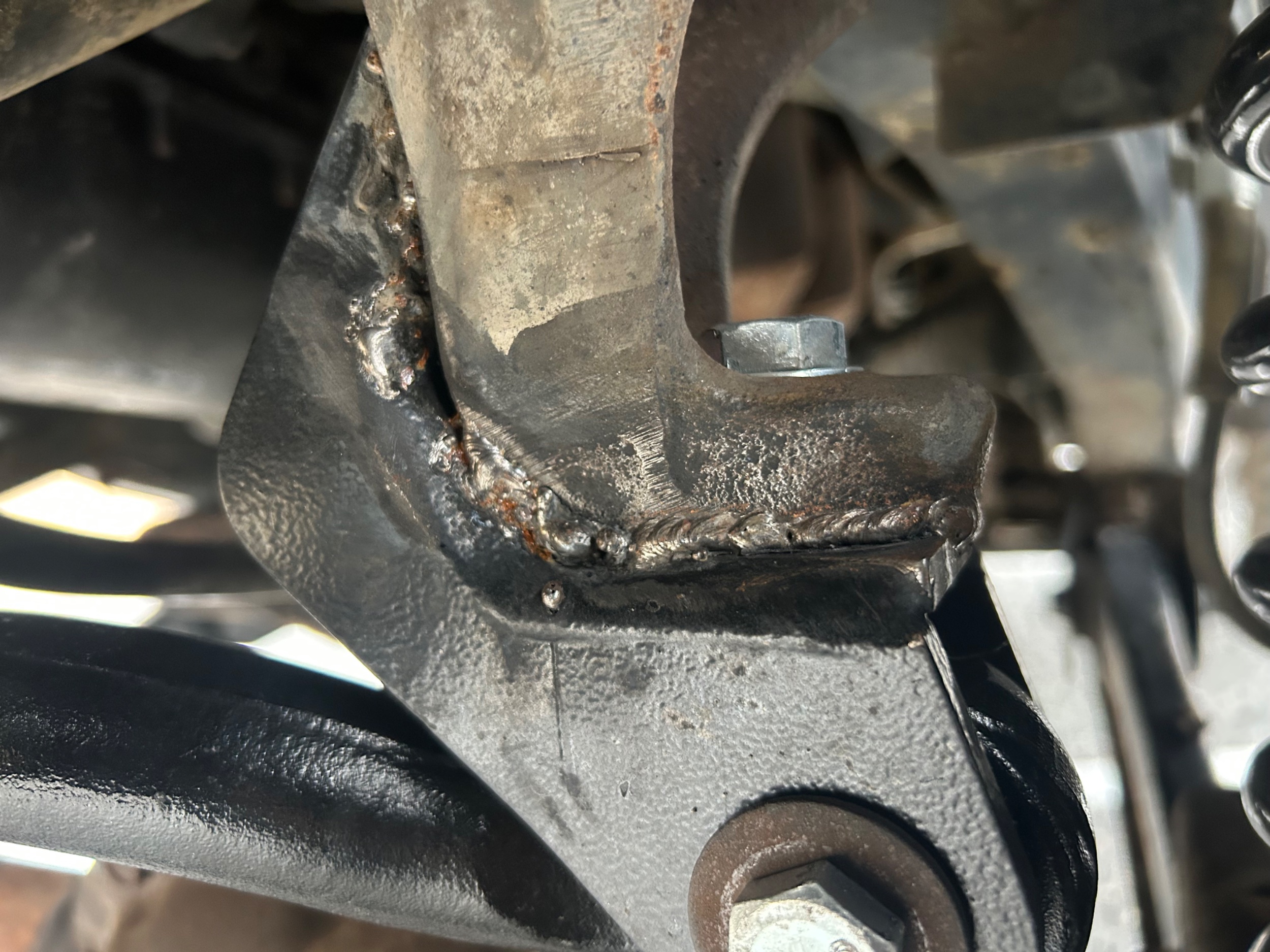

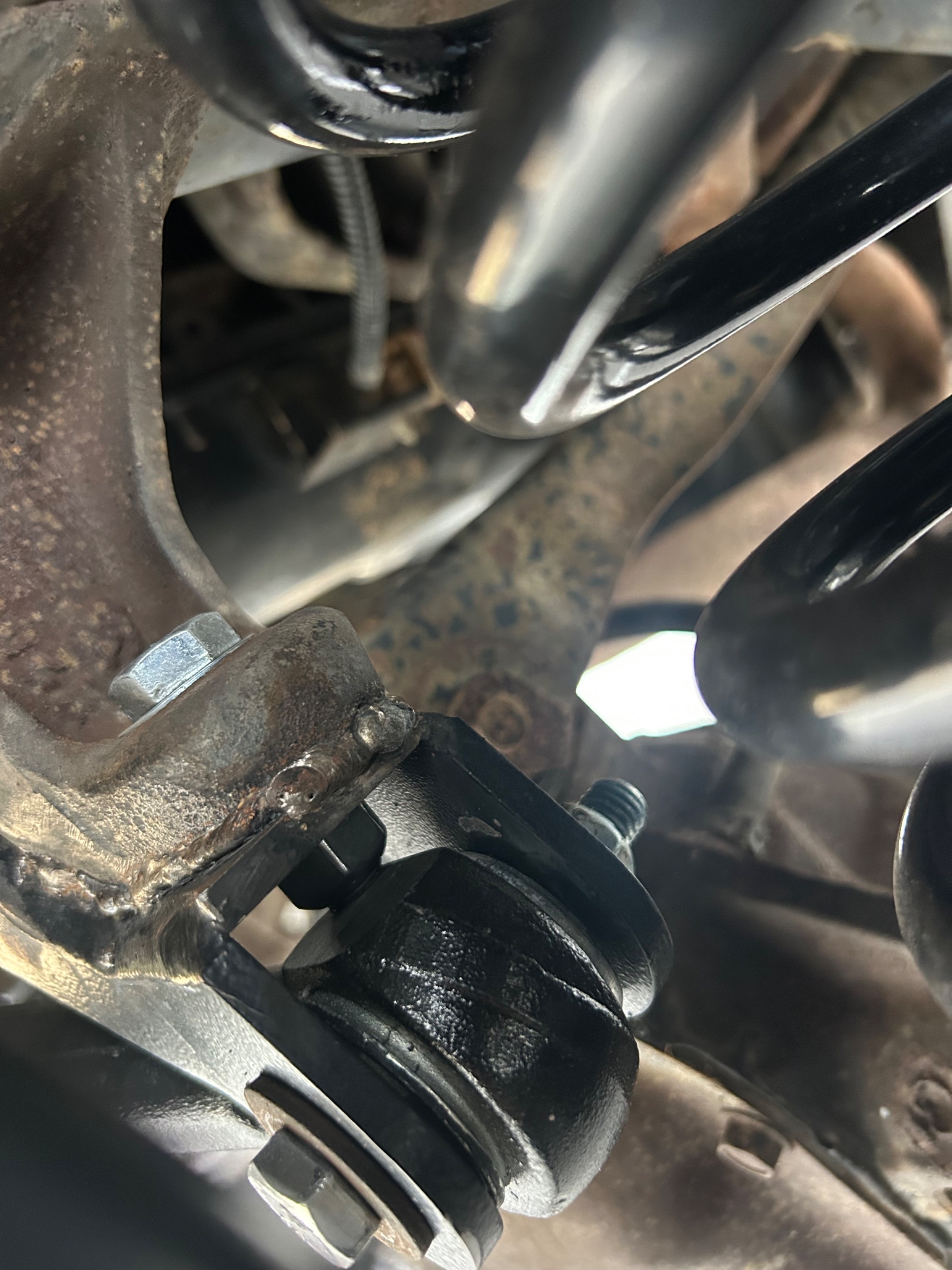

I would have installed one more bolt and nut ant the top and wouldn’t have welded anything.but yes it is not needed at all for that short lift.
Yea my drill wouldn’t fit up there to drill the top hole for the bolt, so I just filled it full of weld lol.

NO. You need to remove that drop bracket. One good smack with a hammer should break those welds. ;)
p.s. I bought a Jeep with that RC bracket and a dropped pitman arm. It handled like crap. I removed both of them and all was well again.
Agree @Boogieman! @Obsdude - I had bad DW and several worn-out parts with the RC mount with stock pitman arm from PO. The FIRST thing we did was remove the bracket, and ride was much smoother by getting the adjustable track bar. The heim joint may need to go now as well, now that I know more about what to look for and what best for my needs since mine is a daily driver. GOOD LUCK on the welding!
