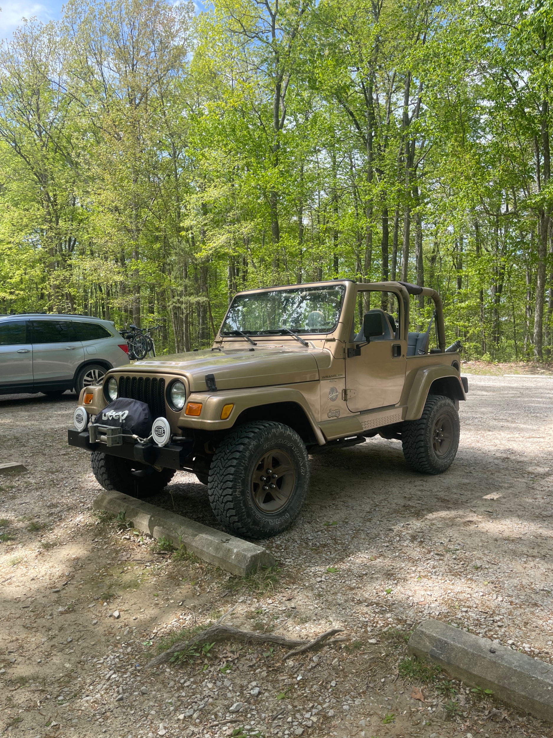

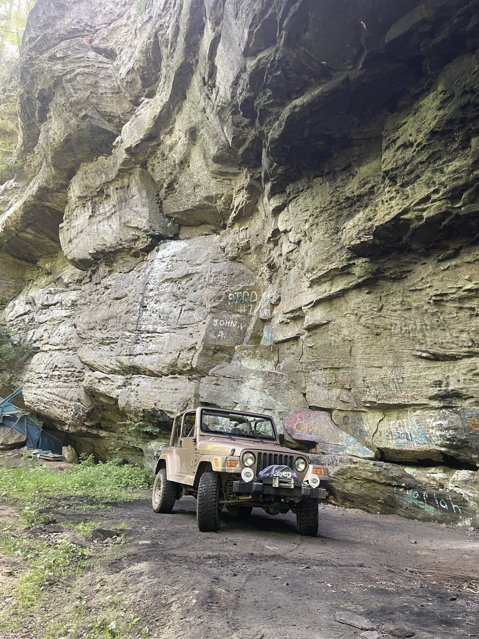

Looking at buying the Rough Country SYE and driveshaft for my 2000 Sahara as I continue to fix things on it.
4.0/ 5 speed. 2 OME HD springs.
Ordering either 32x11.50r15 OR 33x12.50r15 Cooper STT pros today.
The driveshaft Rough Country has lists 4-6" lift. I have 2" OME HD springs. Will the shaft be too long/cause issues?

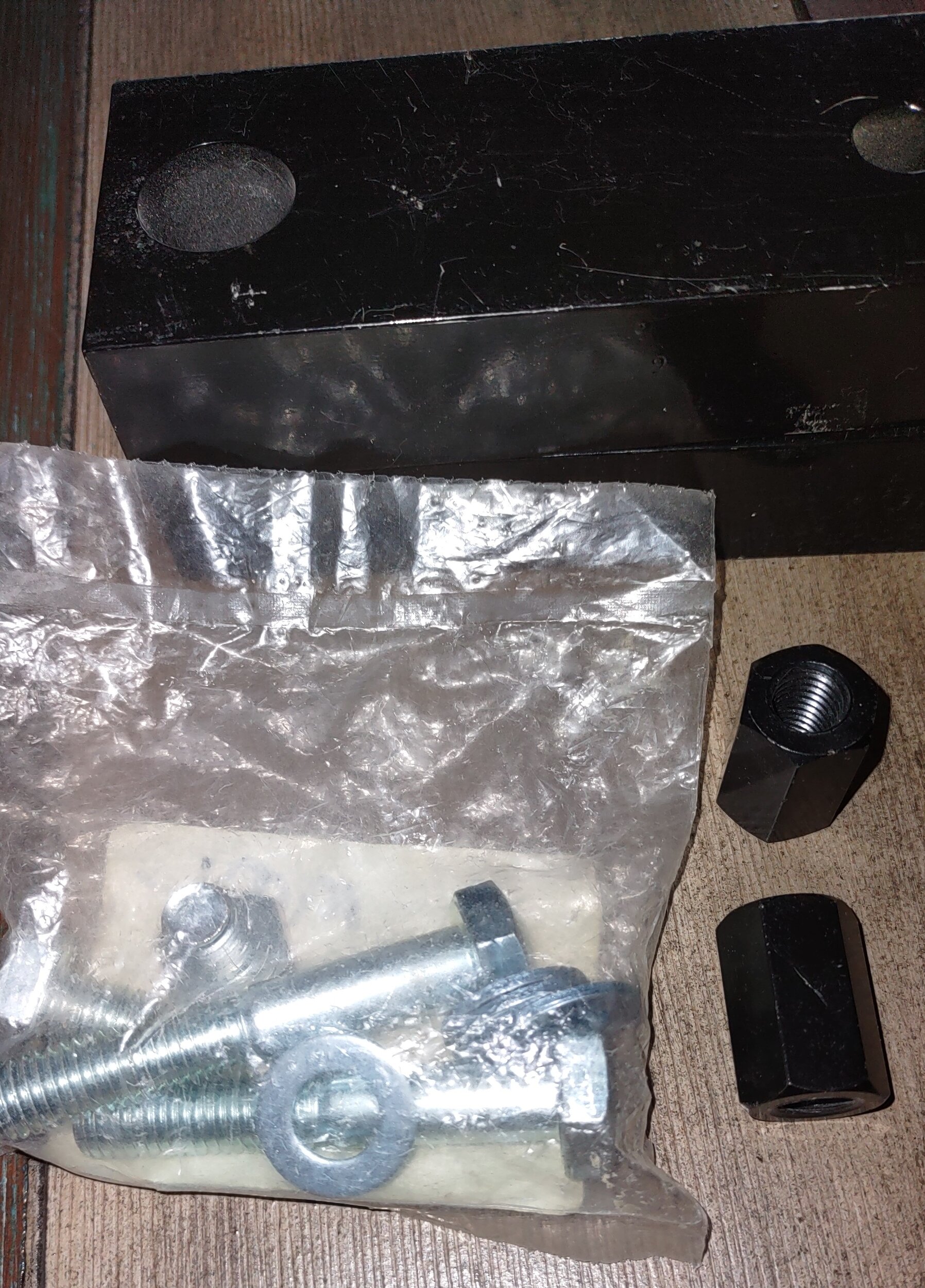

I was running it with 31s, new Spicer U-Joints and a 1" T-Case drop and had some vibrations. Was undrivable before the T-case drop, so I'd imagine with 32s or 33s it'll be back to the same issue.
