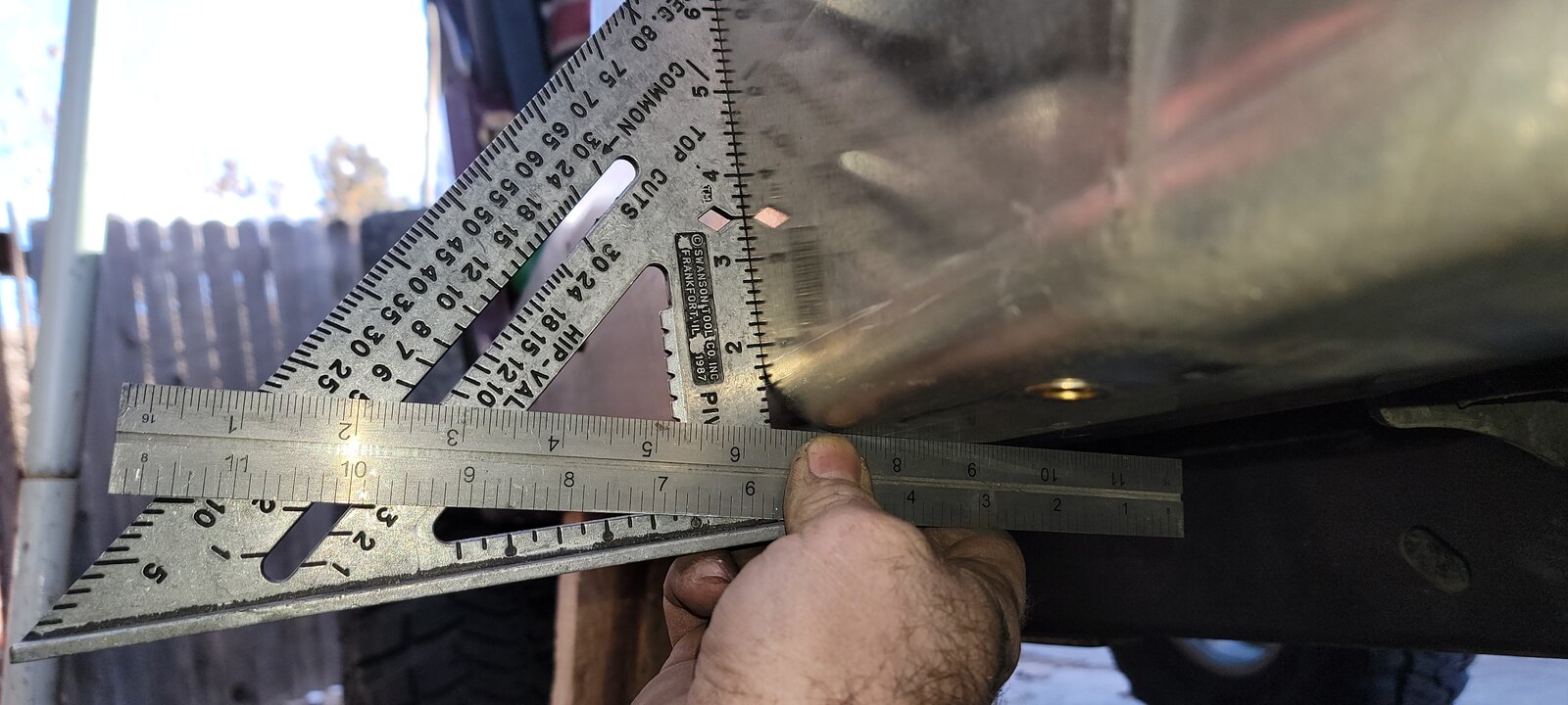

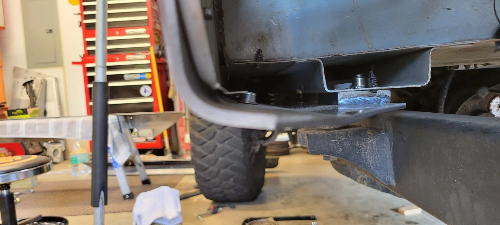

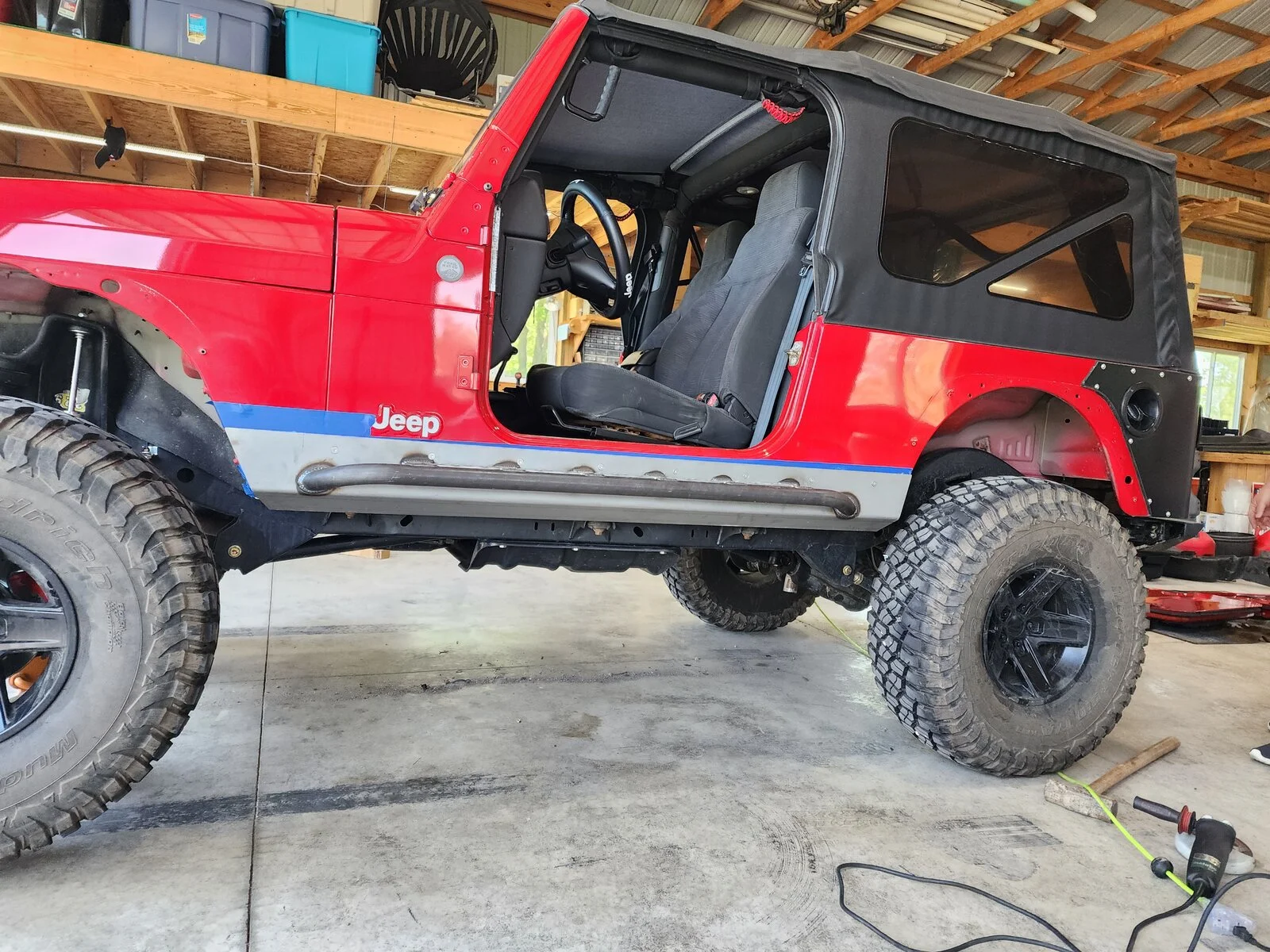

I got to install a set of Savvy sliders on mine today. This is my first time being able to really study Blaine's design. Something that I have never noticed and am really enjoying is how the aluminum rocker sits higher at the bottom corner of the body than one might expect.
The underside has a bend on the outboard side of the torque box that brings the corner up to the height of the tub lip.
Which means that the outer steel slider angles upward. Meaning that despite the double layer of materials, the Savvy design has a bit more clearance than the more common 90° bend most other sliders have. There can't really be more clearance than this without modifying the body with a boatside design.

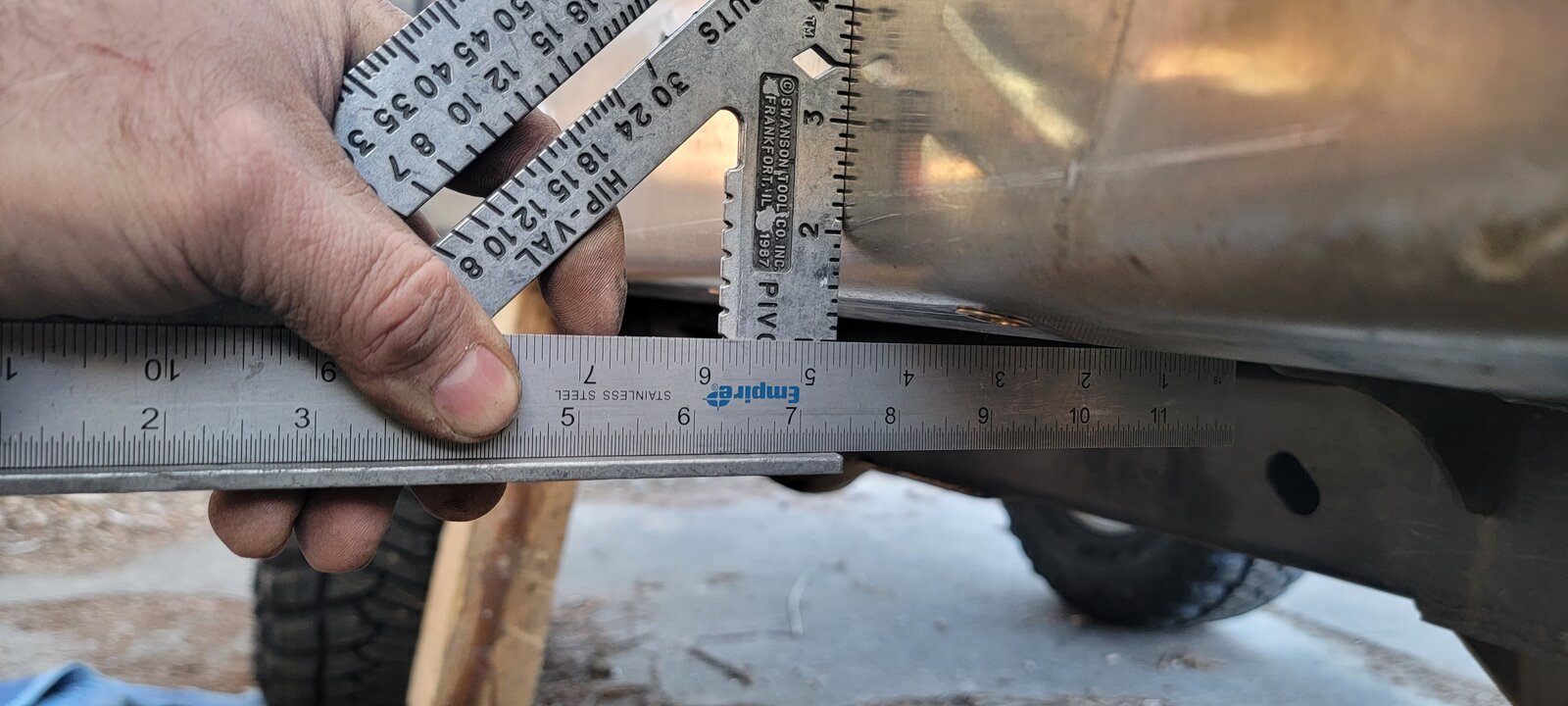

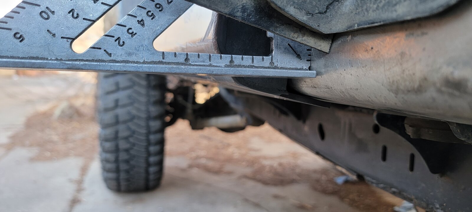

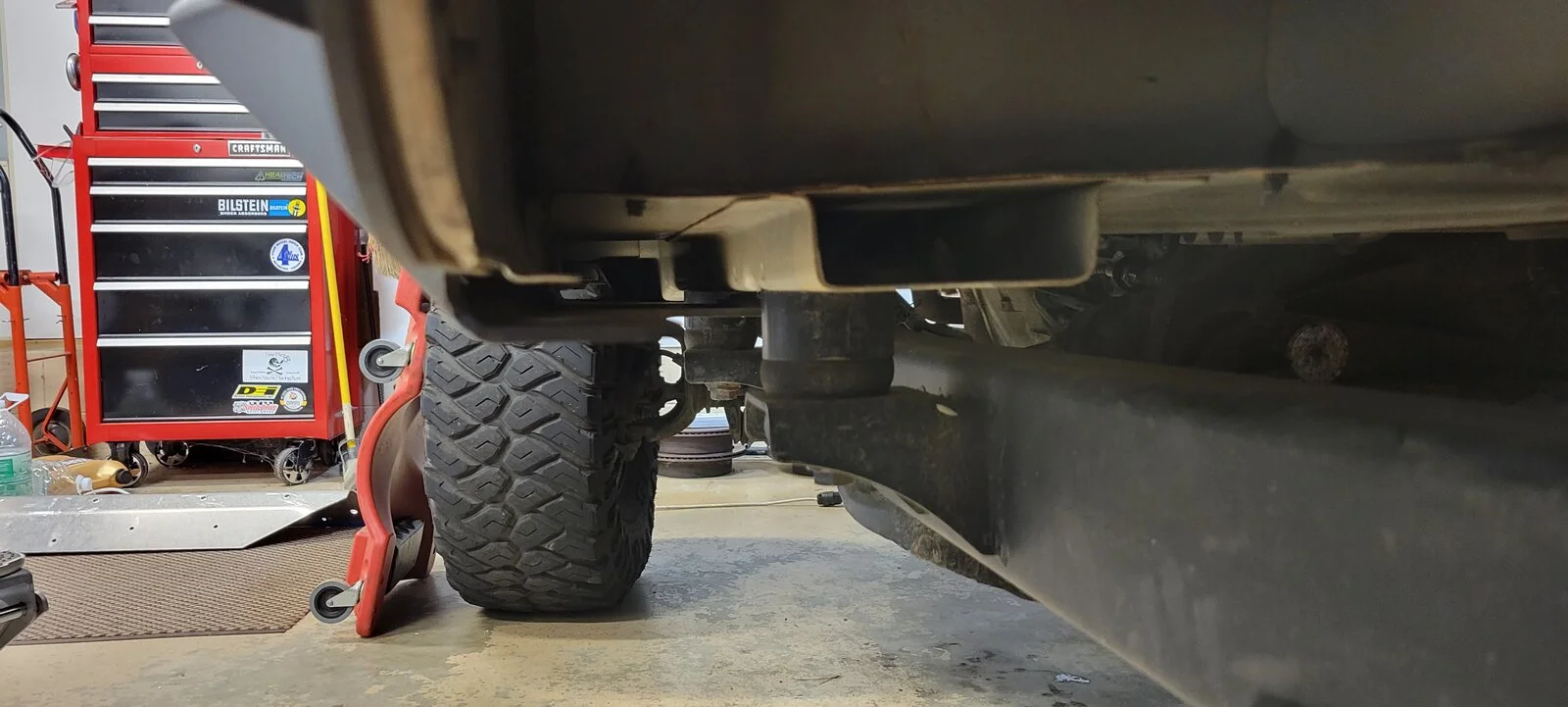

More telling would be a picture if possible taken looking in from the end. That shows the inside face of the aluminum backer goes up as high as possible to the lower edge of the tub.
Any update on these? Did they even ship yet?
I just got them today. I will answer things that I was curious about and answer questions if I can.
There are no instructions.
There are 4 bolts in the torque box.
They will cover the tub, but not the front fender.

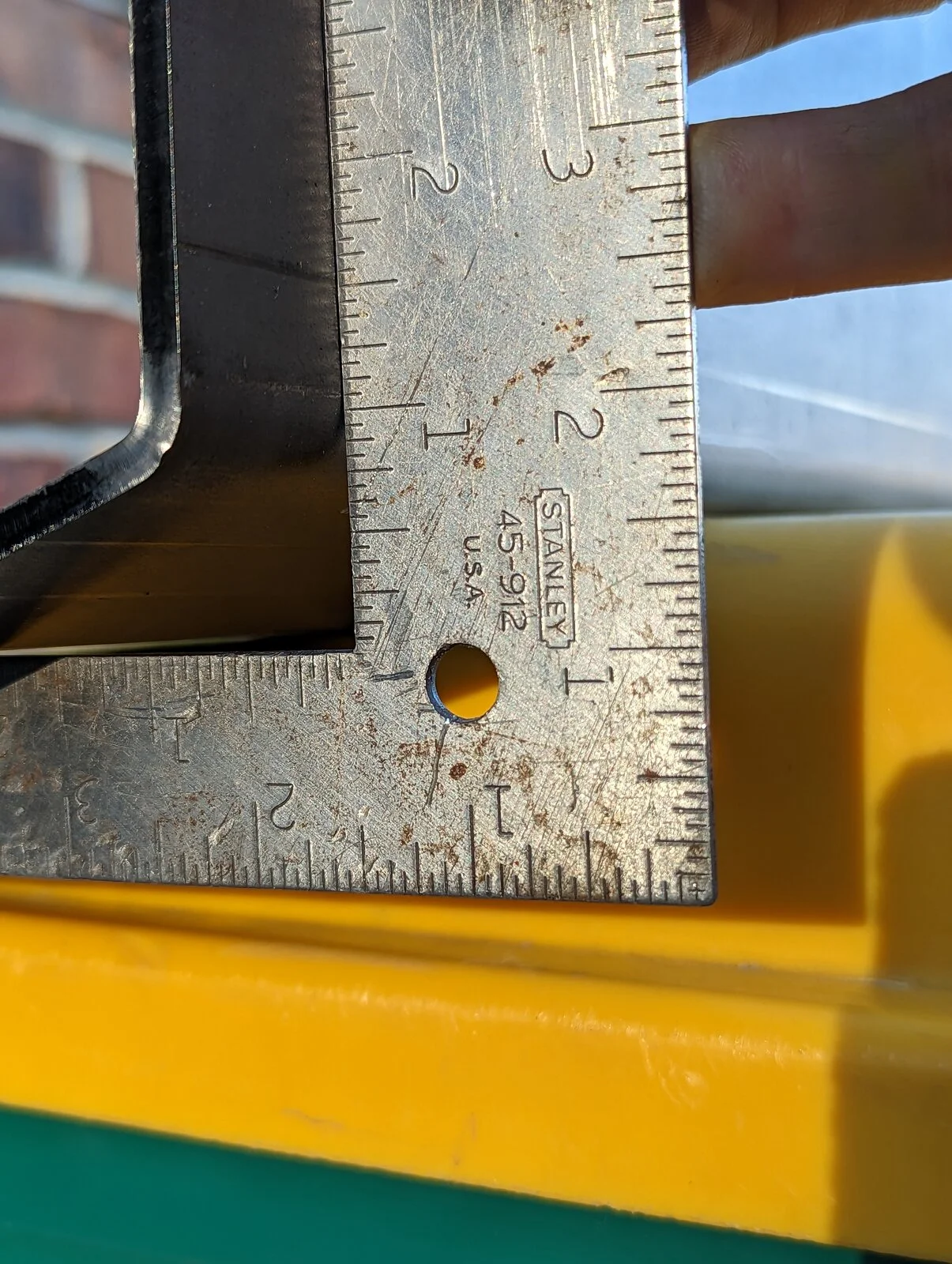

The angle is about 30* and about 3/4" tall.
Here is a shot from my jcrs and my the new savvy sliders. It also shows how much further back the savvy backer goes vs the jcr.
The rear block on the Savvy is also the correct thickness. The jcr is way to thin/small of a spacer block based in the height difference of the torque box front and rear.

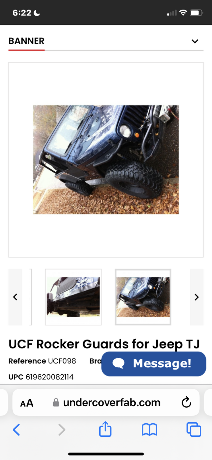

Unless I missed it, I didn’t see UCF rocker guards talked about. Google searches retuned no forum review posts.
They usually get pretty good reviews on their skids. They say that this is a bolt on application for rubicon owners so wondering if additional bolts would be needed/advised?
https://undercoverfab.com/rocker-guards/91-ucf-rocker-guards-for-jeep-tj.html
From what I can tell:
Backer plate: no
Mounting: tub
3/16 Steel
WW2WW: note sure but doesn’t appear to be
Backer plate: no
Mounting: tub
3/16 Steel
The UCF are ..2ww. 🤣 No in the front, yes in the rear. Don’t know what they were thinking there. Doesn’t look like much under tub protection. Using the Rubi mounting points is fine, but you’d need more. Any company that takes pictures like this makes me skeptical.

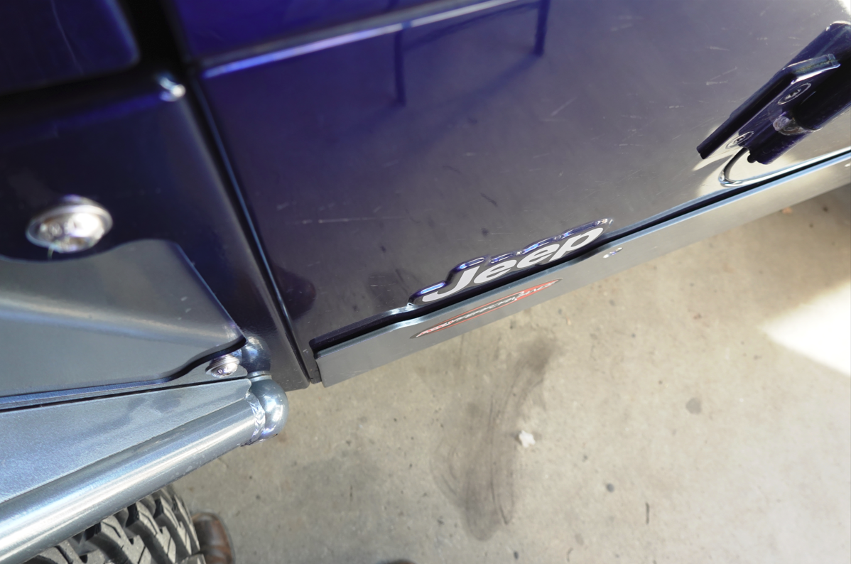

I would definitely install the bolt by the W, it’s not hard to drill a 1” access hole inside by the seat belt torque box area, it’s thin sheet metal. If you didn’t install the bolt, it’s a pretty big span of unreinforced slider.
I can try to grab some when I get home. If any bowing, there is a long gap of bolts on the front end of the slider under the jeep logo where a little gap formed against the body. Maybe the bowing was referring to that..
They’ve held up great, I don’t wheel in AZ type rocks but landed on them a few times.
