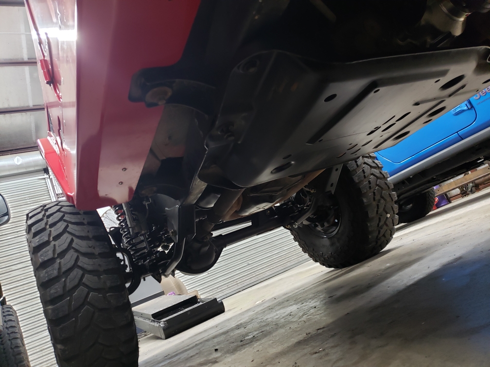

I emailed CAVFAB asking for a picture of how it attaches at the bottom and did not get a great one but here it is. It seems to me that it only bolts on to the sides of the cab. Might need some modifications to be fully secure.

It looks as though it has two bolts in the bottom. Think it was disgust before that there might need to be some slight modification to that.

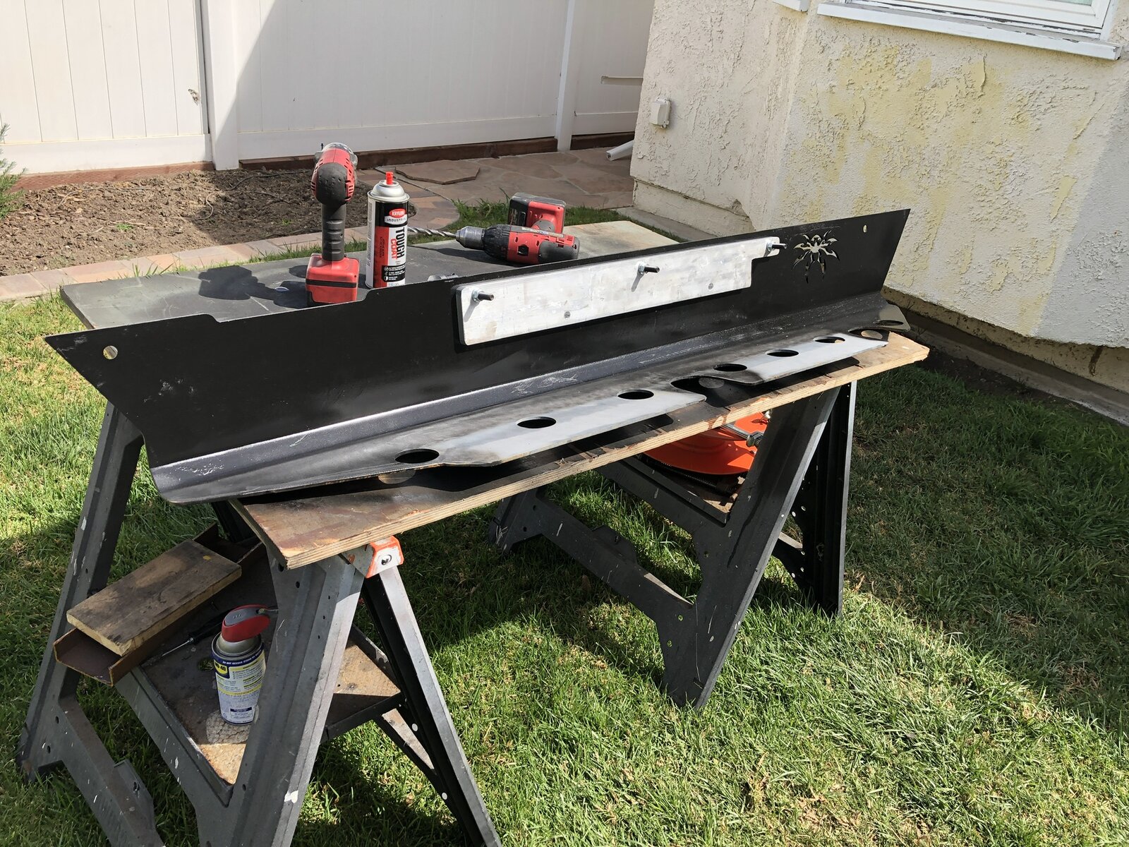

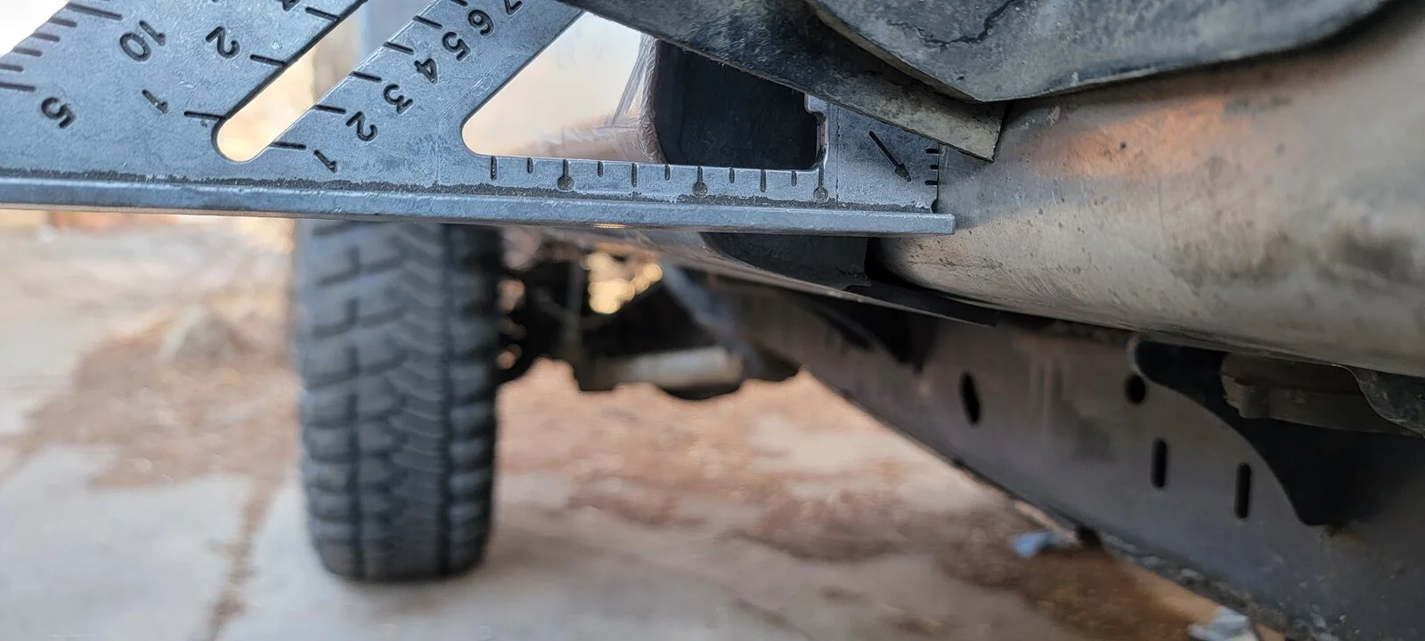

I just recently got the poison spyder ricochet rockers. I am having to Fab them due to metal cloak fenders (I would not use these again, but they came with the jeep.)
https://mail.google.com/mail/u/0?ui...316745&th=186f0df86dade549&view=att&disp=safe
The PS dont quite align to the tub floor in the forward section on my LJ. There is a gap in the front body mount about 3/8" Not a fan of how these were made. and not sure if its a one off or not.

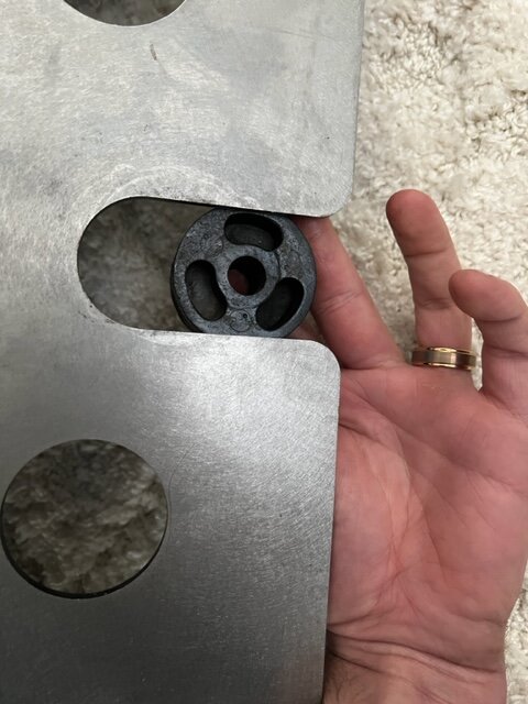

The other issue i'm having is with the body lift pucks. "Body lift pucks sit between the rocker metal of the upper body mount" They dont fit inside the mounting plate cutouts by about 1/8-3/16. I am likely going to trim some flats in the body mounts, but curious if anyone has had this issue or has BL that are wider or narrow than these. I would assume wider would actually be better to hold against the rocker to the tub. I would love to have gotten the rubber gasket for these before installing but they are 90-120 days backordered. (maybe) Has anyone used home made rubber gasket? If so what material is it? I have access to cnc cutters and was on hold for PS for an hour and a half with no answers before giving up. Wish I could just get a cad file.
Do not modify the body mounts or the lift pucks. Open up the slider to fit correctly.

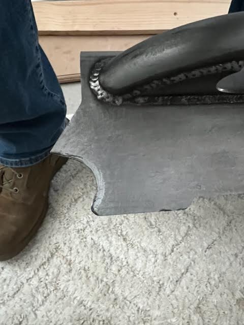

I have the same sliders and did modify them to get them off the body mounts and onto the torque boxes. I also removed a lot of the unnecessary material underneath.
Those are both great points. Thanks for bringing that up. I just like that they go further underneath the tub instead of wanrs or i think it was hard rock or someone that they only went 1-2" past corner. Have you seen anything on people reinforcing or upgrading the PS ricochets? Or should i do any underside bolts? From one of Mr blaines previous posts, i was looking at an inner tub plate or big washers or something.
Here are my mods before I reinstalled. If you want a step by step let me know. I think they dropped 6-8 lbs per side also.
Reactions: IPerkWVU
Those look good. Just add several more attachments (nutserts) to the torque boxes underneath. Make sure the underside is flush. The torque boxes are not equal height as you move front to rear. They taper up after the center body mount. 3/16 to 3/8 plate is needed to level with the front unless they’ve CNC’d it to compensate.

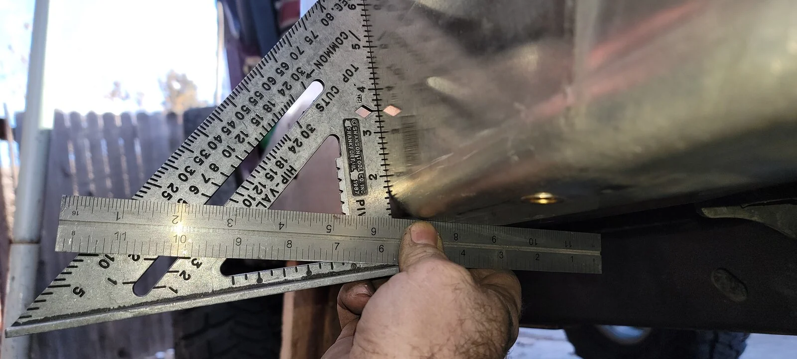

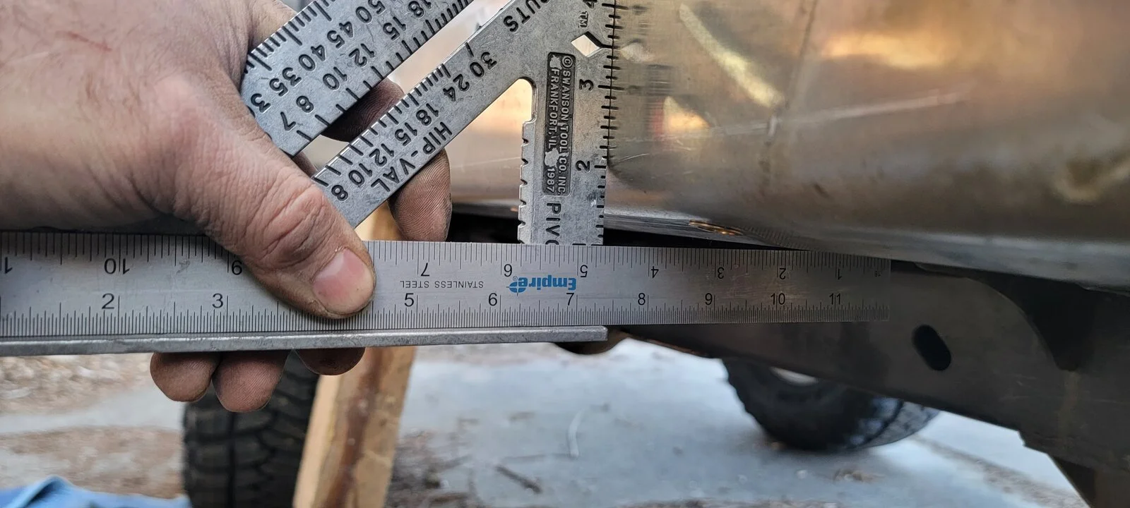

I got to install a set of Savvy sliders on mine today. This is my first time being able to really study Blaine's design. Something that I have never noticed and am really enjoying is how the aluminum rocker sits higher at the bottom corner of the body than one might expect.
The underside has a bend on the outboard side of the torque box that brings the corner up to the height of the tub lip.
Which means that the outer steel slider angles upward. Meaning that despite the double layer of materials, the Savvy design has a bit more clearance than the more common 90° bend most other sliders have. There can't really be more clearance than this without modifying the body with a boatside design.
