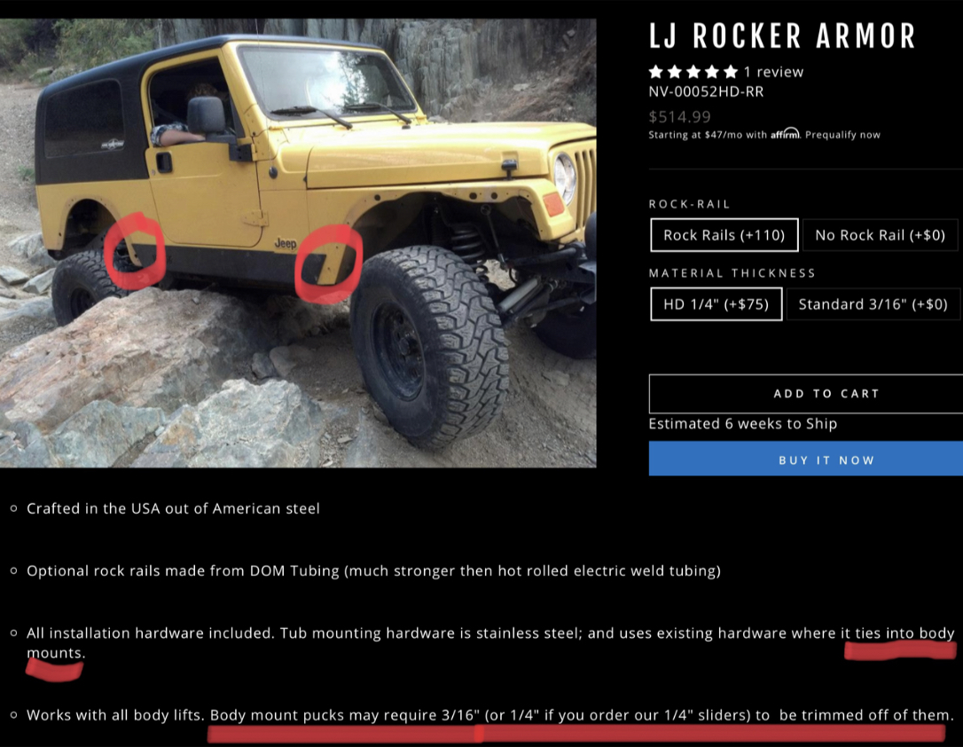

Anybody have or know anything about the Next Venture product? Their website has exactly one picture that doesn't show very much, so I sent them an email. I don't have a horse in this race, but as I like their rear bumper tie-in brace and they're not mentioned here, I figured I'd bring them up.

Like their rear bumper and have the frame tie in (different bumper) but looks like the might not be the best. Doesn’t appear that they go wheel opening to wheel opening and mount to body mounts.

They offer 3/16” and 1/4”. You can add DOM tubing. They are not ww2ww and a reviewer says they tie into the body mounts, so I’d say, “no.”

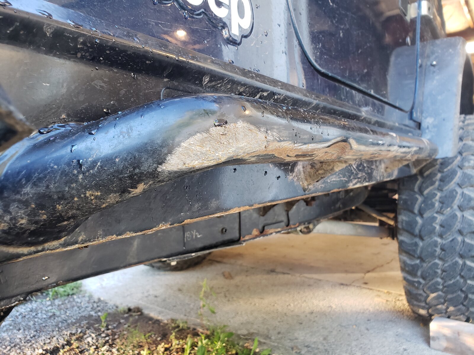

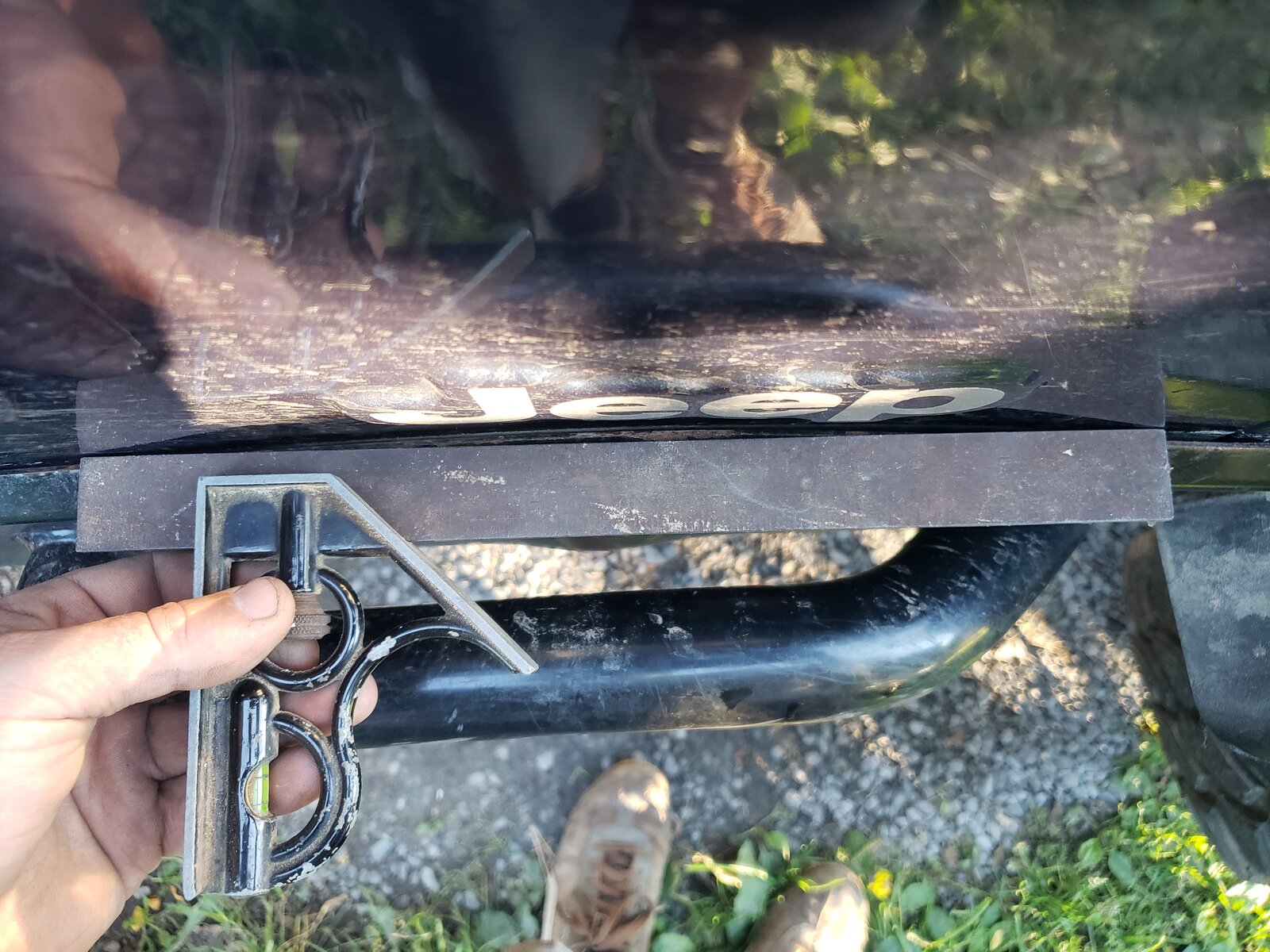

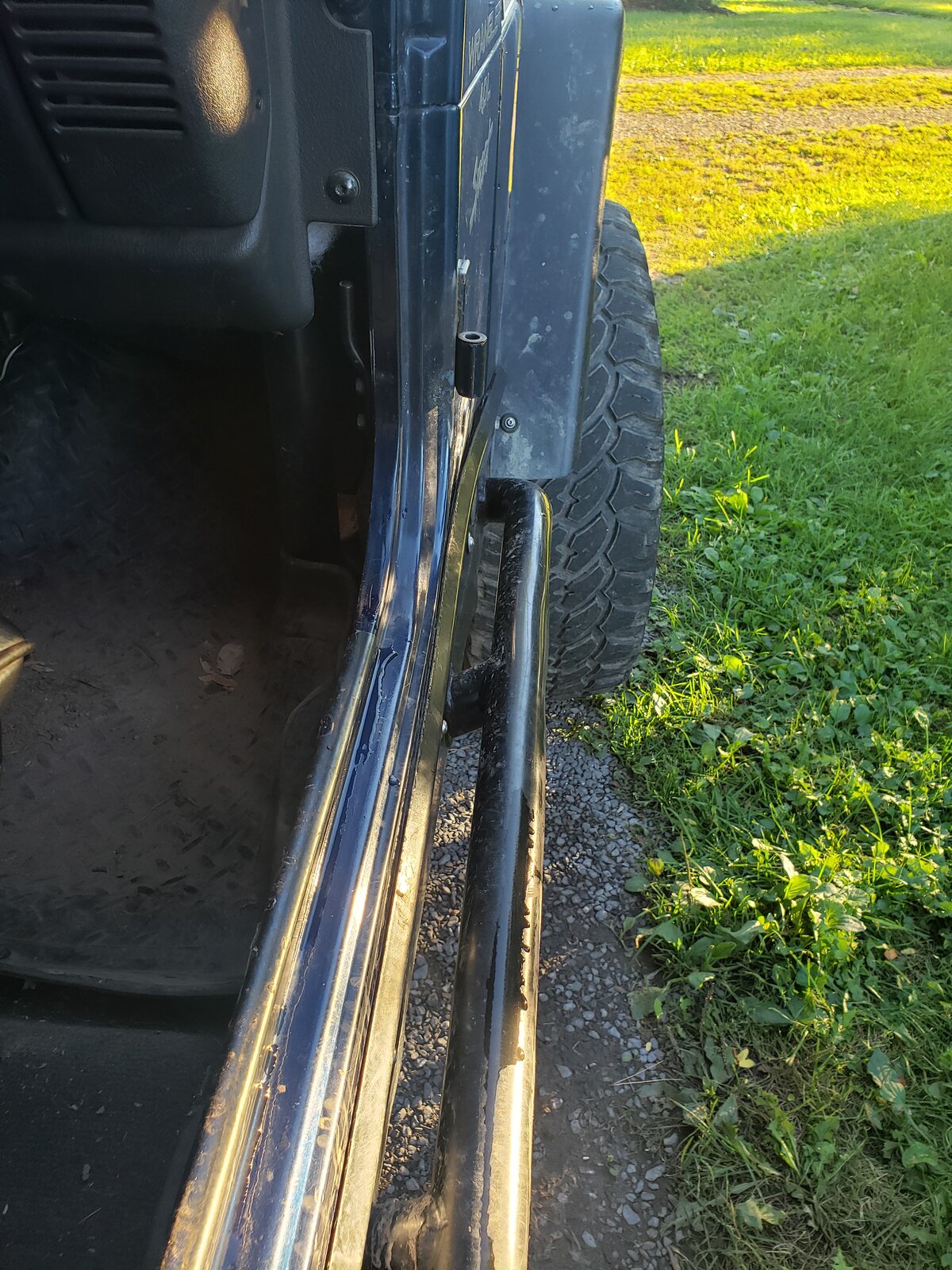

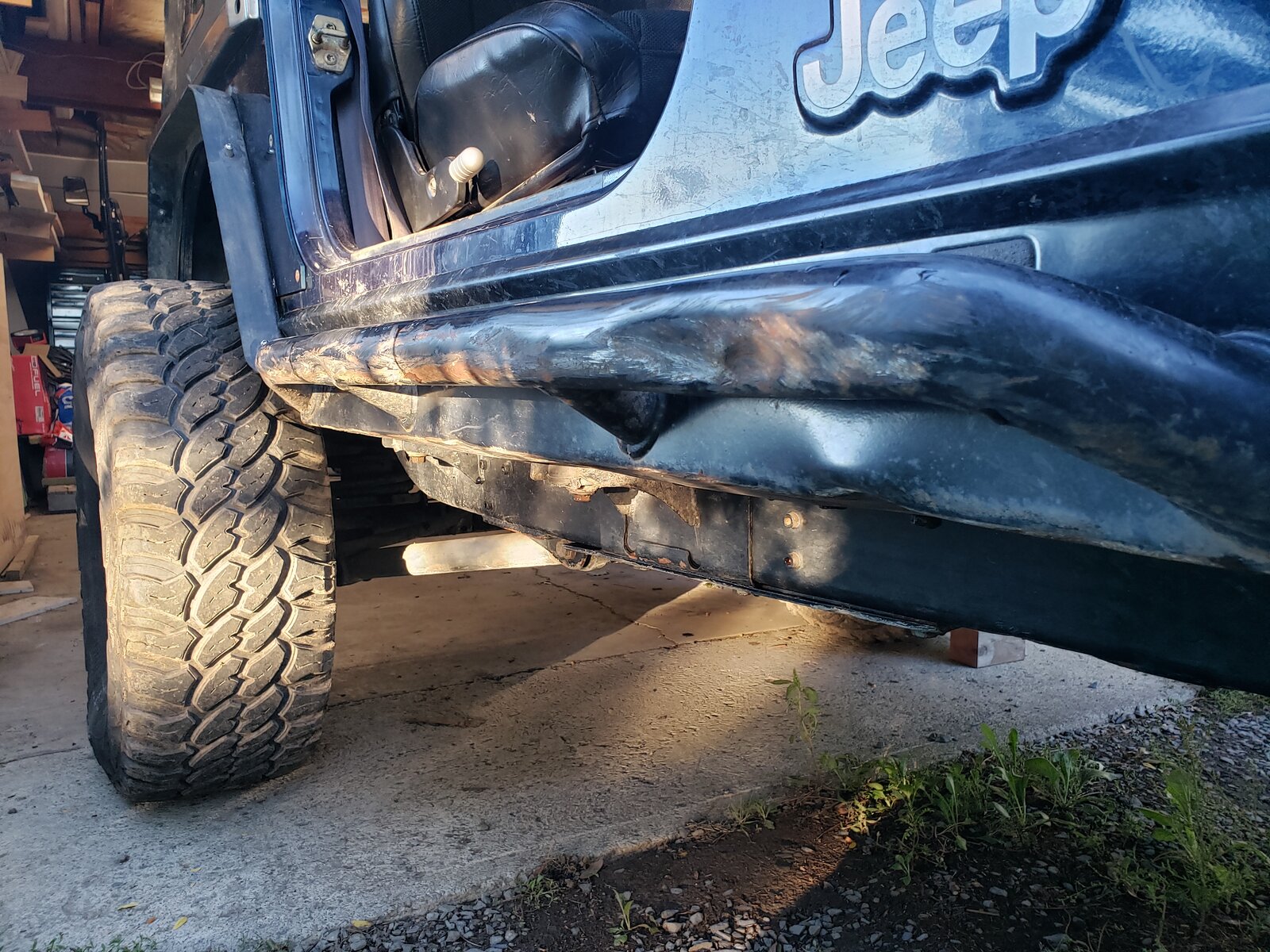

I bought the ARB rockers before Savvy was available. I'll be pulling them to install Savvy rockers. They don't hold up well to actually being used. View attachment 291110View attachment 291111View attachment 291112View attachment 291113
In places like JV, those dents in the tubes will get you hung up on stuff you need to slide them over to make it up an obstacle. I saw lots of tubes like that in JV which is why the Savvy versions don't have tubes and the part that can get damaged like that is replaceable.
