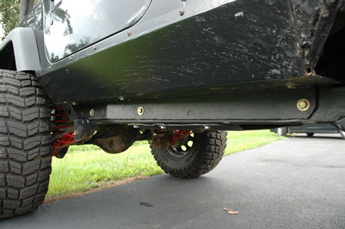

Not one single aspect of using any portion of the body mounts on the TJ or TJ Unlimited is an appropriate mounting system for rock sliders. Not ONE.
I just had 2 more in here like that. One of them had completely collapsed and broken the front body mount frame bracket downward due to the uneven loading.

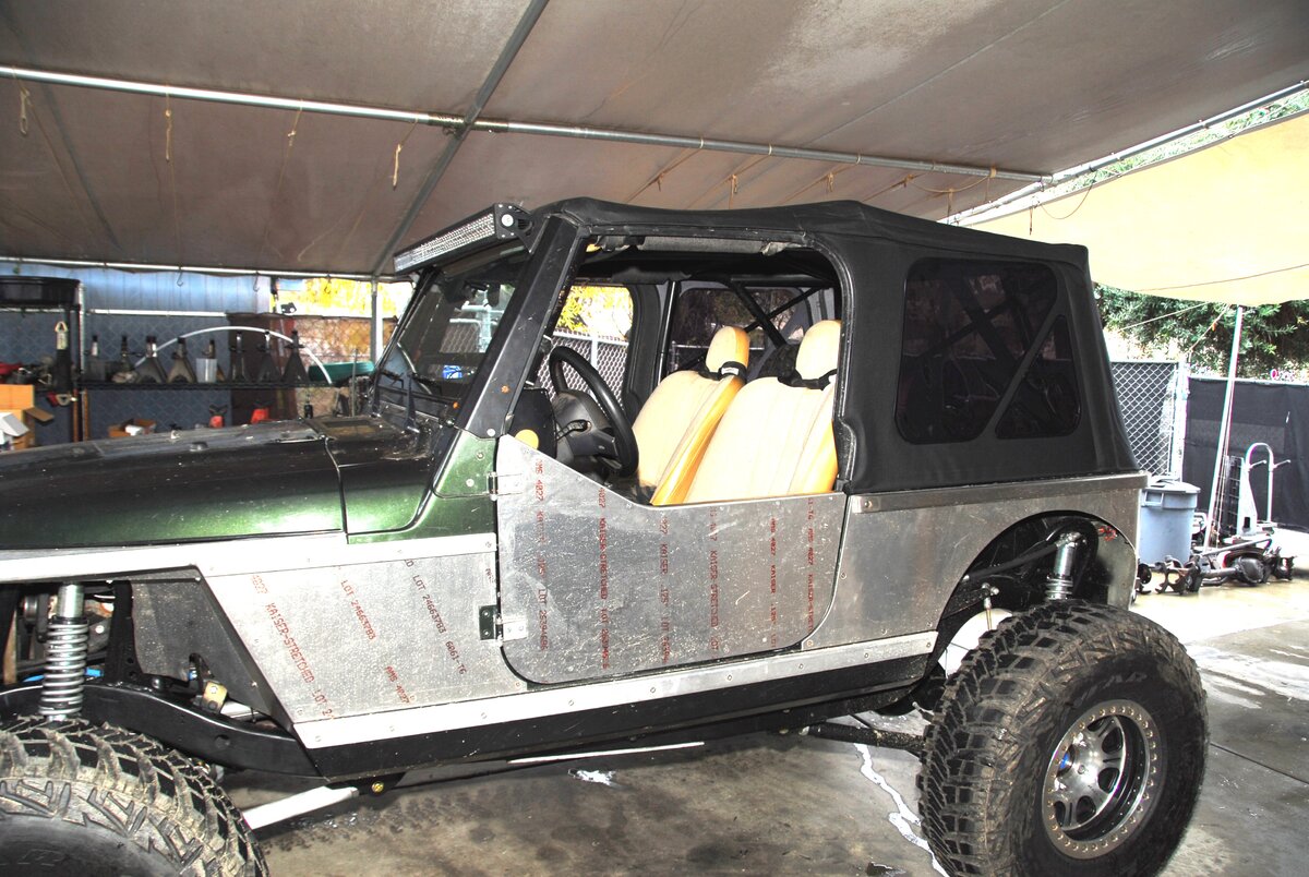

The GR would be much better if they had left them like I designed them and kept that goofy tube step off of them. It makes zero sense to build a high clearance solution for rock rails and then ruin that with a step. So while good, they are not the very best they can be unless you modify them like I did these.
Blaine, What front fenders are those in the picture of the green TJ?
