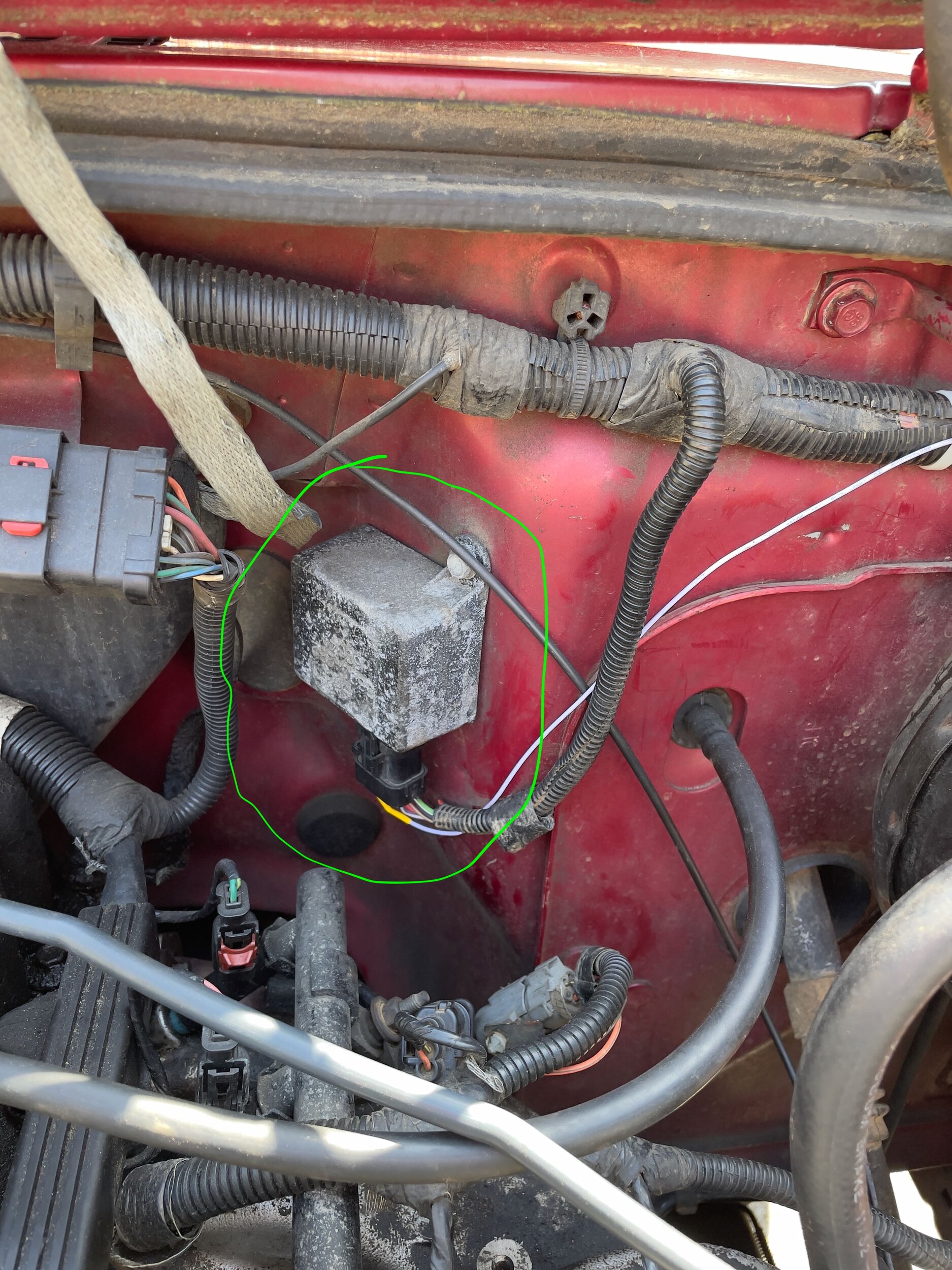

Update on this. Problem Solved!
After more research and studying of the wiring diagram from the Haynes repair manual, I figured this out.
Quick recap:
My '99 TJ was built for the Canadian market. (Confirmed by looking up the build sheet, found by using the link listed in the "How To" section of the forum).
Apparently, the Canadian builds have daytime running lights, controlled via a DRL module mounted on the firewall. (See pic).
The DRL's work by detecting the vehicle moving, then turning on the high beams (at half power, I think). No movement of the headlight switch, they just come on.
This works "fine" with the stock halogen headlights, but when you replace the bulbs with LED's, half power brights, is the same as full power brights. Plus, many LED bulbs do have separate DRL lights/modes that are often enabled by splicing into the parking lights.
I wanted to figure out a way to leverage the same built in DRL module, with the DRL lights in my new LED headlights.
Solution:
Easy. Find the DRL module mounted on your firewall. Unplug the harness and pull back the loom. Find the RED/ORANGE wire. Cut it, and connect the wire to your DRL lights to the side that goes into the connector. Not the side that goes into the harness. Done.
My DRL mode in my LED headlights now automatically come on, and my headlights and brights work normally via the headlight switch.
