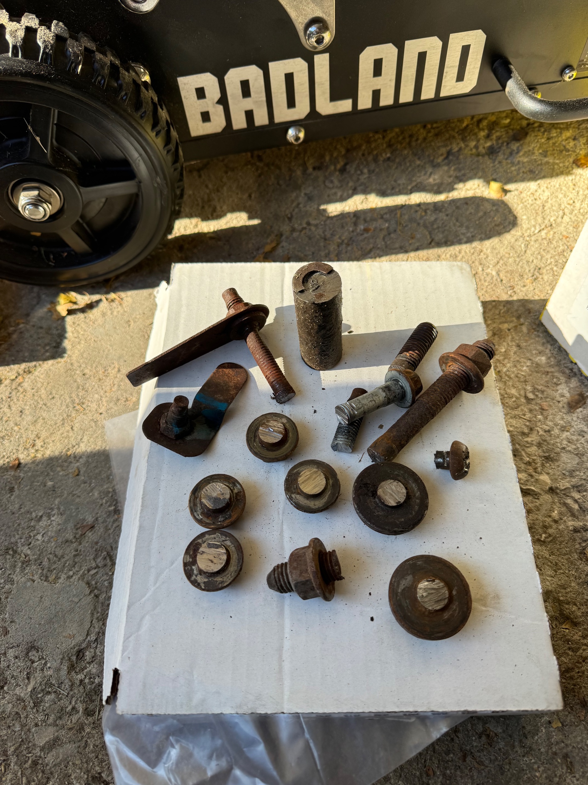

Got the bolt and sleeve cut out. It did require 2 cuts and I can confirm it was a major pain in the ass.

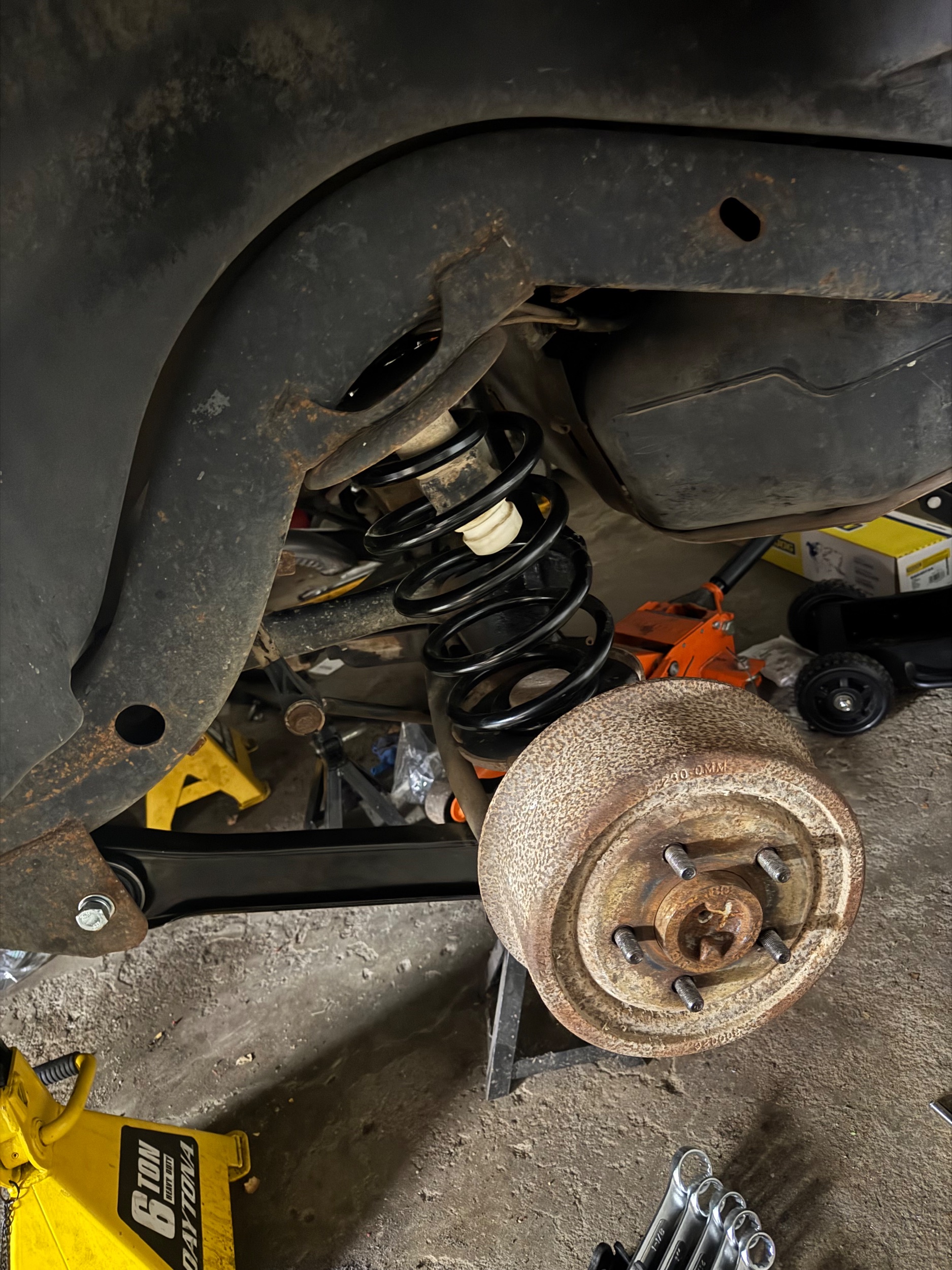

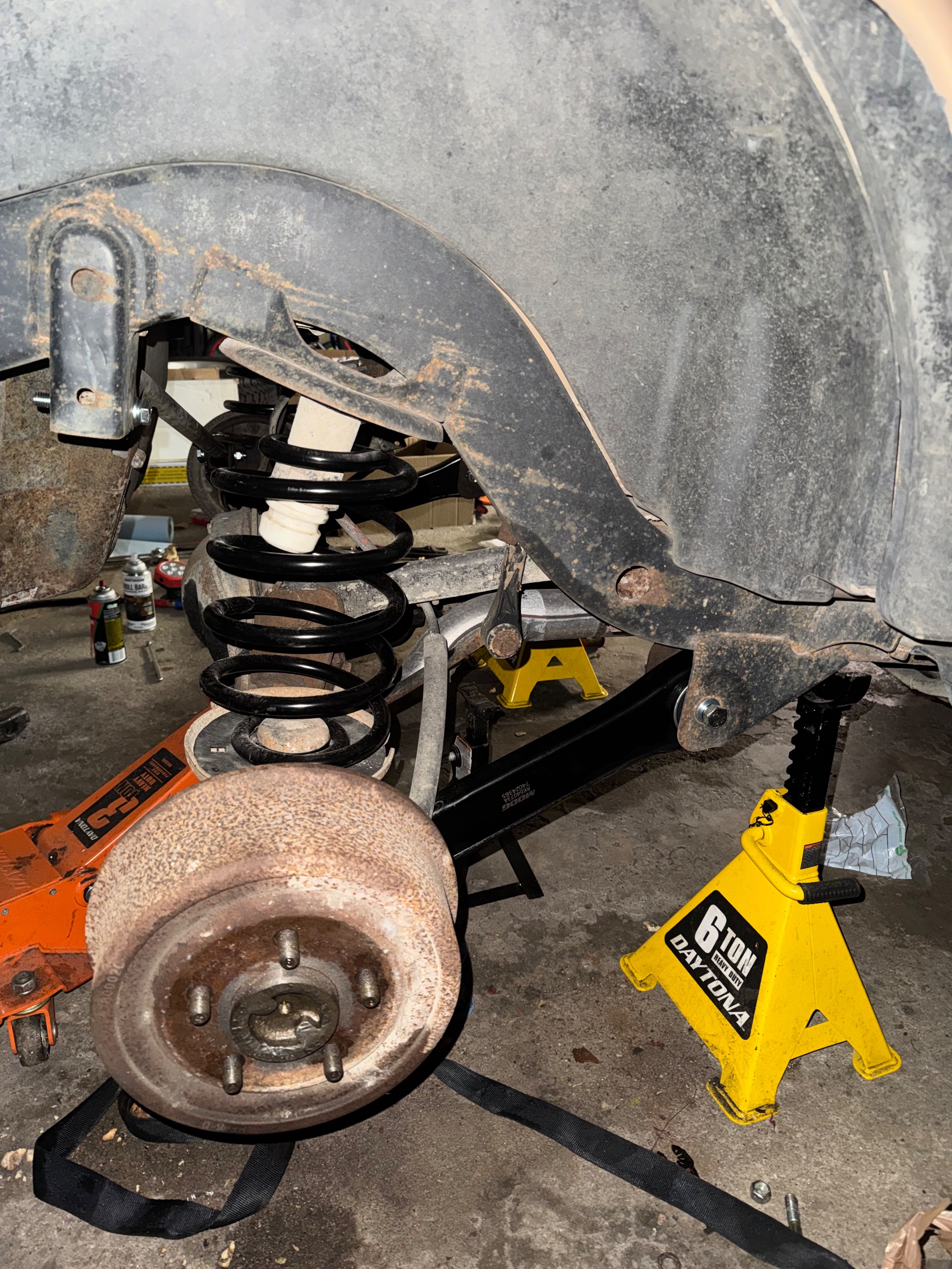

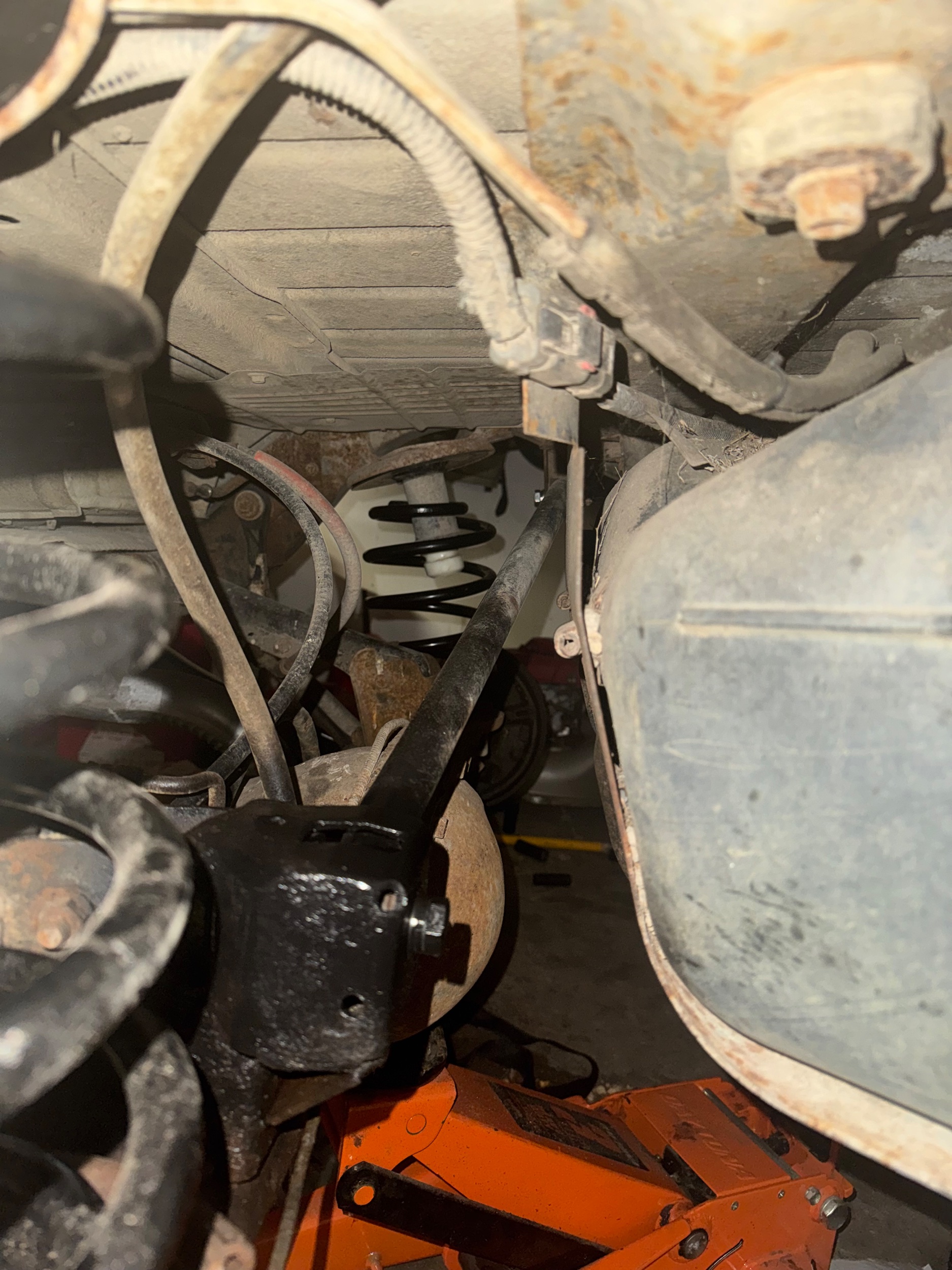

Was able to reuse the stock track bar without damaging it which was great. Everything lined up pretty well. Much less ratcheting than the front axle to get the track bar installed. Need to mount the shocks tonight and then put it back on the ground to do final torque on all the bolts.
The captive nuts on my pass side rear shock mount are… no longer captive. Previous owner just used nut and bolt in the existing holes. I’m hoping it all goes back together well using the same strategy but I’ve learned to not be optimistic.
Passenger side seems to have a newer hub or at least it’s shinier you can see the difference in the pictures. Not sure what that indicates as far as history. But it also has the back side of the drum coated in fluid not wet to the touch but definitely there. I suspect a seal leak on that side but it’s not my focus right now.

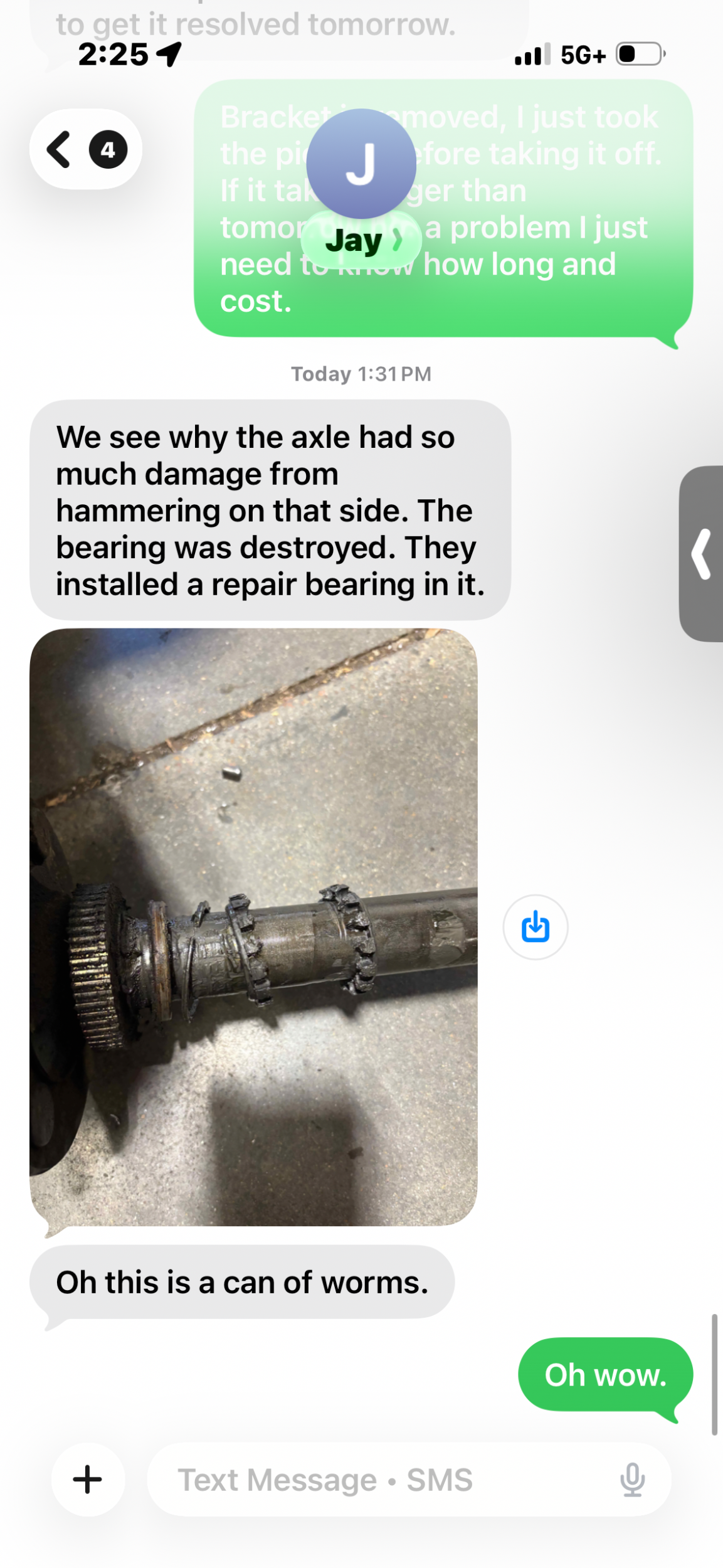

Took the Jeep in to Stomper Offroad a local Jeep shop to get the final alignment, weld that cracked rear track bar bracket, and quote me the rear brake leak fix while it’s in.
They got back to me that the rear brake leak was a mix of brake fluid and GL5 which meant my rear axle was leaking (which I feared). Turned out I didn’t have a “new” axle on the passenger side like I thought from the lack of rust. Apparently previous over just beat all the rust off of it with a hammer while trying to repair either the seal or bearing… Picture of my texts with shop owner.
Had them replace the passenger axle shaft, repair the damage to the axle tube and replace the seal and bearing.
