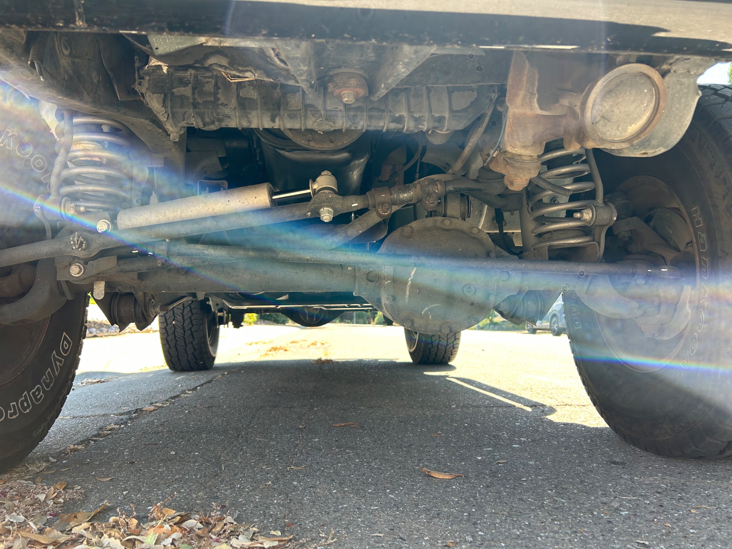

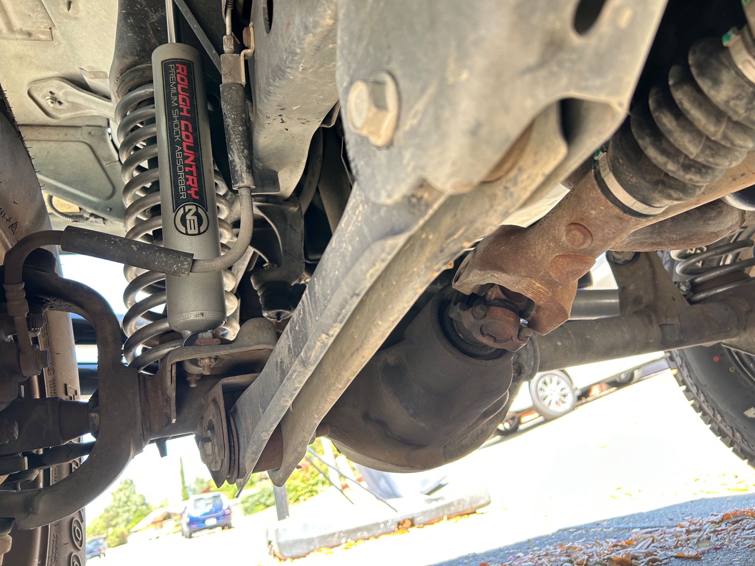

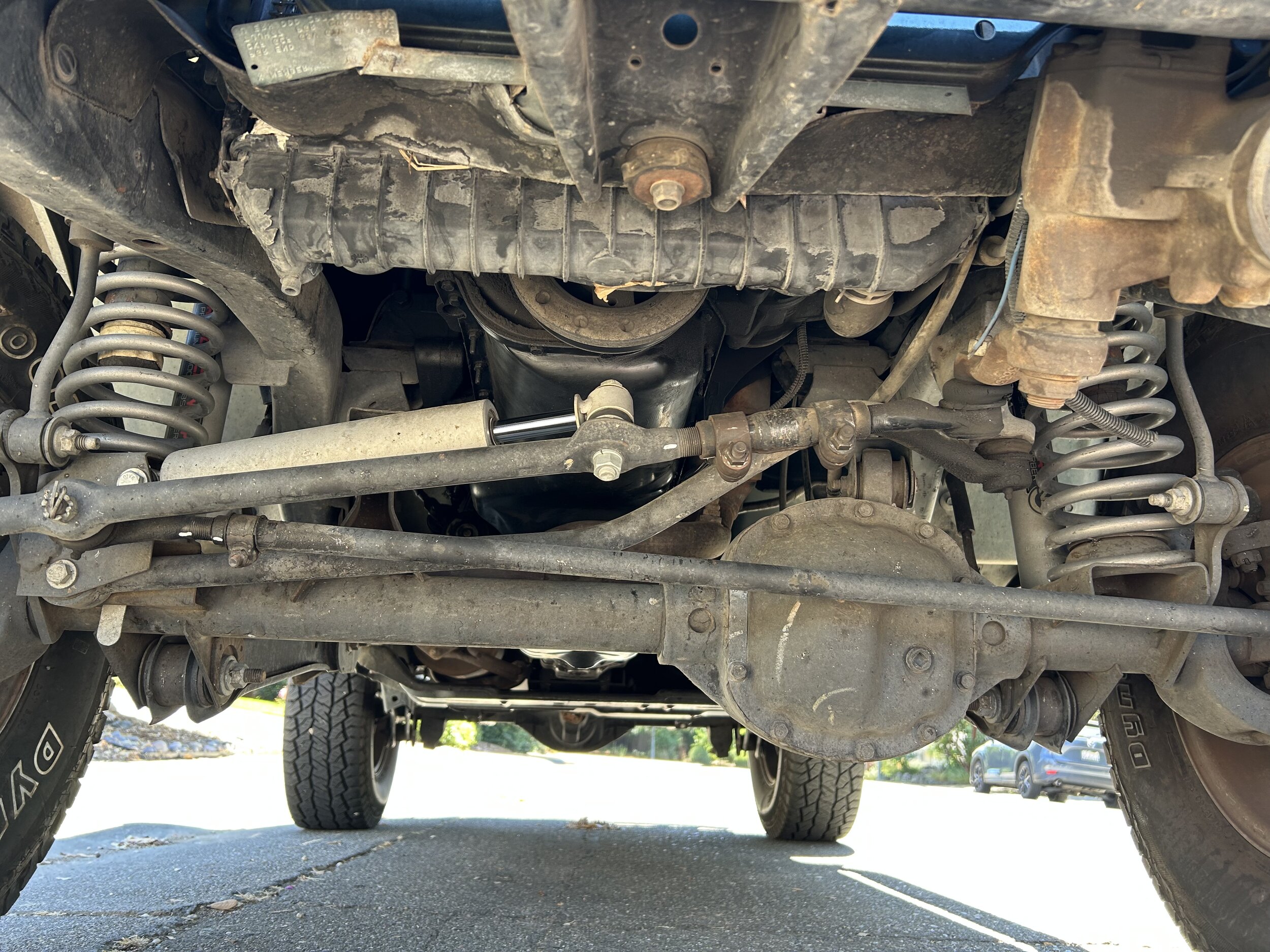

pics of what you have would help.
Yes it can be as simple as 2" shocks and springs depending on what other rough country junk is installed
Thanks! I should have added pics to begin with.

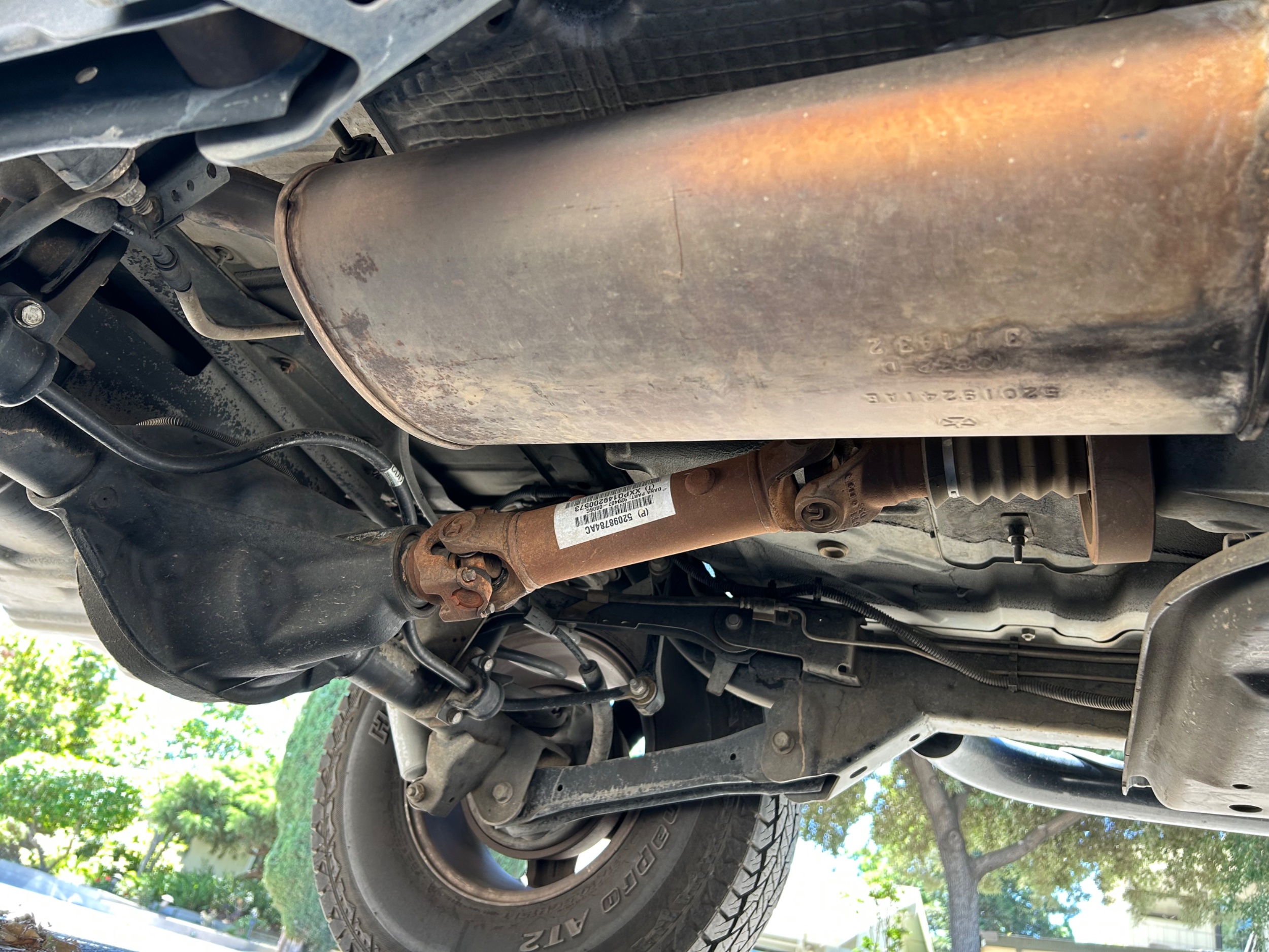

Replace the shocks, coil springs, remove the transfer case drop (if installed), and do an alignment. Doesn't look to me like the front track bar was relocated so that's one less step.
This is really helpful, thank you. It does not appear that the transfer case drop was installed.

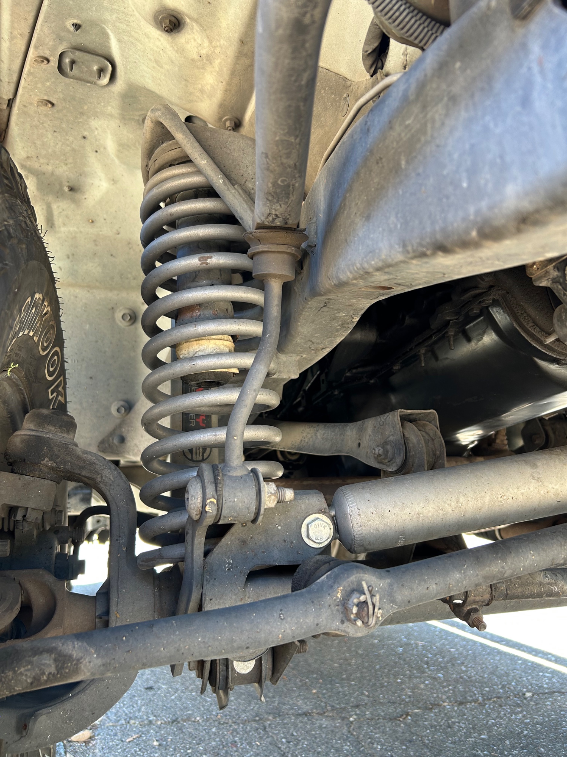

I'm only seeing factory isolators in front and no spacers in back

The factory rubber spacer in the front belongs there. What do the springs measure at ride height? Stock is 12" and 8"
