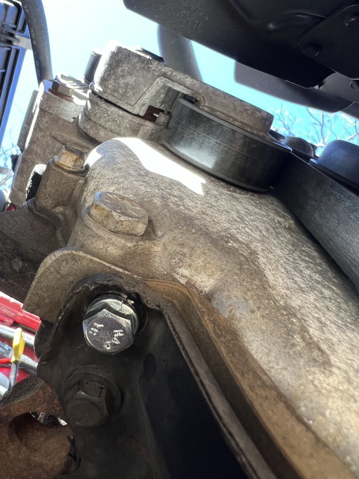

One last try before I give up and bring it in for the RMS and oil pan. Got my 1/4 to 3/8 adapter, so I cleaned everything off again, tightened a number of oil pan bolts I had left too loose since I was worried about over tightening without my IN LB torque wrench, found out the PO had stripped one of the front oil pan bolts in the timing cover, got that replaced, tightened the valve cover to the correct spec, and now it’s wait and see.
One week update post torque check on the new VC gasket, I think this is success.

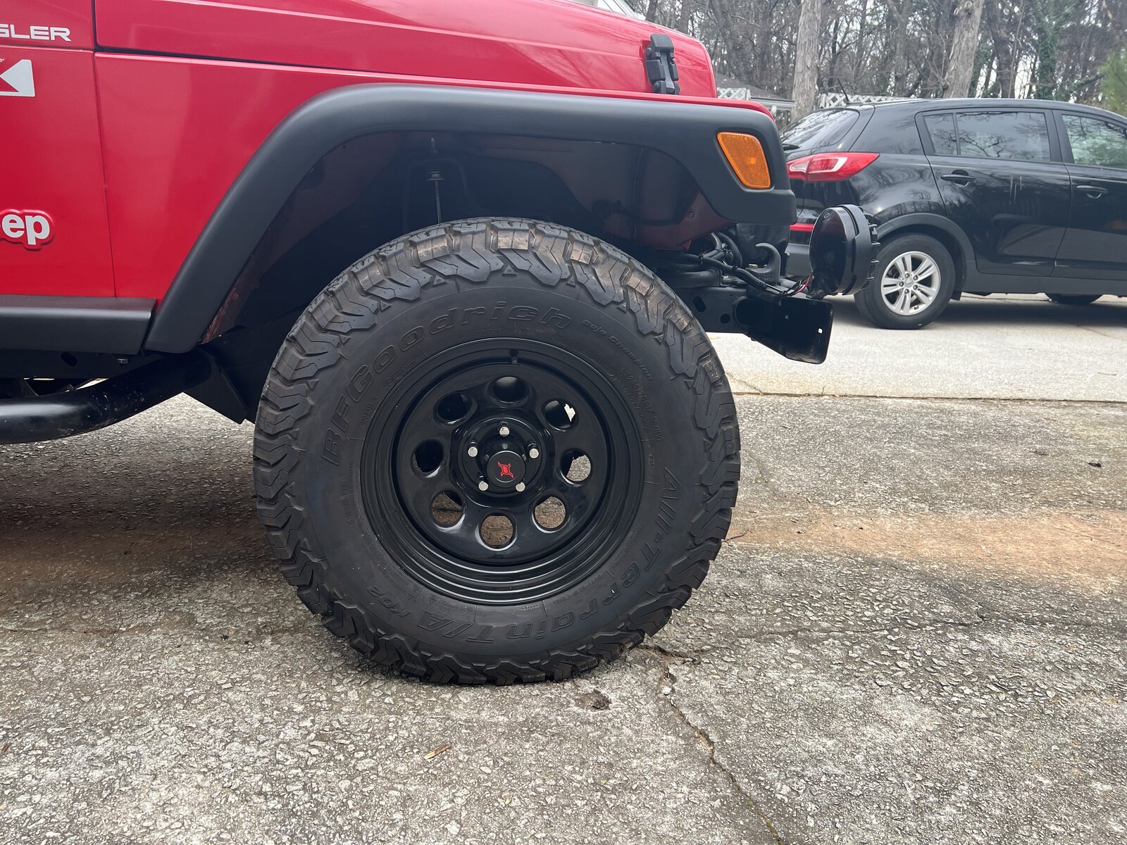

Ordered the 1in aluminum body lift.

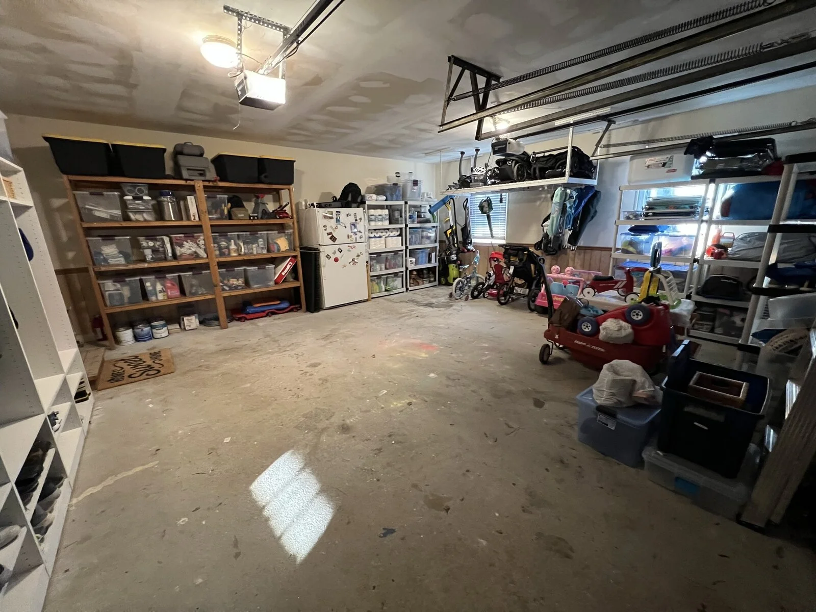

Bonus shot of finally getting my garage back in order now that the lift parts are actually on the Jeep.

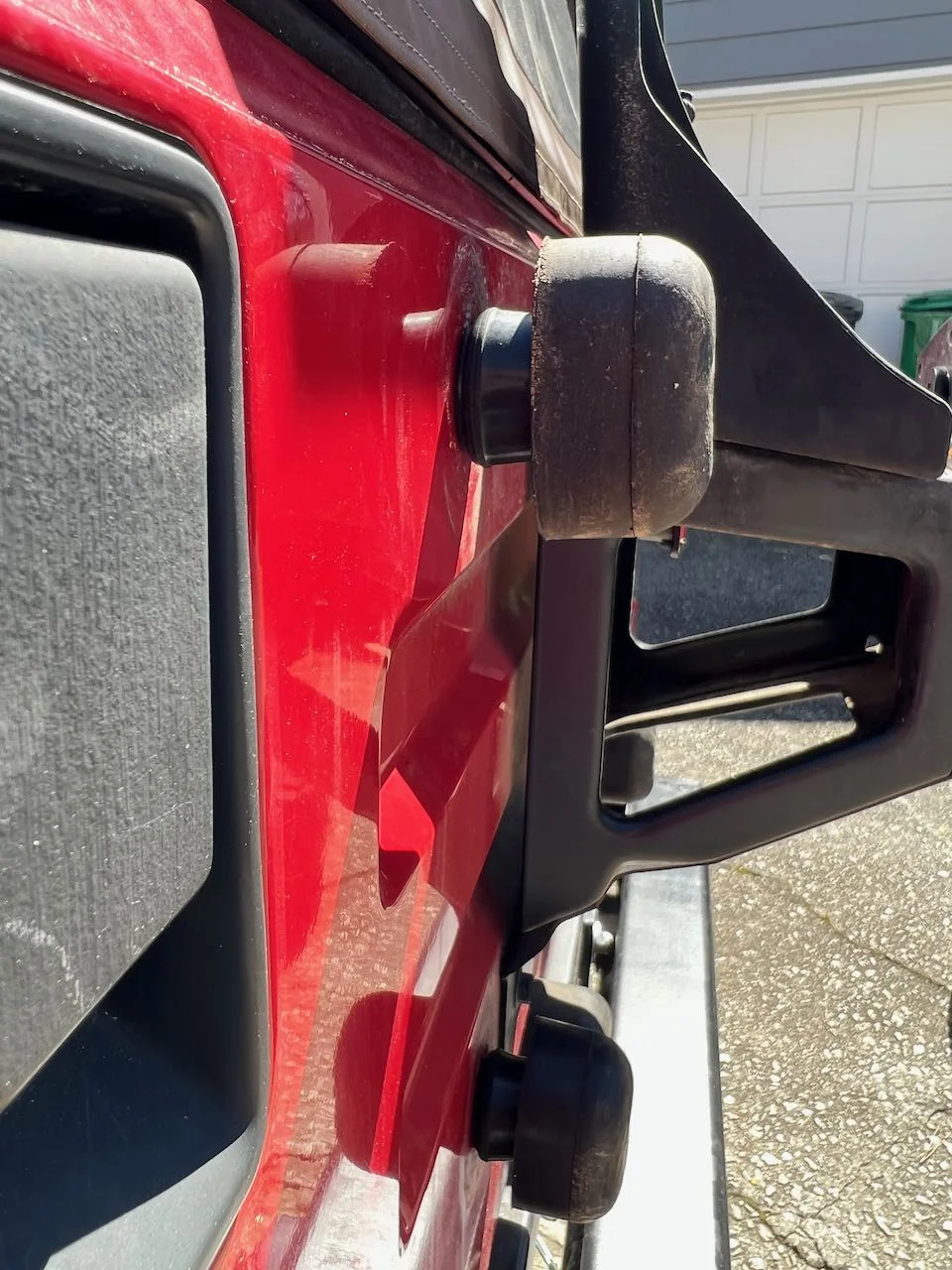

BL and impact wrench delivered and picked up a pair of HF rubber mallets so I can extend the spare tire snubbers. Just need a break in the weather so I can get it installed.

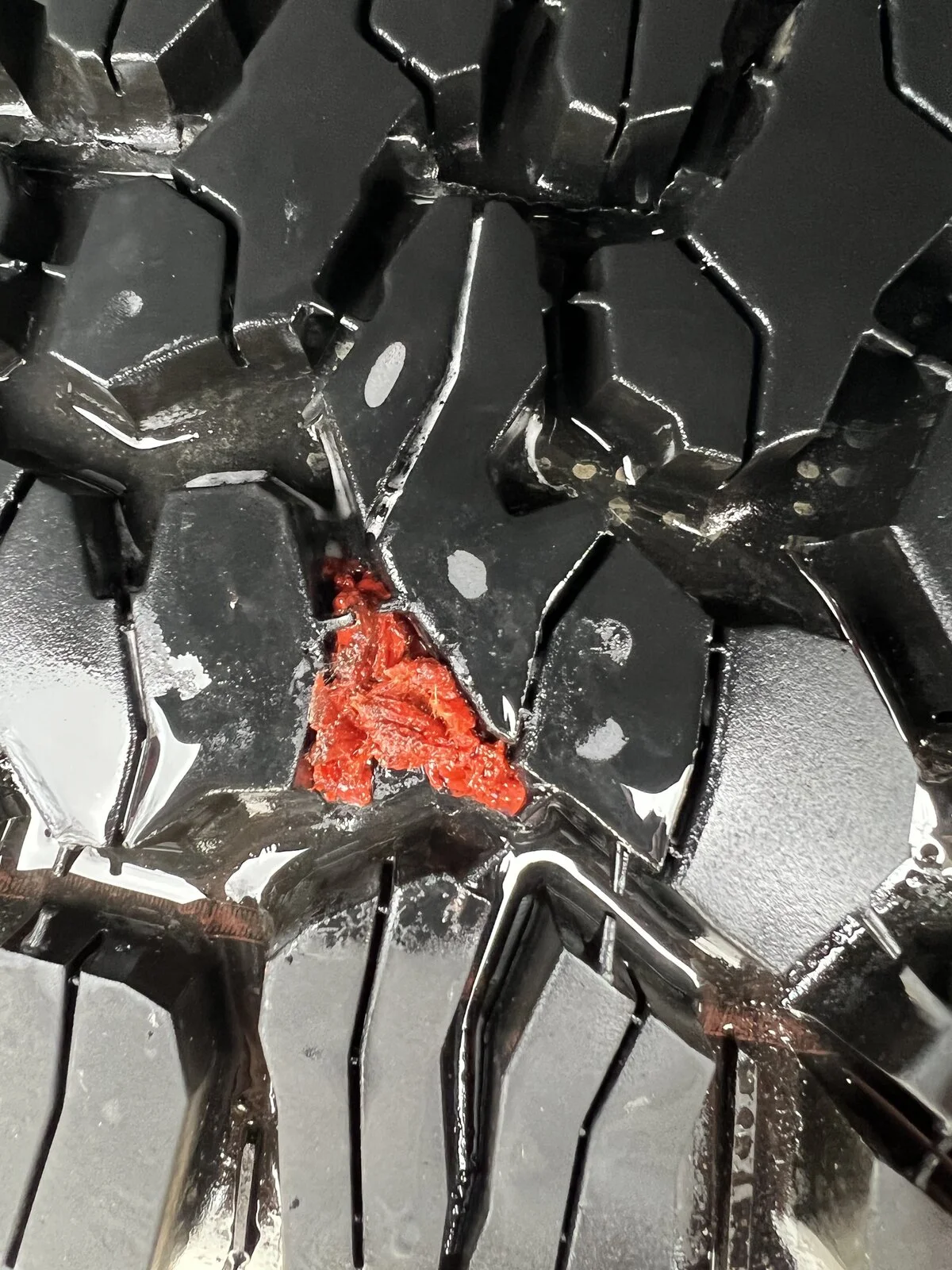

Plugged my new KO2 and after blowing my cig fuse trying to inflate it was a good excuse to upgrade to a VIAIR 88P

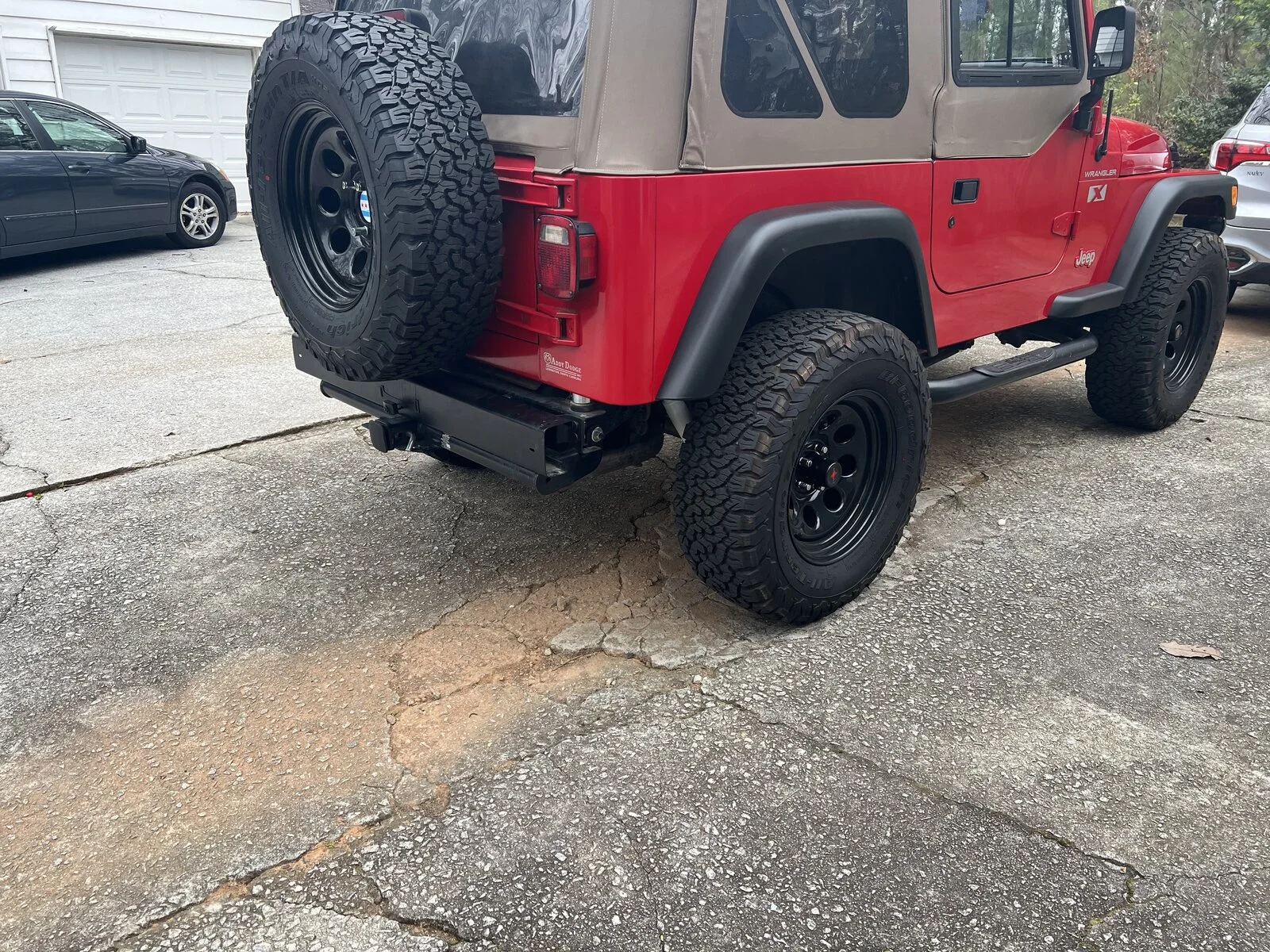

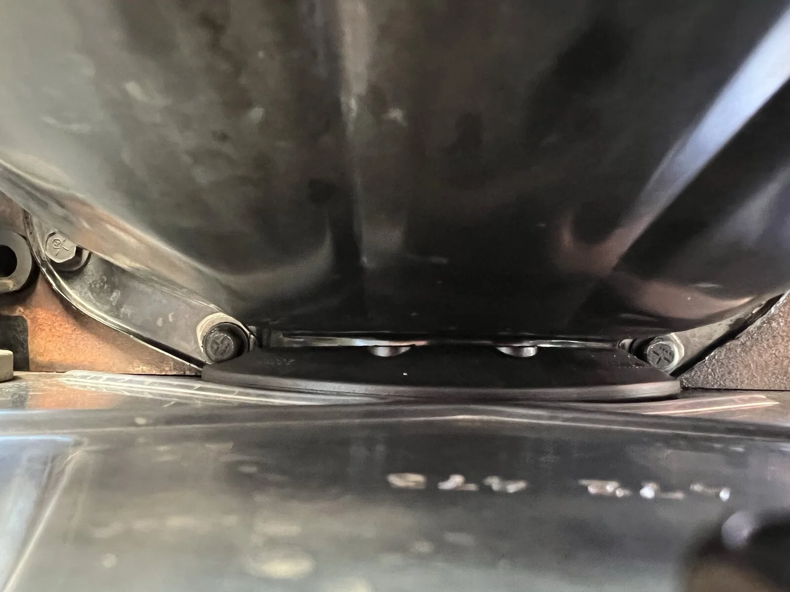

Body lift kicked my ass. It’s not hard but no one talks about what a pain it is to drill the lower holes in the fan shroud or to make sure you raise the body in the rear corners, higher than you expect to get in those pucks, or to make sure you use a long screwdriver to line up the floating nuts.
On the plus side, impact wrench plus southern living means no issues with any bolts and looks like I got away without having to mess with the shift bezel or do a tcase bracket drop.
Tomorrow I’ve got to be in the office which means chopping up my rubber mallets for tire snubbers will be later in the week.

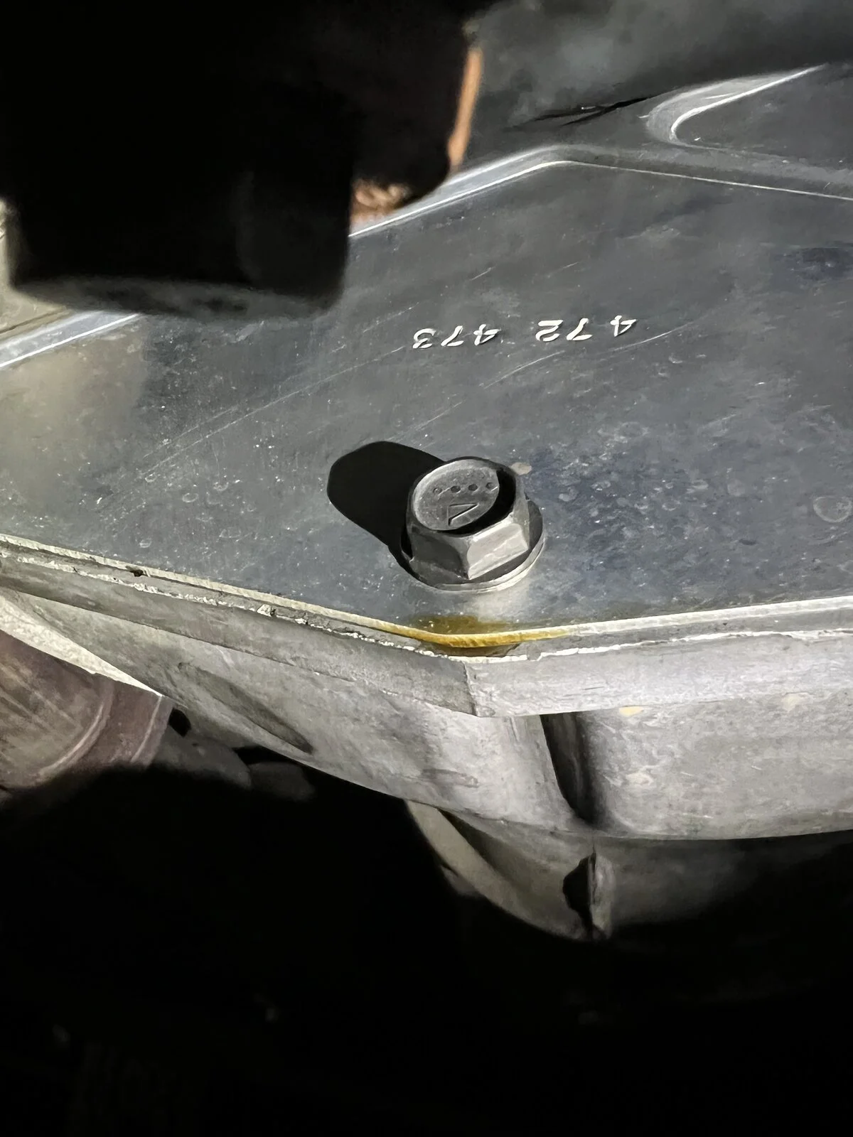

So much for my RMS victory. Was re-checking bolts after the BL and this is ~two weeks of accumulation.
I’m generally not a fan of leaks, but the thought of doing it solo or paying $7-800 before it actually hits the ground isn’t appealing

  1. I took the fan shroud short cut when I did the BL and was only able to get 3 of the 4 bolts back on. While the fan spins freely, makes me a bit nervous on a long trip. It’s also not level by a good inch…

  5. Would like to get a good drive in to sanity check the plug I had to put in my BRAND NEW KO2

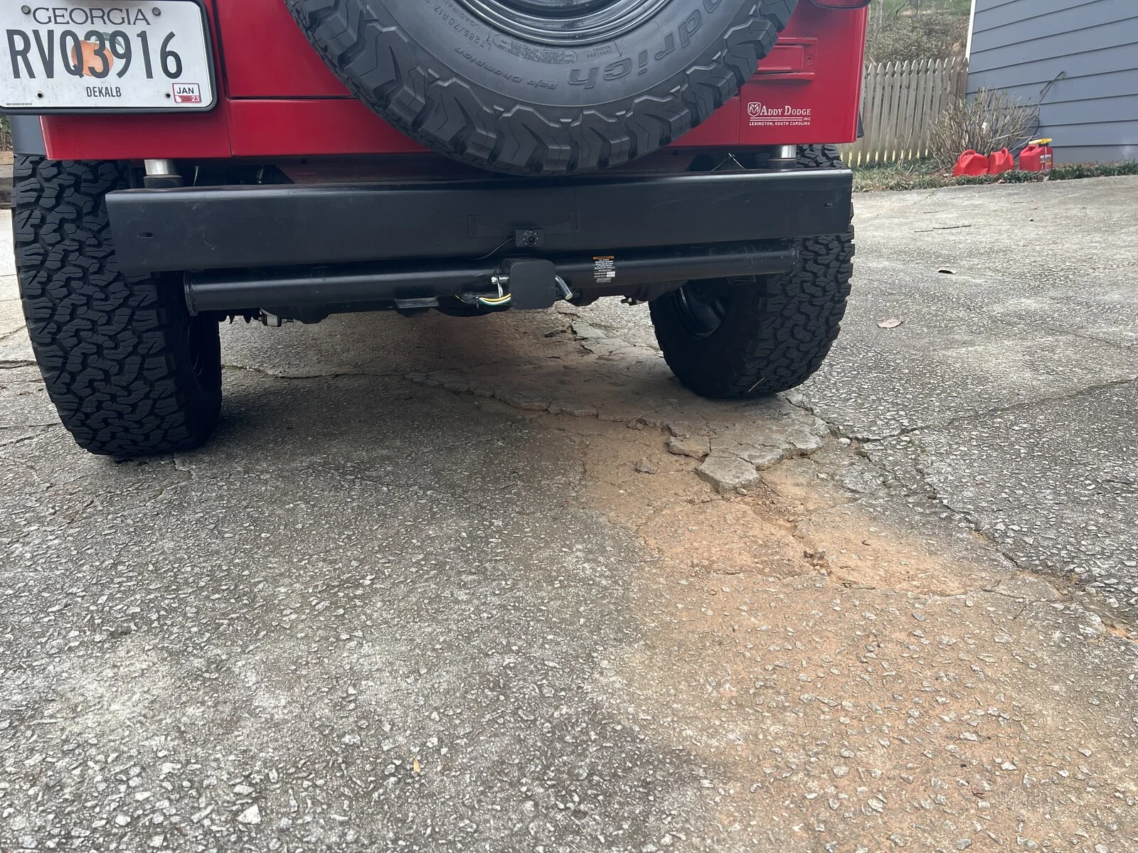

For the cargo carrier, I’ll probably end up with the HF one. There’s a thread somewhere where people said it was decent. I’ve got the Quadratec 2in hitch with frame tie ins. For what I do, it was worth losing the departure angle to run the hitch accessories like bike rack, cargo, and recovery shackle.

extended snubbers for the spare
