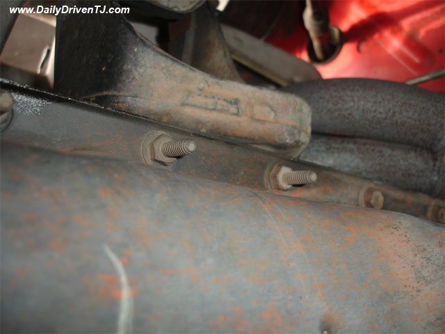

1. Remove the oxygen sensor from the down pipe. Remove the bolts and nuts holding the down pipe to the header. You will have to move the pipe around so that you can lower the oil pan later.

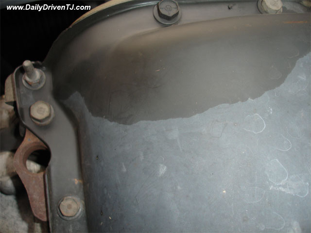

3. Chrysler used different sized bolts to hold the oil pan to the engine block. I think they used 1/2 inch and another size. I took several pictures of the bolts and where they are located so I don't I have to remember them where they go back. Here they are, for your reference. Start removing them and put them in a safe place.
View attachment 2562 View attachment 2563 View attachment 2564 View attachment 2565 View attachment 2566 View attachment 2567

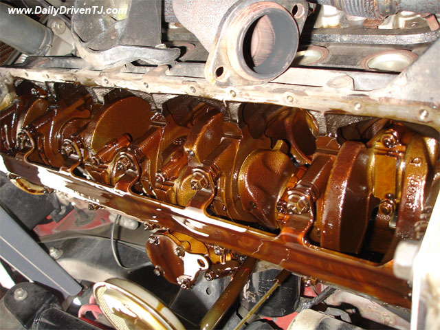

4. Once the oil pan is out of the Jeep, this is what it looks like. Your engine may look different with less brown. My Jeep is 10 years old, JFYI.
5. Remove the main bearing cap brace by removing 12 bolts. This is the long stick shown in the following picture.
6. With the main bearing cap brace removed, remove the rear main bearing cap.

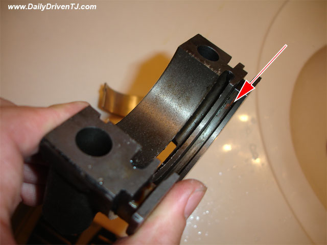

7. Remove the top half of the seal by driving it out of the block. Use extreme caution not to score/dent/scratch anywhere. One small nick or scratch can cause leak and is no longer repairable. As you remove the seal, note the orientation of the seal. The seal is opening towards the front of the vehicle.
View attachment 2574 View attachment 2575 View attachment 2576
Here is what they look like removed from the engine. The top half and the bottom half is shown here.
View attachment 2577 View attachment 2578
Notice how the old seal has lost its shape. *Blue residue shown on the new seal is wheel bearing grease.

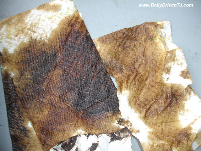

Clean the engine block where the bearing cap mates against free of any residue whatsoever! This cannot be stressed enough! Clean ANY mating surface ABSOLUTELY free of any old sealant and any type of residue!! Remember you have to do this WITHOUT damaging/scoring the metal!
This is a picture of two pieces of paper towels. Left one is used to absorb the oil from the bottom of the oil pan. The one on the right is virgin oil. There was considerable amount of solid stuck on the bottom of the oil pan.

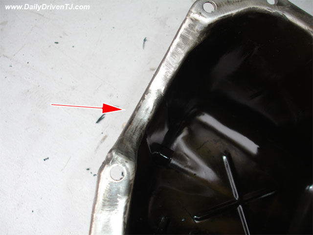

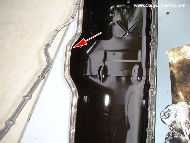

9. Start cleaning the oil pan. Remove the old gasket and clean the mating surface with mild wire wheel. I cleaned the surface with paint prepping agent once again. this gets rid of any oil residues left behind.
Here is how they should look after you are done cleaning.
View attachment 2590 View attachment 2591

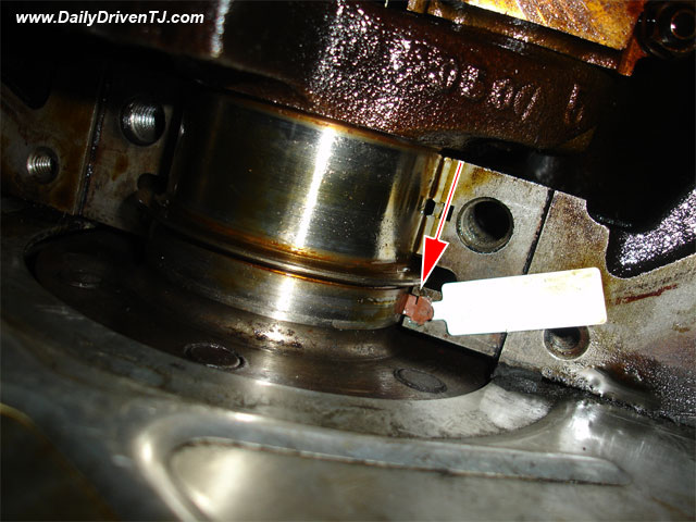

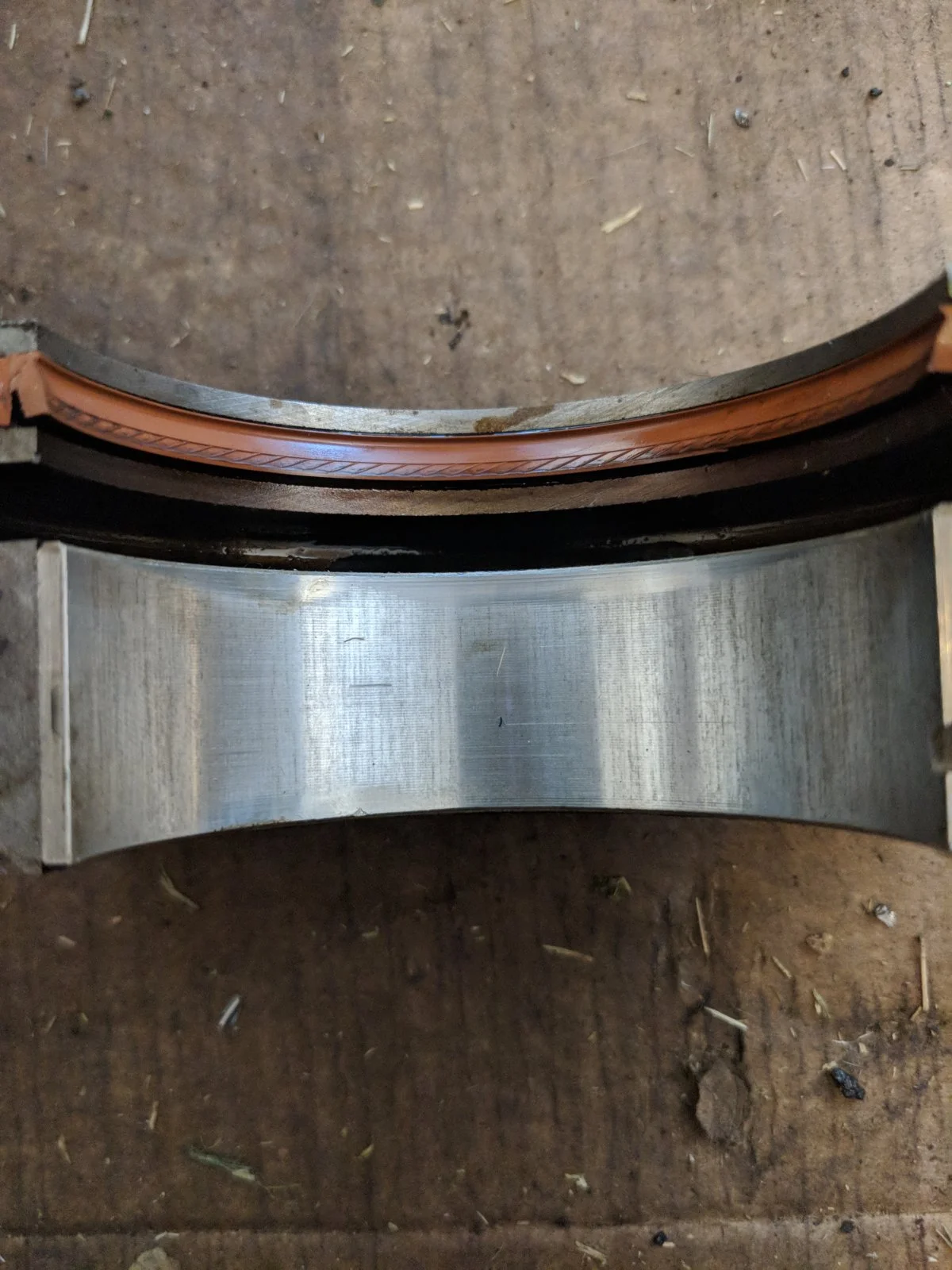

10. Install the upper half of the seal after lubing with some engine oil. DO NOT PUT ANY SEALANT ON THIS SEAL! With the seal's lip opening towards the front of the vehicle.

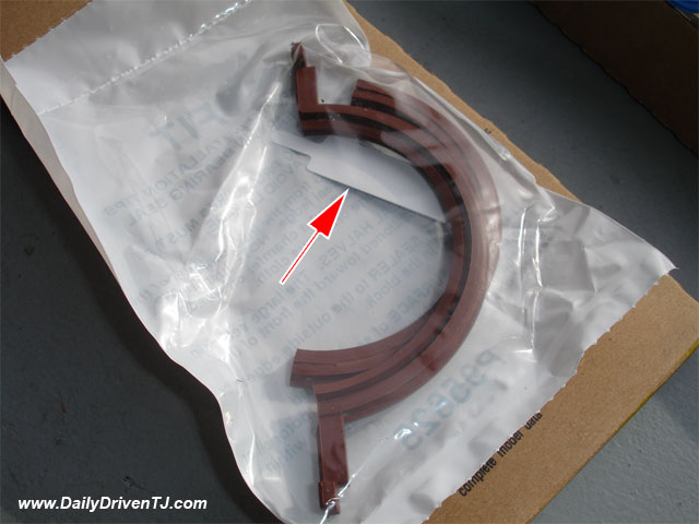

*Here is one crucial detail that every online write up fails to emphasize. As you push in the upper half of the seal, if you do not follow (as you push the seal) the circle channel carefully, you will cut the seal and this will guarantee the rear main seal to leak again.
So how do you install the upper seal without cutting it up? Fel-Pro included this nifty thin plastic that you wedge between the channel and the seal to keep it from getting cut. *I saw the same seal kit that included this plastic piece, and some did not. Your mileage may vary.
View attachment 2592 View attachment 2594 View attachment 2595 View attachment 2596
Notice the orientation of the seal where the mouth of the seal opens toward the front of the vehicle. Once seal is in place, simply pull the plastic out.

14. Place the oil pan gasket on the pan. I used RTV on the crucial area at the front of the block and where the rear bearing cap. I can use RTV here, because this is to seal something that is not moving against anything. Notice that I used RTV on both the top and the bottom of the oil pan gasket. *MAKE SURE YOU CLEAN THE MATING SURFACE OF THE ENGINE BLOCK FREE OF ANY SEALANT AND OILY RESIDUE! I used paint prepping solvent to clean the surface.
View attachment 2603 View attachment 2604 View attachment 2605 View attachment 2606 View attachment 2607
15. Install the oil pan but while doing so make sure the rear main bearing cap's groove lines up with the oil pan gasket. Also pay particular attention to gasket on the front of the engine. It has built in grooves that has to sit just right. Tighten all the bolts and nuts to 12ft.lbs.

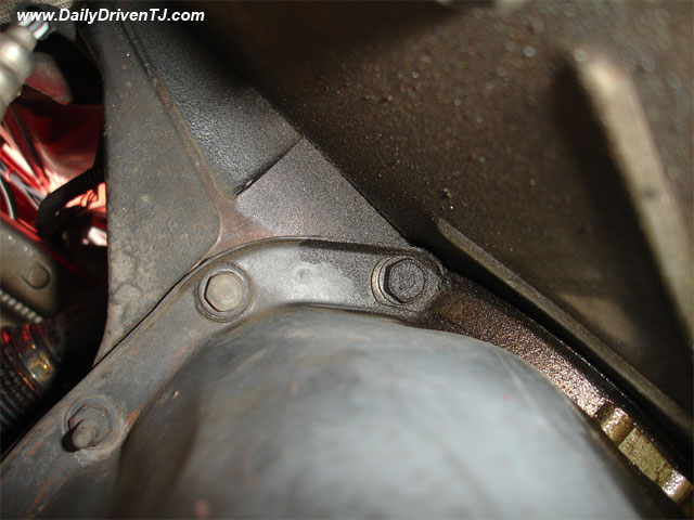

My main question was does the starter also have to be dropped? as that is not mentioned in most of the write ups I have seen.
We don't drop the starter as a matter of course unless it is in the way of something. I don't think it has to be out of the way for the oil pan to come down.

I'm starting to think it has something to do with the different seals that were used.
There is the one with the flange on the bottom half and the one without a flange.
The seal that I removed did not have a flange, nor did the new one that I put in so maybe that aint the problem....
I did not damage the seal when I installed it.
That's because there are two rear main seals, one for earlier model 4.0s and one for later models (as mentioned in the original post):
Now I can't actually comment on this first hand as I've never worked on an earlier model TJ, but it seems to make sense.
The 2000-2006 model rear main seal in the original post is the same one you just linked to in your post.
I believe this could become a source of confusion for someone trying to do this.
