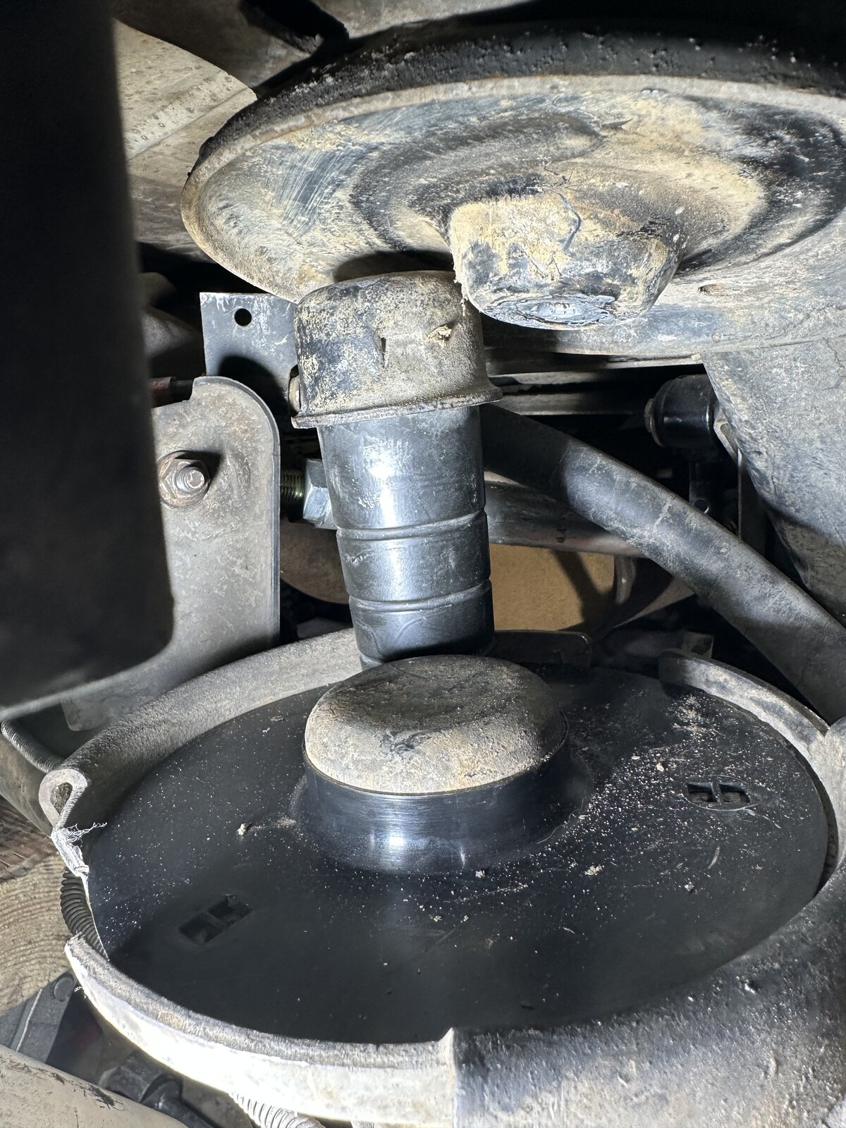

I'm about 4 inches below the shock mount at full compression with the shock.......no bump stop in....I have extended stops that measure 5 inches long....... you're a guru any help would be appreciated
Ditch the mount extension brackets, bolt up the shock, stuff the suspension until the shocks bottom and measure the gap between the end of the cup and the lower pad. Get back to us with the measurement and we can help you figure out if your shocks are actually too long.
Don't just decide you're done and take it for a drive though, because once you know what shocks you're using you'll need to clearance the back of the spring perch so they don't destroy the shocks the first time you droop it.
We disco the shocks, jack stands under frame. Lower axle until you can push the shock forward and line it up in the mount, clearance perch + some for articulation until you can get the shock in the mount with the bolt installed.

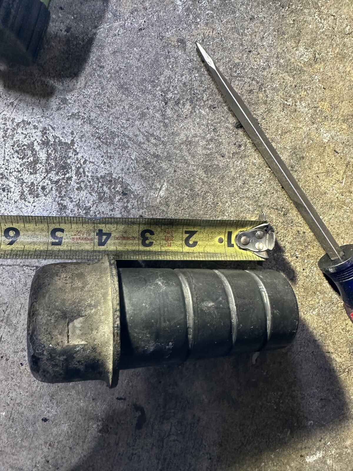

Ok got results.... I think.....fully compressed the rear shocks....I have 4 inches of space between the pads.....cup removed....my cup and bump stop are about 5 1/4 long....shock shaft is 9 1/4 long fully extended. (5000x's)..... Where to go from here?
