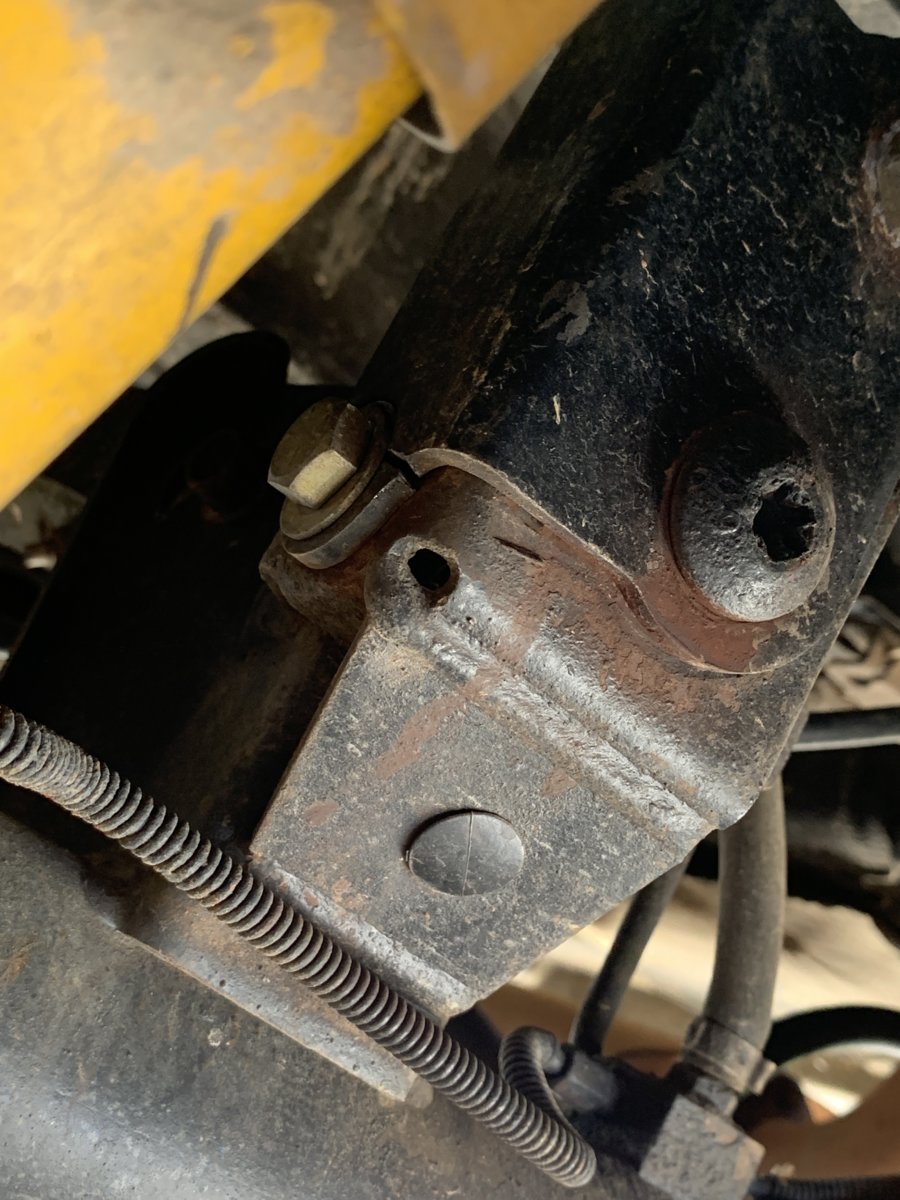

In the meantime, I discovered this as I was underneath... how big of a deal is that cracked bracket?
Pretty common. Let me dig them out and I will get back to you. That crack is in the trackbar relocation bracket. They are about 25 bucks. I'd replace it.

When jacked up, that bracket really separated. You could push my back end about 4-5 inches.
