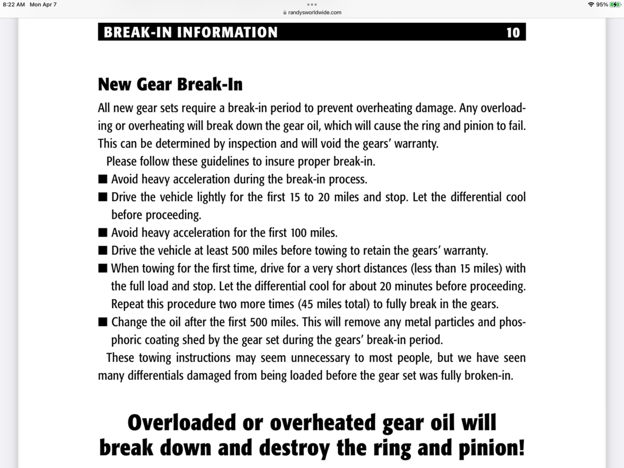

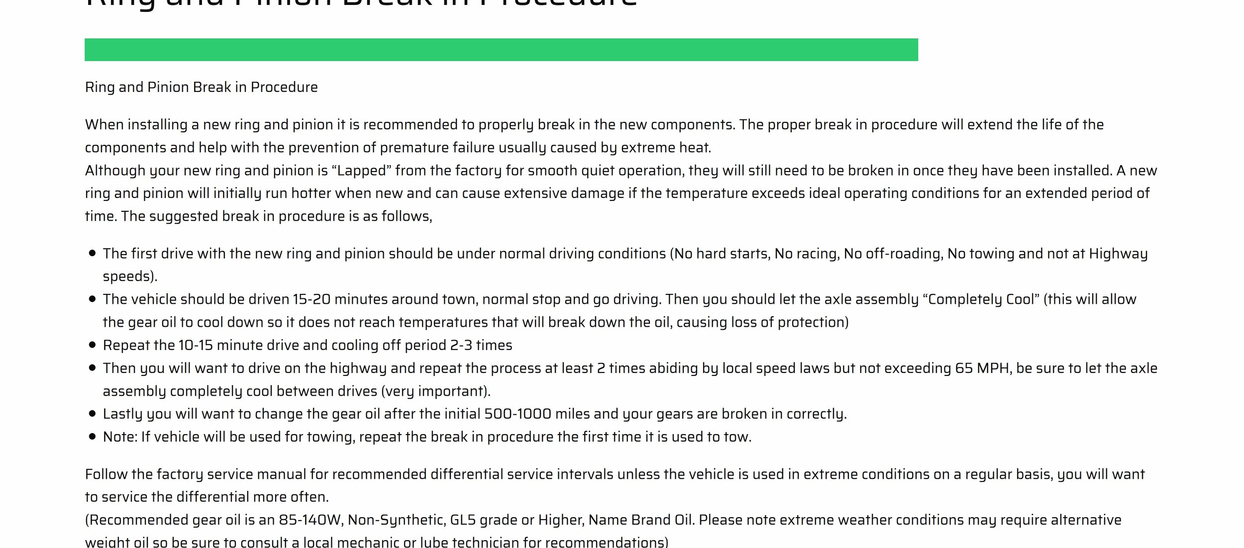

The Revolution Gear break in process requires a number of short drives at low speed, with the need to let the differential cool in between. I will need to do this as part of my drive home. However, I have been unable to find any info on how long I need to let the differential cool for. I understand this may depend on a number of factors, so my plan is to go no faster than 35mph for the first few 20 mile stints and to allow time to cool between. Forecast says temperature will be about 60 degs in the UK tomorrow. Any rough indication of how long I need to stop to allow the differential to cool would be much appreciated.
My guy told me his standard break in process is 5, 15 minute drives at 55mph, with 45 minutes of cool down, then changing the fluid after 500 miles.
