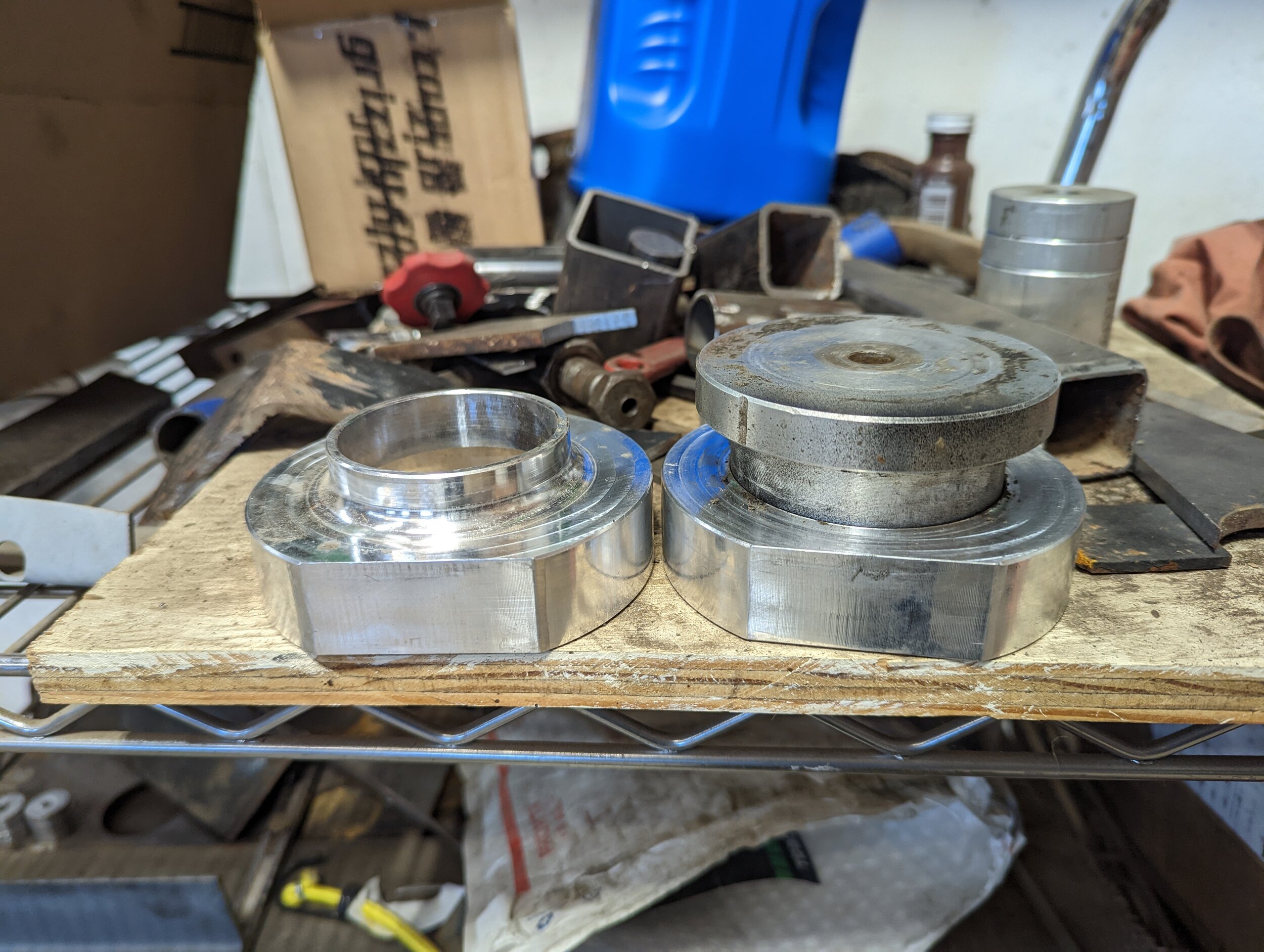

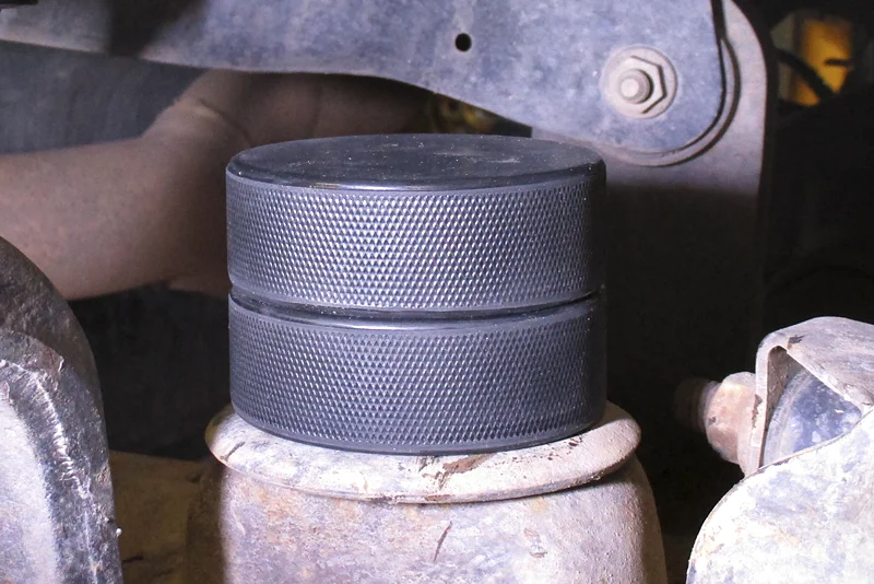

The pucks are not hockey pucks - they are components of this kit:
https://metalcloak.com/universal-adjustable-bump-stop-system-1-4.html Not sure how much better they are than hockey pucks, but I guess I'll find out.
If I use that aluminum spacer, I just put it between the cup and the upper perch?

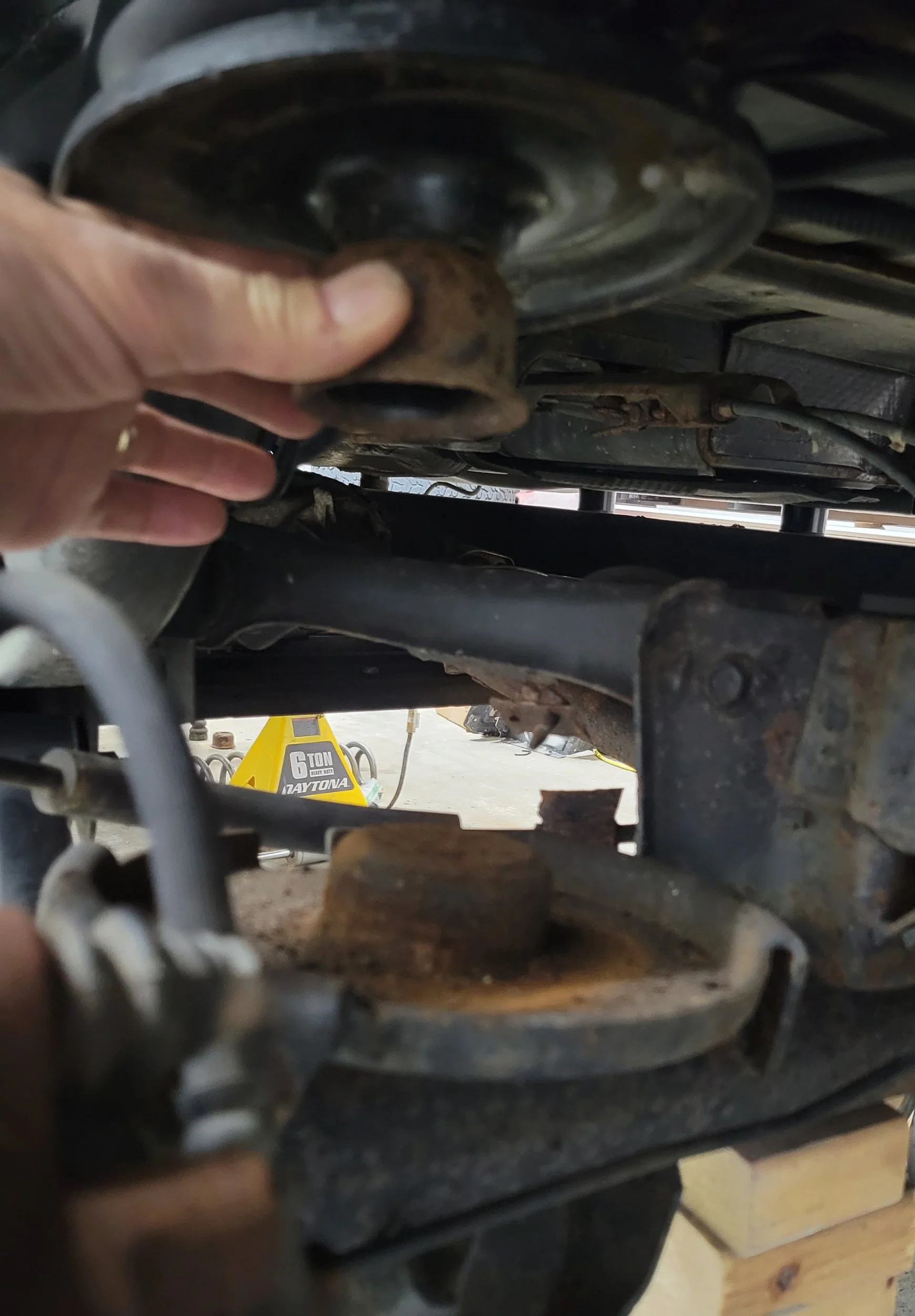

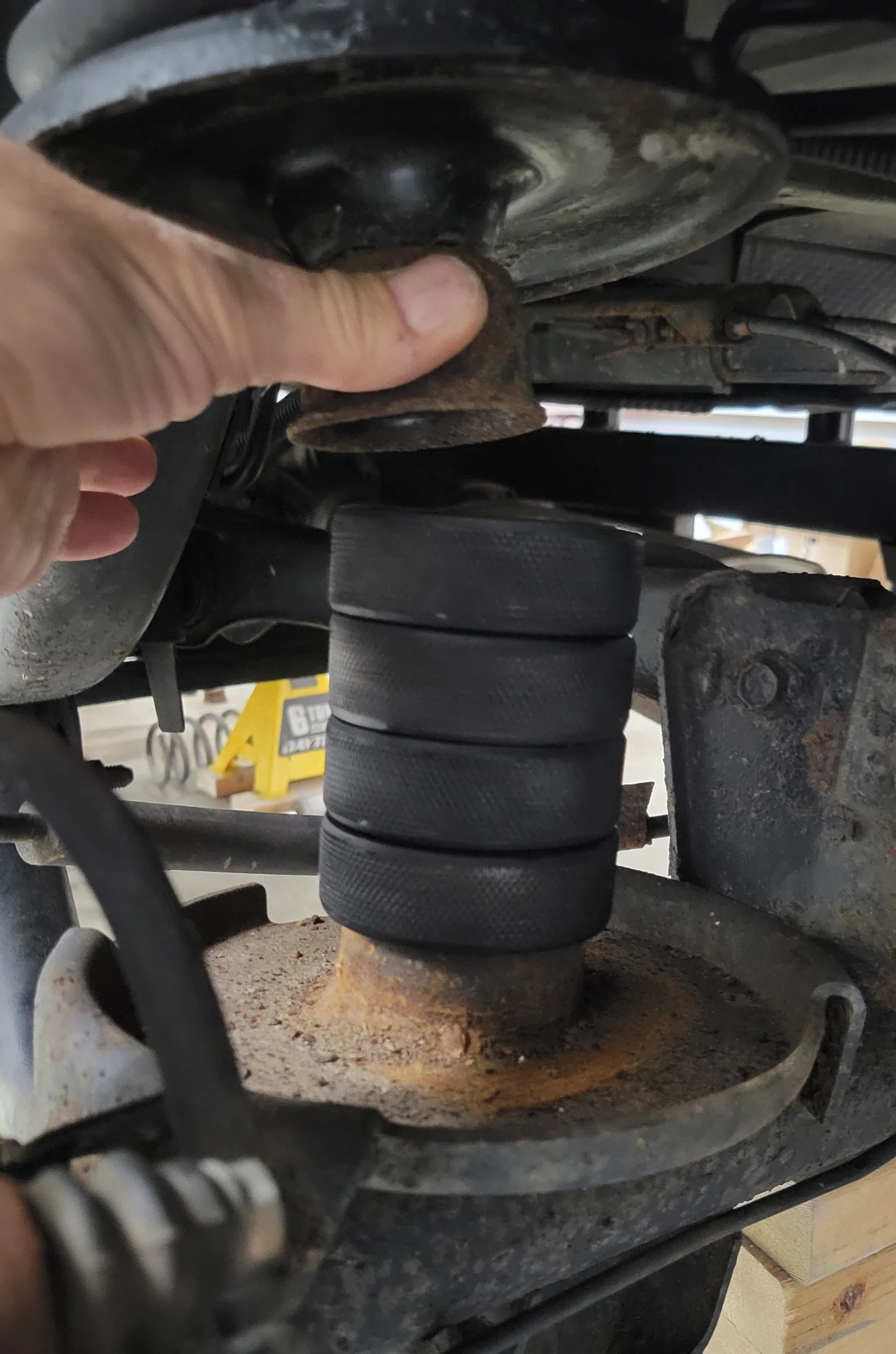

I purchased the ranchos recommended in the forum for a 4" lift, which also matched my measurements. With the jeep supported on the frames I can maybe get another 1/4 inch of up travel on the rear axle with the trackbar disconnected and coil springs removed. I need to see if there is something else in the way. This is without wheels/tires too, so I don't know if I'll have any rub there yet.

Right now I'm trying to get the bump stops and shocks as close to right as possible as I wait for the control arms to come in. Once stops and shocks are done I was going to do the currectlync and track bars - test drive and tweak - and then swap out the control arms (which are 2-3 weeks from delivery), test drive and tweak, then maybe do the tummy tuck and related work. I have plenty of little things to keep me busy while I wait for parts. I spend about 2 hours in the garage each morning before work and maybe a total of 6 hours on the weekends, so it's slow going.
