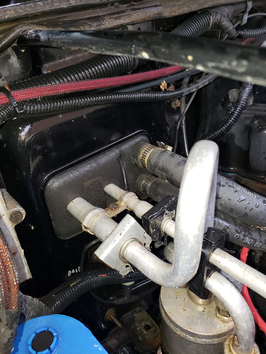

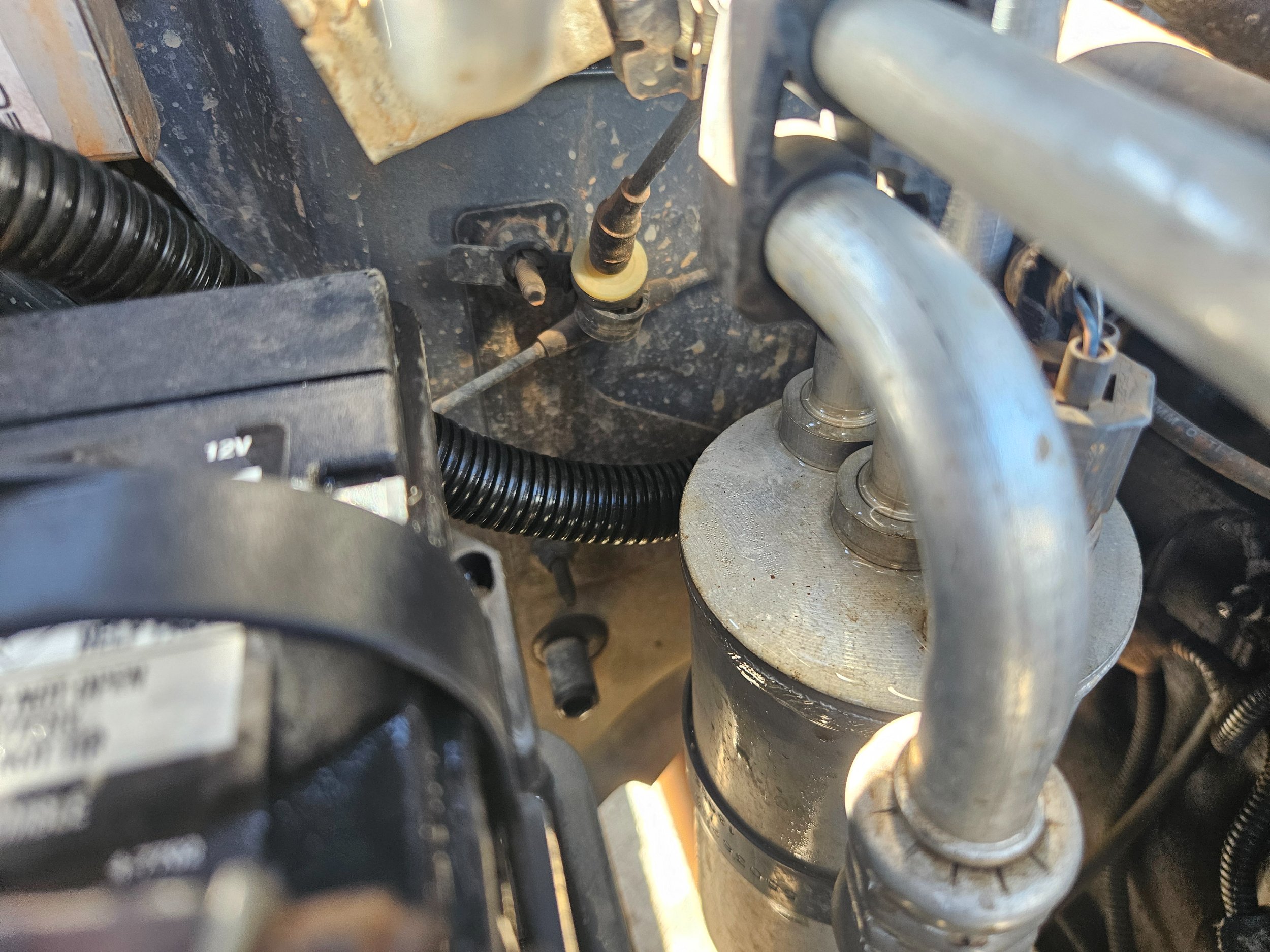

Fought the water accumulation on the passenger side floor for several years; the following were what I did during troubleshooting:
Cleaned the drain for the cowl air intake, sealed seams in the general area, ensured the evaporator pan drain was clear (several times), verified the foam surrounding the coolant and refrigerant lines were sealed and replacing the hood to firewall seal.
