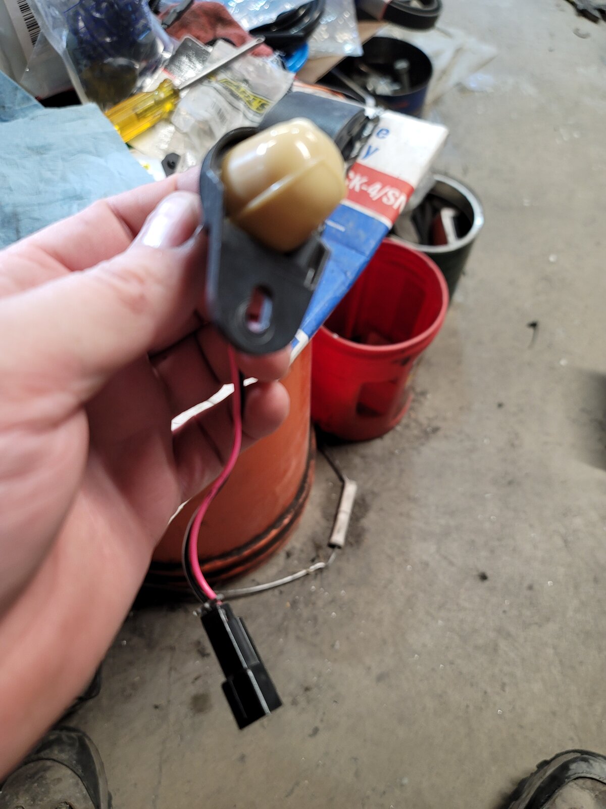

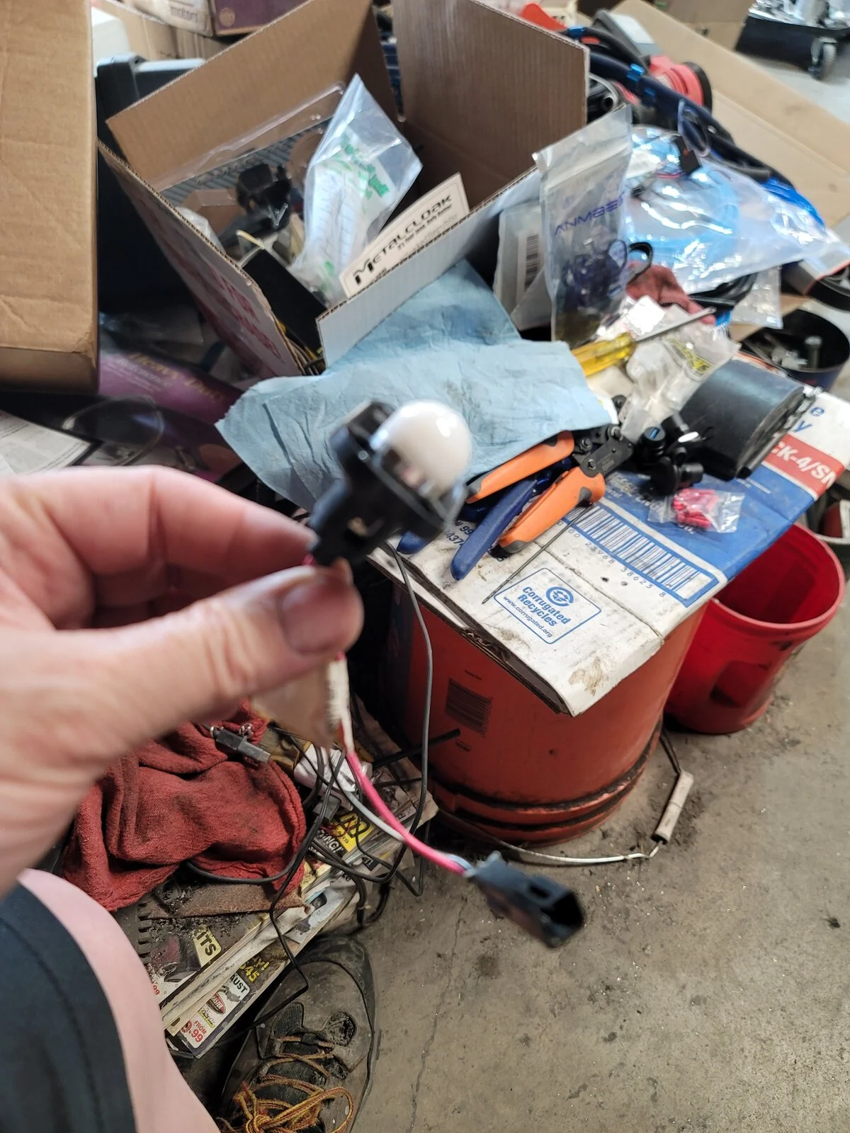

I'm not sure if it's a SE thing or if it's a 97 only thing but my TJ only had a courtesy light on the drivers side. The plug was available on the passenger side but there wasn't a socket.
Its an SE thing… my wrecked SE had one on drivers side but had a plug on right… I got one from deadjeep…my new 97 Sport has one on both sides…

Edit: In the theme of this thread. The courtesy light socket from what I've been able to find was a 1997 only thing. For 1998-2006 the socket was changed to something different.
I know you talked about the bulb being different but the courtesy light socket is a YJ hold over also. And I'm not sure if it's a SE thing or if it's a 97 only thing but my TJ only had a courtesy light on the drivers side. The plug was available on the passenger side but there wasn't a socket.

@97JadeTJ, mine is a 97 SE, and I have that same YJ-style courtesy light on both the driver and passenger sides. Maybe it changed somewhere in the 96–97 production line.

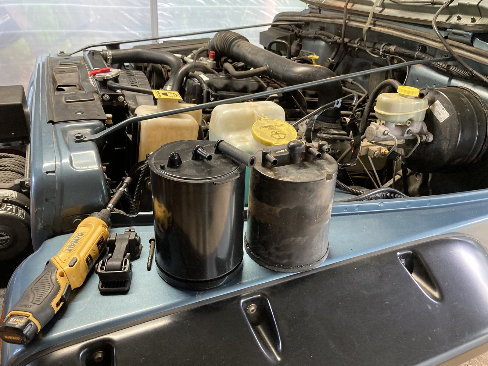

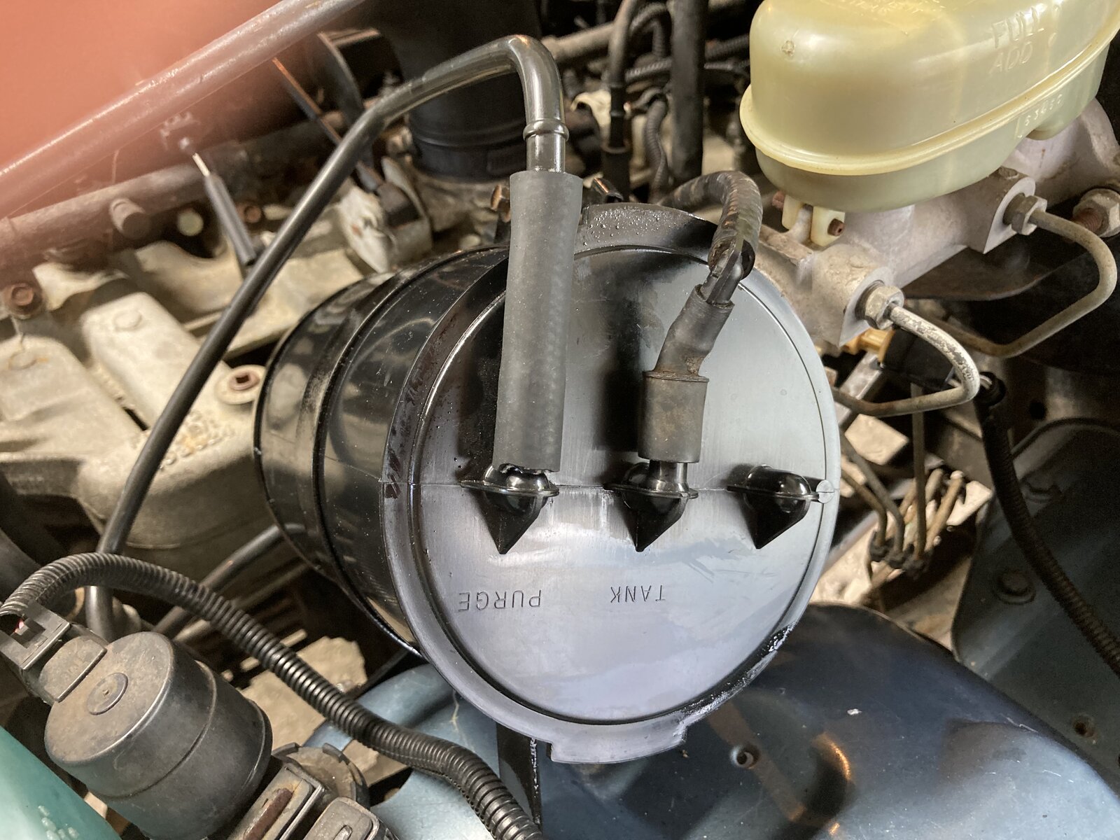

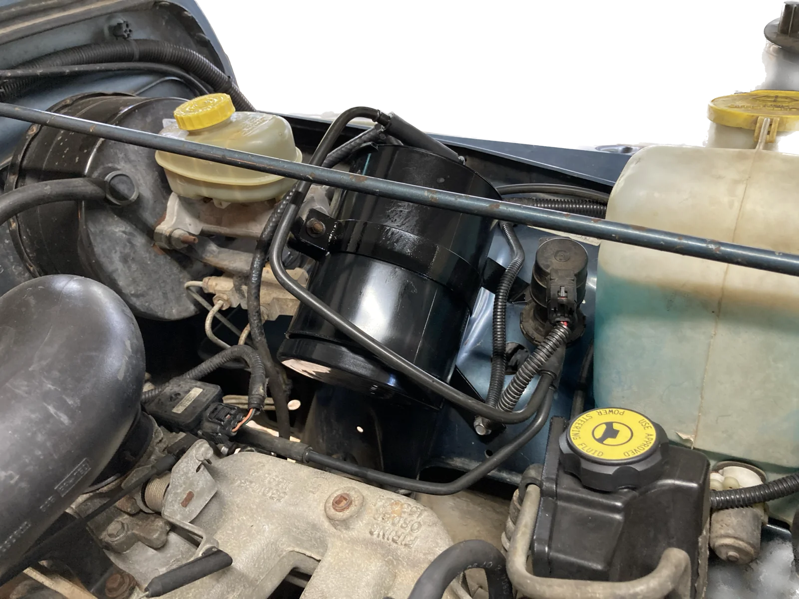

I case anybody runs into problems with their charcoal canister the fix is the VC120 from AutoZone… that’s the only replacement and place I could find it… I ordered it yesterday and picked it up today, $90!… uses the same bracket but you have to bend the point over for it to lay flat…

Can you post a picture of it please?
@Wildman
New one (VC120) on the left original on the right

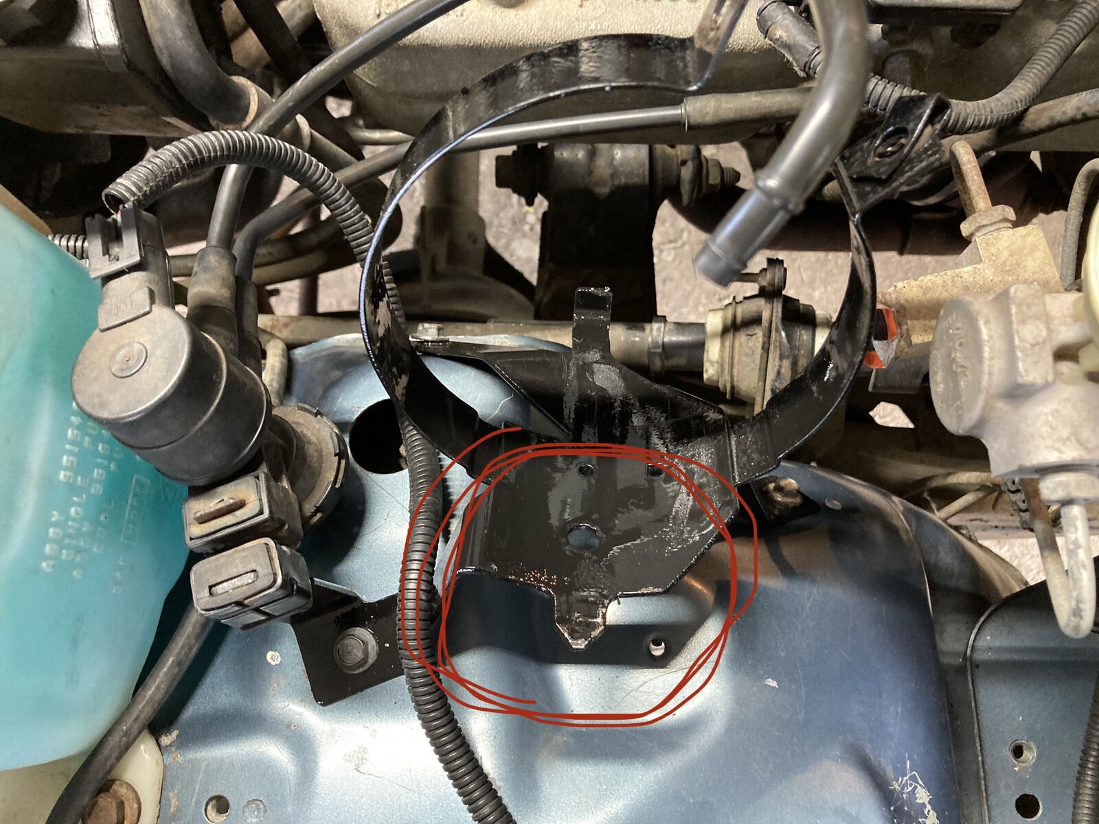

Tab that must be bent over for new one to fit

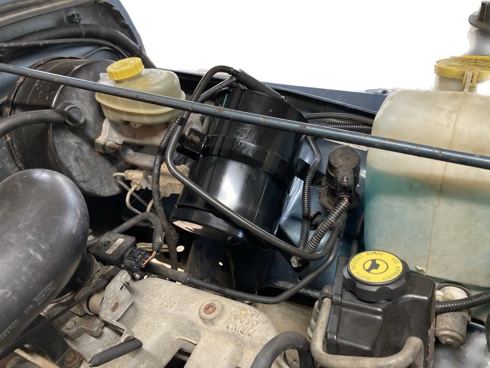

New one installed

Yea the p0441 is incorrect purge flow… could be the gas cap but if not it’s the charcoal canister and/or the purge valve… what happens is that over the years the charcoal breaks down into small pieces in the canister and get sucked into the purge valve and stops it up… I ran into this same problem when I got my first 97 and the new canister and purge valve solved the problem… I‘m not sure what years they used this particular canister but I know they changed it to a rectangular shaped one and then moved it to the rear of the jeep behind the tail lights…
