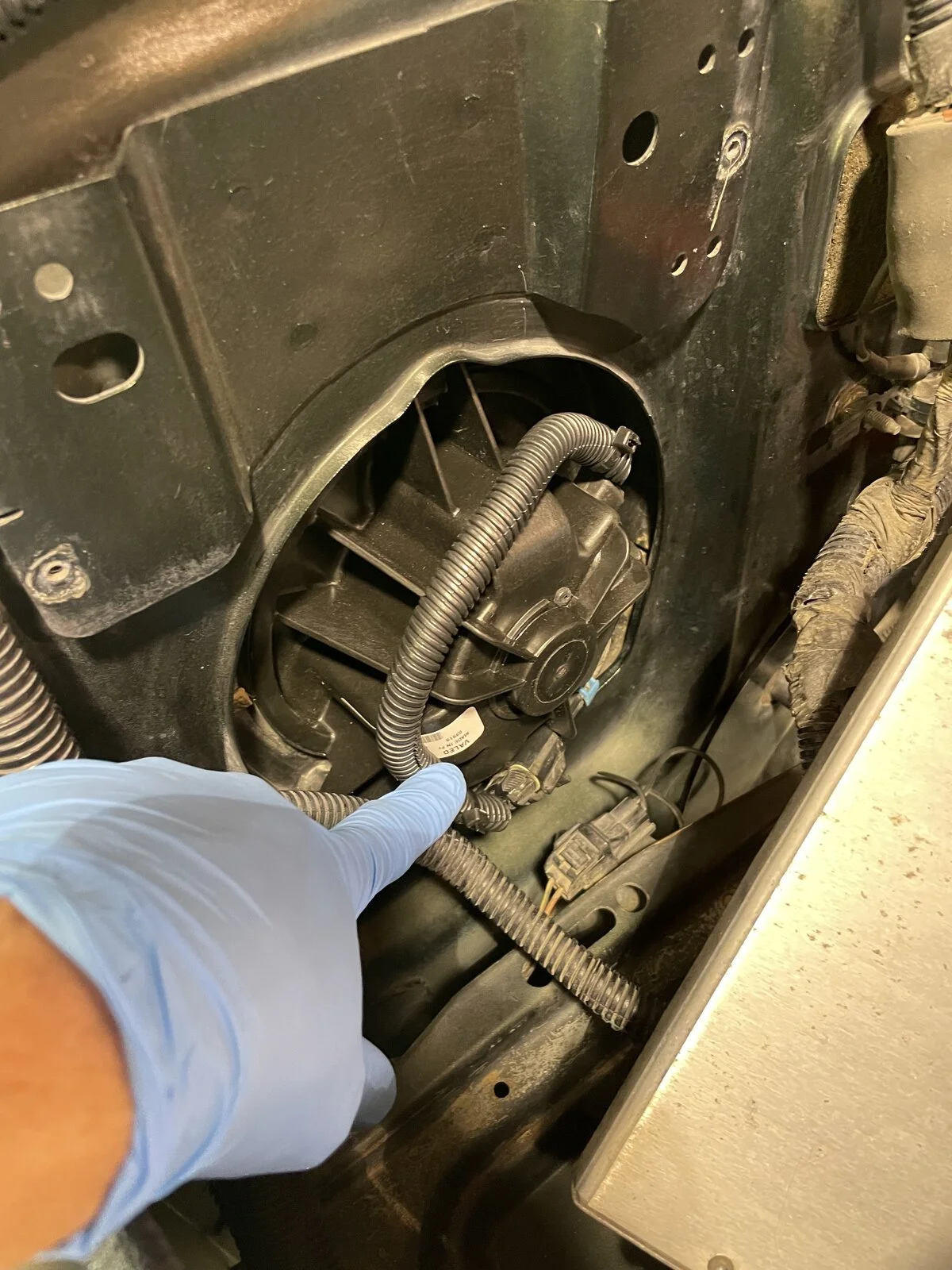

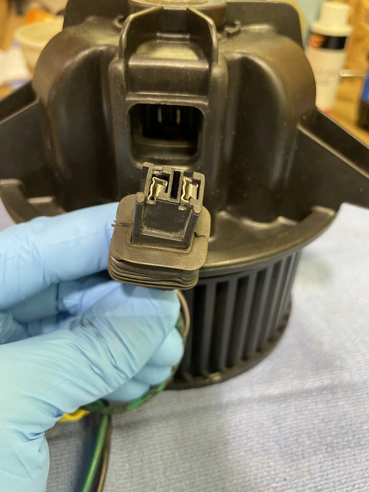

I dunno when you replaced the heater fan's wiring harness but the usual cause of melted wiring is the fan motor is going bad. The shellac coating the winding wires breaks down letting the wires start shorting out to each other which starts the motor drawing more amperage through the wiring, switch, and resistor pack. Replacing any of those without also replacing the fan motor is likely to result in it happening again.

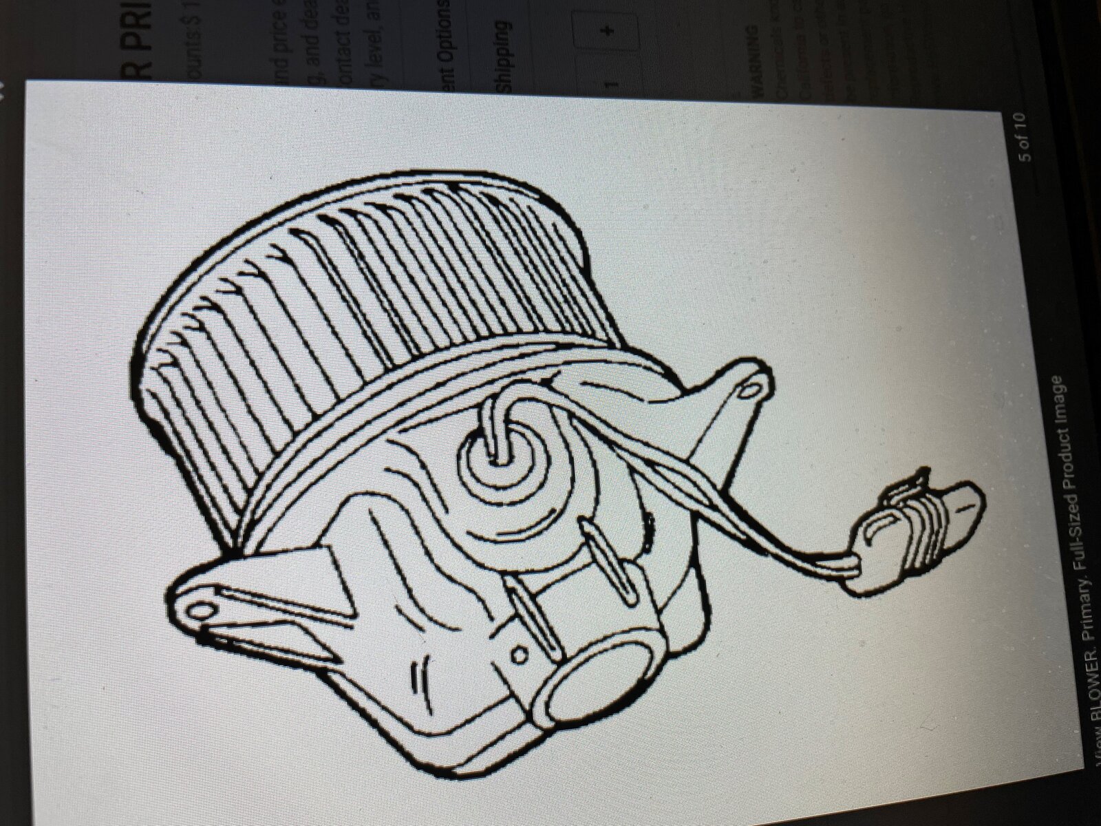

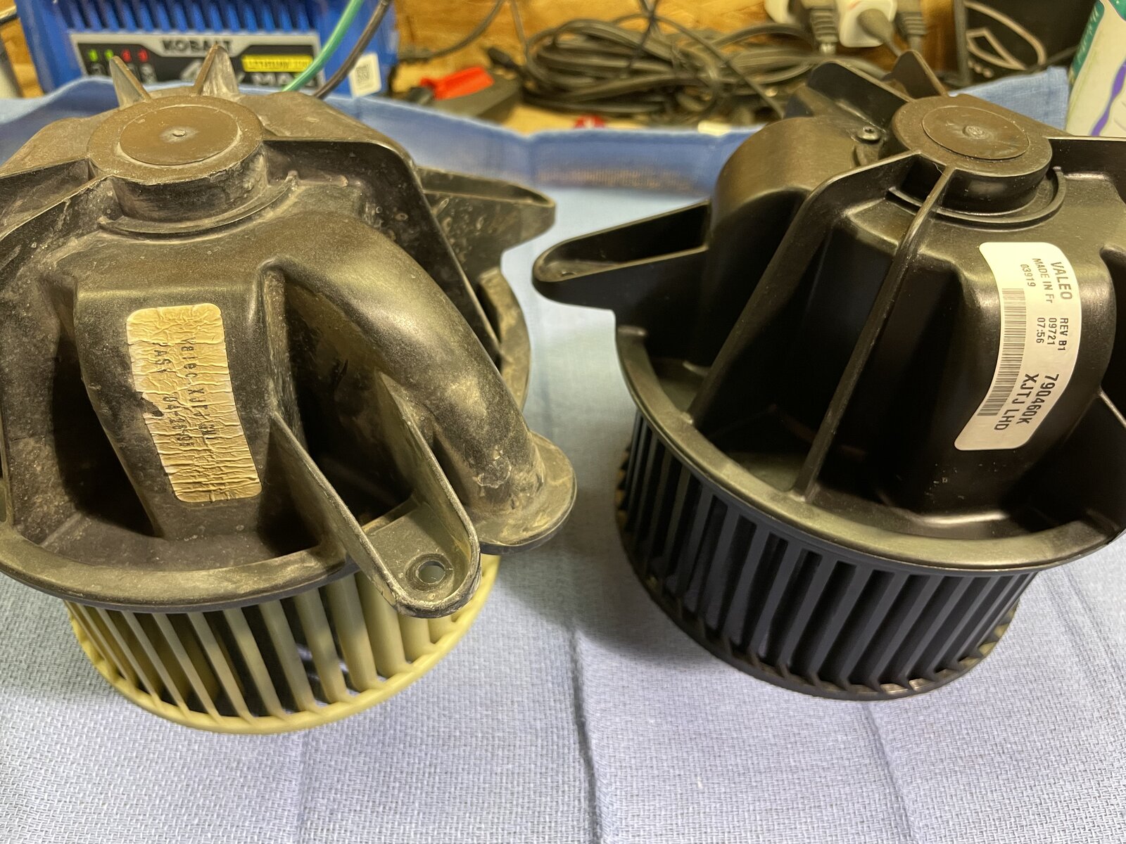

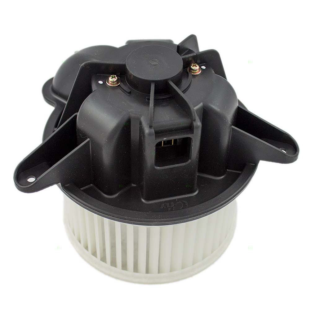

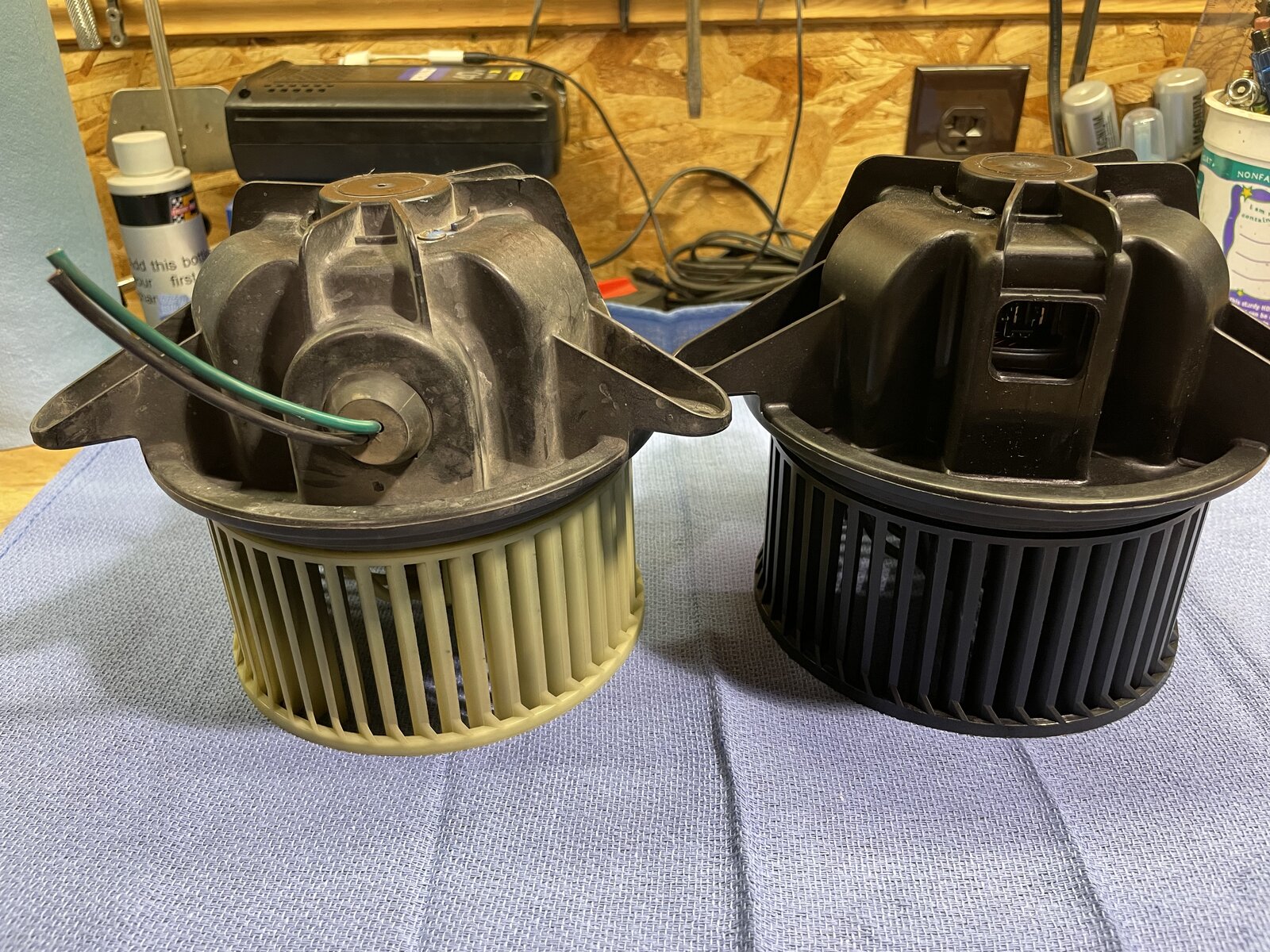

@Jerry Bransford, I finally checked under the dash a few weeks back. The new harness for the resistor still OK (but it doesn't get used in the summer). I've been wanting to replace the blower motor as your suggestion made sense to me. BUT apparently, the '97 (or maybe early '97s) have another peculiarity here. The blower motor on mine has a pigtail which connects to the harness in front of the firewall.
Subsequent blower motors have hole that the harness plugs directly into.
The blower motors appear otherwise identical. The old version of the blower is not available. Chrysler did make a conversion wiring harness plug which plugs into the harness on my jeep and the newer style blower motor (Mopar part no. 4886151AA). But, of course its discontinued as well. My local dealer found three dealers that have one (TN, CO and TX) but none of them will ship it to me. I found 2 online places that said they had it and then cancelled my order and said they were out of stock after I paid for it. I guess I'm going to some junkyards this weekend looking for a plug that goes into the newer style blower motor.

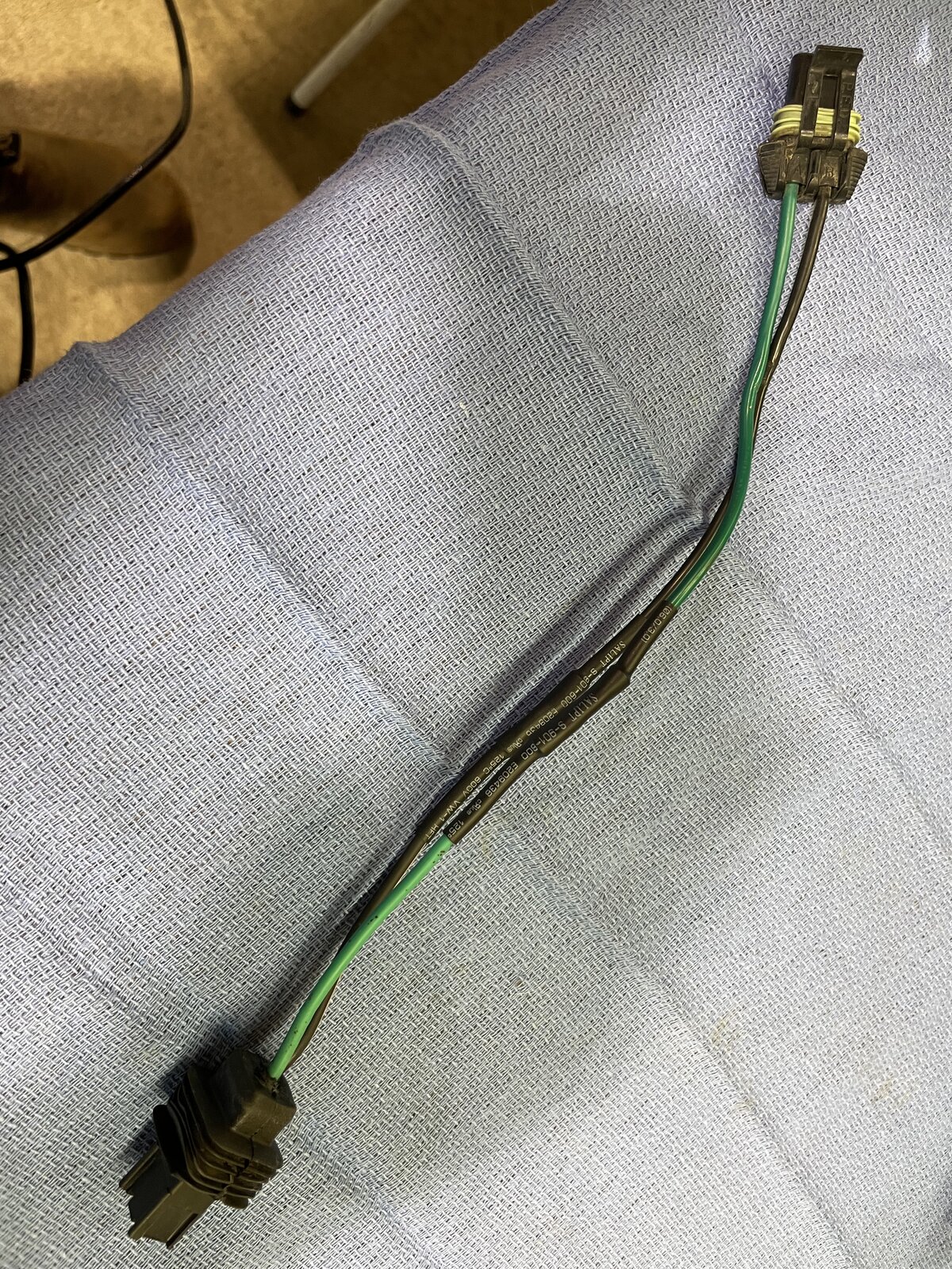

Update:
I was able to get a heater blower plug from a wrecked 2001 TJ at a junk yard. I cut the pigtail from my old blower motor and spliced it to the plug from the junk yard. Wire number (2), color (green and black) and gauge were the same. This essentially Re-creates the discontinued Mopar adaptor noted above:
As the old blower was still working somewhat, I ran it with it out of the fire wall before cutting the pigtail. I did the same with the new motor to confirm they both spun the same direction. I’m not sure if it would run in reverse or just not run if I reversed the polarity, but all seemed good. So, the new blower motor is in and works well after a several week saga for what I thought would be very straight forward.
Reactions: SSTJ and Wildman

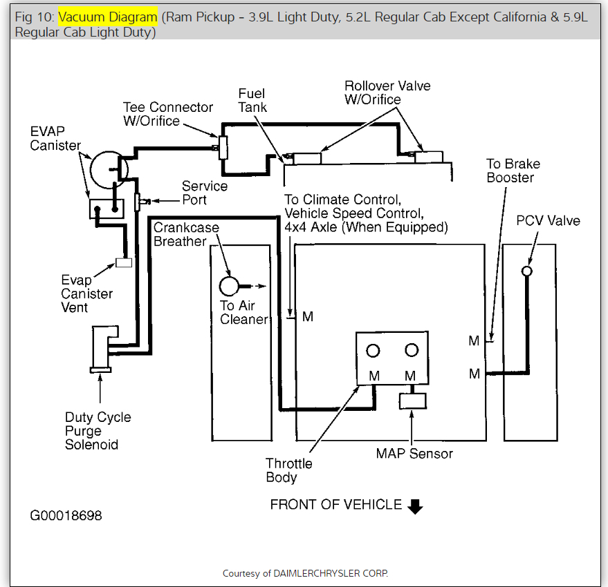

If anyone can help, I need some good clear pics of the charcoal canister and how the plumbing is done between it, the purge valve, and the intake manifold and or the emissions line from the fuel tank that runs next to the fuel line.

The round charcoal canister right in front of the brake booster and master has a small purge solenoid near it and the lines going from that to the charcoal canister and then to the manifold or near it.
Reactions: SSTJ
I don't know if I have any good pictures of my charcoal canister & purge valve or not. I'll go back and look to see if I do or not.
Edit: Here is the vacuum schematic. I know it says it's for a V-8 but it was how mine is setup.
