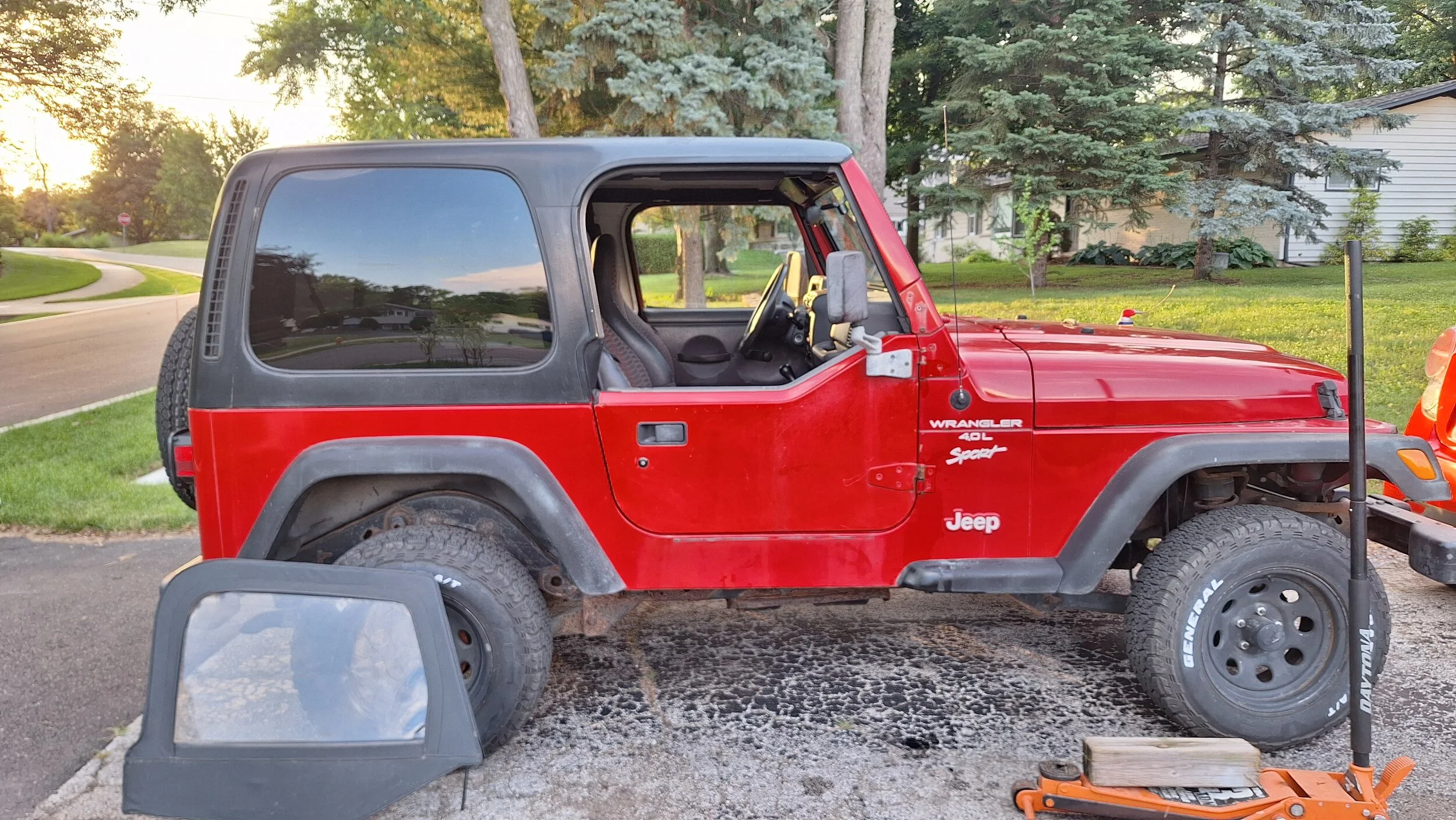

Meanwhile I had to drive the Jeep to work for a week when my daily was in the shop. The Jeep is parked now, til the appointment at the shop for the rear diff pinion bearing. Making a lot more noise then I like.... :cry: I have a master bearing kit for them to install. I did pick up half doors in the mean time!
Got her back today!

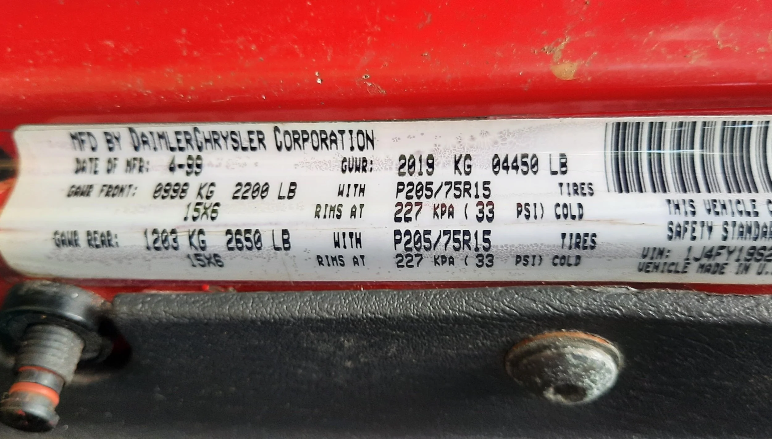

I ran the VIN on my Jeep to get the build.
The tire size on the build sheet matches the spare size, make and model. Including rim.
30X9.5R15
The sticker on the door jam does not.
Is this normal for a Chrysler product?

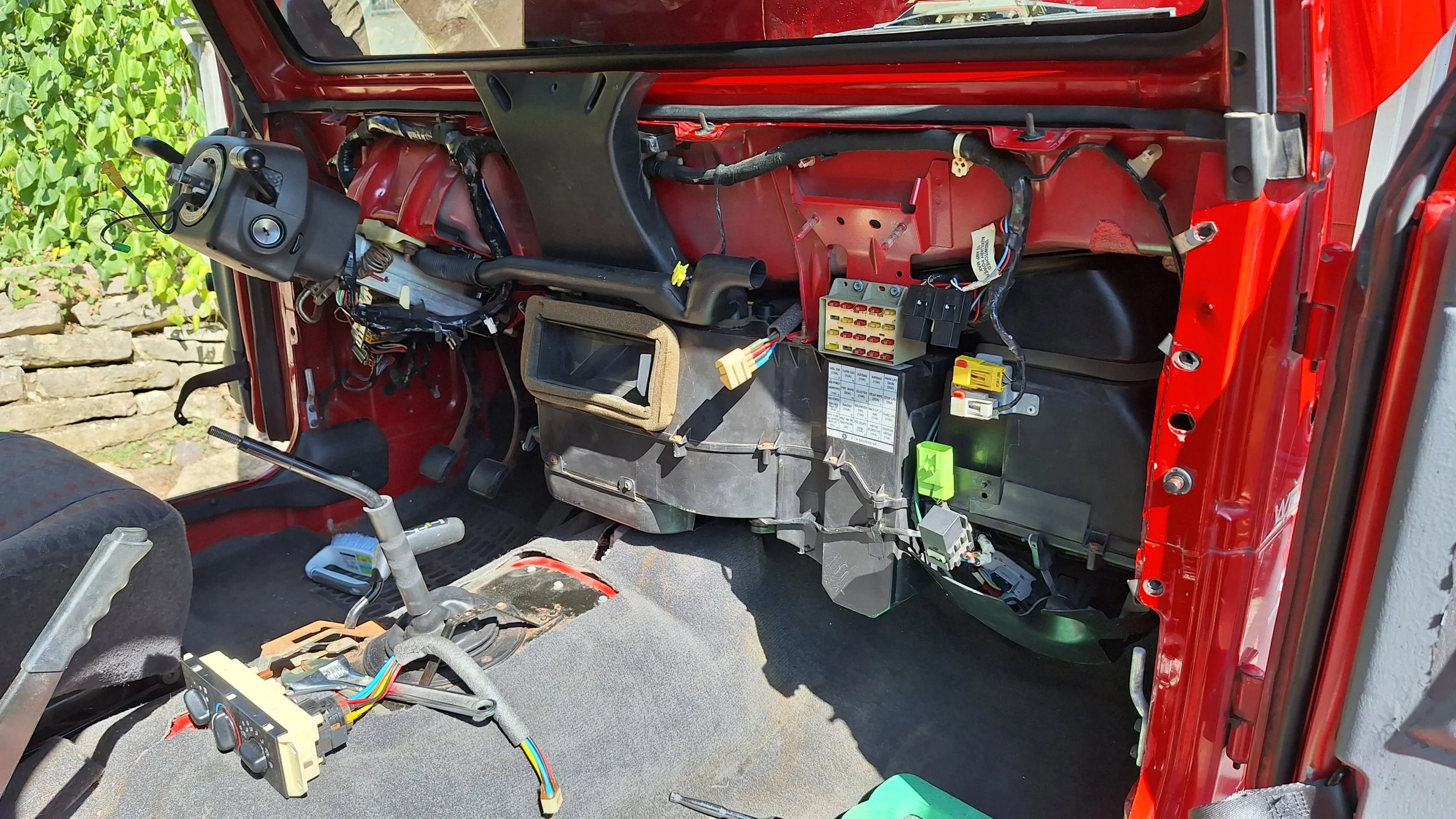

New heater core installed. That was a chore! Found there were a lot of missing and lose fasteners in the dash! All tight now! Found that the gasket was missing from the fan! While the dash was out, replace the door ajar switch in the passenger side along with the antenna base. Much easier to get at with the dash out, Since I took the passenger seat out, I threw in a new set of spacers and bushings on it.
Then I noticed that it was taking forever to heat up.... :( The thermostat was stuck open. New one took care of that.
