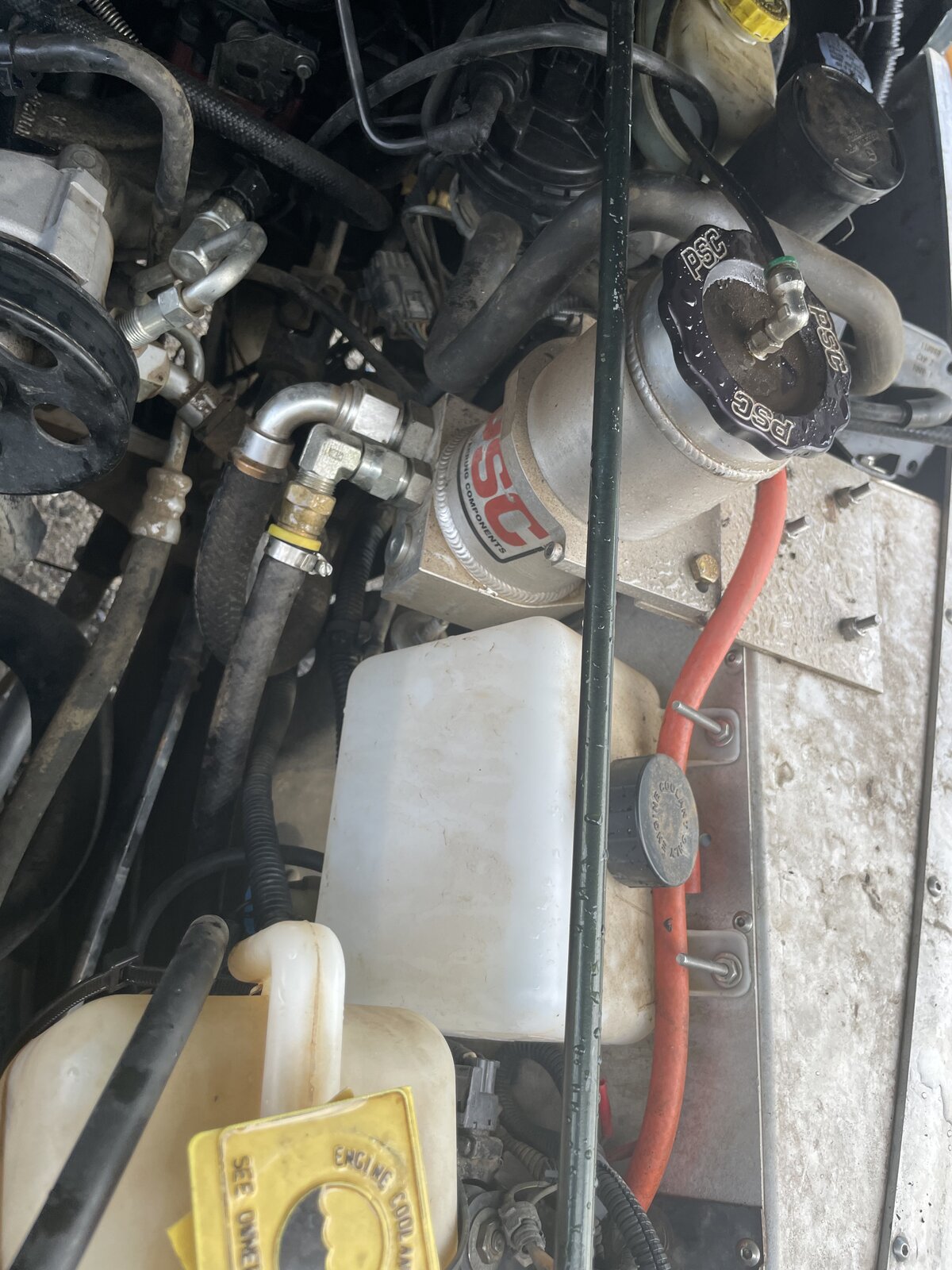

I am thinking the master cylinder mount may be the way to go in my situation. A 4 cyl has a lot less distance to the pump from there than a 6cyl. If I move the resi in front of the pump I would need a 90* possibly a 120* fitting at the pump. I will measure the distance to see what the feed line length will be. Also have to check to see if I still have the bracket.

Looking back at your original pics, it reminded me that my original install with a remote res had a nasty S-turn in the input hose to make a connection. If memory serves, I smoked two pumps that way.
The master cylinder is a no go. My charcoal/evap stuff is there with no where else to put it. Maybe another 90* at the pump will help. The feed line hose length is very short. I will see what I can do with another 90* fitting. 😑

If you can keep the hose length in -12 under roughly 18" and mostly straight, that will be good enough we can say it isn't causing the problem.

Fitment is the issue, as with all builds. Hopefully I can fit about a 8” hose with a slight curve.

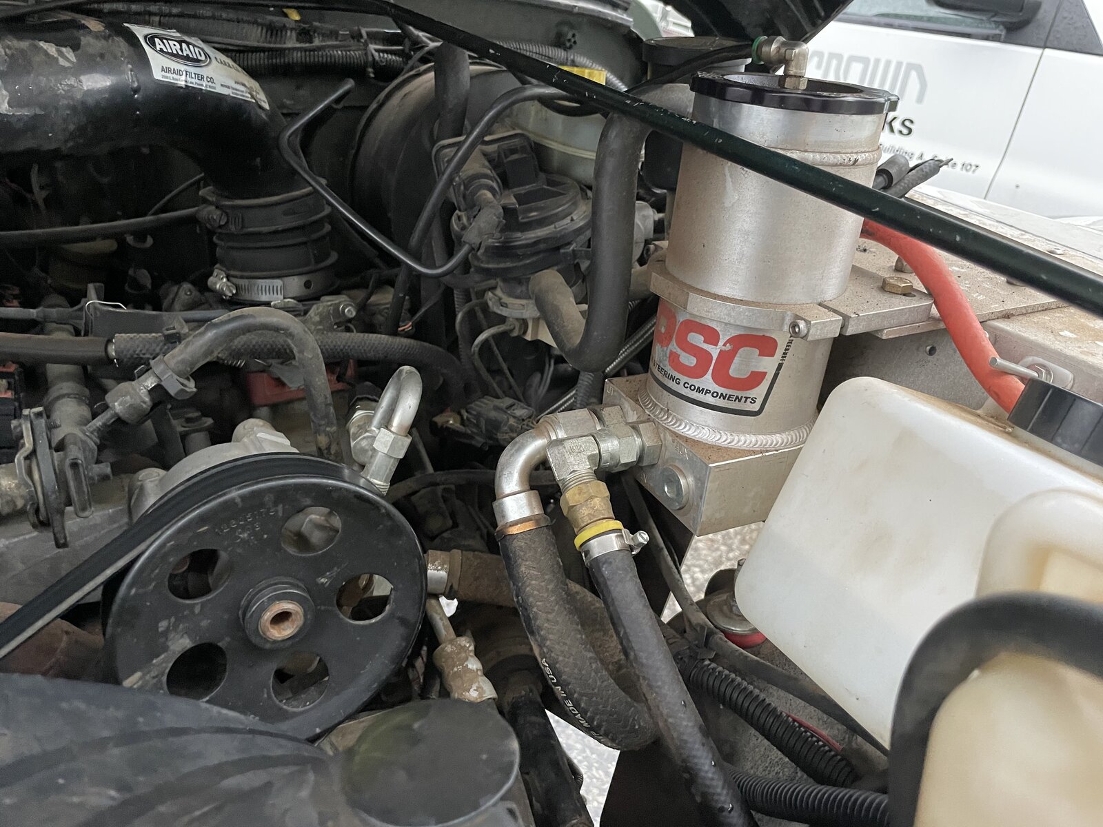

If I switch places with my wiper reservoir and steer resi and add a 90* fitting at the pump I think all will be well. Will end up with a short straight run that will allow the hose to move with the engine. Resi will have to be lowered a tad but should still be plenty high.
It is and engine movement will break or ruin the hose and or fittings. You would ideally like the reservoir forward or rearward of the pump inlet so the hose runs fore and aft a bit so it can flex that way. Even if you have to rotate the reservoir some, that works better than the loop.
Exactly what happened to mine in same location . Hose too short and engine movement had the hose seeping. I moved the reservoir back and lengthened the hose a few inches and zero issues since.

Noted, I’ll be lengthening the hose and moving my res when I install this new pump.

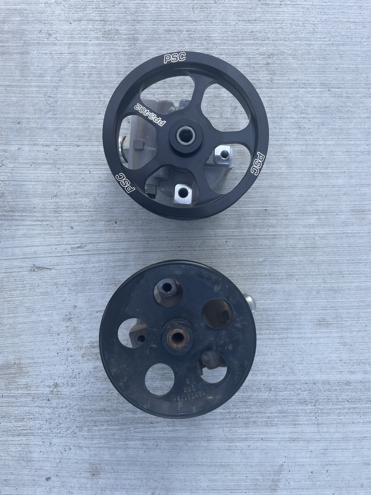

Got the new pump installed. Moving the reservoir and replacing fittings.

New aluminum pulley is cooler. Lol
