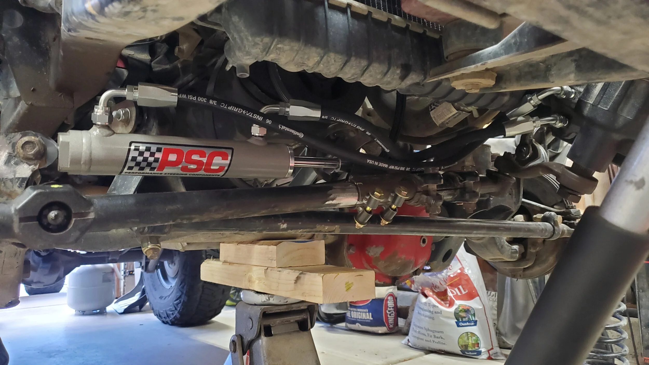

i just got a complete PSC hydro assist kit but i don’t know a whole lot about them. i have seen from some videos that the community figured out different mounting locations, line routing, or supporting mods like bolt in brackets and things like that. are there any worth looking into before i take on this install?

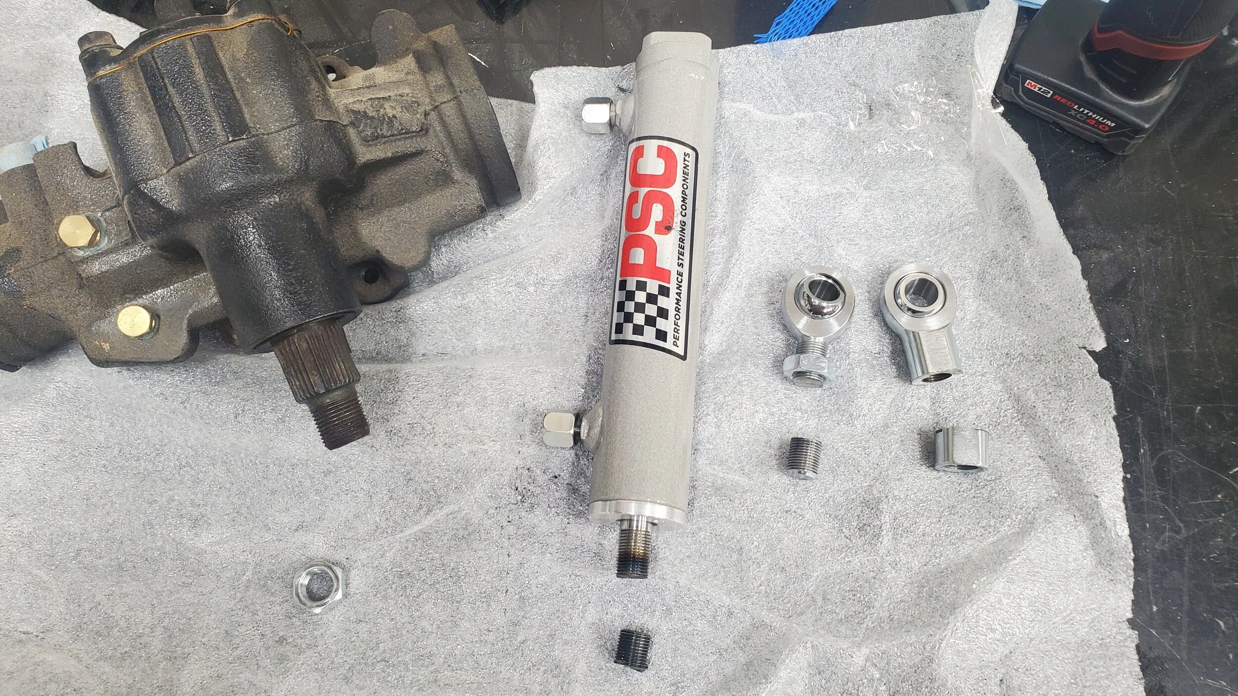

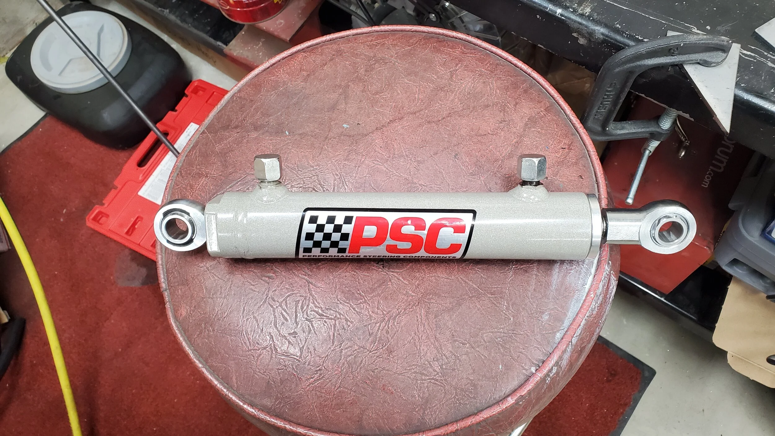

Shorten the ram and heim joint to fit the mount and drag link.
Build, or buy, the drag link mount.
Keep your hoses only as long as they need to be at full axle droop (cycle your front axle).
Use Blaine's cooler linked above.
