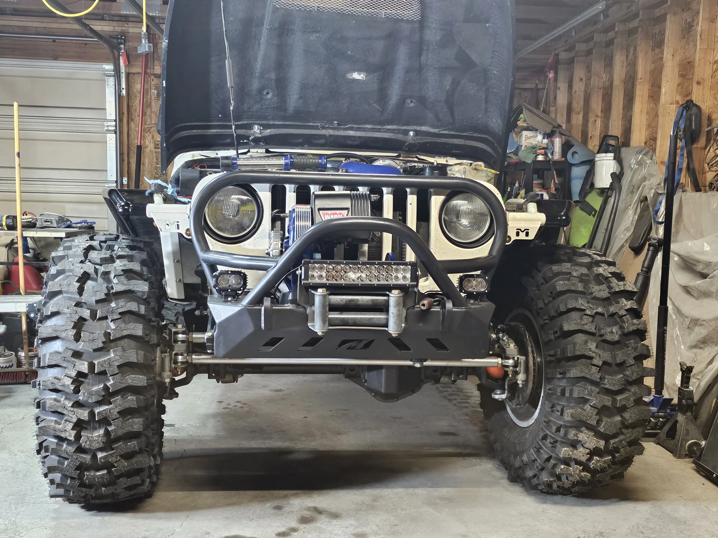

Measured my tires again last night and I was off on my width. Outside of tire to outside of tire I'm @ 82" now. My axle is a 1977 Ford HP44 that I narrowed to be Wagoneer width which is approximately 61.5" WMS. Then I have 1.5" spacers so I'm 63.5" WMS with them. I have 17x9 Spyderlock rims with 3.5" back spacing and 38x13.5x17 Mickey Thompson Baja Pro XS tires.
With my old setup I was running recentered Hummer rims that were 16.5x9 and about 4.25" backspacing with 38x12.5x16.5 TSL SX tires and my outside of tire to outside of tire was 75" with them.
I won't be able to tell you what the differences are until I get my engine fixed and can finally get this new build out on the trail. But I am a little worried about it being so wide.
My math says you should be at 80" wide now; not sure where the other 2" comes from. Maybe the tires bulging out? Your Jeep looks great, just a touch too wide I think. What size are your flares? I was interested in using metalcloak fenders but making a custom flare that actually stays 8" wide all of the way down. Just not sure how 8" would look.
Your second photo looks really narrow, but that may just be the angle. Is the suspension decompressed? Looks like you have a lot of room. How did it handle at that overall width on and off the road? I have 60.5 wms, 12.5 tires, 8 wheels with 3.75 backspacing, so I SHOULD be at 73.5, and while I feel okay on/off road, sometimes when I'm off camber it feels a bit sketchy. Any issues at that width with the trails in Washington?
I've got their 8" flares because I wanted to try and cover my tires as much as possible for the times I did drive it on the street. Yes those Baja Pro XS tires have a pretty big bulge. I'll try to get something on the tires so I can get a good measurement. My front axle is Waggy width.
