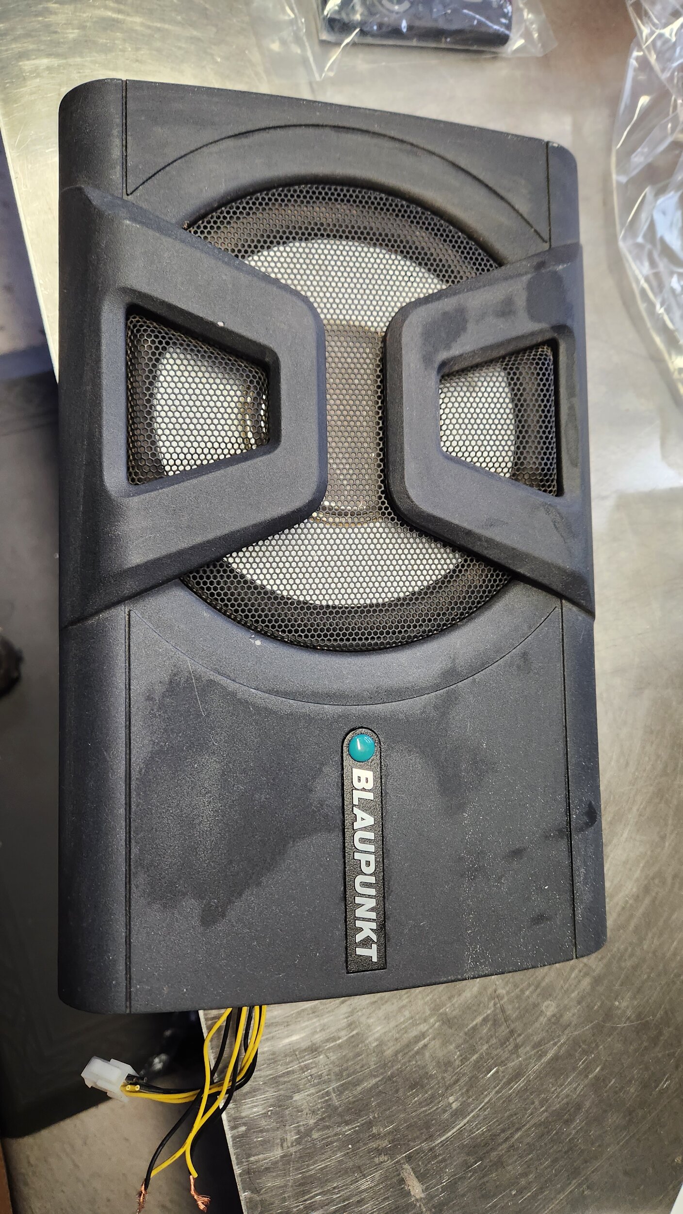

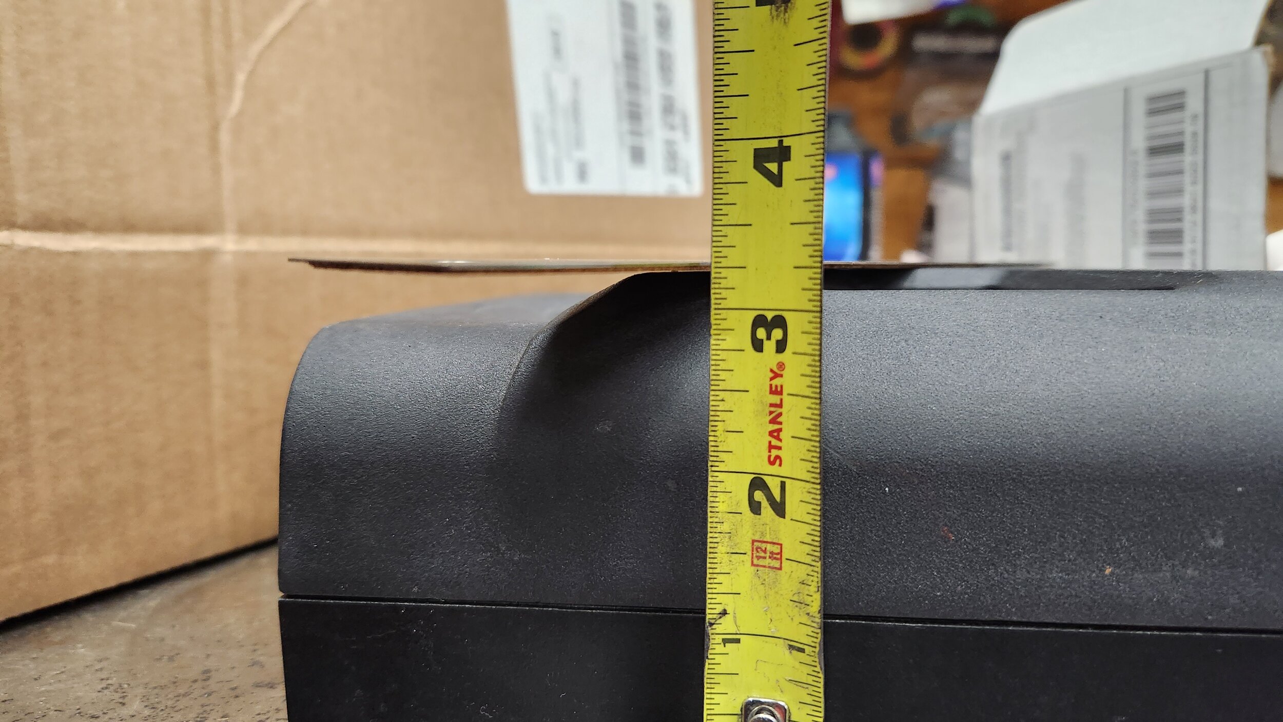

It's pouring rain here right now and I can't get my back seat out of the shed to check but I have a Blaupunkt powered sub woofer that is 9x14 and 3.25" thick, will it fit under the seat?
It should. I have a 8 inch kicker hideaway and it fits. I have it in the middle towards the front barely under seat, not pushed back etc.
  • dimensions: 14-1/4"W x 3-1/4"H x 9-3/8"D
The 3.25” dimension is the only question. It’s very close. You can always add a spacer under the rear seat mounting brackets and seat belt bracket if you can’t quite fit it. I suspect you are G2G though.
Thanks guys, the rain let up and I got the seat installed and it fits! I got most of the wiring run and tomorrow I will pick up the ground under one of the seat bracket bolts. Then I will figure out how I will secure the sub, my thoughts on that are 2 footman loops with a strap. I did notice when I fold the seat up it wants to nudge the sub back a couple inches.

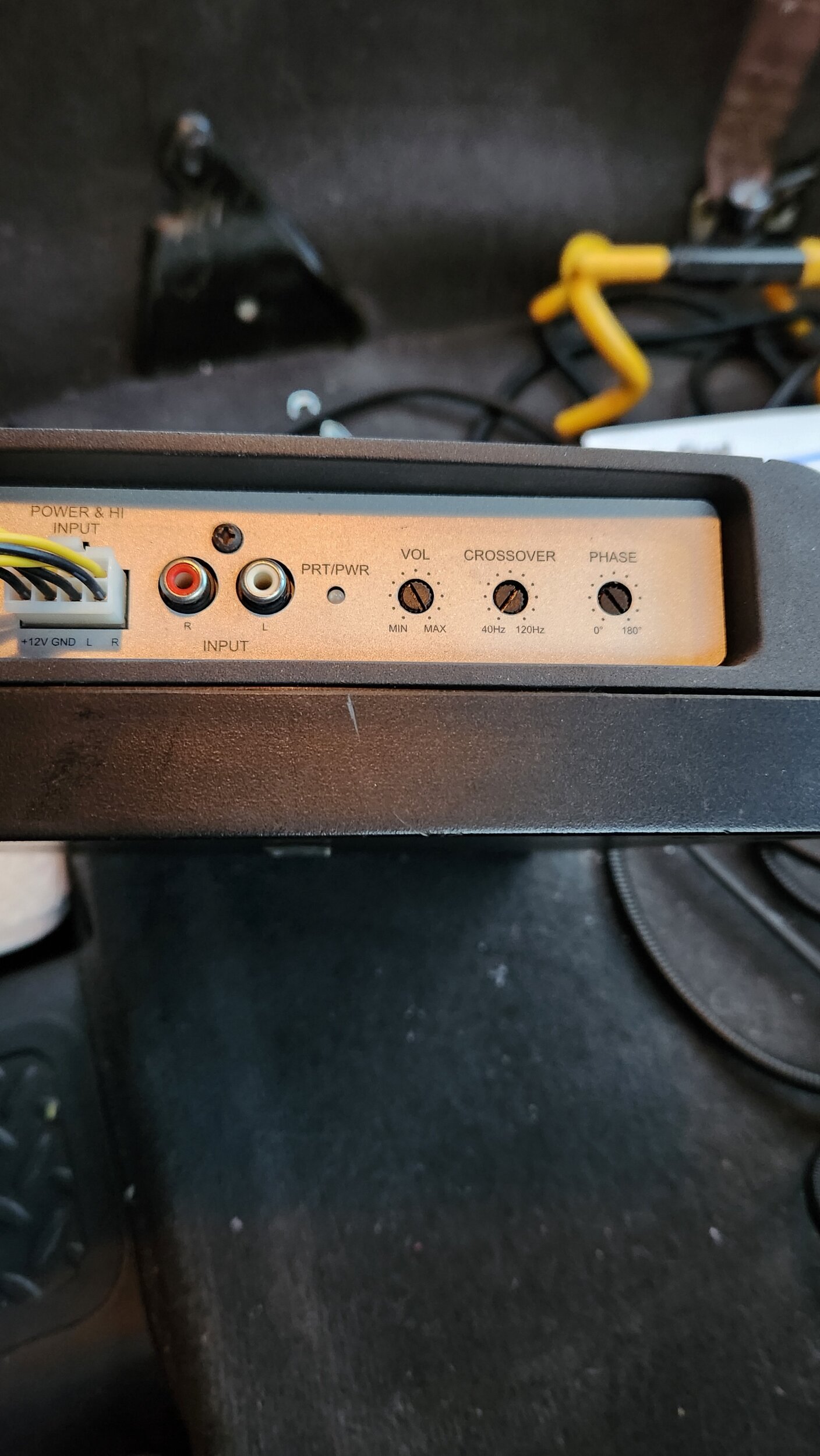

Then I need to figure out how to adjust it, the sub was designed for either high level input or RCA input from the receiver and I am using the RCA inputs so I don't even know if these adjustments matter as I have adjustments on the head unit as well. Any tips on that would be appreciated.
I think I have the crossover and phase figured out, I just need to figure out what to do with the volume since I now have that control in the head unit.
