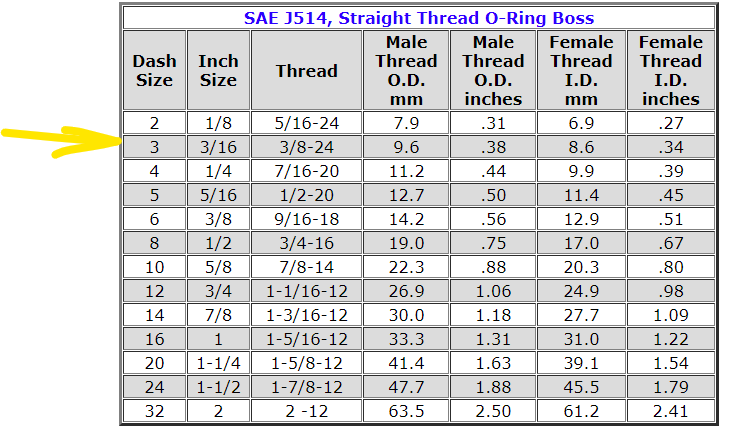

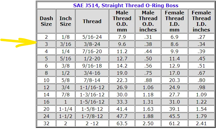

Any chance you know what size threads that sensor has? I've been searching and can't seem to find it

The port size is 3/8-24 and it is an ORB or O-ring Boss which means there is a small chamfer at the port entry that an o-ring gets squished into to seal it. They are calling it -3.
