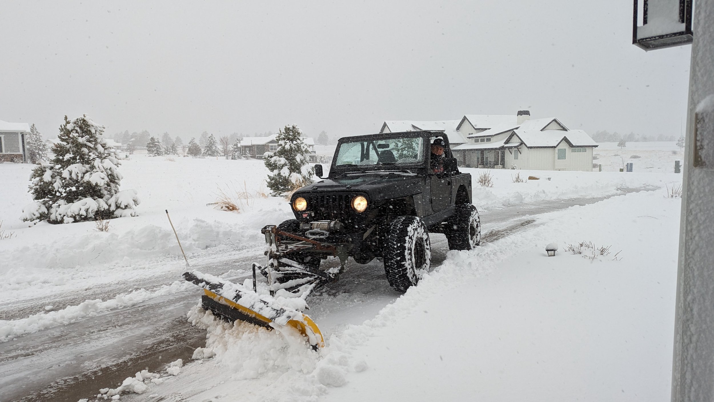

I recently installed a Meyer plow to my other TJ. And put 8, 8x16 blocks as close to the tailgate as I could and strapped them down with a short 2" ratchet strap. Now just waiting for it to snow enough to plow. I'll only be doing mine and the neighbors driveway and our access road.

I don't use counter weights and I don't have a problem pushing snow around. Your plow is huge compared to mine though.
I'd go with that rear hitch rack, and I would push it into the receiver as far as i could get it to go, without interfering w/ the spare.
Then drill a new hole for the hitch pin.
Then I would get a few plastic milk crates and fill them up with whatever I could find to make them heavy, and strap them on the rack.
Unless you happen to have an old engine block laying around...
Maybe this is why Jeep says don't put a snowplow on a TJ.... That said , most 3/4 -1 pickups should have 800 lbs. counterweight at the rear of the truck .
You could get multiple 3/8" steel plates made to fit in the rear of the Jeep and stack them as needed to achieve your goal . You will likely need to beef the rear suspension quite a lot .
Ya the max payload of a TJ is only about 800-something pounds TOTAL, same as a car, but people act like it's a HD pickup and add heavy items (bumpers, winch, rock rails, snowplow, tools, etc). Been there, done that, I didn't know any better at the time.
