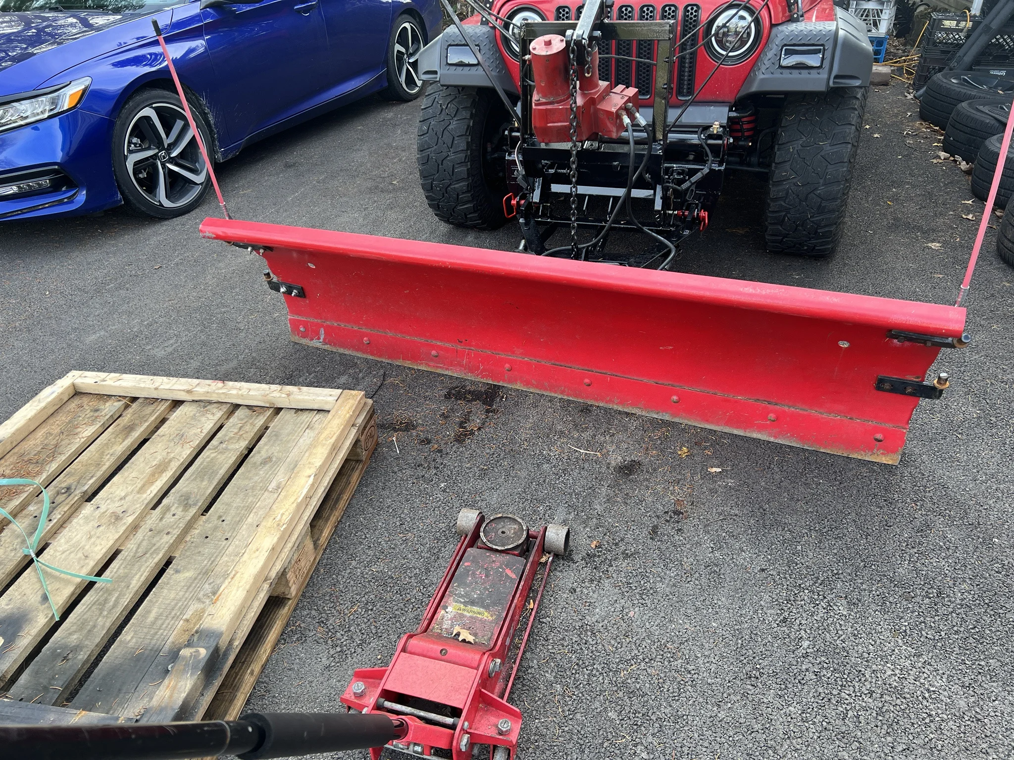

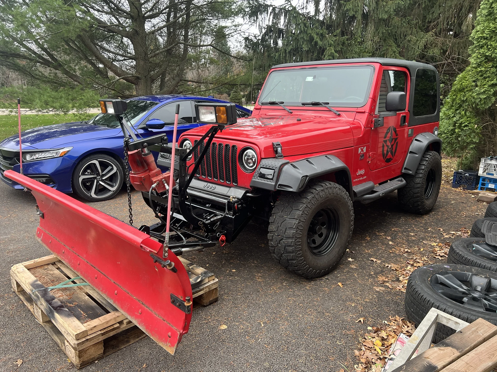

I have the same front air bags installed
Aired up to 50psi, and chain adjusted to allow the plow to rest in float mode. What plow model is that if u dont mind me askin?? Curious what weight is
My Western plow must be heavier. It lifts the ass end off the pavement and I lose SOME traction. It became very obvious on first use. I suspected the short wheelbase might need counterweight before testing it
Took 3 of us to lift that plow off the trailer. Someone had it in use on a TJ because I got the unimount, and harness with it. This is a common setup as 3 were for sale within an hour drive, and its been around 20+ years
Just needed some new Grade8 hardware I sourced from my local McMaster Carr. Im not sweatin the GVWR as this isnt leaving my driveway
It was an old Meyers home plow. Hydraulic over electric. I've since graduated to a mid-size chevy colorado, with heated seats, and it has a Snowex LT7200 (with down pressure). This plow only weighs 300 lb. with the headgear!
That's very light, nice!!!
Back in the day, I knew a few people with CJ's equipped with snow ploys (it was how we got ours actually!). Nearly every single one would have about 10-15 sand bags in the trunk, with some salt bags on top (that were used as needed). Your plow seems to be WAAAY far out compared to the ones we used to have, at least if my aging memory serves me correctly. This is likely compounding your leverage problem.
