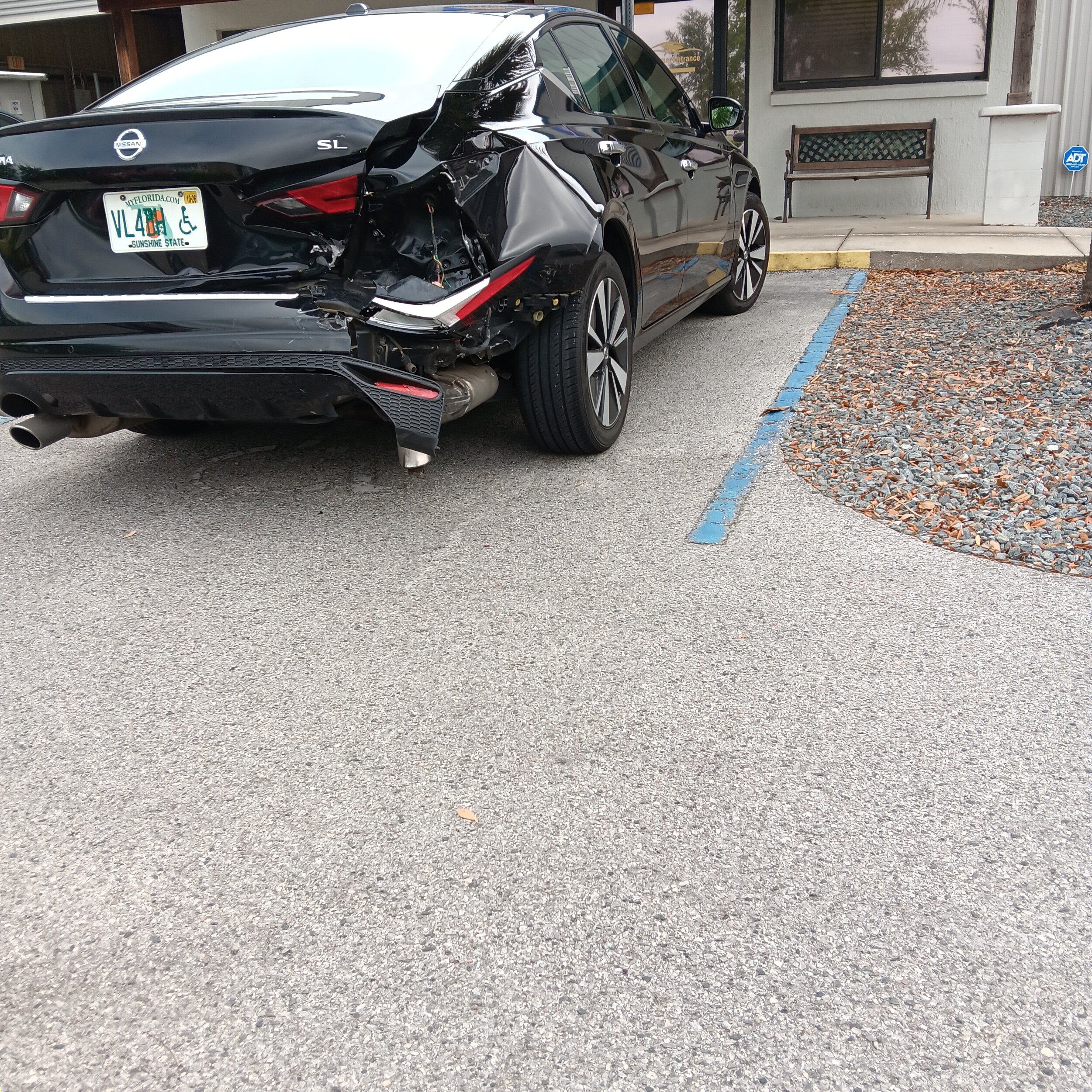

I see quarter, trunk, lights, bumper and bumper cover replacement. The rear/trunk bulkhead will have to be pulled, so time on the frame machine. If the quarter contacted the door, there is likely damage to the door, maybe full replacement. I say $7-10K assuming the bags didn't blow and that back glass isn't broken.

Collision center told me that the damage was right on the line of total
I'd have guessed it would be totaled, based on your photos. Between vehicle value depreciation, parts prices, labor costs and the markup on both, it doesn't take much to total a car out anymore.
