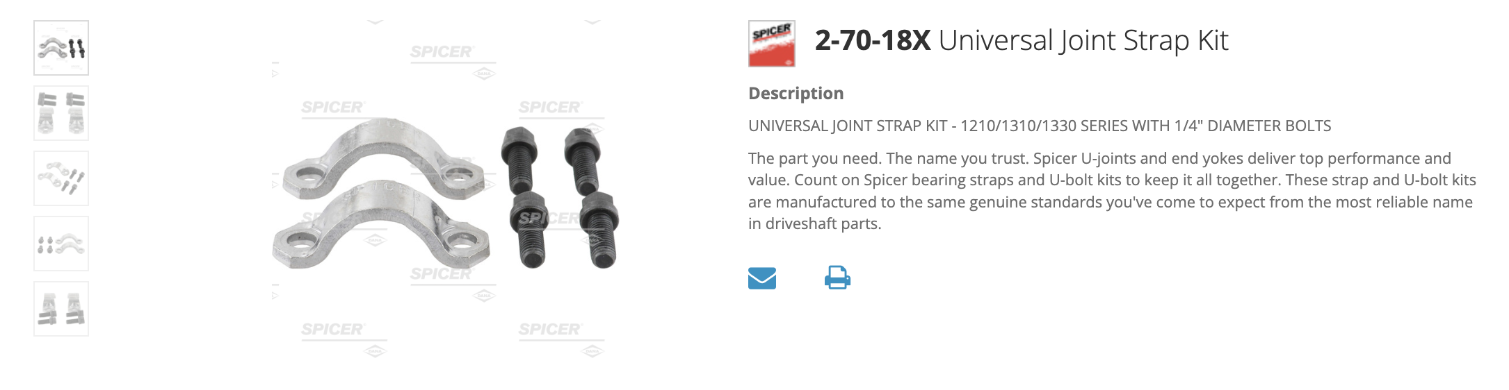

Yes, 1/4-28 is correct but no reason to purchase them separately if they are hard to find. They usually come with a new strap kit. Any local driveline shop should be able to sell it to you.
Thanks for the confirmation. But it is a very different world over here, driveline shops just not a thing. Ordered bolts from Amazon, here today or tomorrow.

Bolts arrived and used this, seems to be making a big difference. Thanks for the pointer.
