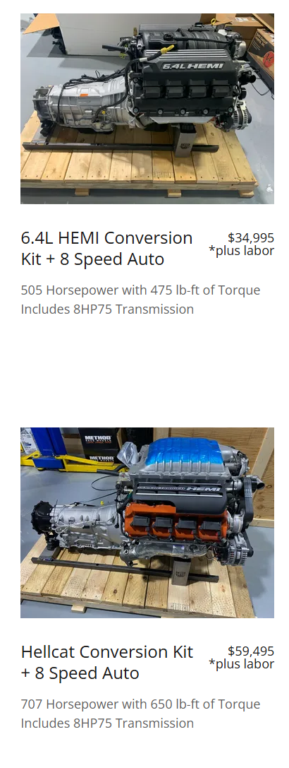

DIY vs them installing it? 22k seems insane to me but I guess that's cos I'm a DIYer.
Friends 2GR swap in MR2 was 18k I guess 😵‍💫
We know your ass cheeks couldn't pass a dollar bill you're so CHEAP....
This is into a JK/JL price but a TJ/LJ would be comparable I'd guess... But if you tried to source a Hellcat take out I'd guess you're at $12K minimum & you'd need a 4x4 8HP to go behind it since the Challenger won't work.
I so am. I have a friend and we always joke "ya don't pay off a house early spending money for X!!"
Holy moly that is expensive. They need to put a "spoiler" over those prices, no POORS allowed!!!
