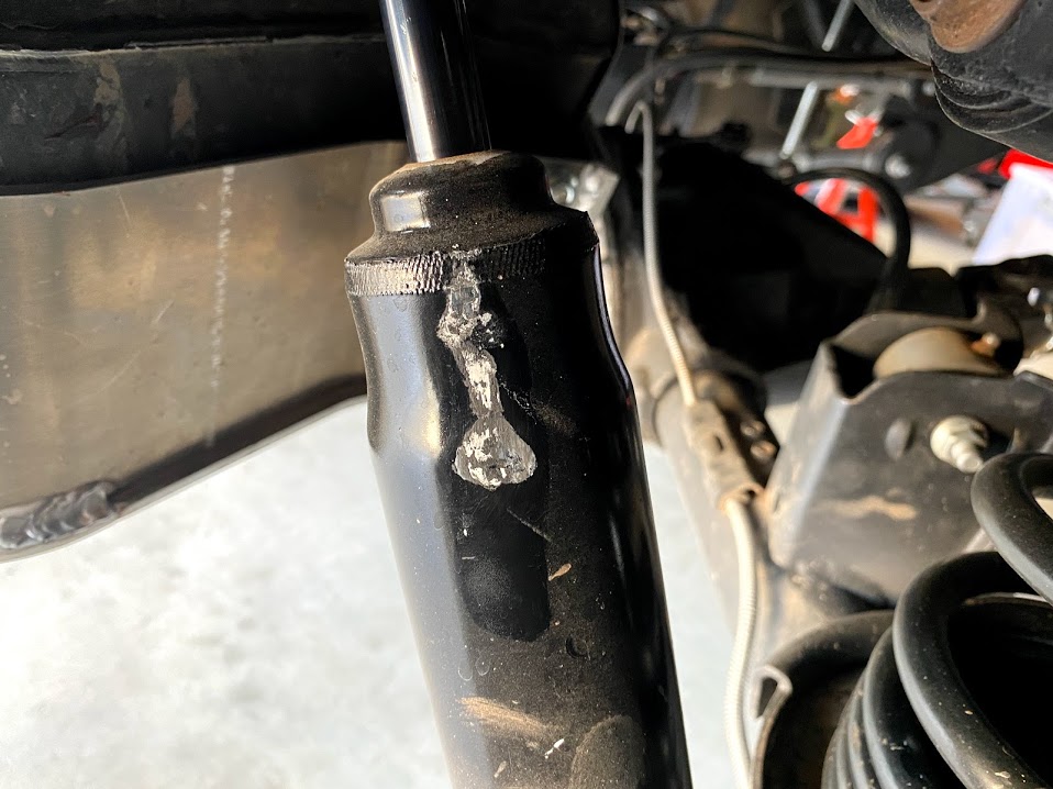

Have you cycled your rear suspension? If my lower shock mounts were moved that far out the shock would hit the frame at articulation.
I have and get a very slight "kiss" of the shock on the frame rail during full articulation. Clayton warns of this - they say that "big body" shocks may rub.
You can see the passenger side shock here where the black paint gets worn off and the white paint below pokes through (or in some cases also gets rubbed off). This photo was taken on the TJ, the LJ is basically the same. Someone said that the R5000x series shocks have a large rebound bumper inside the body that sits inside that contoured portion of the shock (at full extension), so this wouldn't cause any long-term issues and I haven't seen any. It hasn't shown to be problematic, so as the LJ wears the paint down here, I'll just touch it up to keep the rust away and call it good (until I get around to installing the mid-arm and outboard setup).

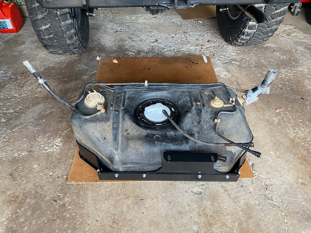

The new Delphi fuel pump module arrived, so I went a cleaned out the tank and did the filler mod while I was there... (pre-mod photo below):
With everything in place, I went and installed the tank, or at least I tried to. With the Savvy GTS orientated in the "highest" position (i.e. most ground clearance setup), the top of the vapor/emissions hoses were pressing against the tub. I removed and repositioned the tank to the lowest setting for now and may revisit going back to the taller setting in the spring time when it's warmer and I have time to fiddle with it.

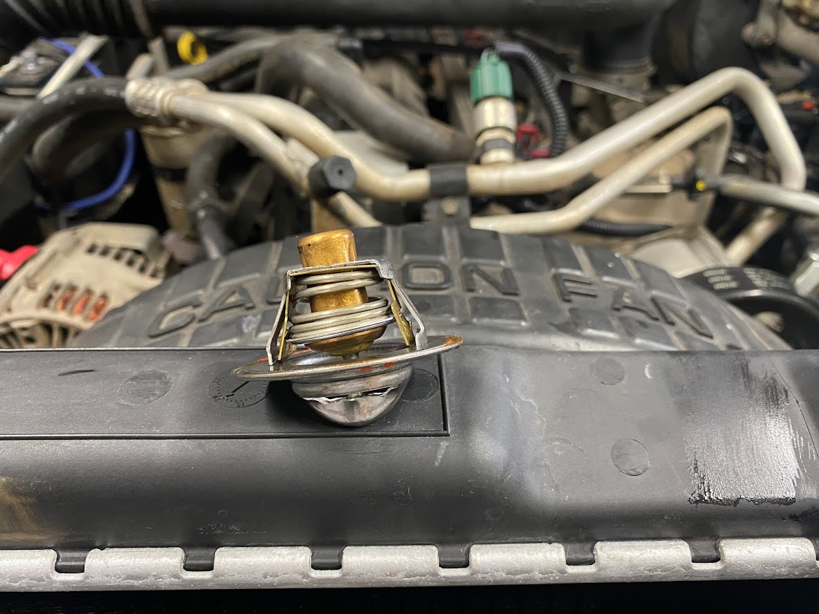

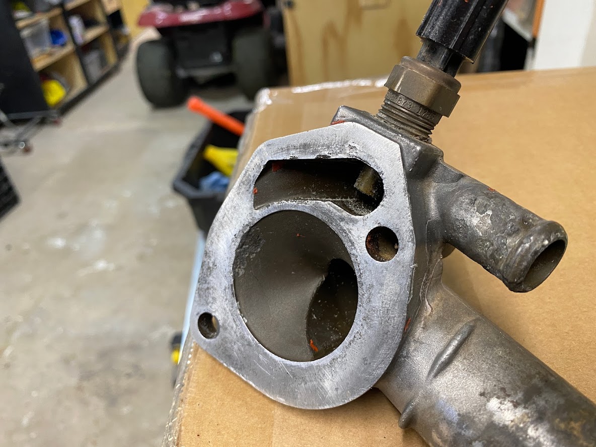

When it finally cooled down last week I noticed my engine temps were barely above 160º, so I figured another Fail-Safe ironically failed.
I had a new Super Stant 195º in the parts bin but the t-stat housing was known to cause me some grief and there was some obvious pitting, so I went and decided to replace it.

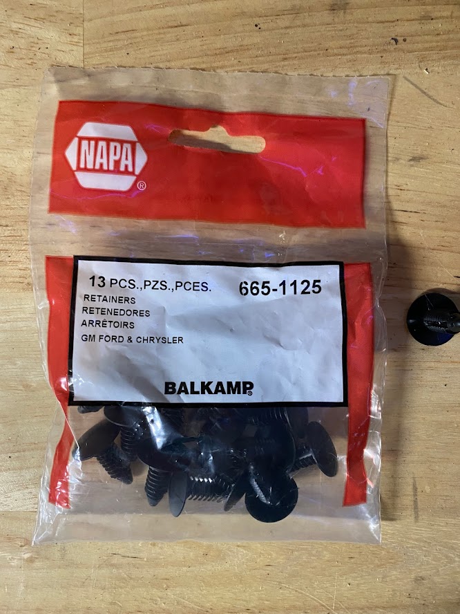

At NAPA, I found the perfect panel clip replacements for the wheelwell liners - photo below shows the P/N if you ever need it...

With the tank out, are we able to see the charcoal can up there ?
My check engine light is P0441. Changed the purge valve but did not help.
Reactions: pc1p
You don't need to remove the gas tank to see the charcoal canister, at least not on the 05-06... I can get to it by simply removing the wheel well liners and reaching up in there. What I've seen on evap codes like this is that the charcoal canister itself has failed, allowing charcoal bits to move through the system. I would remove it, clear the lines with some low pressure compressed air, and replace the canister with a new one.

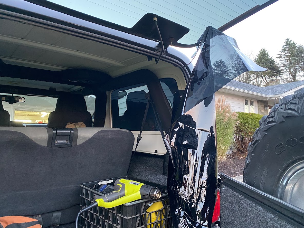

As the days continued to get shorter and darker, I thought it would be a good idea to see what I could do about visibility through the windows of the hardtop...
A couple minutes with the scraper and heat gun and I was able to get all three rear windows pulled clean of the 5% tint that was overlaid over factory tint. This has been a huge improvement in invisibility visibility - I can actually see when backing up now!

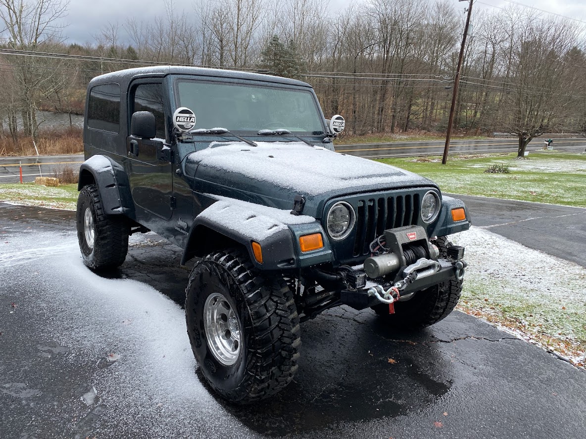

Got our first snowfall too - about 2-1/2" in total - so I had to play around. The LJ handled great, which was a surprise considering all the "yOu'Re GoNnA dIe On Mt/Rs!" comments on various forums and FB pages.
