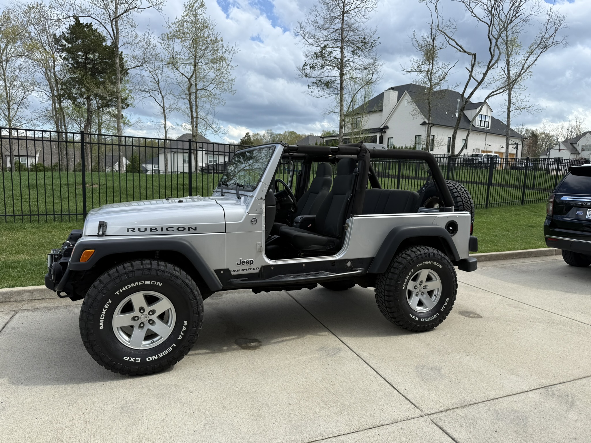

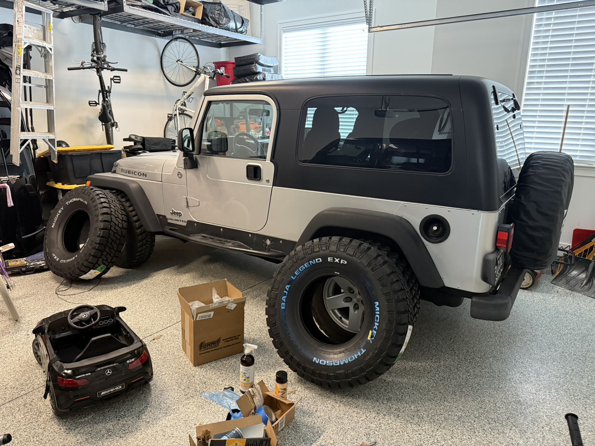

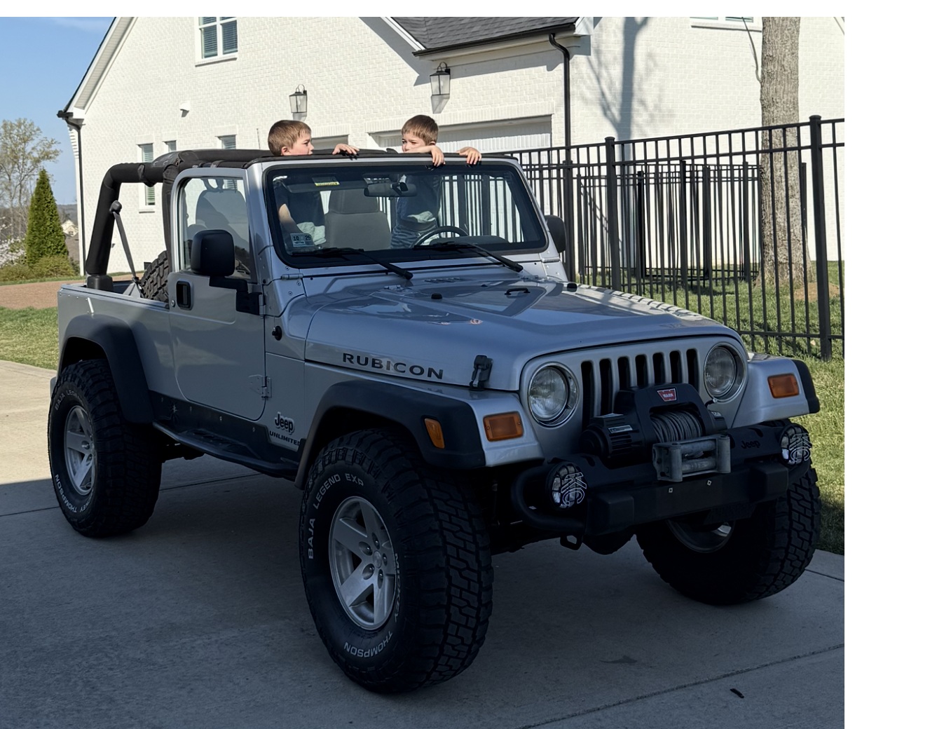

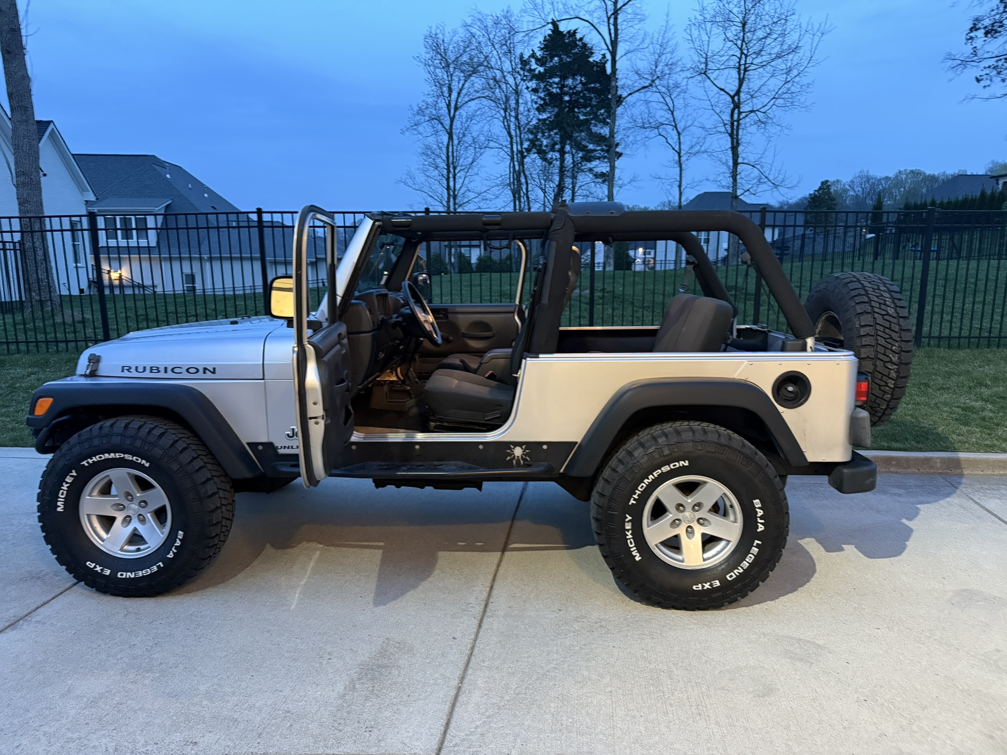

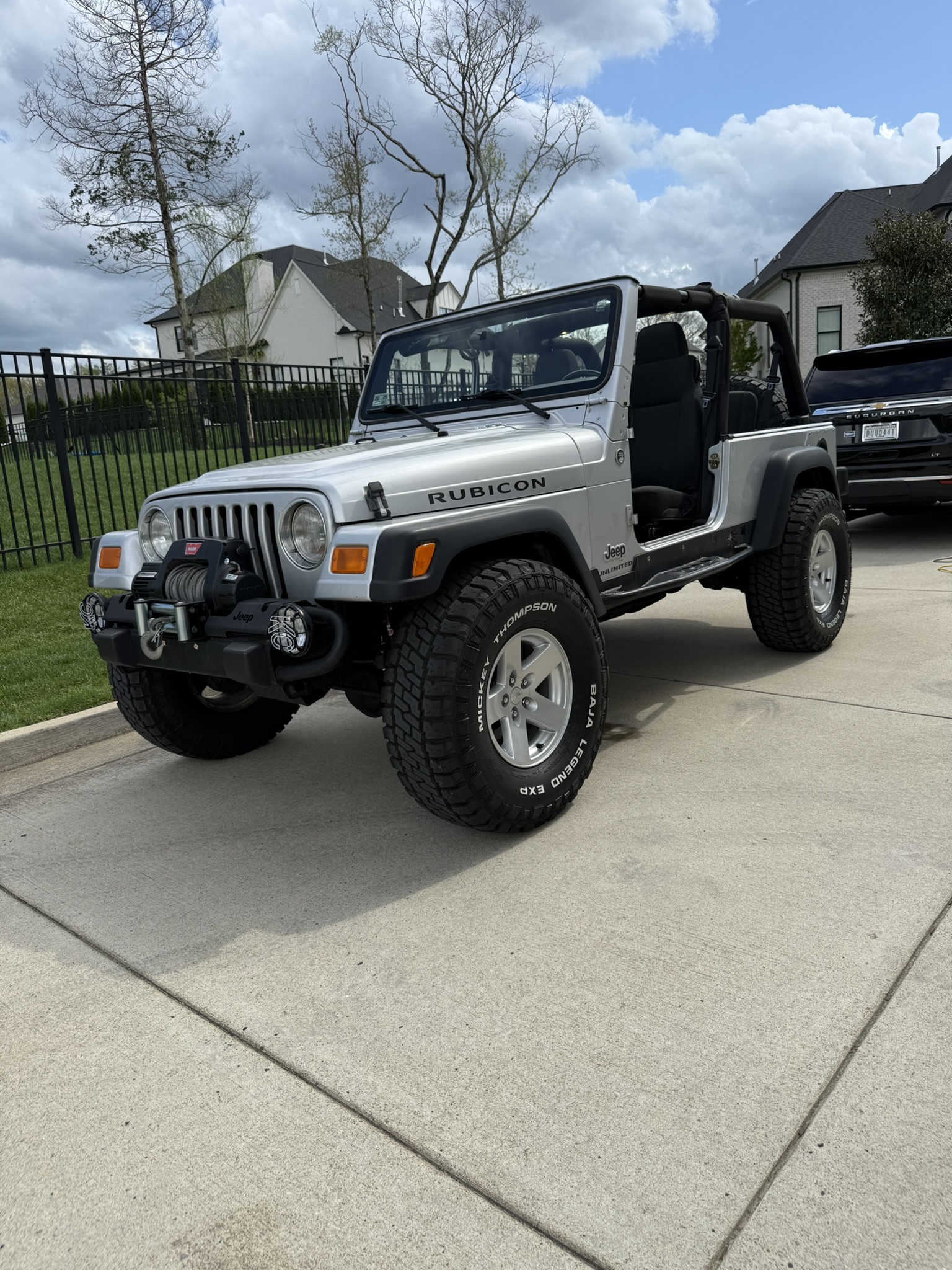

Overall, its a 2 inch lift with 35's. I wanted to keep it as close to stock as possible, but give it a more aggressive stance and look.
Here is what I have done so far:

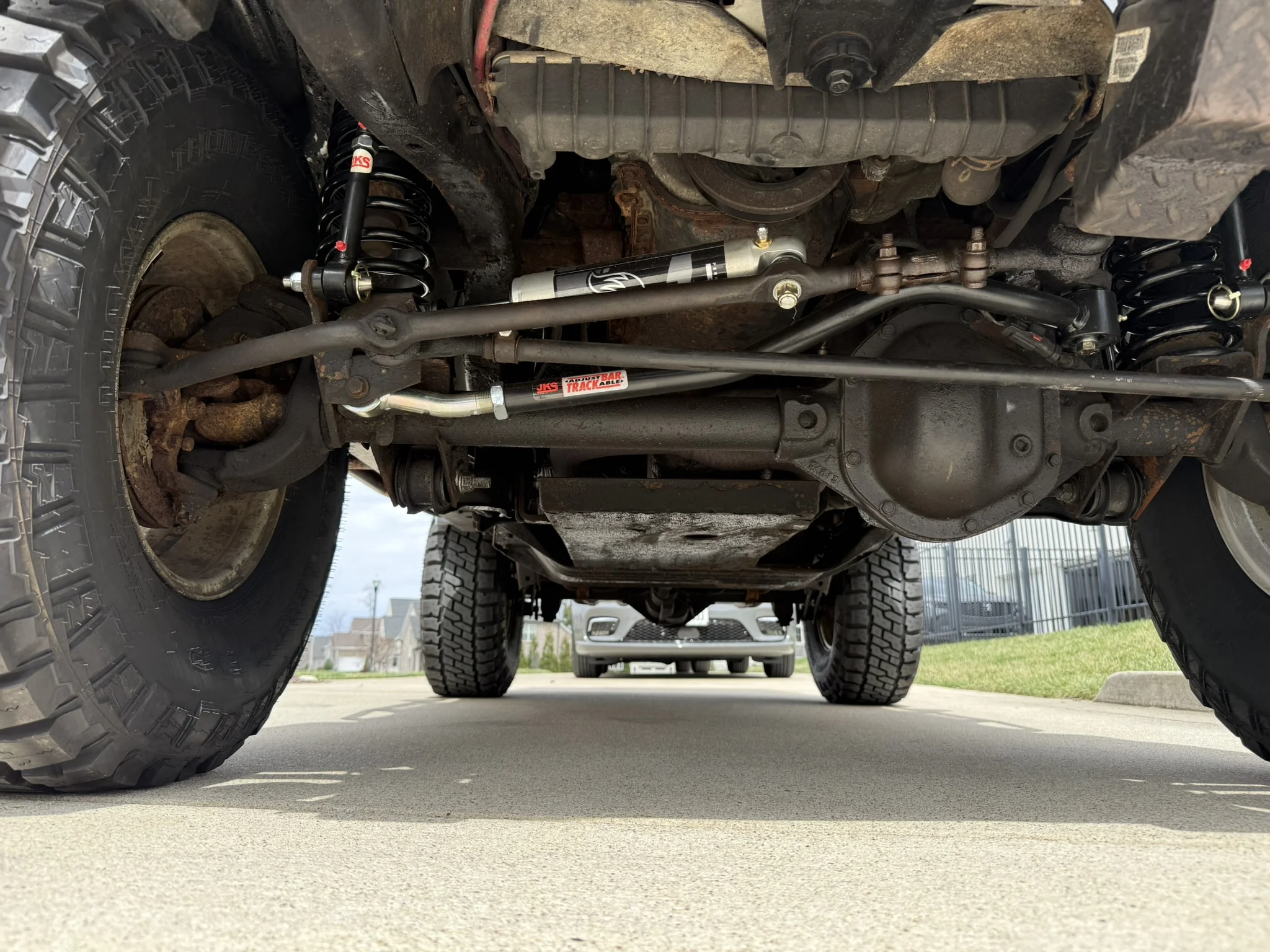

  • 11 - New Body mounts
  • Front and Rear Dual Rate Coil Springs
  • Fox Adventure Series Shocks
  • Front Adjustable Trackbar
  • Front Sway Bar Quicker Disconnects
  • Front Brake Line Relocation
  • Rear Track Bar Bracket
  • Rear Bump Stop Extensions
  • Fox Performance Series Steering Stabilizer
  • 1.25 inch spacers
  • 5 - 315/75/16 Mickey Thompson Baja Legend Tires on factory wheels
  • Upgraded spare tire carrier
I am about 85% done with the build so far, and the only remaining items are the TJ half doors, custom floor mats for front back and trunk, and new LED lights for headlights and fog.

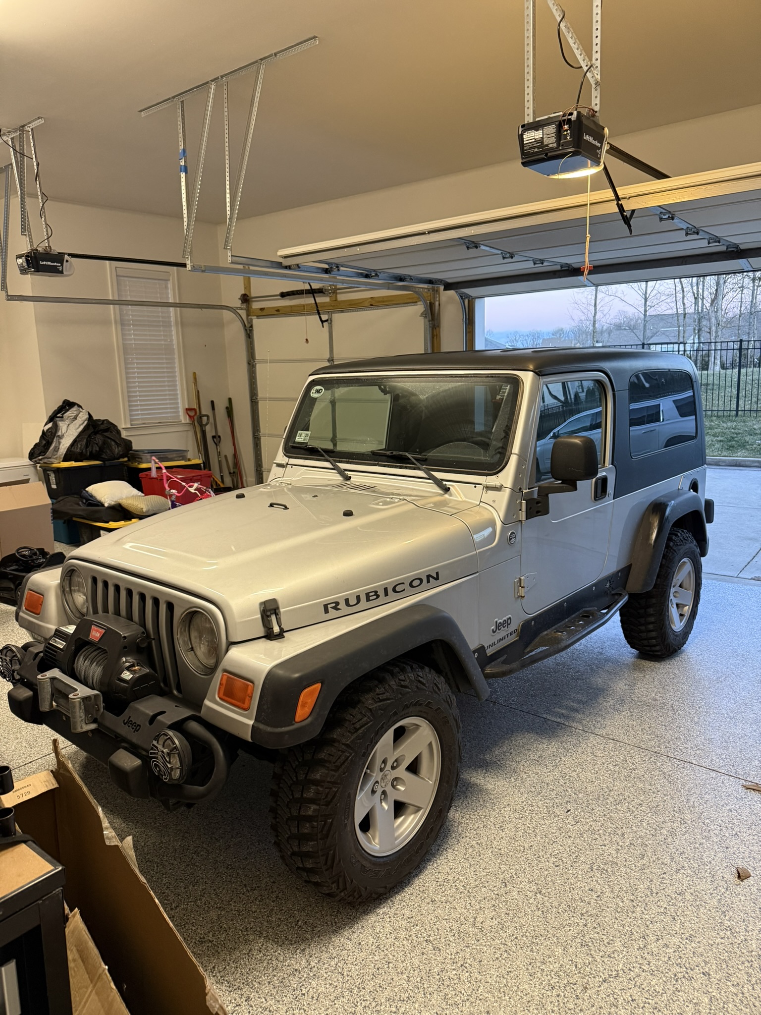

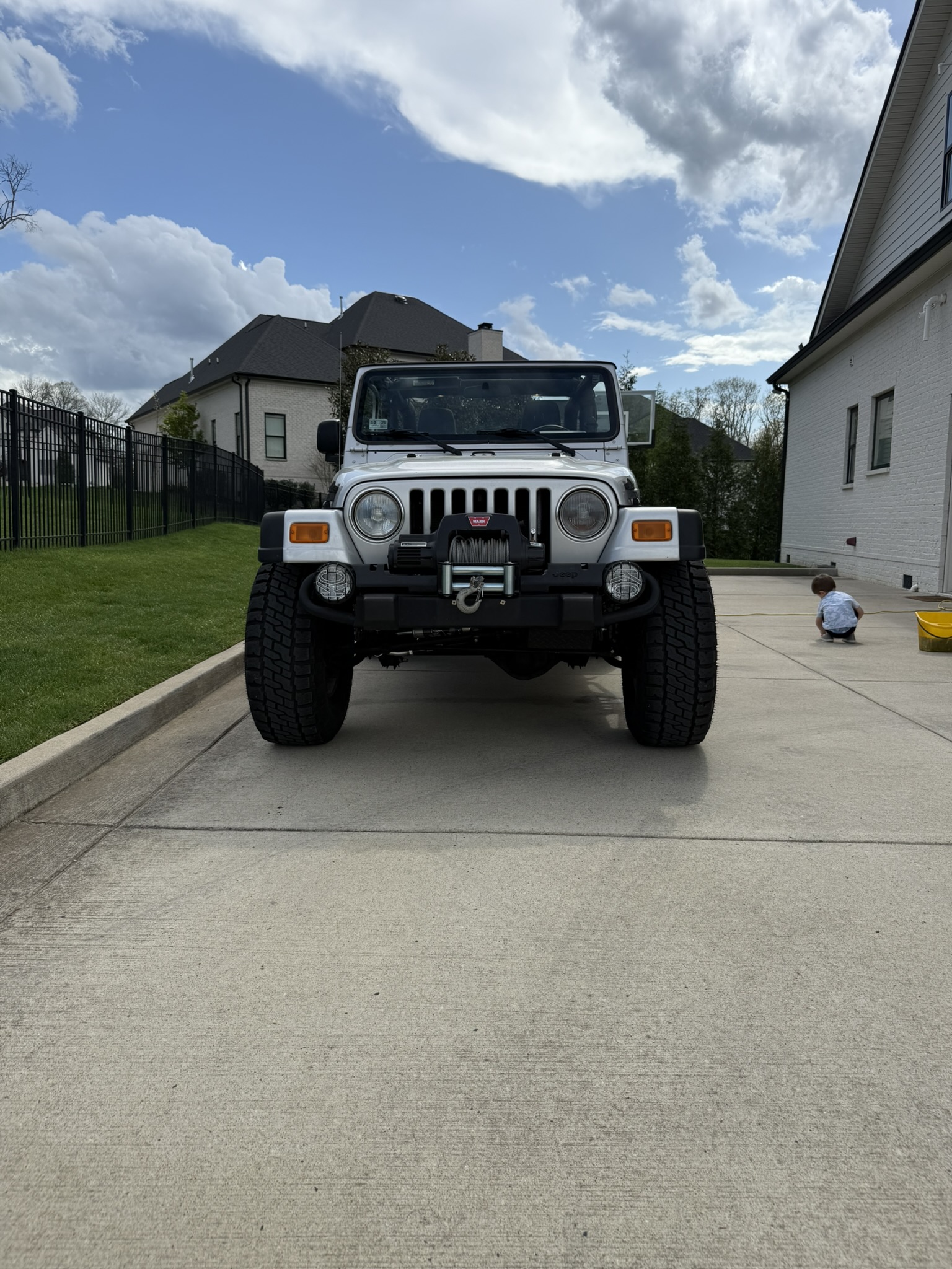

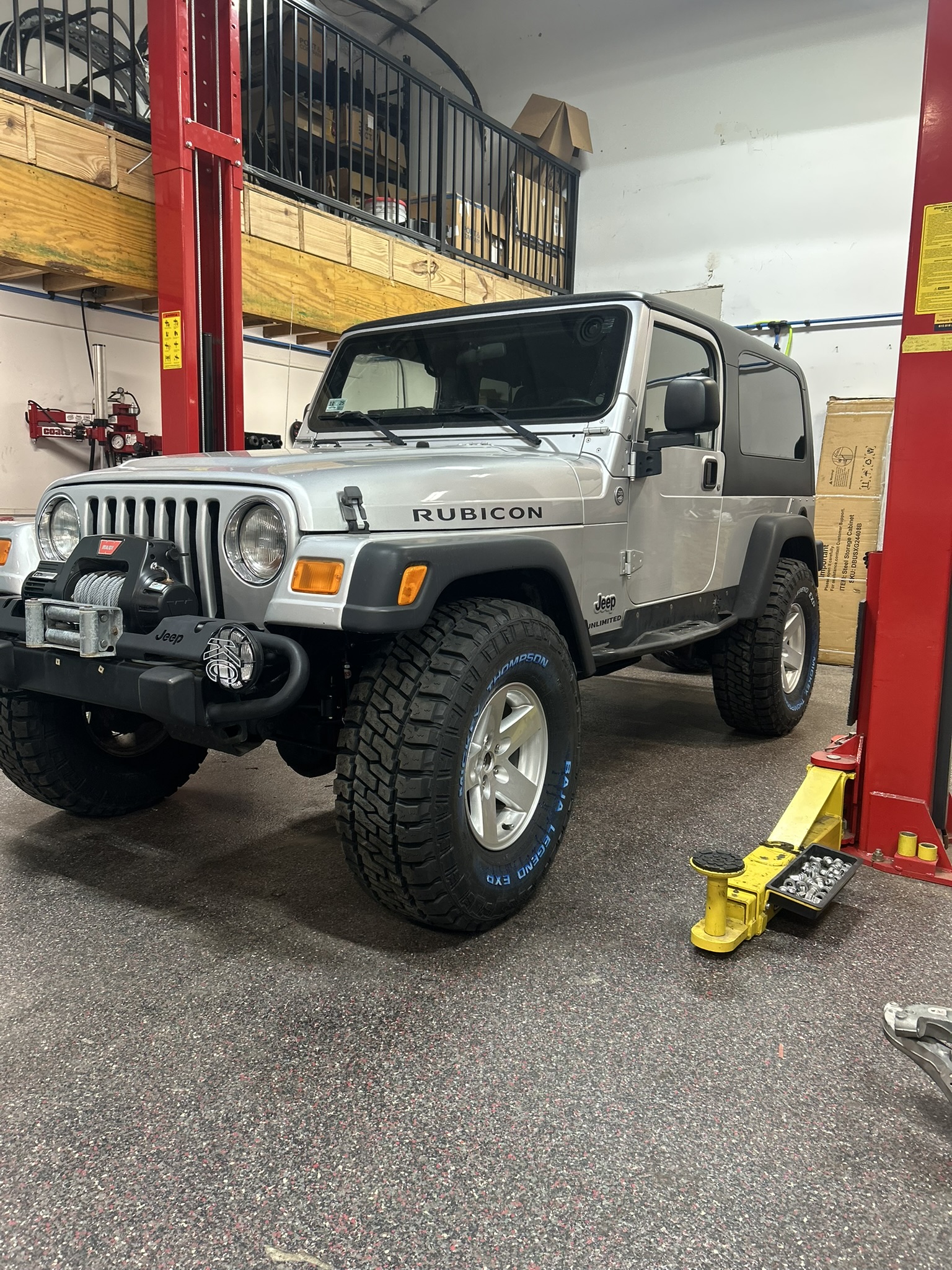

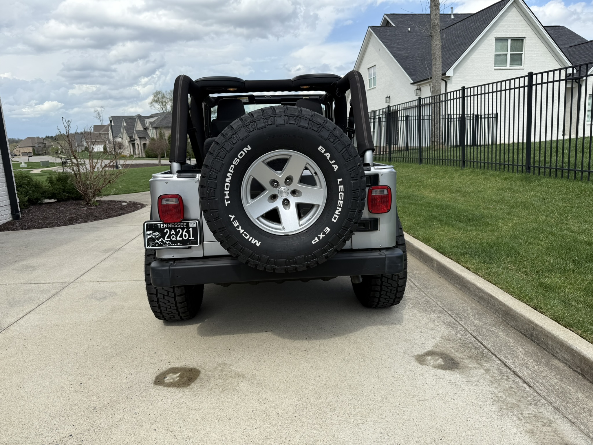

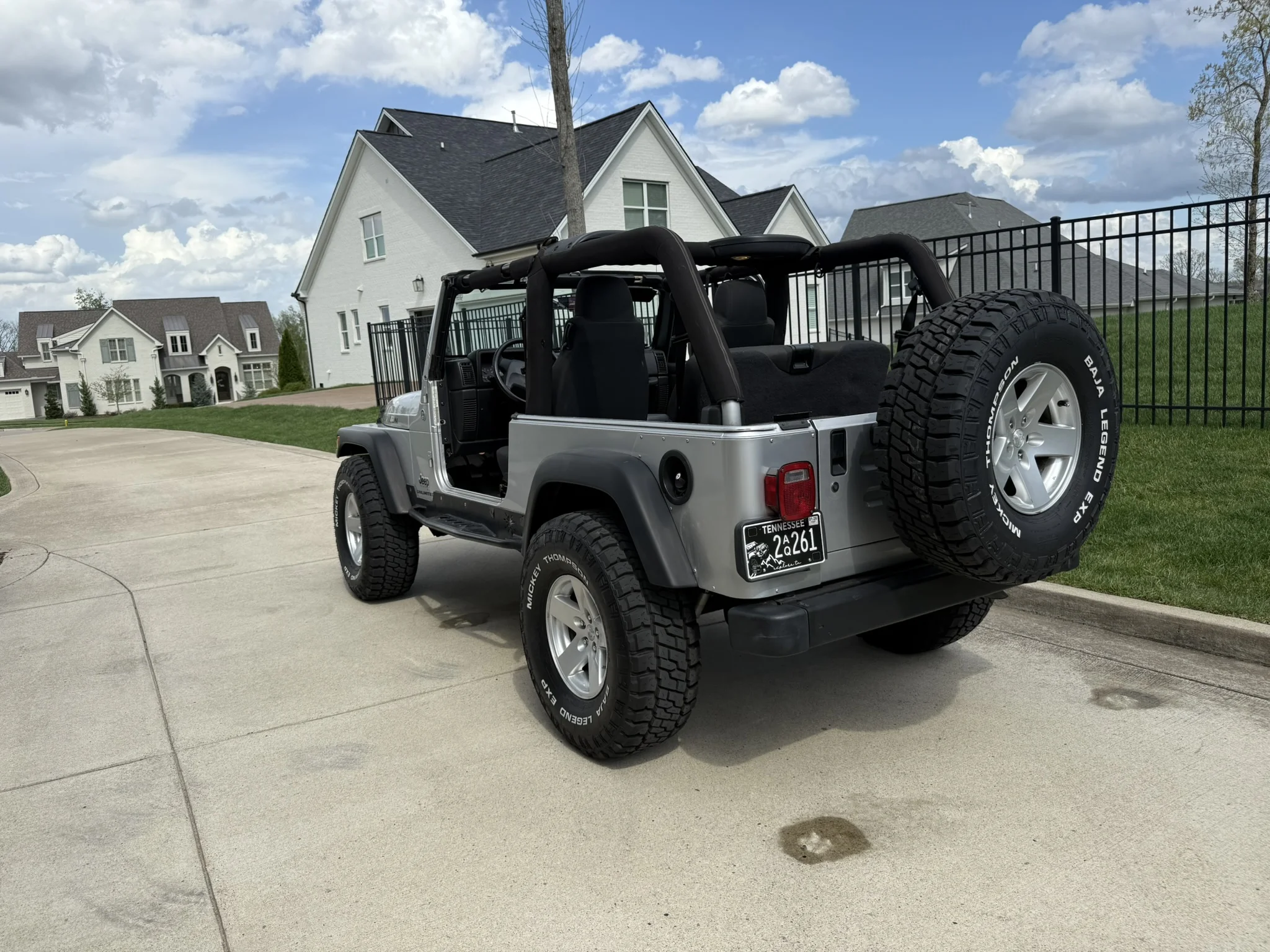

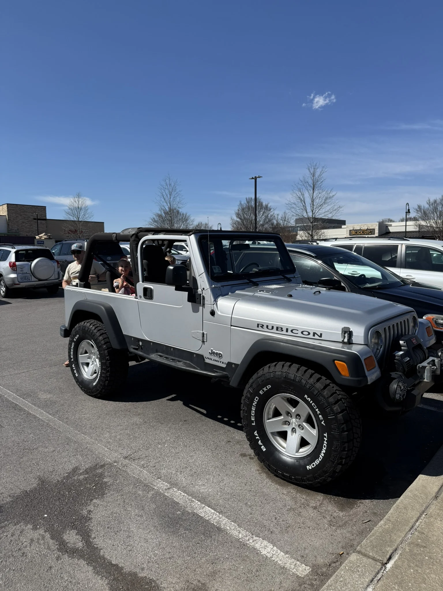

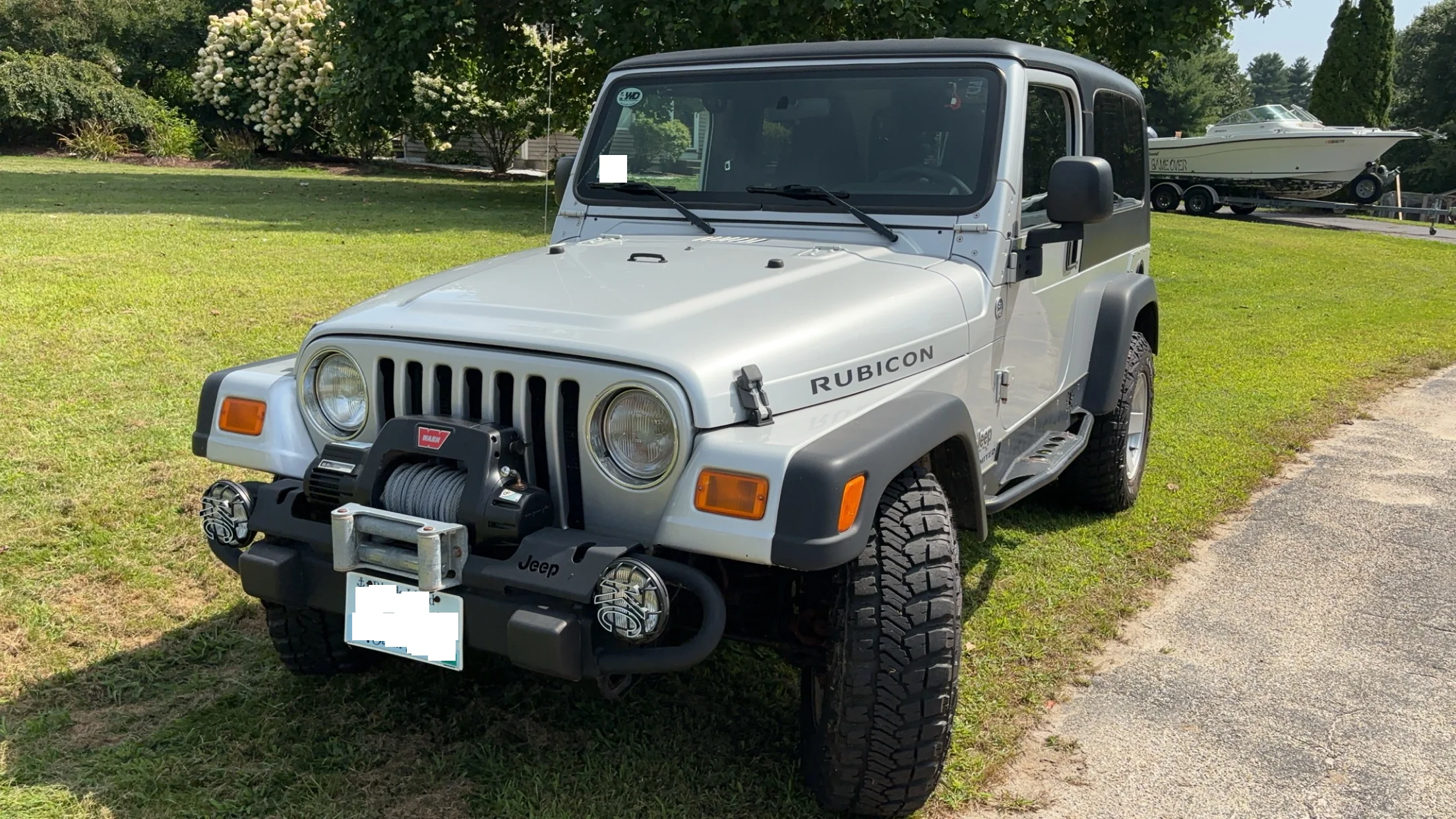

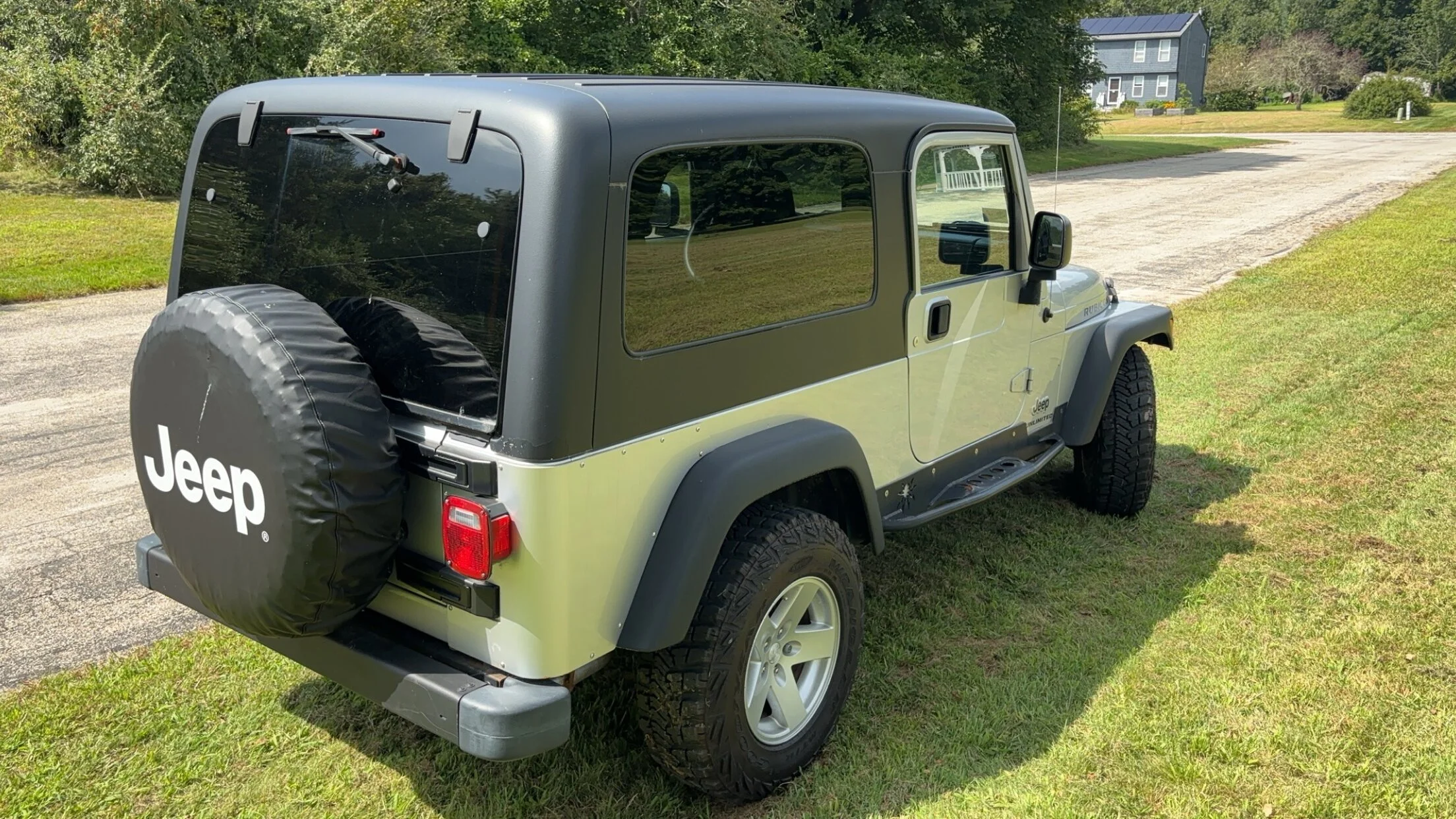

Here are some before and after pics
Before:
After:
