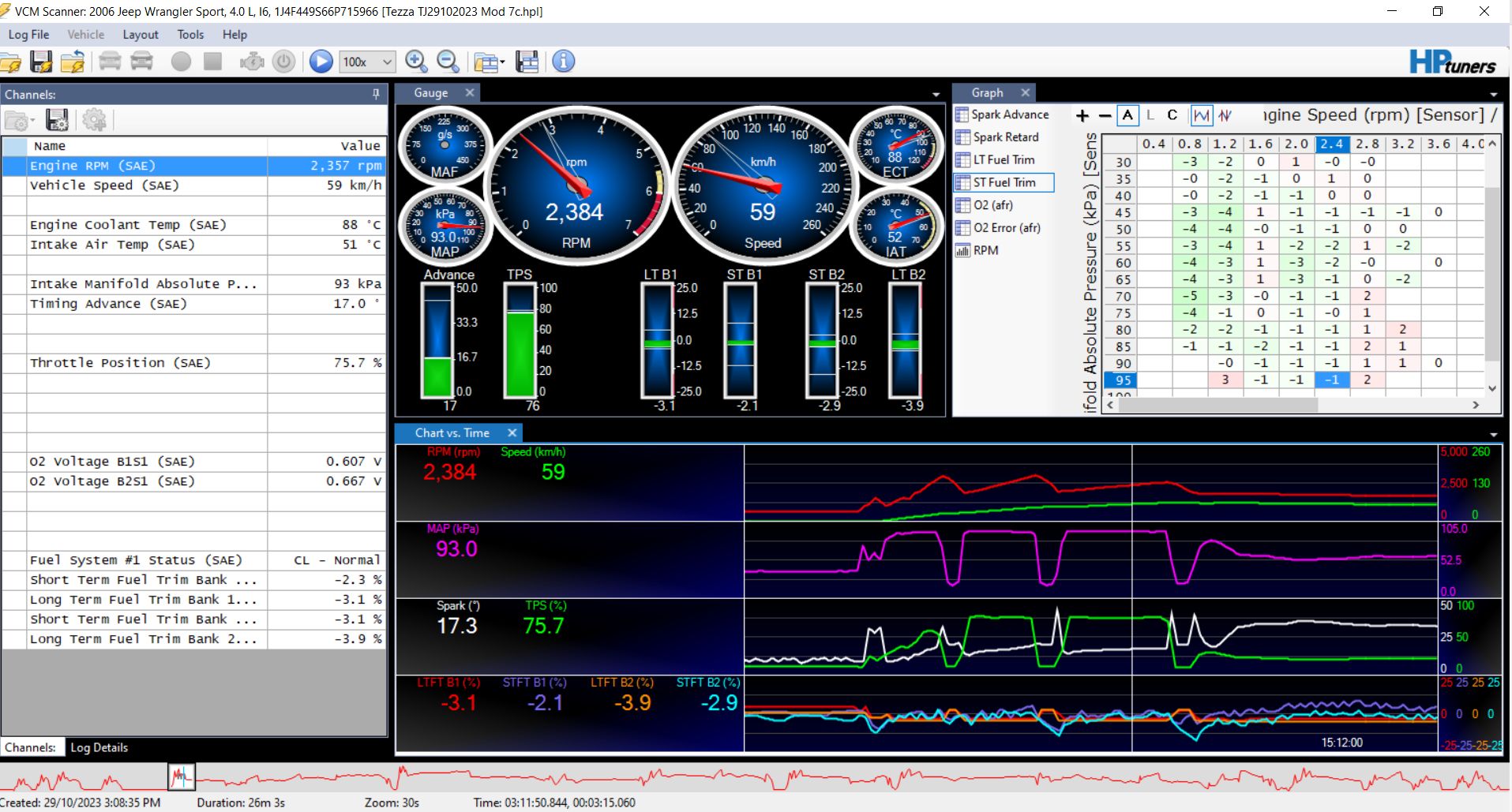

What I have seen ( not on my Jeep) certain conditions the engine can go back into open loop and use values stored in the pcm for fuel and timing. My experience is it usually happens at idle or wide open throttle. I don’t usually see it on OBD 2 vehicles but TJ’s are early OBD 2 vehicles so you may see this happen. I have not played with mine enough to know.
Reactions: 2000tjguy
Never heard off long term vs short term closed loop.
I've read that the closed loop tables can be influenced by long-term fuel trims (which of course are adjusted by short-term fuel trims)...that all sounds good to me but I know next to nothing on how it all works.

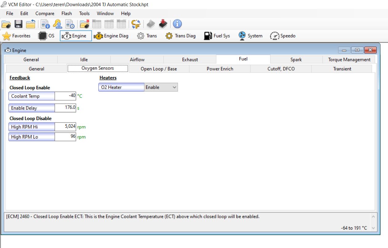

Info from 2004 TJ , JTEC+ , PCM, 2006 has similar enable temp for primary O2 sensors.
I think you are referring to adaptive learning where the pcm learns the needed parameters for certain operating conditions.
Just found this:
I have that one (Part I), along with Part II, and Part III in hard copy. I found them on eBay. I'm too lazy to scan them, so having them in pdf is awesome. Now, we just need to find Parts II and III in pdf form!
I put all the PCM documentation JTEC, NGC on the manuals thread long ago, go through it and you will find them.
Well, heck. I wrongfully assumed that all the manuals had been updated to the first post. I just found your post with a Google search. Awesome - thanks for putting those in there! Now I have to page through all twelve pages to see what other hidden gems I've missed...
