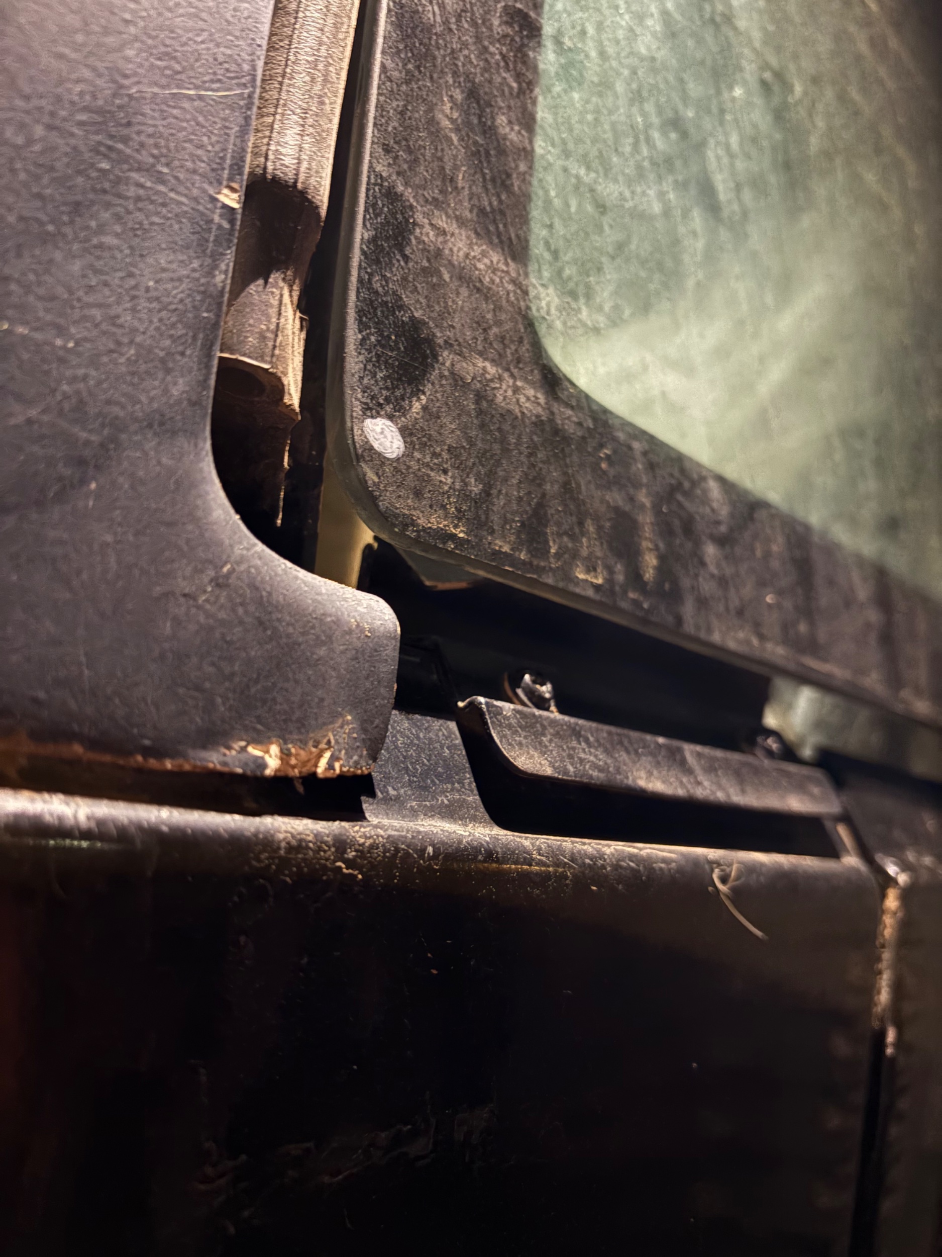

On the topic of hard top vents

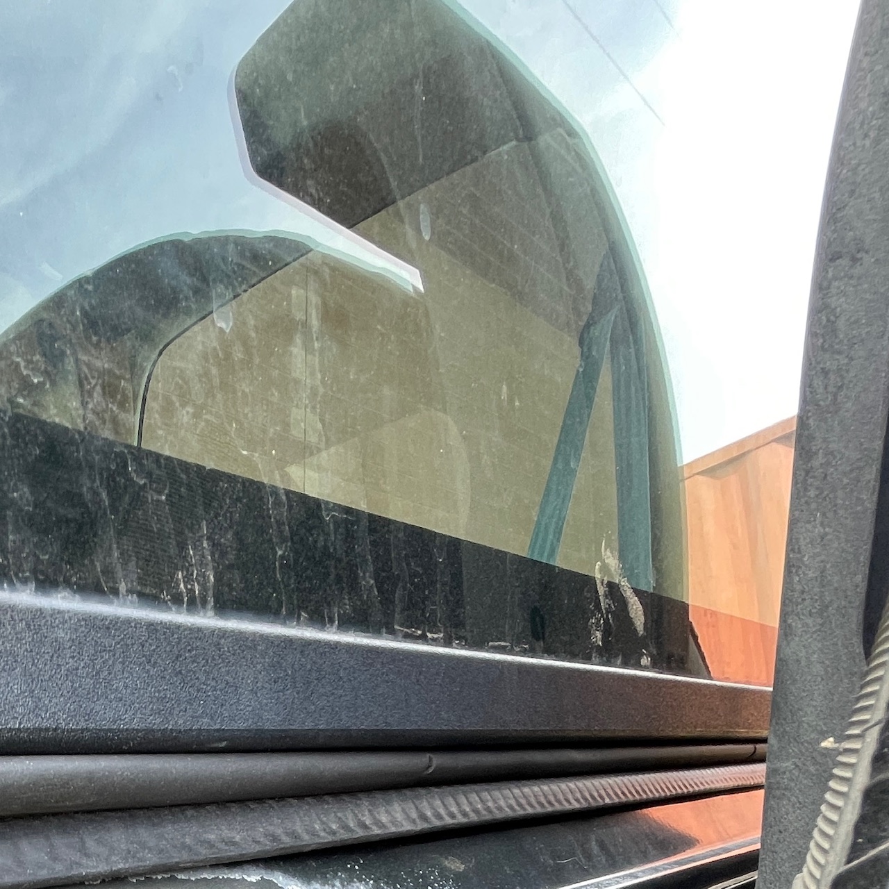

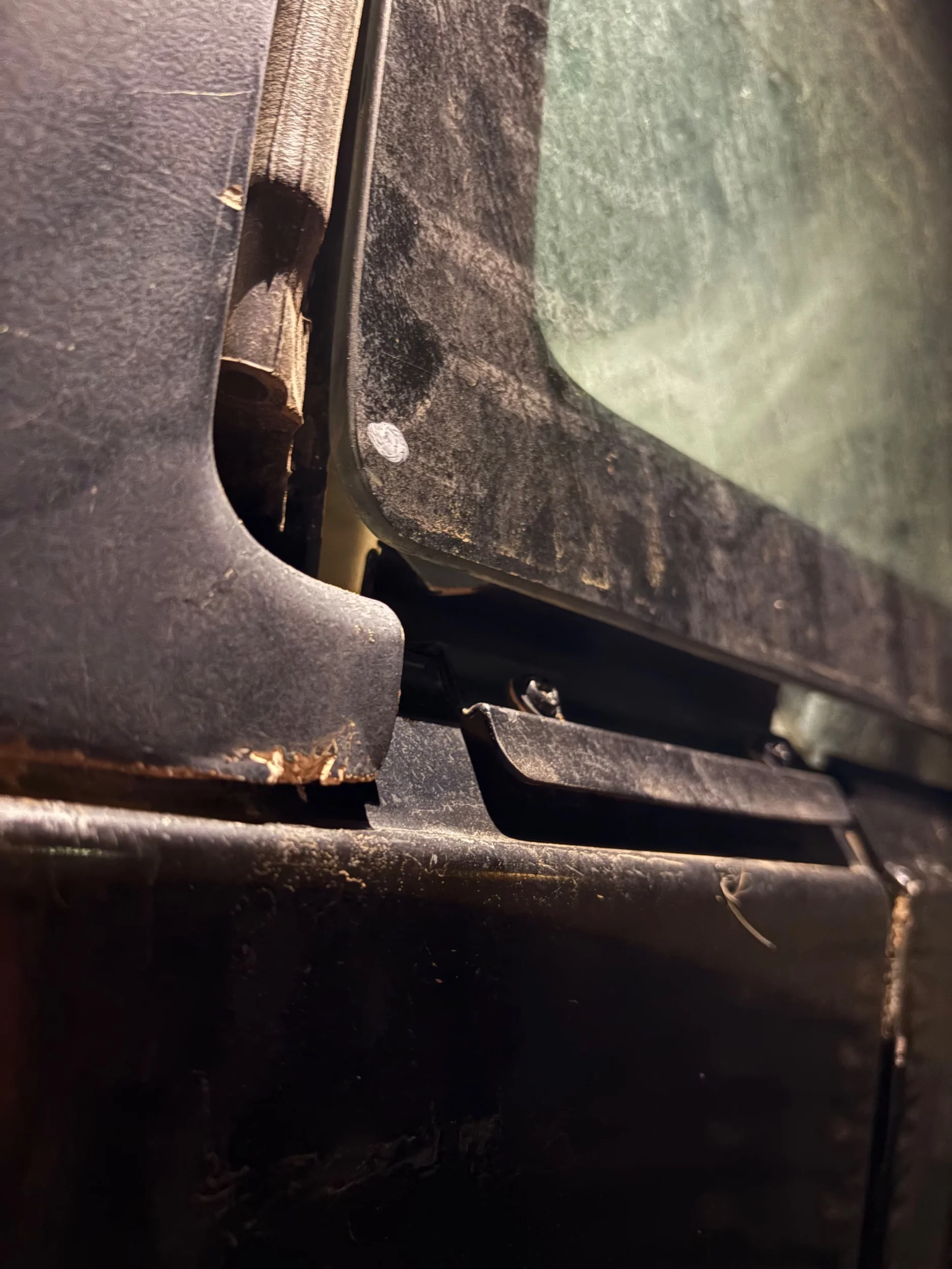

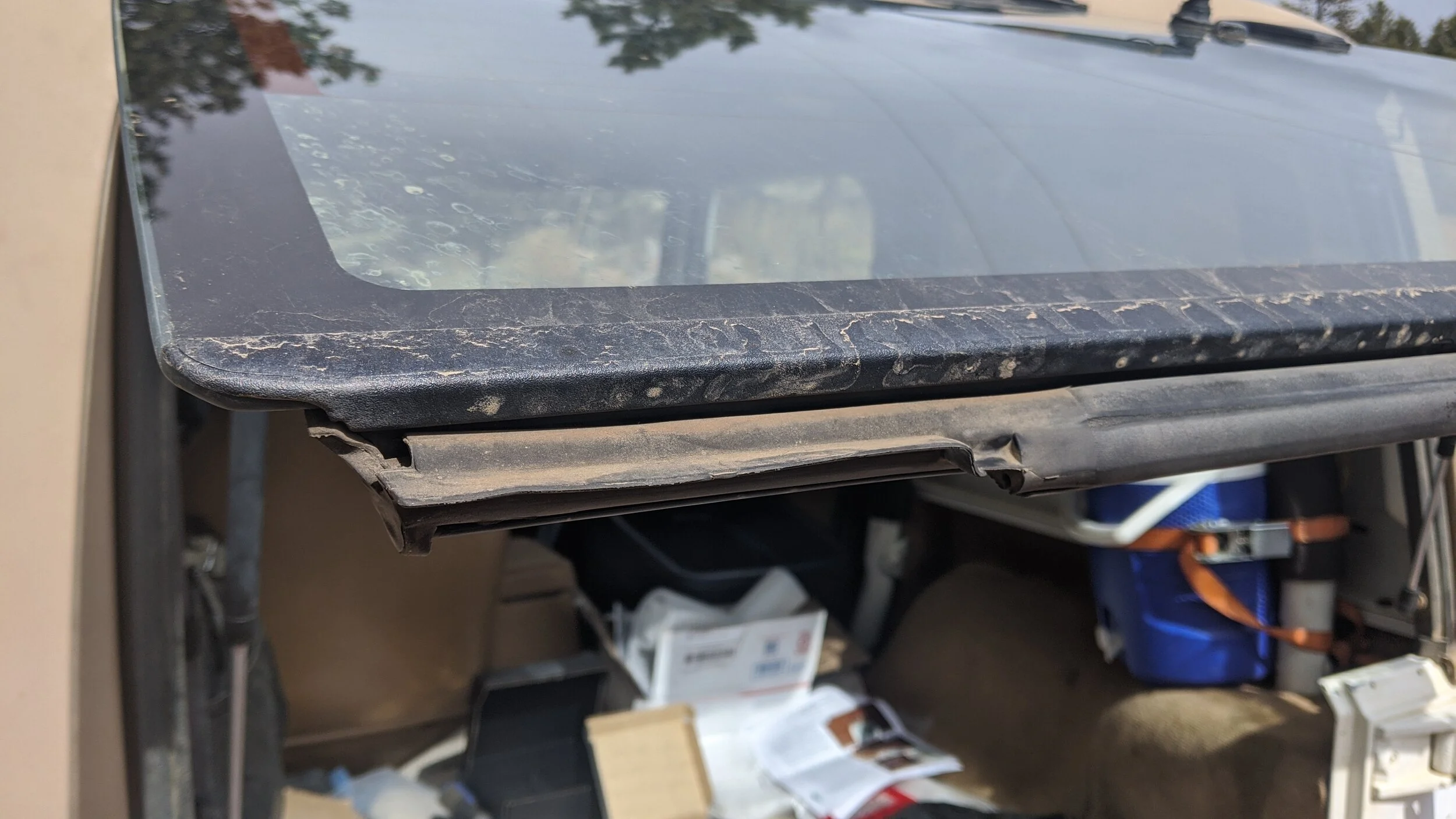

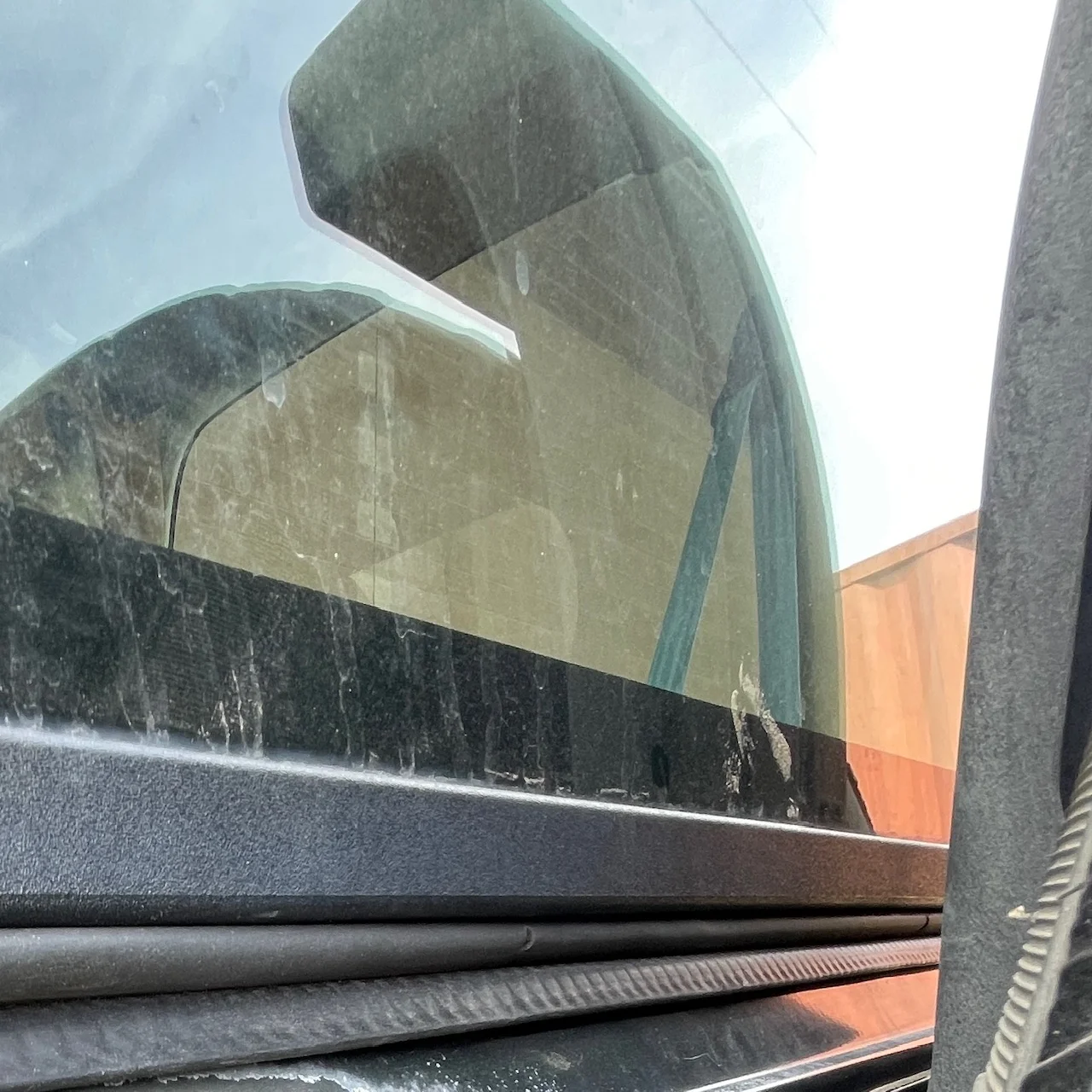

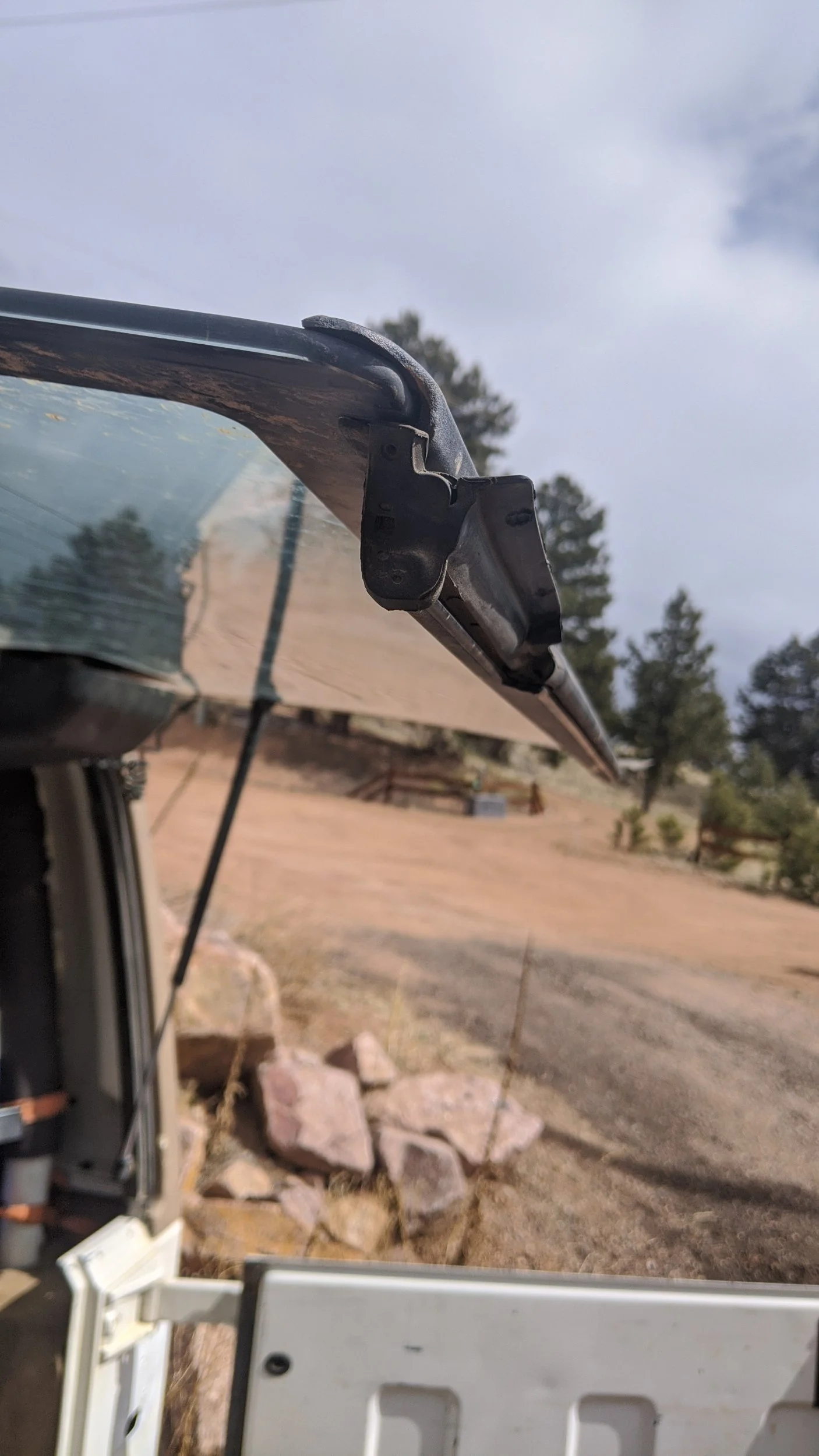

The two 97s I've owned or worked on didn't have a weatherstrip on the tailgate top. Just the one on the lower glass edge
LOL I have one of each. The pair of '02's don't. Le sigh. I guess this free hard top has already cost me:
$60 vents
$20 lift struts
$54 lower seal thingy
$22 fiberglass repair kit
$? paint
I haven't even taken it off the donor jeep yet.

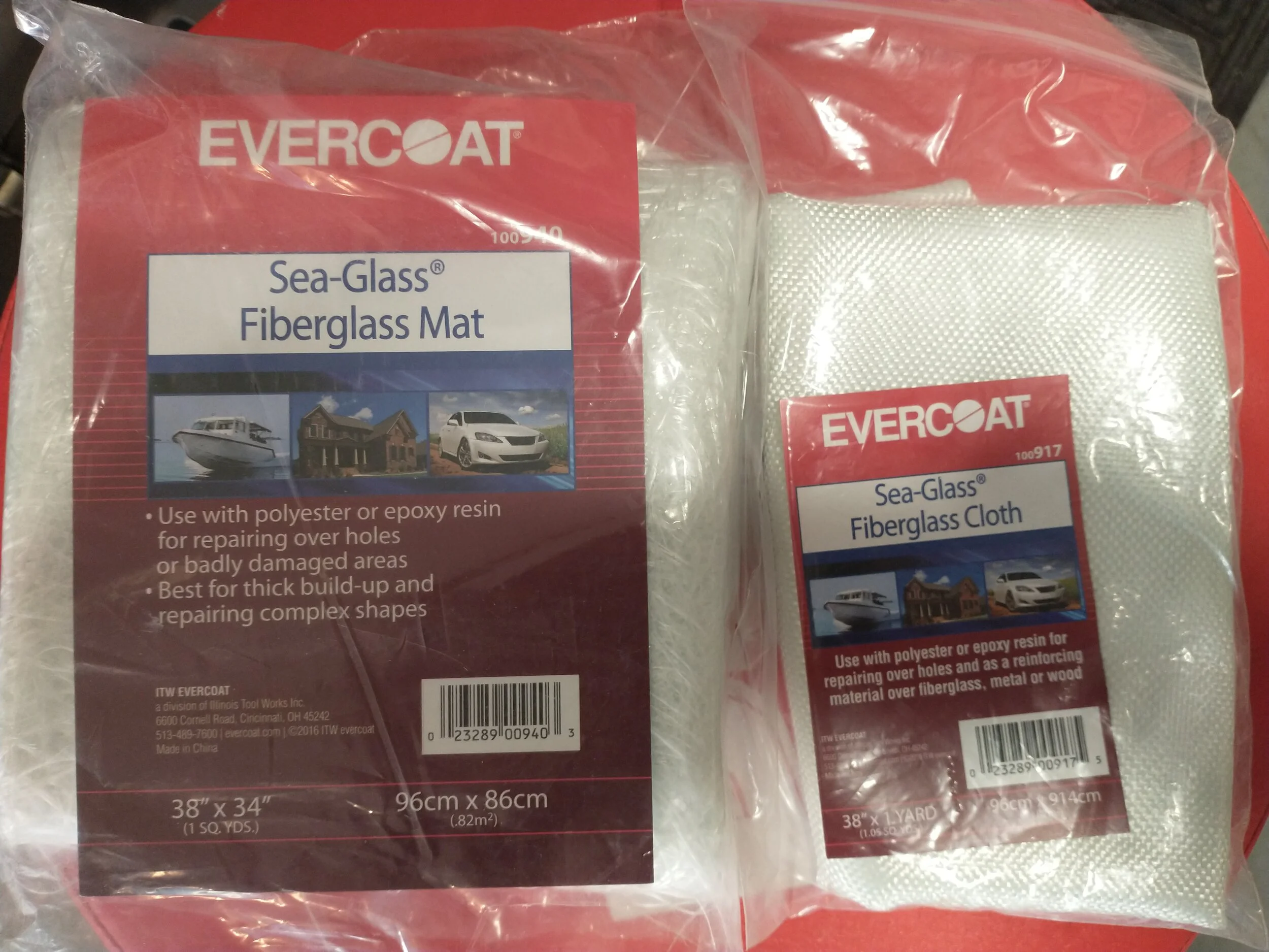

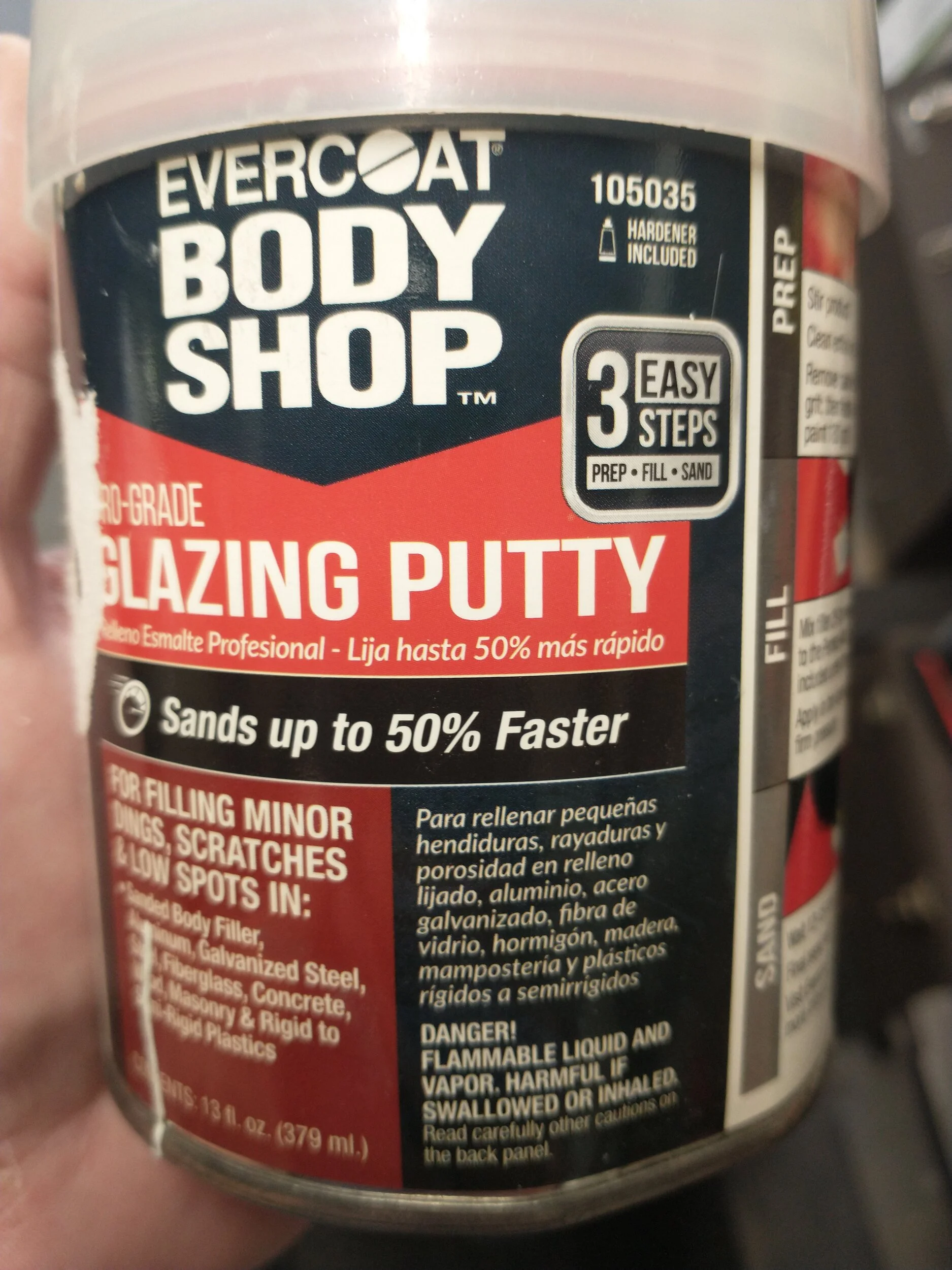

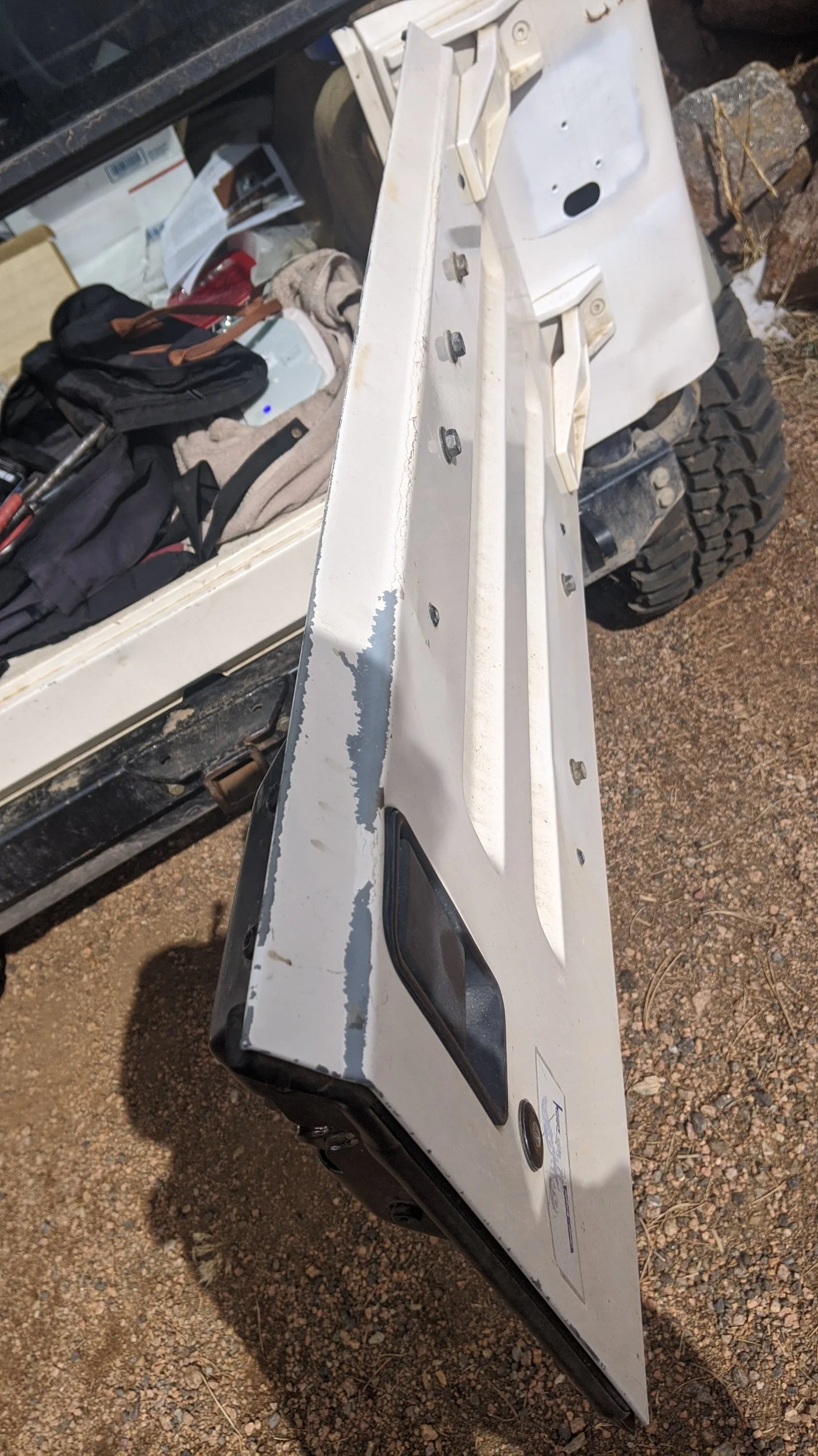

will fiberglass the cracks

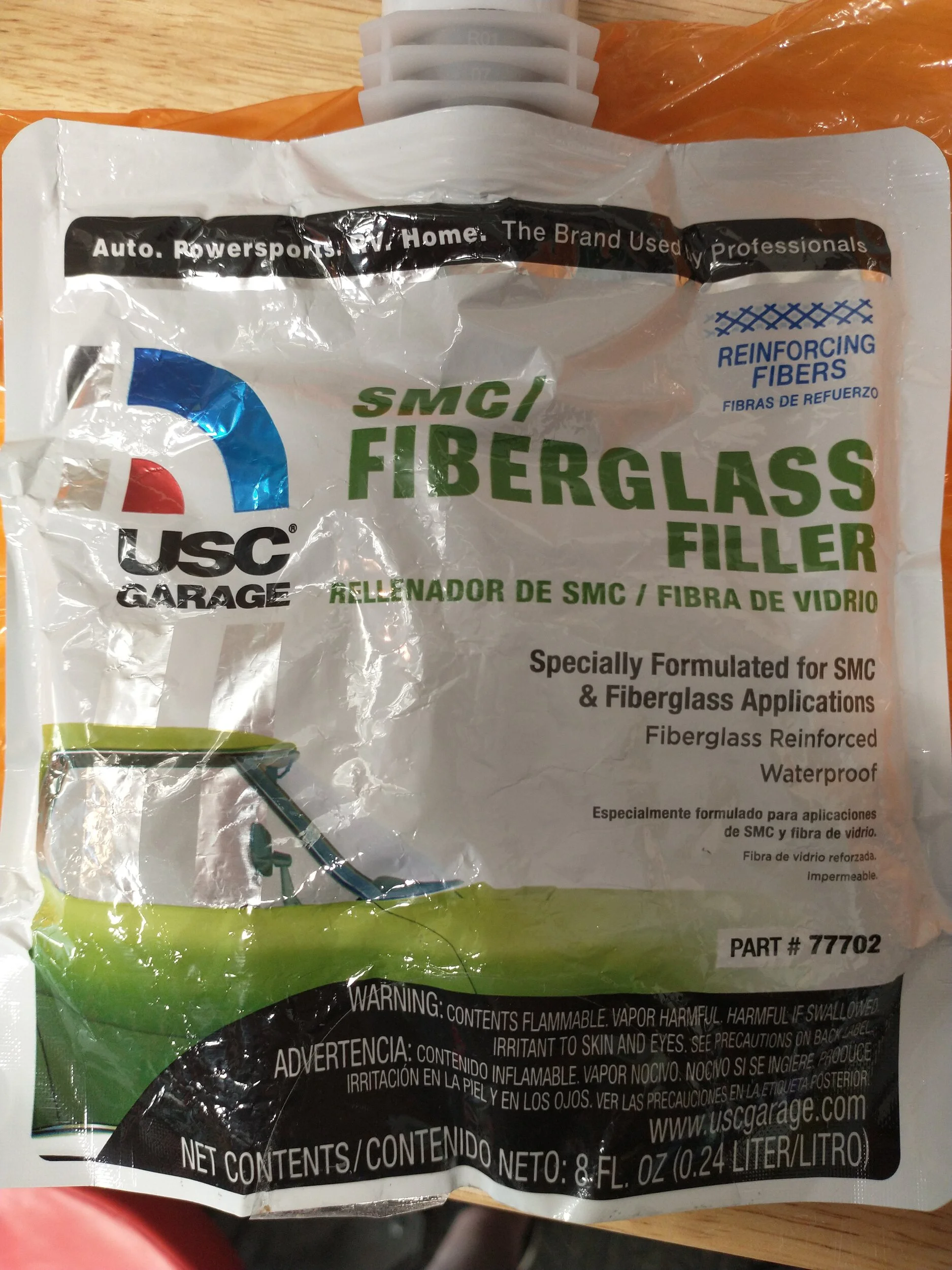

Not sure, but I would suspect the older tops are made of the same SMC material as the lid on my '05 LJ. If that's the case, be sure to get the proper repair materials. If the repair products are not rated for use on SMC, you'll likely have further issues with anything you "fix".
  • Face Palm
Reactions: hear and Rickyd
Having watched exactly one video of a kid fixing his JK top, he used this stuff. If there is a specific SMC product, I'm not seeing it. But your post was the first I had ever heard of SMC, so ignorance is a real factor here. :)

Come to think of it, the left over fiberglass made the plastic brittle engine hood cover on my lawnmower repair fabulous. 🤫😀
https://www.amazon.com/dp/B000BO9NOO?tag=wranglerorg-20
First post link explains a bit about SMC, second list products I can confirm work.
