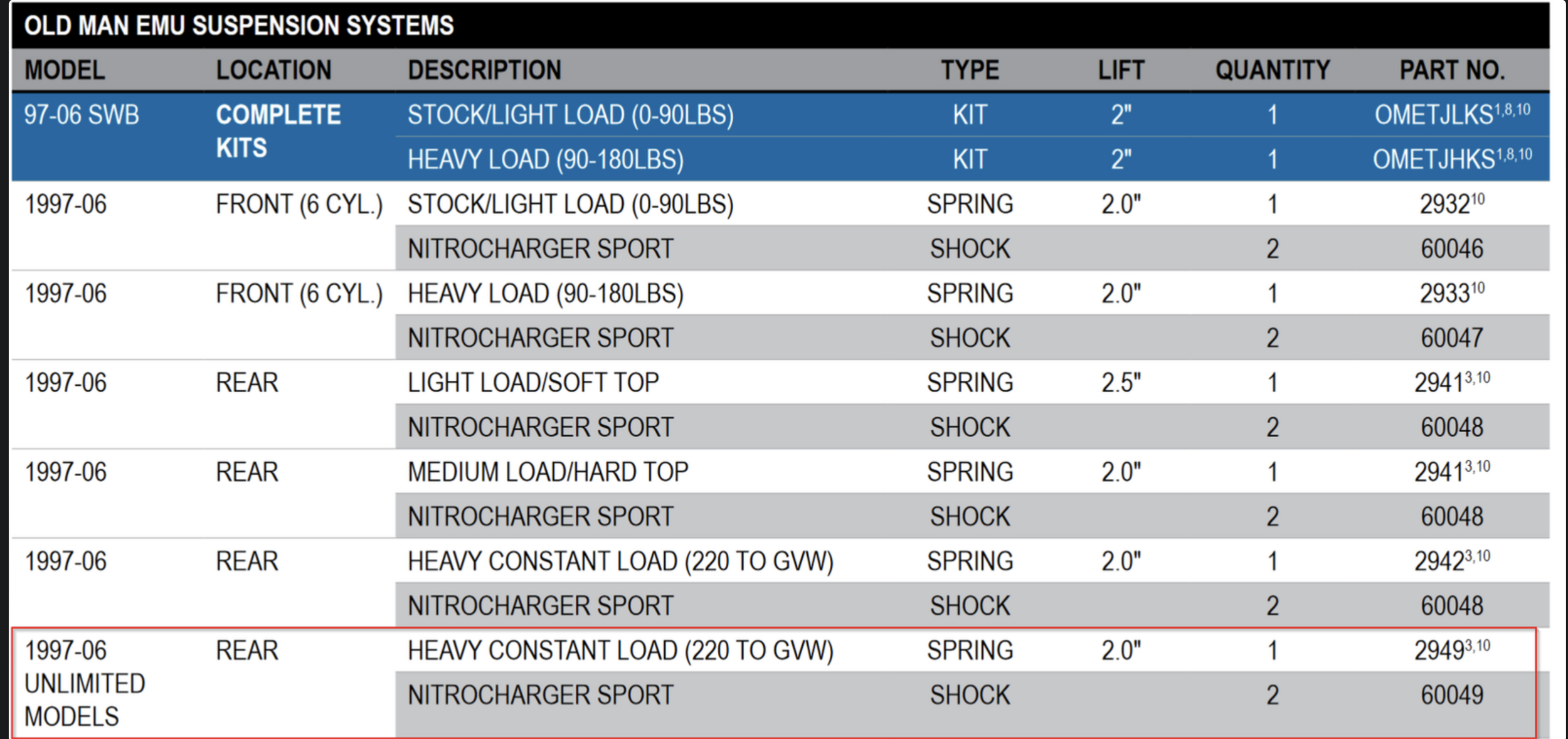

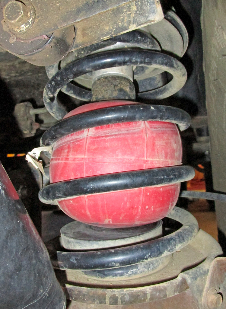

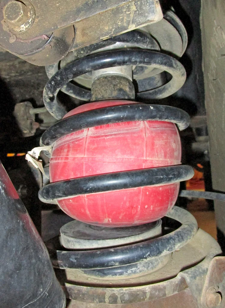

I use OME 2" lift springs with AIR LIFT 60811 1000 Series balloons. I keep them at the minimum 5 PSI except for when I'm pulling my heavy trailer, then I use about 30 PSI. They keep everything level. My bump stop cups sit just slightly above the balloons most of the time (with an extender), with NO jounce pad (the balloon is your new jounce pad). Be sure to file your bump stop cup rim smooth so it doesn't cut the balloon.
These have worked great for the 3 years I've used them. They're fine offroad too, with full articulation of the rear axle.
