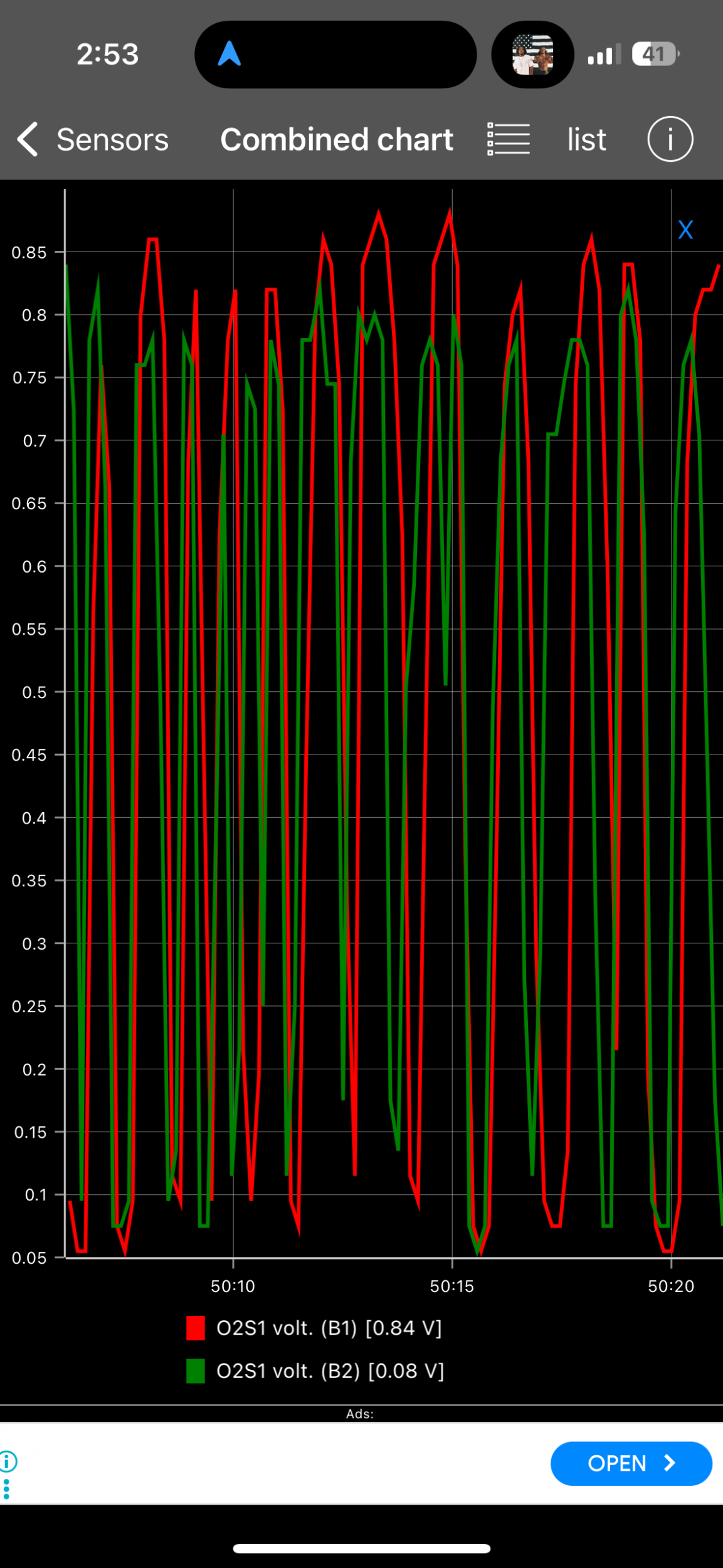

Here’s a picture of the readings for both upstream sensors. Is it normal to be dropping below 0.1?

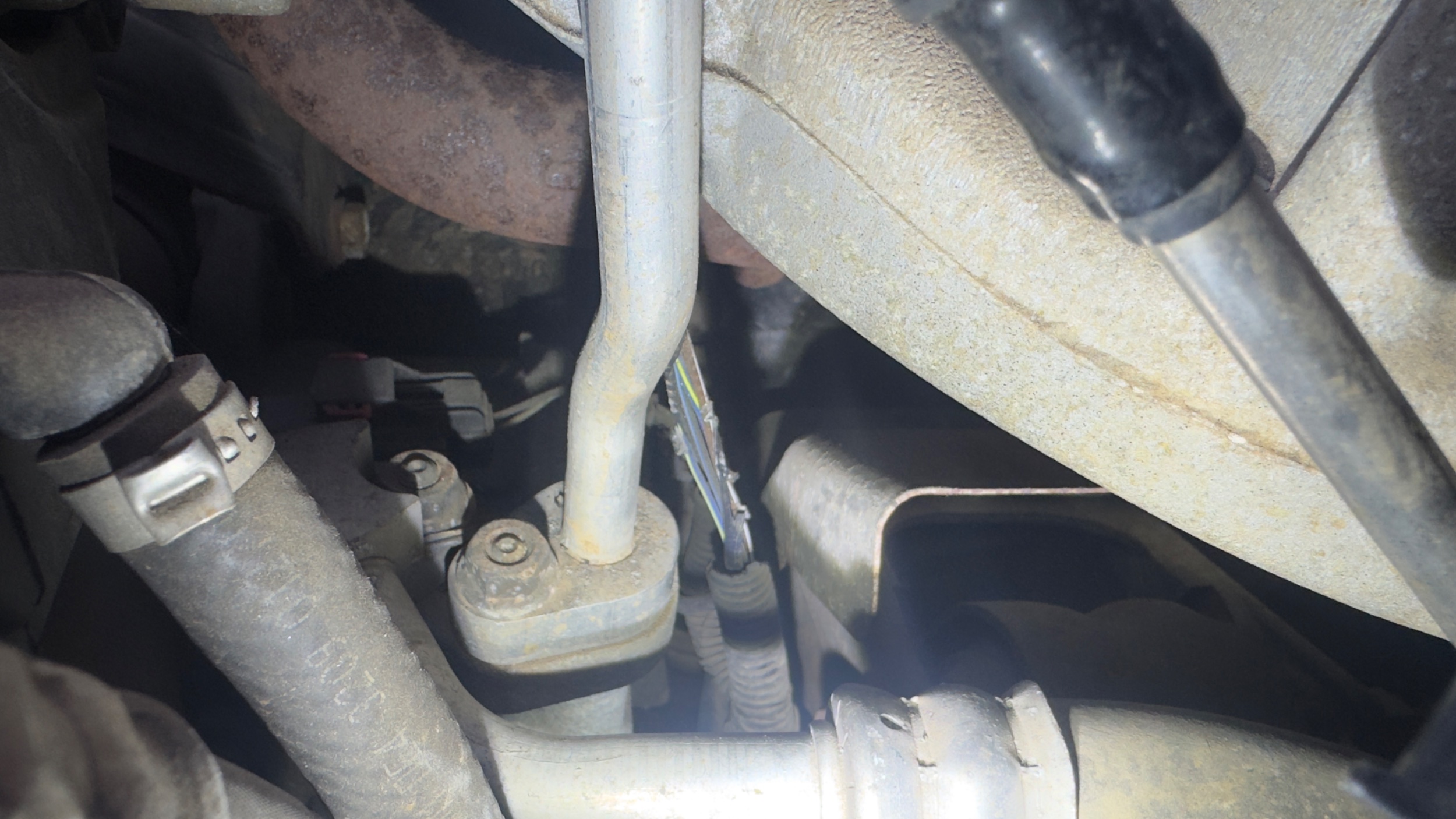

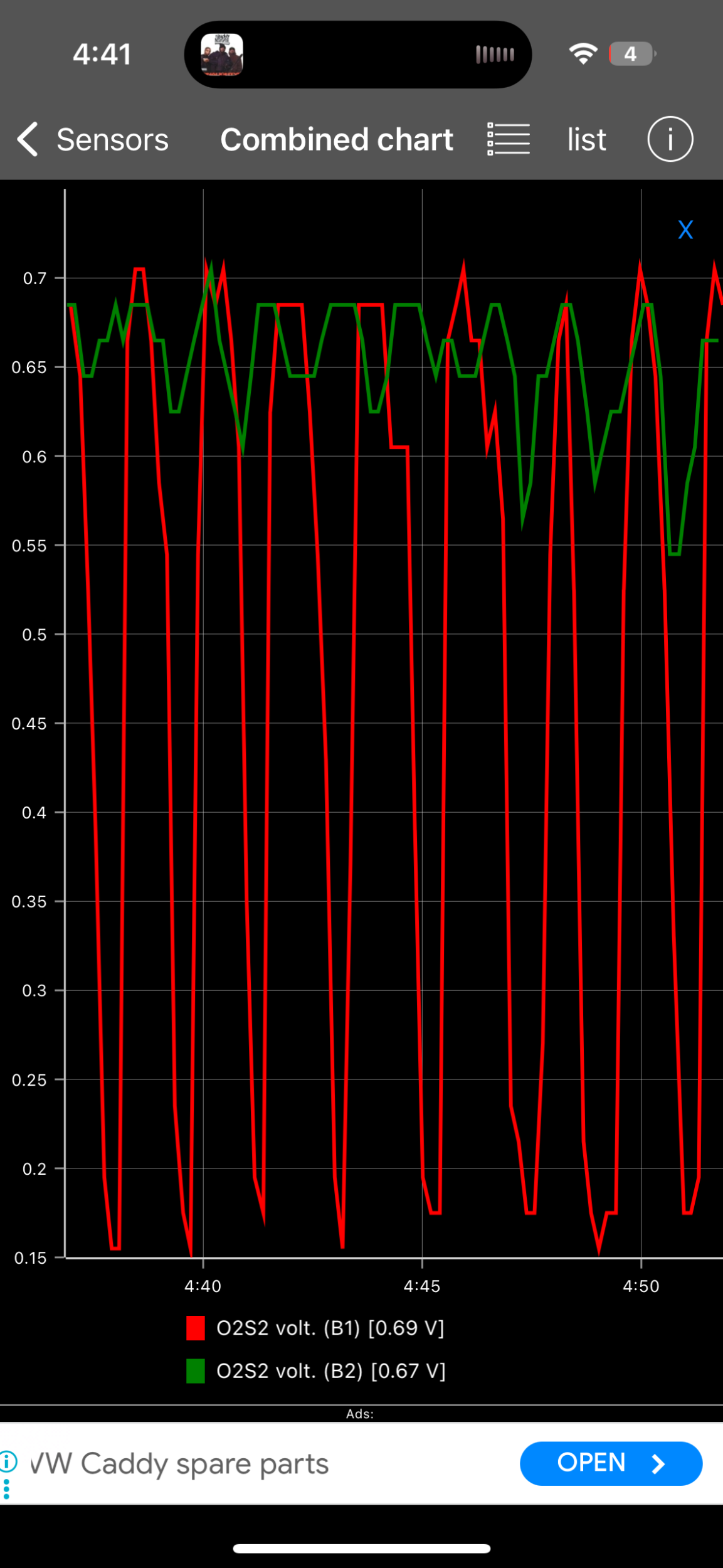

I was having a look at somethings and noticed this wiring was looking pretty bad. I’m not certain but I believe this runs to the down stream sensor on bank 1 (sensor2, bank1). If this wiring is bad, could it have an effect on the upstream sensor? Here’s a photo of the wiring and another of the voltages when comparing both downstream sensors. Does it seem right for them both to be reading different at times?

Update to this: took it in to get them wires checked, apparently only the insulation was melted and not any of the wires.

Got the wires checked out and it seems like only the insulation was melted not no actual cables. Mechanic replaced them and suggest it must be a fuel leak. They looked for a fuel leak but said it’s dry and there’s no leak so they are completely lost on what it is….
