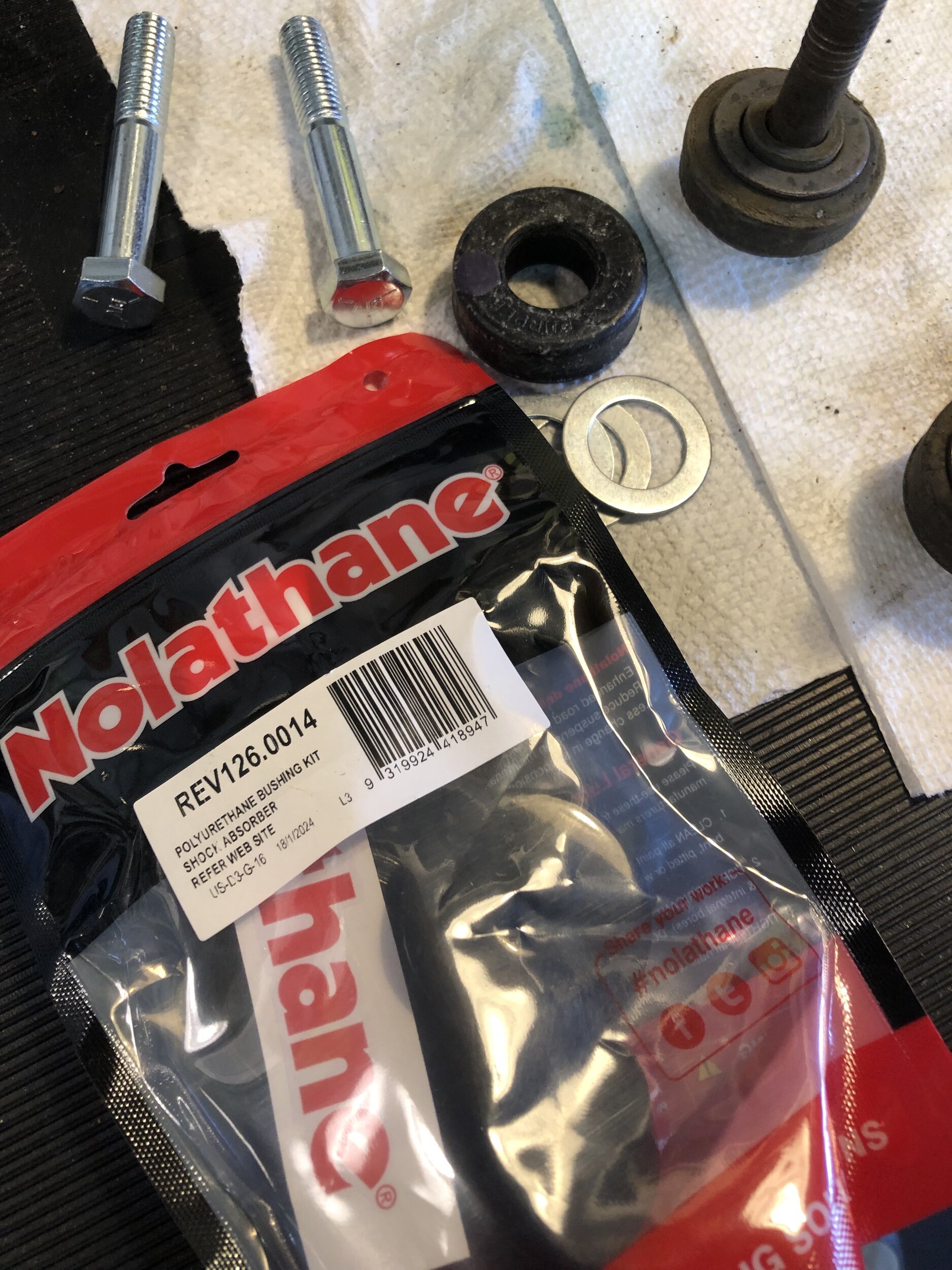

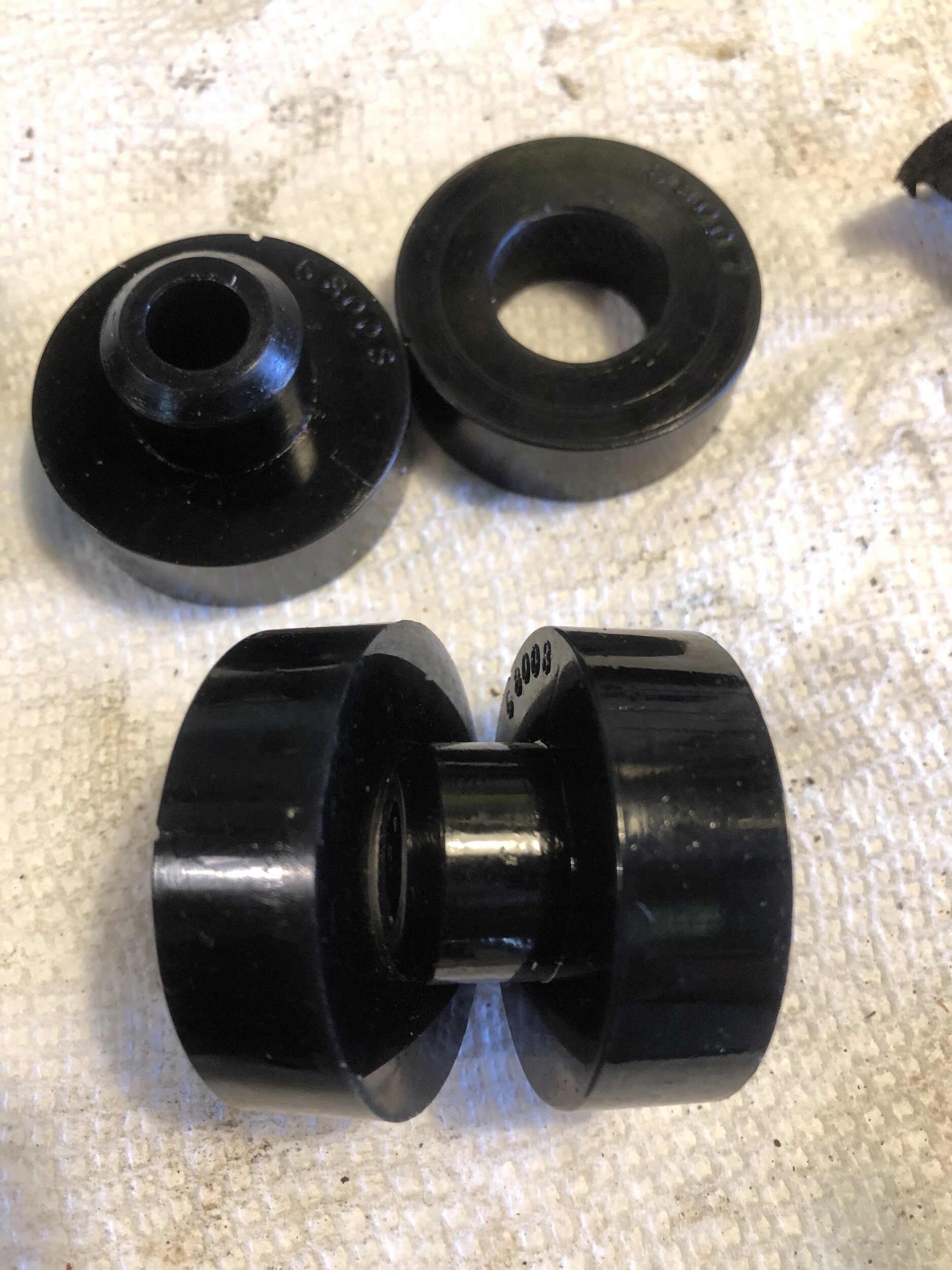

Button Bushings anyone? I called All J and they do not have the Button Bushings that are used to attach the Boom to the rear bridge and stinger. Has anyone found a suitable substitute source for these bushings? Thanks

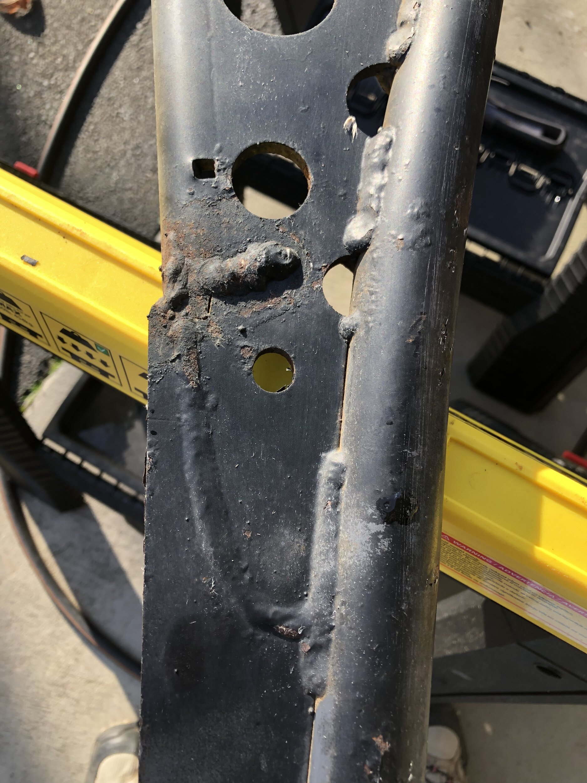

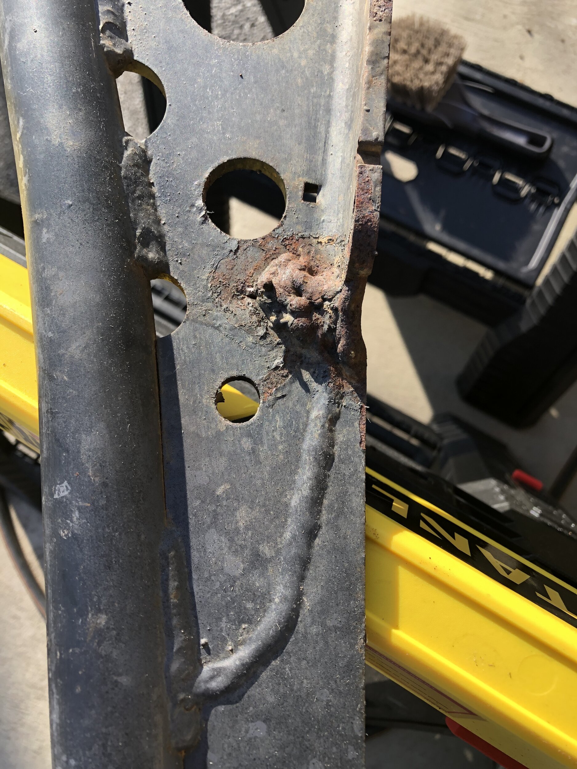

stock JK front upper stem bushings have been used in a couple. I've also bolted the stinger solid to the skid and crossover with spacers. pay special attention to the crossover that bolts to the diff skid. they bust at the 4 3/8" bolt holes that attach it to the skid. a traction bar can be substituted for the stinger and differential skid, I opted to build 3rd link on one of my personal rigs instead of using the stinger that behaves more like a radius arm. https://barnes4wd.com/products/anti-wrap-traction-bar-kit?_pos=1&_psq=traction&_ss=e&_v=1.0
07-18 STOCK front upper stem shock mounts work. you can also bolt it up solid with spacers. pay attention to the crossover/truss. they crack badly and can bust off at the 4 3/8 mounting bolts. a cj/yj traction bar can be substituted for the stinger and differential skid. I opted to get rid of the third gen camaro/radius arm bologna and built a 3rd link and set it up with about 85% antisquat with the nth degree lower arms. heres a link for a traction bar that will replace the stinger with bushings we'll likely be able to get until the end of time.

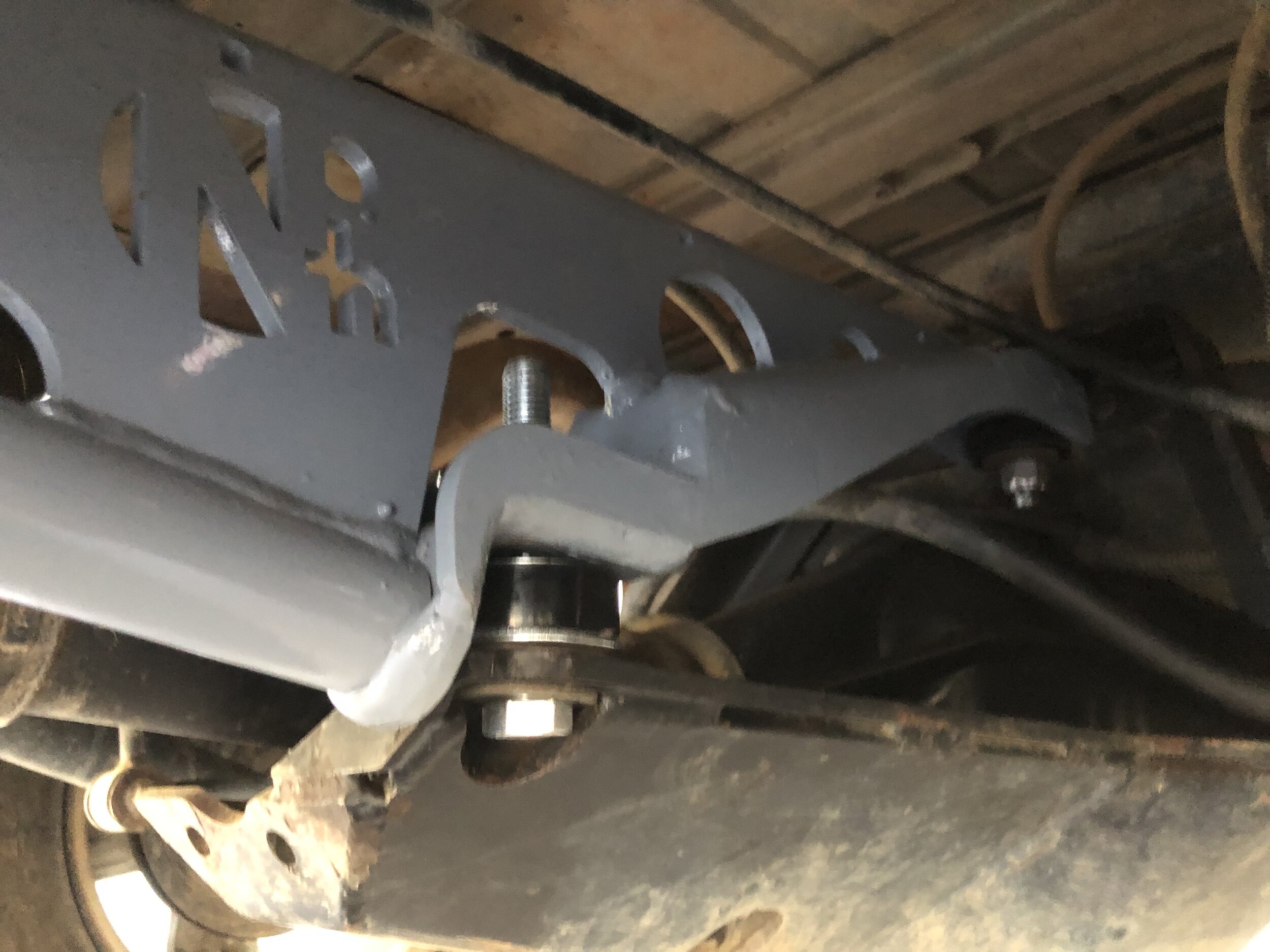

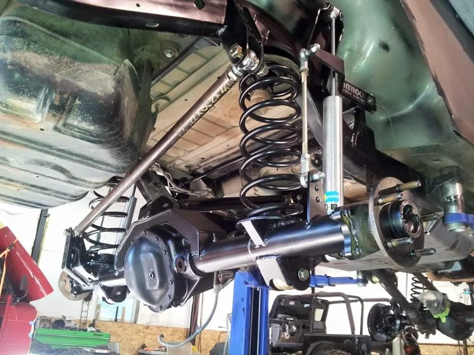

David got any pics of the three link conversion?
Reactions: Wildman
I'll have to dig through my old photo bucket for the nthdegree conversion. Here's one of the lj's i did close to 10 years ago. It has 15" of travel between the bumpstops with 12" travel forward mounted shocks.

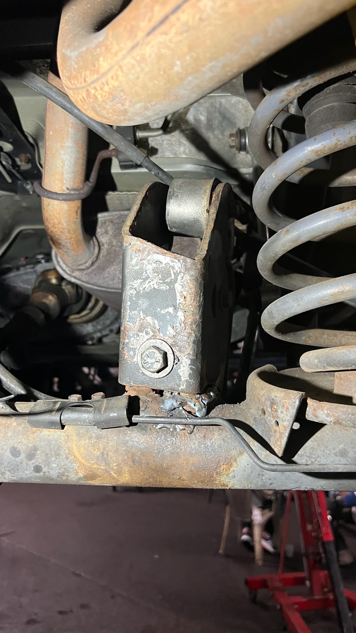

Having issues with the rear sway bar hitting the drivers side of the stinger? Any one had this issue? Does sway bar need new bushings or does it need to be heated up and bent a little so it doesn’t hit? Is that even advisable? Been chasing the noise for a long time and finally think I found it.
Pics would be a big help.
