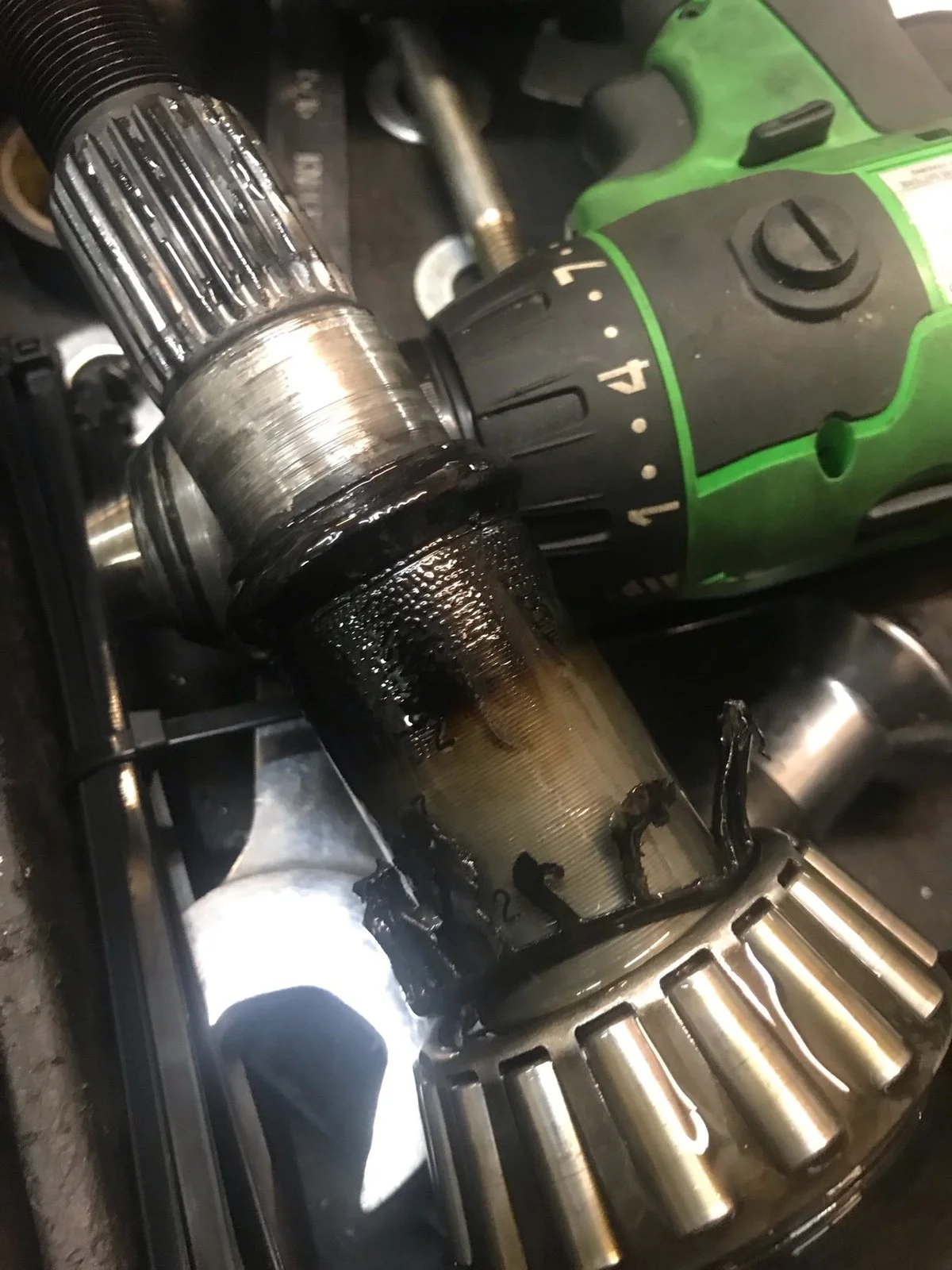

Finally got it into the shop to get it fixed. Bearing was toast, and it’s all fixed for me to pick it up Monday. Guy sent me a picture of it. Said I was lucky it didn’t blow up on me.
