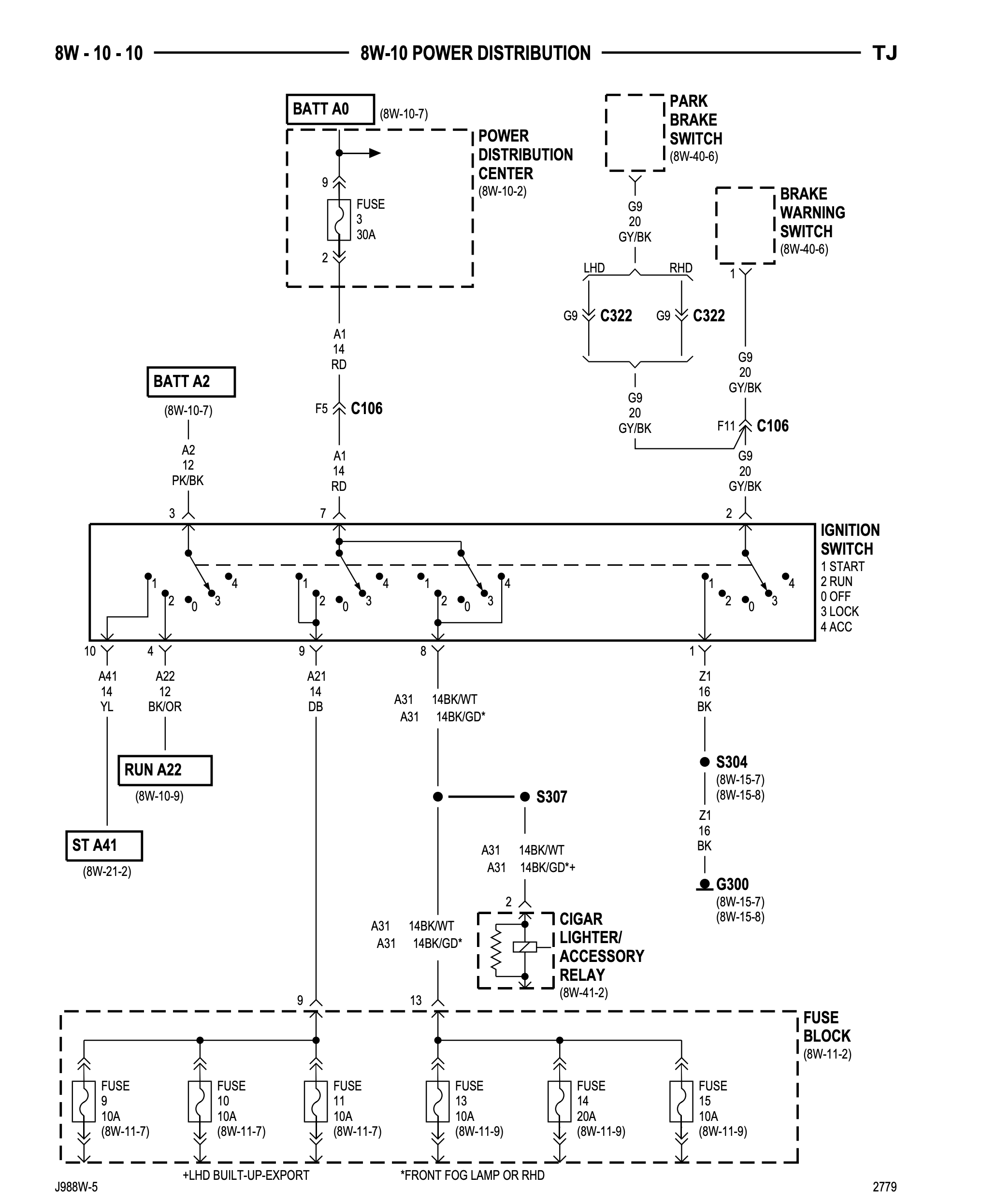

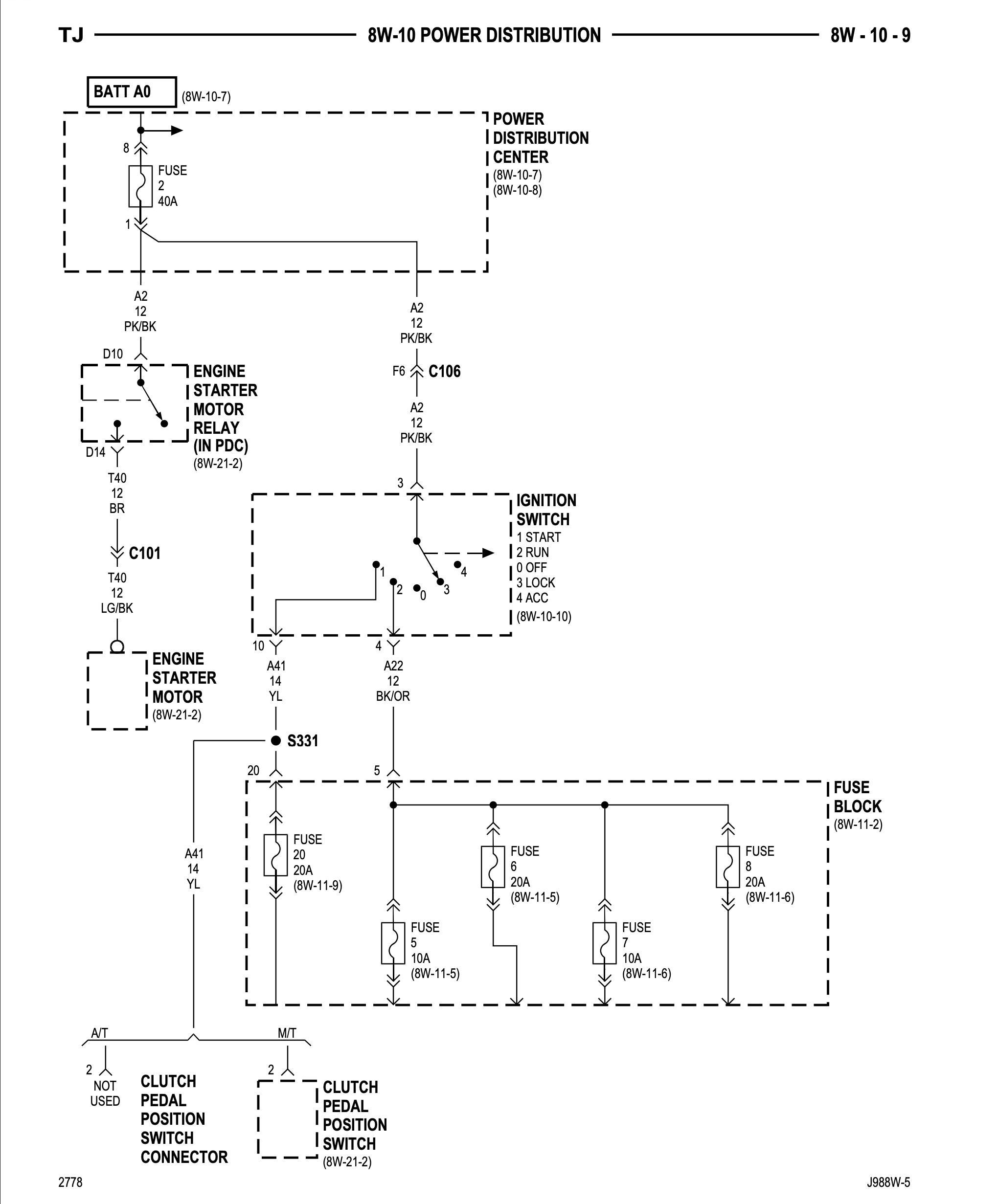

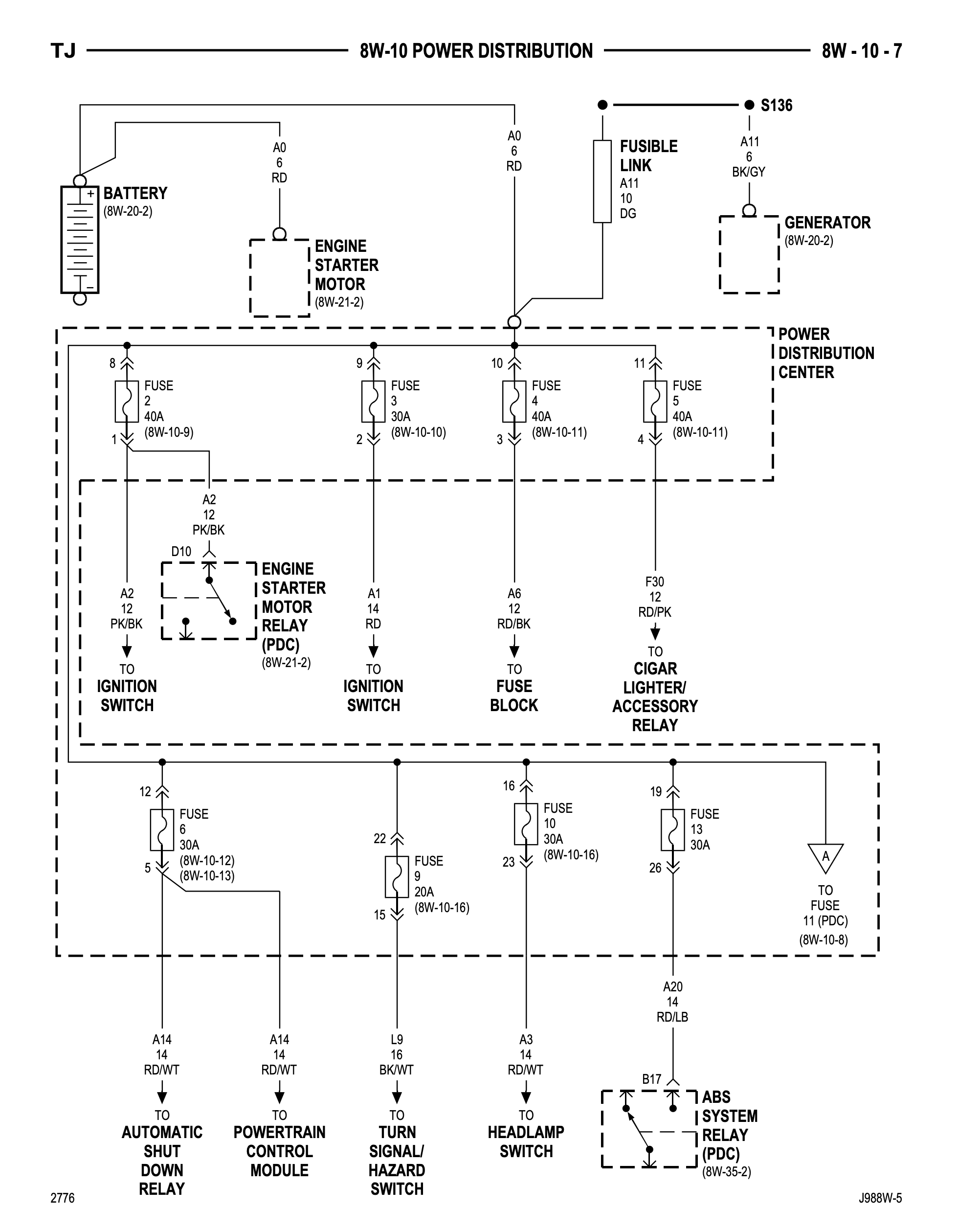

If the jeep starts and runs fuse 3 in the PDC which supplies the ignition switch is good. It switches through two sets of contacts one of those is the one that supplies the radio, turn signls and wipers.
Hazards are powered from fuse 9 in the PDC and unrelated to the other things specified above.
Try turning the ignition switch back from the off to the accessory position. If the radio, turn signals and hazards work in the accessory position, the switch contacts are bad in the part that supplies those circuits in the normal run position.
That was a good call! Everything works perfectly when the ignition switch is on accessory. So I guess the switch has to come out. What I replaced a couple of years ago was the actuator pin assembly. Is that what isn’t working or something else?
Thanks so much.
Hope these schematics assist you in troubleshooting the contacts in the Ignition Switch.
